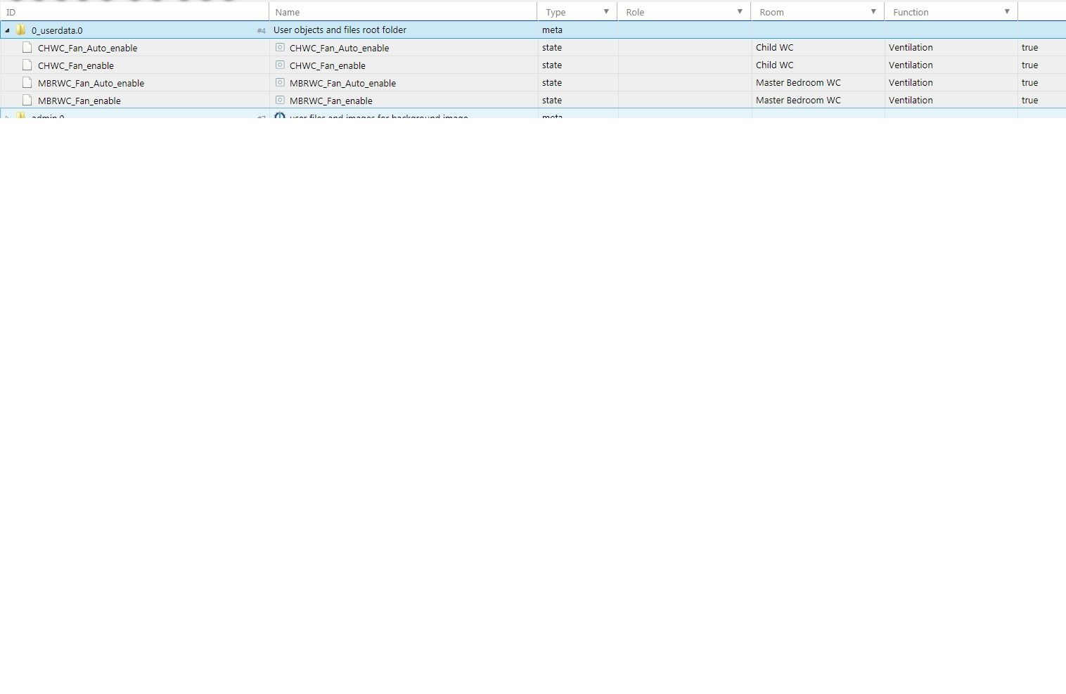

      I`ve found, Selector with ENUM for 0_userdata.0 is working with errors.
      Problem exists for 0_userdata.0 only.
      For example:

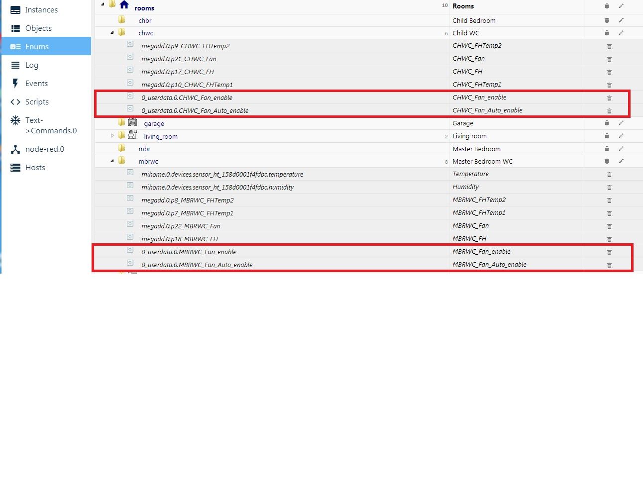

      Result Log (* We got objects from the room "chwc" too: 4 and 5 lines):
      12/28/2019, 11:39:26 PM.140	[info ]: javascript.0 (32608) Start javascript script.js.Developing.Test3
      12/28/2019, 11:39:26 PM.143	[info ]: javascript.0 (32608) script.js.Developing.Test3: subscribe: {"pattern":{"id":"telegram.0.communicate.request","change":"any","q":0},"name":"script.js.Developing.Test3"}
      12/28/2019, 11:39:26 PM.144	[info ]: javascript.0 (32608) script.js.Developing.Test3: registered 1 subscription and 0 schedules
      12/28/2019, 11:39:32 PM.995	[warn ]: javascript.0 (32608) script.js.Developing.Test3: 0_userdata.0.CHWC_Fan_Auto_enable
      12/28/2019, 11:39:32 PM.995	[warn ]: javascript.0 (32608) script.js.Developing.Test3: 0_userdata.0.CHWC_Fan_enable
      12/28/2019, 11:39:32 PM.995	[warn ]: javascript.0 (32608) script.js.Developing.Test3: 0_userdata.0.MBRWC_Fan_Auto_enable
      12/28/2019, 11:39:32 PM.995	[warn ]: javascript.0 (32608) script.js.Developing.Test3: 0_userdata.0.MBRWC_Fan_enable
      12/28/2019, 11:39:32 PM.995	[warn ]: javascript.0 (32608) script.js.Developing.Test3: megadd.0.p18_MBRWC_FH
      12/28/2019, 11:39:32 PM.995	[warn ]: javascript.0 (32608) script.js.Developing.Test3: megadd.0.p22_MBRWC_Fan
      12/28/2019, 11:39:32 PM.996	[warn ]: javascript.0 (32608) script.js.Developing.Test3: megadd.0.p7_MBRWC_FHTemp1
      12/28/2019, 11:39:32 PM.996	[warn ]: javascript.0 (32608) script.js.Developing.Test3: megadd.0.p8_MBRWC_FHTemp2
      12/28/2019, 11:39:32 PM.996	[warn ]: javascript.0 (32608) script.js.Developing.Test3: mihome.0.devices.sensor_ht_158d0001f4fdbc.humidity
      12/28/2019, 11:39:32 PM.996	[warn ]: javascript.0 (32608) script.js.Developing.Test3: mihome.0.devices.sensor_ht_158d0001f4fdbc.temperature
      My ENUMs\Objects:
