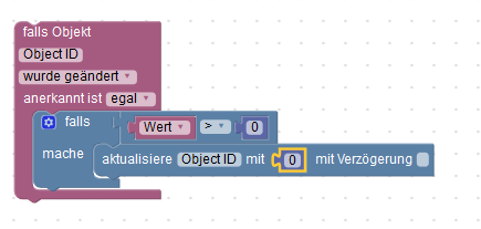

        editieren ist ja dann simpel:blockly_simpel.png
        <block type="on" id="Uzcz_V$hT-V2M]ZssfVO" x="38" y="113">
        <block type="controls_if" id="WecdzgJoyG)5nF+?vec,">
        <block type="logic_compare" id="a[y%xGt-xZ:8s5W5R{]"> <field name="OP">GT</field> <value name="A"> <block type="on_source" id="8dS+O,*D{lE/;{eM,og">
        <block type="math_number" id=":}Wwk40nhk3n,XNF}aKF">
        <field name="NUM">0</field>
        <block type="update" id="?5SDV{TWM)o4*B1m5}/W">
        <block type="math_number" id="~3zrm6a/Vn^p598qbd[@">
