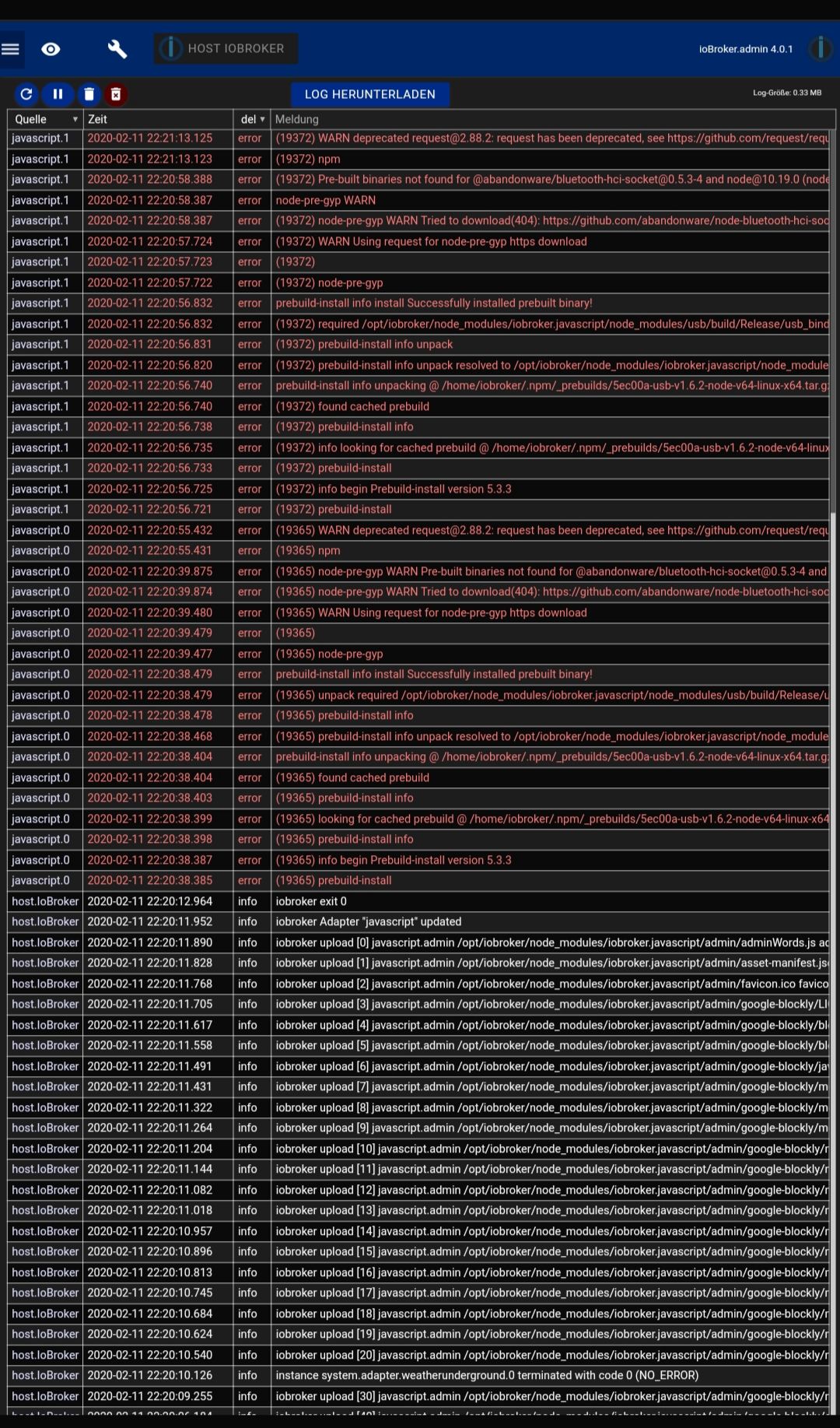

      gerade ein upgrade auf v 4.4.0 durchgeführt mit folgender Fehlermeldung
      javascript.0	2020-02-09 17:54:32.323	error	node-pre-gyp WARN Pre-built binaries not found for @abandonware/bluetooth-hci-socket@0.5.3-4 and node@10.18.1 (node-v64 ABI, glibc) (falling back to source compile with node-gyp)
      javascript.0	2020-02-09 17:54:32.323	error	(16549) WARN Tried to download(404): https://github.com/abandonware/node-bluetooth-hci-socket/releases/download/0.5.3-4/binding-0.5.3-4-node-v64-linux-x64.tar.gz
      javascript.0	2020-02-09 17:54:32.313	error	(16549) node-pre-gyp
      javascript.0	2020-02-09 17:54:31.838	error	(16549)
      javascript.0	2020-02-09 17:54:31.834	error	(16549) node-pre-gyp WARN Using request for node-pre-gyp https download
      javascript.0	2020-02-09 17:54:30.726	error	prebuild-install info install Successfully installed prebuilt binary!
      javascript.0	2020-02-09 17:54:30.726	error	(16549) info unpack required /opt/iobroker/node_modules/iobroker.javascript/node_modules/usb/build/Release/usb_bindings.node successfully
      javascript.0	2020-02-09 17:54:30.724	error	(16549) prebuild-install
      javascript.0	2020-02-09 17:54:30.712	error	(16549) prebuild-install info unpack resolved to /opt/iobroker/node_modules/iobroker.javascript/node_modules/usb/build/Release/usb_bindings.node
      javascript.0	2020-02-09 17:54:30.640	error	(16549) prebuild-install info unpacking @ /home/iobroker/.npm/_prebuilds/5ec00a-usb-v1.6.2-node-v64-linux-x64.tar.gz
      javascript.0	2020-02-09 17:54:30.638	error	(16549) prebuild-install info found cached prebuild
      javascript.0	2020-02-09 17:54:30.637	error	(16549) info looking for cached prebuild @ /home/iobroker/.npm/_prebuilds/5ec00a-usb-v1.6.2-node-v64-linux-x64.tar.gz
      javascript.0	2020-02-09 17:54:30.636	error	(16549) prebuild-install
      javascript.0	2020-02-09 17:54:30.622	error	(16549) info begin Prebuild-install version 5.3.3
      javascript.0	2020-02-09 17:54:30.619	error	(16549) prebuild-install
      javascript.1	2020-02-09 17:54:12.400	error	node-pre-gyp WARN Pre-built binaries not found for @abandonware/bluetooth-hci-socket@0.5.3-4 and node@10.18.1 (node-v64 ABI, glibc) (falling back to source compile with node-gyp)
      javascript.1	2020-02-09 17:54:12.400	error	(16556) WARN Tried to download(404): https://github.com/abandonware/node-bluetooth-hci-socket/releases/download/0.5.3-4/binding-0.5.3-4-node-v64-linux-x64.tar.gz
      javascript.1	2020-02-09 17:54:12.399	error	(16556) node-pre-gyp
      javascript.1	2020-02-09 17:54:11.987	error	(16556) WARN Using request for node-pre-gyp https download
      javascript.1	2020-02-09 17:54:11.984	error	(16556) node-pre-gyp
      javascript.1	2020-02-09 17:54:11.137	error	(16556) prebuild-install info install Successfully installed prebuilt binary!
      javascript.1	2020-02-09 17:54:11.136	error	(16556) info unpack required /opt/iobroker/node_modules/iobroker.javascript/node_modules/usb/build/Release/usb_bindings.node successfully
      javascript.1	2020-02-09 17:54:11.129	error	(16556) prebuild-install
      javascript.1	2020-02-09 17:54:11.089	error	(16556) prebuild-install info unpack resolved to /opt/iobroker/node_modules/iobroker.javascript/node_modules/usb/build/Release/usb_bindings.node
      javascript.1	2020-02-09 17:54:11.017	error	prebuild-install info unpacking @ /home/iobroker/.npm/_prebuilds/5ec00a-usb-v1.6.2-node-v64-linux-x64.tar.gz
      javascript.1	2020-02-09 17:54:11.017	error	(16556) info renaming to @ /home/iobroker/.npm/_prebuilds/5ec00a-usb-v1.6.2-node-v64-linux-x64.tar.gz
      javascript.1	2020-02-09 17:54:11.016	error	(16556) prebuild-install
      javascript.1	2020-02-09 17:54:10.809	error	(16556) info downloading to @ /home/iobroker/.npm/_prebuilds/5ec00a-usb-v1.6.2-node-v64-linux-x64.tar.gz.16689-9e60a4cb3f1c2.tmp
      javascript.1	2020-02-09 17:54:10.808	error	(16556) prebuild-install
      javascript.1	2020-02-09 17:54:10.804	error	(16556) http 200 https://github.com/tessel/node-usb/releases/download/v1.6.2/usb-v1.6.2-node-v64-linux-x64.tar.gz
      javascript.1	2020-02-09 17:54:10.803	error	(16556) prebuild-install
      javascript.1	2020-02-09 17:54:09.767	error	(16556) request GET https://github.com/tessel/node-usb/releases/download/v1.6.2/usb-v1.6.2-node-v64-linux-x64.tar.gz
      javascript.1	2020-02-09 17:54:09.766	error	(16556) prebuild-install http
      javascript.1	2020-02-09 17:54:09.763	error	(16556) looking for cached prebuild @ /home/iobroker/.npm/_prebuilds/5ec00a-usb-v1.6.2-node-v64-linux-x64.tar.gz
      javascript.1	2020-02-09 17:54:09.760	error	(16556) prebuild-install info
      javascript.1	2020-02-09 17:54:09.749	error	(16556) info begin Prebuild-install version 5.3.3
      javascript.1	2020-02-09 17:54:09.747	error	(16556) prebuild-install
      host.IoBroker	2020-02-09 17:53:49.742	info	iobroker exit 0
      host.IoBroker	2020-02-09 17:53:48.588	info	iobroker Adapter "javascript" updated
      host.IoBroker	2020-02-09 17:53:48.529	info	iobroker upload [0] javascript.admin /opt/iobroker/node_modules/iobroker.javascript/admin/adminWords.js adminWords.js application/javascript
      host.IoBroker	2020-02-09 17:53:48.467	info	iobroker upload [1] javascript.admin /opt/iobroker/node_modules/iobroker.javascript/admin/asset-manifest.json asset-manifest.json application/json
      host.IoBroker	2020-02-09 17:53:48.403	info	iobroker upload [2] javascript.admin /opt/iobroker/node_modules/iobroker.javascript/admin/favicon.ico favicon.ico image/vnd.microsoft.icon
      host.IoBroker	2020-02-09 17:53:48.338	info	iobroker upload [3] javascript.admin /opt/iobroker/node_modules/iobroker.javascript/admin/google-blockly/LICENSE google-blockly/LICENSE null
      host.IoBroker	2020-02-09 17:53:48.223	info	iobroker upload [4] javascript.admin /opt/iobroker/node_modules/iobroker.javascript/admin/google-blockly/blockly_compressed.js google-blockly/blockly_compressed.js application/javascript
      host.IoBroker	2020-02-09 17:53:48.160	info	iobroker upload [5] javascript.admin /opt/iobroker/node_modules/iobroker.javascript/admin/google-blockly/blocks_compressed.js google-blockly/blocks_compressed.js application/javascript
      host.IoBroker	2020-02-09 17:53:48.095	info	iobroker upload [6] javascript.admin /opt/iobroker/node_modules/iobroker.javascript/admin/google-blockly/javascript_compressed.js google-blockly/javascript_compressed.js application/javascript
      host.IoBroker	2020-02-09 17:53:48.018	info	iobroker upload [7] javascript.admin /opt/iobroker/node_modules/iobroker.javascript/admin/google-blockly/media/1x1.gif google-blockly/media/1x1.gif image/gif
      host.IoBroker	2020-02-09 17:53:47.930	info	iobroker upload [8] javascript.admin /opt/iobroker/node_modules/iobroker.javascript/admin/google-blockly/media/click.mp3 google-blockly/media/click.mp3 audio/mpeg
      host.IoBroker	2020-02-09 17:53:47.852	info	iobroker upload [9] javascript.admin /opt/iobroker/node_modules/iobroker.javascript/admin/google-blockly/media/click.ogg google-blockly/media/click.ogg audio/ogg
      host.IoBroker	2020-02-09 17:53:47.766	info	iobroker upload [10] javascript.admin /opt/iobroker/node_modules/iobroker.javascript/admin/google-blockly/media/click.wav google-blockly/media/click.wav audio/wav
      host.IoBroker	2020-02-09 17:53:47.705	info	iobroker upload [11] javascript.admin /opt/iobroker/node_modules/iobroker.javascript/admin/google-blockly/media/delete.mp3 google-blockly/media/delete.mp3 audio/mpeg
      host.IoBroker	2020-02-09 17:53:47.629	info	iobroker upload [12] javascript.admin /opt/iobroker/node_modules/iobroker.javascript/admin/google-blockly/media/delete.ogg google-blockly/media/delete.ogg audio/ogg
      host.IoBroker	2020-02-09 17:53:47.559	info	iobroker upload [13] javascript.admin /opt/iobroker/node_modules/iobroker.javascript/admin/google-blockly/media/delete.wav google-blockly/media/delete.wav audio/wav
      host.IoBroker	2020-02-09 17:53:47.489	info	iobroker upload [14] javascript.admin /opt/iobroker/node_modules/iobroker.javascript/admin/google-blockly/media/disconnect.mp3 google-blockly/media/disconnect.mp3 audio/mpeg
      host.IoBroker	2020-02-09 17:53:47.427	info	iobroker upload [15] javascript.admin /opt/iobroker/node_modules/iobroker.javascript/admin/google-blockly/media/disconnect.ogg google-blockly/media/disconnect.ogg audio/ogg
      host.IoBroker	2020-02-09 17:53:47.362	info	iobroker upload [16] javascript.admin /opt/iobroker/node_modules/iobroker.javascript/admin/google-blockly/media/disconnect.wav google-blockly/media/disconnect.wav audio/wav
      host.IoBroker	2020-02-09 17:53:47.300	info	iobroker upload [17] javascript.admin /opt/iobroker/node_modules/iobroker.javascript/admin/google-blockly/media/handclosed.cur google-blockly/media/handclosed.cur null
      host.IoBroker	2020-02-09 17:53:47.231	info	iobroker upload [18] javascript.admin /opt/iobroker/node_modules/iobroker.javascript/admin/google-blockly/media/handdelete.cur google-blockly/media/handdelete.cur null
      host.IoBroker	2020-02-09 17:53:47.167	info	iobroker upload [19] javascript.admin /opt/iobroker/node_modules/iobroker.javascript/admin/google-blockly/media/handopen.cur google-blockly/media/handopen.cur null
      host.IoBroker	2020-02-09 17:53:47.097	info	iobroker upload [20] javascript.admin /opt/iobroker/node_modules/iobroker.javascript/admin/google-blockly/media/quote0.png google-blockly/media/quote0.png image/png
      host.IoBroker	2020-02-09 17:53:46.341	info	iobroker upload [30] javascript.admin /opt/iobroker/node_modules/iobroker.javascript/admin/google-blockly/msg/js/pl.js google-blockly/msg/js/pl.js application/javascript
      host.IoBroker	2020-02-09 17:53:45.393	info	iobroker upload [40] javascript.admin /opt/iobroker/node_modules/iobroker.javascript/admin/google-blockly/own/blocks_time.js google-blockly/own/blocks_time.js application/javascript
      host.IoBroker	2020-02-09 17:53:44.613	info	iobroker upload [50] javascript.admin /opt/iobroker/node_modules/iobroker.javascript/admin/google-blockly/own/msg/fr.js google-blockly/own/msg/fr.js application/javascript
      host.IoBroker	2020-02-09 17:53:43.250	info	iobroker upload [60] javascript.admin /opt/iobroker/node_modules/iobroker.javascript/admin/precache-manifest.2667e3a6e95d83f9ded6e81f5008ecf1.js precache-manifest.2667e3a6e95d83f9ded6e81f5008ecf1.js
      host.IoBroker	2020-02-09 17:53:41.046	info	iobroker upload [70] javascript.admin /opt/iobroker/node_modules/iobroker.javascript/admin/static/js/main.c06e875f.chunk.js.LICENSE.txt static/js/main.c06e875f.chunk.js.LICENSE.txt text/plain
      host.IoBroker	2020-02-09 17:53:40.179	info	iobroker upload [80] javascript.admin /opt/iobroker/node_modules/iobroker.javascript/admin/vs/basic-languages/cpp/cpp.js vs/basic-languages/cpp/cpp.js application/javascript
      javascript.1	2020-02-09 17:53:39.658	error	(16556) Longitude or latitude does not set. Cannot use astro.
      host.IoBroker	2020-02-09 17:53:38.952	info	iobroker upload [90] javascript.admin /opt/iobroker/node_modules/iobroker.javascript/admin/vs/basic-languages/java/java.js vs/basic-languages/java/java.js application/javascript
      host.IoBroker	2020-02-09 17:53:38.029	info	iobroker upload [100] javascript.admin /opt/iobroker/node_modules/iobroker.javascript/admin/vs/basic-languages/powershell/powershell.js vs/basic-languages/powershell/powershell.js application/javascr
      host.IoBroker	2020-02-09 17:53:34.682	info	instance system.adapter.javascript.1 started with pid 16556
      host.IoBroker	2020-02-09 17:53:34.647	info	instance system.adapter.javascript.0 started with pid 16549
      host.IoBroker	2020-02-09 17:53:32.816	info	instance system.adapter.javascript.1 terminated with code 156 (156)
      host.IoBroker	2020-02-09 17:53:32.763	info	instance system.adapter.javascript.0 terminated with code 156 (156)
      host.IoBroker	2020-02-09 17:53:32.085	info	stopInstance system.adapter.javascript.1 send kill signal
      host.IoBroker	2020-02-09 17:53:32.081	info	stopInstance system.adapter.javascript.1 (force=false, process=true)
      host.IoBroker	2020-02-09 17:53:32.077	info	stopInstance system.adapter.javascript.0 send kill signal
      host.IoBroker	2020-02-09 17:53:32.034	info	stopInstance system.adapter.javascript.0 (force=false, process=true)
      host.IoBroker	2020-02-09 17:53:31.831	info	iobroker Update "system.adapter.javascript.1"
      host.IoBroker	2020-02-09 17:53:31.823	info	iobroker Update "system.adapter.javascript.0"
      host.IoBroker	2020-02-09 17:52:29.403	info	instance system.adapter.daswetter.0 terminated with code 0 (NO_ERROR)
      host.IoBroker	2020-02-09 17:52:00.120	info	instance system.adapter.daswetter.0 started with pid 16337
      host.IoBroker	2020-02-09 17:51:51.470	info	iobroker npm install iobroker.javascript@4.4.0 --loglevel error --prefix "/opt/iobroker" (System call)
      host.IoBroker	2020-02-09 17:51:51.462	info	iobroker NPM version: 6.13.4
      host.IoBroker	2020-02-09 17:51:50.457	info	iobroker Update javascript from @4.3.4 to @4.4.0
      host.IoBroker	2020-02-09 17:51:47.712	info	iobroker upgrade javascript

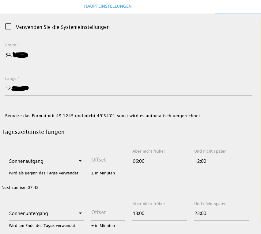

                    @biker nimm mal den Haken raus
                    EDIT: Das sind aber nicht die Geokordinaten
                      A Former User @Homoran last edited by
                      @Homoran

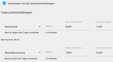

                      in der Haupteinstellung sind Geodaten eingetragen. Dachte, das mit gesetzten Haken auf diese zugegriffen wird. Der Kartenausschnitt rechts gibt mit Haken gesetzt auch meinen Standort wieder.
                      Habe mal den Haken entfernt und gespeichert. Es öffnet sich Dialog: Bitte bestätigen
                      Einige Daten wurden nicht gespeichert. Verwerfen?
                      Ursache liegt also tiefer. Habe nun auch festgestellt, das ich manuell angelegte States nicht mehr ändern kann.

                        leider nicht - die Astrofunktionen funktionieren nur mir eingegebene Koordinaten im js-Adapter
                          A Former User @Homoran last edited by A Former User
                          @Homoran
                          ah Danke ! habe den Haken entfernt. Seltsamer weise werden die Koordinaten trotz Hinweis
                          .. Einige Daten wurden nicht gespeichert. Verwerfen? übernommen.

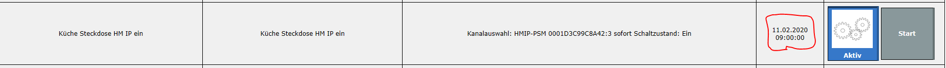

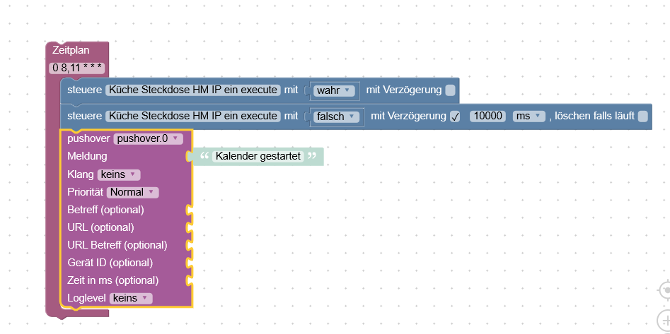

                                ich hänge mich hier mal rein. Habe das Problem, dass bei meinen Scripten, die mit einem Cronjob getriggert werden, nach Update auf 4.4.0 alles genau eine Stunde später abläuft. Meine Einstellungen:
                                Ein Blockly, das eigentlich um 08:00 Uhr schalten sollte, schaltet erst um 09.00 Uhr. Setze ich den Haken in der Config für "Verwenden Sie die Systemeinstellungen", dann wird der Cronjob nicht ausgeführt.
                                Hier das Blockly:

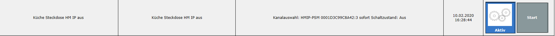

                                Ich stoße damit ein Programm in der CCU3 an. Das wurde aber erst um 09.00 Uhr aktiviert.
                                Es sollte um 10.00 Uhr das Ausschaltblockly angestossen werden, ist leider nicht passiert.
                                Hier stehen noch die Daten vom letzten Ausschalten drin. Das Programm soll um 11.00 Uhr wieder einschalten und um 15.00 Uhr wieder ausschalten. Werde mal schauen, wie da die Zeiten liegen.
                                Was muss ich einstellen, damit wieder um 08.00 Uhr geschaltet wird? Offset von 60 min?
