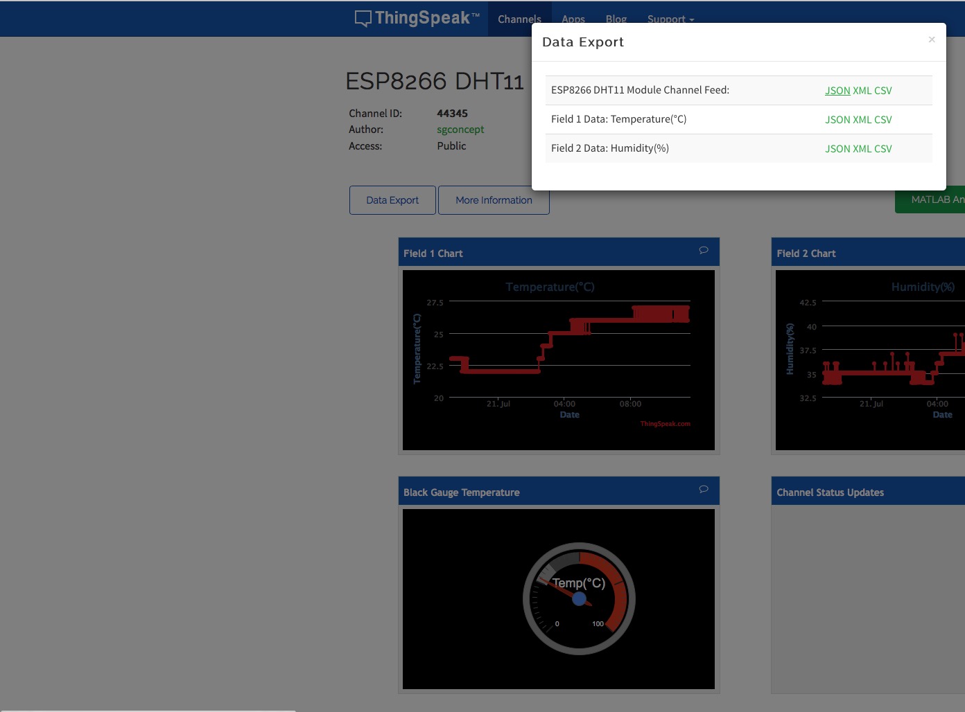

        theoretisch kann man jede Seite parsen. In diesem Fall ist es aber gleich viel einfacher, da für die öffentlichen channels auch ein JSON Feed zur Verfügung steht: 261_bildschirmfoto_2016-07-21_um_11.29.29.jpg
        Sieht dann so aus:
        {"channel":{"id":44345,"name":"ESP8266 DHT11 Module","description":"ESP8266 DHT11 Module","latitude":"1.386593","longitude":"103.895565","field1":"Temperature(°C)","field2":"Humidity(%)","created_at":"2015-06-28T01:17:29Z","updated_at":"2016-07-21T09:29:33Z","elevation":"5","last_entry_id":1743323},"feeds":[{"created_at":"2016-07-21T09:01:24Z","entry_id":1743224,"field1":"27.00","field2":"35.00\r\n\r\n"},{"created_at":"2016-07-21T09:01:41Z","entry_id":1743225,"field1":"27.00","field2":"35.00\r\n\r\n"},{"created_at":"2016-07-21T09:01:58Z","entry_id":1743226,"field1":"27.00","field2":"35.00\r\n\r\n"},{"created_at":"2016-07-21T09:02:15Z","entry_id":1743227,"field1":"27.00","field2":"35.00\r\n\r\n"},{"created_at":"2016-07-21T09:02:32Z","entry_id":1743228,"field1":"27.00","field2":"35.00\r\n\r\n"},{"created_at":"2016-07-21T09:02:49Z","entry_id":1743229,"field1":"27.00","field2":"35.00\r\n\r\n"},{"created_at":"2016-07-21T09:03:06Z","entry_id":1743230,"field1":"27.00","field2":"35.00\r\n\r\n"},{"created_at":"2016-07-21T09:03:23Z","entry_id":1743231,"field1":"26.00","field2":"36.00\r\n\r\n"},{"created_at":"2016-07-21T09:03:40Z","entry_id":1743232,"field1":"27.00","field2":"35.00\r\n\r\n"},{"created_at":"2016-07-21T09:03:57Z","entry_id":1743233,"field1":"27.00","field2":"35.00\r\n\r\n"},{"created_at":"2016-07-21T09:04:14Z","entry_id":1743234,"field1":"27.00","field2":"35.00\r\n\r\n"},{"created_at":"2016-07-21T09:04:31Z","entry_id":1743235,"field1":"27.00","field2":"35.00\r\n\r\n"},{"created_at":"2016-07-21T09:04:48Z","entry_id":1743236,"field1":"27.00","field2":"35.00\r\n\r\n"},{"created_at":"2016-07-21T09:05:05Z","entry_id":1743237,"field1":"27.00","field2":"35.00\r\n\r\n"},{"created_at":"2016-07-21T09:05:23Z","entry_id":1743238,"field1":"26.00","field2":"36.00\r\n\r\n"},{"created_at":"2016-07-21T09:05:40Z","entry_id":1743239,"field1":"27.00","field2":"35.00\r\n\r\n"},{"created_at":"2016-07-21T09:05:57Z","entry_id":1743240,"field1":"27.00","field2":"35.00\r\n\r\n"},{"created_at":"2016-07-21T09:06:14Z","entry_id":1743241,"field1":"27.00","field2":"35.00\r\n\r\n"},{"created_at":"2016-07-21T09:06:31Z","entry_id":1743242,"field1":"27.00","field2":"35.00\r\n\r\n"},{"created_at":"2016-07-21T09:06:48Z","entry_id":1743243,"field1":"27.00","field2":"35.00\r\n\r\n"},{"created_at":"2016-07-21T09:07:05Z","entry_id":1743244,"field1":"27.00","field2":"35.00\r\n\r\n"},{"created_at":"2016-07-21T09:07:22Z","entry_id":1743245,"field1":"27.00","field2":"35.00\r\n\r\n"},{"created_at":"2016-07-21T09:07:40Z","entry_id":1743246,"field1":"27.00","field2":"35.00\r\n\r\n"},{"created_at":"2016-07-21T09:07:56Z","entry_id":1743247,"field1":"27.00","field2":"35.00\r\n\r\n"},{"created_at":"2016-07-21T09:08:14Z","entry_id":1743248,"field1":"26.00","field2":"36.00\r\n\r\n"},{"created_at":"2016-07-21T09:08:31Z","entry_id":1743249,"field1":"27.00","field2":"35.00\r\n\r\n"},{"created_at":"2016-07-21T09:08:48Z","entry_id":1743250,"field1":"27.00","field2":"35.00\r\n\r\n"},{"created_at":"2016-07-21T09:09:05Z","entry_id":1743251,"field1":"26.00","field2":"36.00\r\n\r\n"},{"created_at":"2016-07-21T09:09:22Z","entry_id":1743252,"field1":"27.00","field2":"35.00\r\n\r\n"},{"created_at":"2016-07-21T09:09:38Z","entry_id":1743253,"field1":"27.00","field2":"35.00\r\n\r\n"},{"created_at":"2016-07-21T09:09:56Z","entry_id":1743254,"field1":"27.00","field2":"35.00\r\n\r\n"},{"created_at":"2016-07-21T09:10:13Z","entry_id":1743255,"field1":"27.00","field2":"35.00\r\n\r\n"},{"created_at":"2016-07-21T09:10:30Z","entry_id":1743256,"field1":"27.00","field2":"35.00\r\n\r\n"},{"created_at":"2016-07-21T09:10:47Z","entry_id":1743257,"field1":"27.00","field2":"35.00\r\n\r\n"},{"created_at":"2016-07-21T09:11:04Z","entry_id":1743258,"field1":"27.00","field2":"35.00\r\n\r\n"},{"created_at":"2016-07-21T09:11:21Z","entry_id":1743259,"field1":"27.00","field2":"35.00\r\n\r\n"},{"created_at":"2016-07-21T09:11:38Z","entry_id":1743260,"field1":"27.00","field2":"35.00\r\n\r\n"},{"created_at":"2016-07-21T09:11:55Z","entry_id":1743261,"field1":"27.00","field2":"35.00\r\n\r\n"},{"created_at":"2016-07-21T09:12:12Z","entry_id":1743262,"field1":"27.00","field2":"35.00\r\n\r\n"},{"created_at":"2016-07-21T09:12:29Z","entry_id":1743263,"field1":"27.00","field2":"35.00\r\n\r\n"},{"created_at":"2016-07-21T09:12:46Z","entry_id":1743264,"field1":"27.00","field2":"35.00\r\n\r\n"},{"created_at":"2016-07-21T09:13:03Z","entry_id":1743265,"field1":"27.00","field2":"35.00\r\n\r\n"},{"created_at":"2016-07-21T09:13:20Z","entry_id":1743266,"field1":"27.00","field2":"35.00\r\n\r\n"},{"created_at":"2016-07-21T09:13:37Z","entry_id":1743267,"field1":"27.00","field2":"35.00\r\n\r\n"},{"created_at":"2016-07-21T09:13:54Z","entry_id":1743268,"field1":"27.00","field2":"35.00\r\n\r\n"},{"created_at":"2016-07-21T09:14:11Z","entry_id":1743269,"field1":"27.00","field2":"35.00\r\n\r\n"},{"created_at":"2016-07-21T09:14:28Z","entry_id":1743270,"field1":"27.00","field2":"35.00\r\n\r\n"},{"created_at":"2016-07-21T09:14:45Z","entry_id":1743271,"field1":"27.00","field2":"35.00\r\n\r\n"},{"created_at":"2016-07-21T09:15:02Z","entry_id":1743272,"field1":"26.00","field2":"36.00\r\n\r\n"},{"created_at":"2016-07-21T09:15:19Z","entry_id":1743273,"field1":"27.00","field2":"35.00\r\n\r\n"},{"created_at":"2016-07-21T09:15:36Z","entry_id":1743274,"field1":"27.00","field2":"35.00\r\n\r\n"},{"created_at":"2016-07-21T09:15:54Z","entry_id":1743275,"field1":"27.00","field2":"35.00\r\n\r\n"},{"created_at":"2016-07-21T09:16:11Z","entry_id":1743276,"field1":"27.00","field2":"35.00\r\n\r\n"},{"created_at":"2016-07-21T09:16:28Z","entry_id":1743277,"field1":"27.00","field2":"35.00\r\n\r\n"},{"created_at":"2016-07-21T09:16:45Z","entry_id":1743278,"field1":"27.00","field2":"35.00\r\n\r\n"},{"created_at":"2016-07-21T09:17:02Z","entry_id":1743279,"field1":"27.00","field2":"35.00\r\n\r\n"},{"created_at":"2016-07-21T09:17:19Z","entry_id":1743280,"field1":"26.00","field2":"36.00\r\n\r\n"},{"created_at":"2016-07-21T09:17:36Z","entry_id":1743281,"field1":"27.00","field2":"35.00\r\n\r\n"},{"created_at":"2016-07-21T09:17:53Z","entry_id":1743282,"field1":"26.00","field2":"36.00\r\n\r\n"},{"created_at":"2016-07-21T09:18:10Z","entry_id":1743283,"field1":"27.00","field2":"35.00\r\n\r\n"},{"created_at":"2016-07-21T09:18:27Z","entry_id":1743284,"field1":"27.00","field2":"35.00\r\n\r\n"},{"created_at":"2016-07-21T09:18:44Z","entry_id":1743285,"field1":"27.00","field2":"35.00\r\n\r\n"},{"created_at":"2016-07-21T09:19:01Z","entry_id":1743286,"field1":"27.00","field2":"35.00\r\n\r\n"},{"created_at":"2016-07-21T09:19:18Z","entry_id":1743287,"field1":"26.00","field2":"36.00\r\n\r\n"},{"created_at":"2016-07-21T09:19:35Z","entry_id":1743288,"field1":"26.00","field2":"36.00\r\n\r\n"},{"created_at":"2016-07-21T09:19:53Z","entry_id":1743289,"field1":"27.00","field2":"35.00\r\n\r\n"},{"created_at":"2016-07-21T09:20:10Z","entry_id":1743290,"field1":"26.00","field2":"36.00\r\n\r\n"},{"created_at":"2016-07-21T09:20:27Z","entry_id":1743291,"field1":"27.00","field2":"35.00\r\n\r\n"},{"created_at":"2016-07-21T09:20:43Z","entry_id":1743292,"field1":"27.00","field2":"35.00\r\n\r\n"},{"created_at":"2016-07-21T09:21:01Z","entry_id":1743293,"field1":"27.00","field2":"35.00\r\n\r\n"},{"created_at":"2016-07-21T09:21:18Z","entry_id":1743294,"field1":"27.00","field2":"35.00\r\n\r\n"},{"created_at":"2016-07-21T09:21:35Z","entry_id":1743295,"field1":"27.00","field2":"35.00\r\n\r\n"},{"created_at":"2016-07-21T09:21:52Z","entry_id":1743296,"field1":"26.00","field2":"36.00\r\n\r\n"},{"created_at":"2016-07-21T09:22:09Z","entry_id":1743297,"field1":"26.00","field2":"36.00\r\n\r\n"},{"created_at":"2016-07-21T09:22:26Z","entry_id":1743298,"field1":"27.00","field2":"35.00\r\n\r\n"},{"created_at":"2016-07-21T09:22:44Z","entry_id":1743299,"field1":"27.00","field2":"35.00\r\n\r\n"},{"created_at":"2016-07-21T09:23:00Z","entry_id":1743300,"field1":"27.00","field2":"35.00\r\n\r\n"},{"created_at":"2016-07-21T09:23:18Z","entry_id":1743301,"field1":"27.00","field2":"35.00\r\n\r\n"},{"created_at":"2016-07-21T09:23:35Z","entry_id":1743302,"field1":"27.00","field2":"35.00\r\n\r\n"},{"created_at":"2016-07-21T09:23:52Z","entry_id":1743303,"field1":"27.00","field2":"35.00\r\n\r\n"},{"created_at":"2016-07-21T09:24:09Z","entry_id":1743304,"field1":"27.00","field2":"35.00\r\n\r\n"},{"created_at":"2016-07-21T09:24:26Z","entry_id":1743305,"field1":"26.00","field2":"36.00\r\n\r\n"},{"created_at":"2016-07-21T09:24:43Z","entry_id":1743306,"field1":"26.00","field2":"36.00\r\n\r\n"},{"created_at":"2016-07-21T09:25:00Z","entry_id":1743307,"field1":"26.00","field2":"36.00\r\n\r\n"},{"created_at":"2016-07-21T09:25:17Z","entry_id":1743308,"field1":"26.00","field2":"36.00\r\n\r\n"},{"created_at":"2016-07-21T09:25:34Z","entry_id":1743309,"field1":"27.00","field2":"35.00\r\n\r\n"},{"created_at":"2016-07-21T09:25:51Z","entry_id":1743310,"field1":"27.00","field2":"35.00\r\n\r\n"},{"created_at":"2016-07-21T09:26:08Z","entry_id":1743311,"field1":"26.00","field2":"36.00\r\n\r\n"},{"created_at":"2016-07-21T09:26:25Z","entry_id":1743312,"field1":"27.00","field2":"35.00\r\n\r\n"},{"created_at":"2016-07-21T09:26:42Z","entry_id":1743313,"field1":"27.00","field2":"35.00\r\n\r\n"},{"created_at":"2016-07-21T09:26:59Z","entry_id":1743314,"field1":"27.00","field2":"35.00\r\n\r\n"},{"created_at":"2016-07-21T09:27:16Z","entry_id":1743315,"field1":"26.00","field2":"36.00\r\n\r\n"},{"created_at":"2016-07-21T09:27:33Z","entry_id":1743316,"field1":"27.00","field2":"35.00\r\n\r\n"},{"created_at":"2016-07-21T09:27:50Z","entry_id":1743317,"field1":"27.00","field2":"35.00\r\n\r\n"},{"created_at":"2016-07-21T09:28:07Z","entry_id":1743318,"field1":"26.00","field2":"36.00\r\n\r\n"},{"created_at":"2016-07-21T09:28:24Z","entry_id":1743319,"field1":"26.00","field2":"36.00\r\n\r\n"},{"created_at":"2016-07-21T09:28:41Z","entry_id":1743320,"field1":"27.00","field2":"35.00\r\n\r\n"},{"created_at":"2016-07-21T09:28:59Z","entry_id":1743321,"field1":"27.00","field2":"35.00\r\n\r\n"},{"created_at":"2016-07-21T09:29:16Z","entry_id":1743322,"field1":"27.00","field2":"35.00\r\n\r\n"},{"created_at":"2016-07-21T09:29:33Z","entry_id":1743323,"field1":"26.00","field2":"36.00\r\n\r\n"}]}
        Nötig ist natürlich die URL (sorry, heißt ja __der__ URL) zu deinem Feed. Und dein Channel sollte öffentlich sein, sonst wird das echt kompliziert mit der Anmeldung per Skript auf thingspeak.com.
