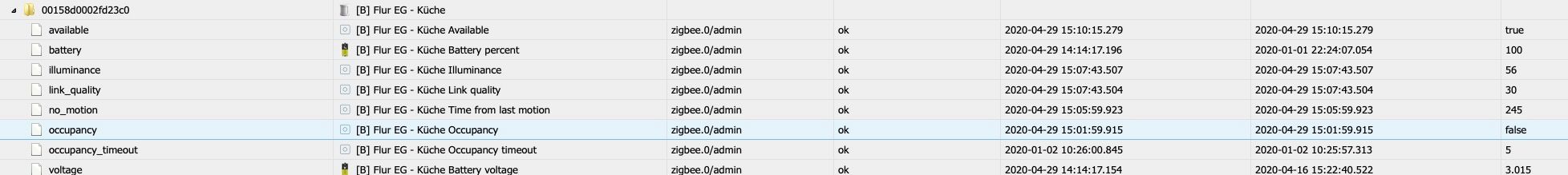

        Hier ein Screenshot von einem dieser Bewegungsmelder:
        Man sieht, dass der Occupancy Wert das letzte mal um 15:01:59 geändert wurde.
        Ich habe aber um 15:07:43 meine Hand vor den Sensor gehalten. Das sieht man bei den Werten "illuminance" und "link_quality"
        Im Log (debug) steht folgendes zu der Zeit:
        2020-04-29 15:07:43.453 - debug: zigbee.0 (15341) handleMessage. {"type":"attributeReport","device":{"ID":28,"_type":"EndDevice","_ieeeAddr":"0x00158d0002fd23c0","_networkAddress":33125,"_manufacturerID":4151,"_endpoints":[{"ID":1,"profileID":260,"deviceID":263,"inputClusters":[0,65535,1030,1024,1280,1,3],"outputClusters":[0,25],"deviceNetworkAddress":33125,"deviceIeeeAddress":"0x00158d0002fd23c0","clusters":{"msIlluminanceMeasurement":{"attributes":{"measuredValue":56}},"msOccupancySensing":{"attributes":{"occupancy":1}},"genBasic":{"attributes":{"65281":{"1":3015,"3":27,"4":12712,"5":29,"6":[0,65537],"10":44156,"11":75,"100":0},"modelId":"lumi.sensor_motion.aq2","appVersion":5}}},"_binds":[]}],"_manufacturerName":"LUMI","_powerSource":"Battery","_modelID":"lumi.sensor_motion.aq2","_applicationVersion":5,"_interviewCompleted":true,"_interviewing":false,"meta":{},"_lastSeen":1588165663453},"endpoint":"[Circular]","data":{"measuredValue":56},"linkquality":30,"groupID":0,"cluster":"msIlluminanceMeasurement","meta":{"zclTransactionSequenceNumber":180,"manufacturerCode":null,"frameControl":{"frameType":0,"manufacturerSpecific":false,"direction":1,"disableDefaultResponse":true}}}
        2020-04-29 15:07:43.454 - debug: zigbee.0 (15341) Received Zigbee message from '0x00158d0002fd23c0', type 'attributeReport', cluster 'msIlluminanceMeasurement', data '{"measuredValue":56}' from endpoint 1 with groupID 0
        2020-04-29 15:07:43.455 - debug: zigbee.0 (15341) Type attributeReport device {"type":"device","device":{"ID":28,"_type":"EndDevice","_ieeeAddr":"0x00158d0002fd23c0","_networkAddress":33125,"_manufacturerID":4151,"_endpoints":[{"ID":1,"profileID":260,"deviceID":263,"inputClusters":[0,65535,1030,1024,1280,1,3],"outputClusters":[0,25],"deviceNetworkAddress":33125,"deviceIeeeAddress":"0x00158d0002fd23c0","clusters":{"msIlluminanceMeasurement":{"attributes":{"measuredValue":56}},"msOccupancySensing":{"attributes":{"occupancy":1}},"genBasic":{"attributes":{"65281":{"1":3015,"3":27,"4":12712,"5":29,"6":[0,65537],"10":44156,"11":75,"100":0},"modelId":"lumi.sensor_motion.aq2","appVersion":5}}},"_binds":[]}],"_manufacturerName":"LUMI","_powerSource":"Battery","_modelID":"lumi.sensor_motion.aq2","_applicationVersion":5,"_interviewCompleted":true,"_interviewing":false,"meta":{},"_lastSeen":1588165663453},"mapped":{"zigbeeModel":["lumi.sensor_motion.aq2"],"model":"RTCGQ11LM","vendor":"Xiaomi","description":"Aqara human body movement and illuminance sensor","supports":"occupancy and illuminance","fromZigbee":[{"cluster":"genBasic","type":["attributeReport","readResponse"]},{"cluster":"msOccupancySensing","type":["attributeReport","readResponse"]},{"cluster":"msIlluminanceMeasurement","type":["attributeReport","readResponse"]},{"cluster":"genBasic","type":["attributeReport","readResponse"]}],"toZigbee":[]},"name":"0x00158d0002fd23c0"} incoming event: {"type":"attributeReport","device":{"ID":28,"_type":"EndDevice","_ieeeAddr":"0x00158d0002fd23c0","_networkAddress":33125,"_manufacturerID":4151,"_endpoints":[{"ID":1,"profileID":260,"deviceID":263,"inputClusters":[0,65535,1030,1024,1280,1,3],"outputClusters":[0,25],"deviceNetworkAddress":33125,"deviceIeeeAddress":"0x00158d0002fd23c0","clusters":{"msIlluminanceMeasurement":{"attributes":{"measuredValue":56}},"msOccupancySensing":{"attributes":{"occupancy":1}},"genBasic":{"attributes":{"65281":{"1":3015,"3":27,"4":12712,"5":29,"6":[0,65537],"10":44156,"11":75,"100":0},"modelId":"lumi.sensor_motion.aq2","appVersion":5}}},"_binds":[]}],"_manufacturerName":"LUMI","_powerSource":"Battery","_modelID":"lumi.sensor_motion.aq2","_applicationVersion":5,"_interviewCompleted":true,"_interviewing":false,"meta":{},"_lastSeen":1588165663453},"endpoint":"[Circular]","data":{"measuredValue":56},"linkquality":30,"groupID":0,"cluster":"msIlluminanceMeasurement","meta":{"zclTransactionSequenceNumber":180,"manufacturerCode":null,"frameControl":{"frameType":0,"manufacturerSpecific":false,"direction":1,"disableDefaultResponse":true}}}
        Bedeutet das "attributes":{"occupancy":1}" nicht das er eine Bewegung erkannt hat? Oder liege ich da falsch?

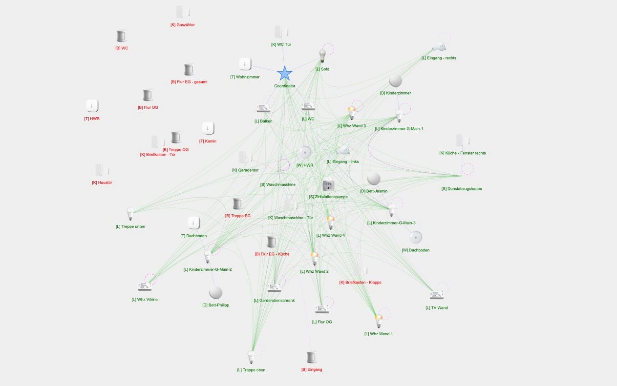

                                            @MichaB Die Netzwerkkarte ist bei mir nicht wirklich zu gebrauchen. Ich habe massenweise Geräte die als Rot und ohne Verbindung angezeigt werden aber wunderbar funktionieren. Habe gestern und vorgestern erst alle Geräte neu angelernt und trotzdem das Problem.
