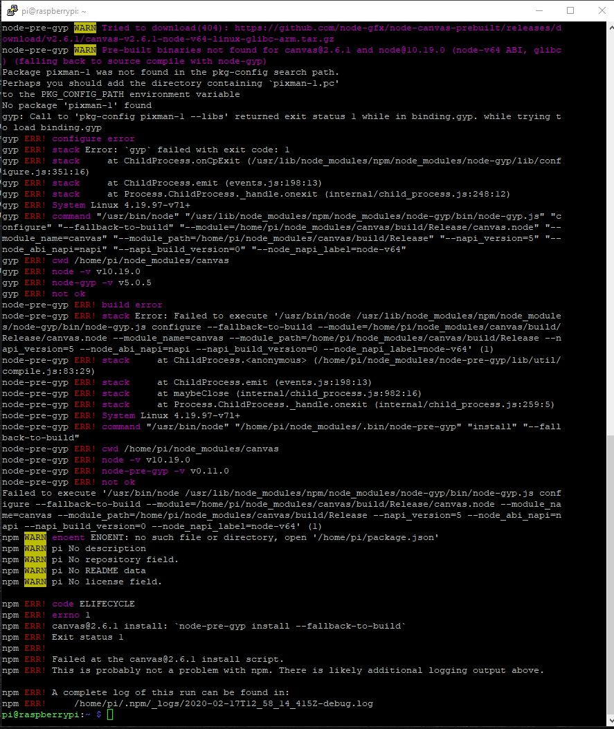

                      pi@raspberrypi:~ $ cd /opt/iobroker
                      pi@raspberrypi:/opt/iobroker $ npm install canvas@2.6.1 --unsafe-perm --production --save --prefix
                      npm WARN invalid config prefix=true
                      npm WARN invalid config Must be a valid filesystem path
                      canvas@2.6.1 install /opt/iobroker/node_modules/canvas
                      node-pre-gyp install --fallback-to-build
                      node-pre-gyp WARN Using request for node-pre-gyp https download
                      node-pre-gyp WARN Tried to download(404): https://github.com/node-gfx/node-canvas-prebuilt/releases/download/v2.6.1/canvas-v2.6.1-node-v64-linux-glibc-arm.tar.gz
                      node-pre-gyp WARN Pre-built binaries not found for canvas@2.6.1 and node@10.19.0 (node-v64 ABI, glibc) (falling back to source compile with node-gyp)
                      Package pixman-1 was not found in the pkg-config search path.
                      Perhaps you should add the directory containing `pixman-1.pc'
                      to the PKG_CONFIG_PATH environment variable
                      No package 'pixman-1' found
                      gyp: Call to 'pkg-config pixman-1 --libs' returned exit status 1 while in binding.gyp. while trying to load binding.gyp
                      gyp ERR! configure error
                      gyp ERR! stack Error: `gyp` failed with exit code: 1
                      gyp ERR! stack     at ChildProcess.onCpExit (/usr/lib/node_modules/npm/node_modules/node-gyp/lib/configure.js:351:16)
                      gyp ERR! stack     at ChildProcess.emit (events.js:198:13)
                      gyp ERR! stack     at Process.ChildProcess._handle.onexit (internal/child_process.js:248:12)
                      gyp ERR! System Linux 4.19.97-v7l+
                      gyp ERR! command "/usr/bin/node" "/usr/lib/node_modules/npm/node_modules/node-gyp/bin/node-gyp.js" "configure" "--fallback-to-build" "--module=/opt/iobroker/node_modules/canvas/build/Release/canvas.node" "--module_name=canvas" "--module_path=/opt/iobroker/node_modules/canvas/build/Release" "--napi_version=5" "--node_abi_napi=napi" "--napi_build_version=0" "--node_napi_label=node-v64"
                      gyp ERR! cwd /opt/iobroker/node_modules/canvas
                      gyp ERR! node -v v10.19.0
                      gyp ERR! node-gyp -v v5.0.5
                      gyp ERR! not ok
                      node-pre-gyp ERR! build error
                      node-pre-gyp ERR! stack Error: Failed to execute '/usr/bin/node /usr/lib/node_modules/npm/node_modules/node-gyp/bin/node-gyp.js configure --fallback-to-build --module=/opt/iobroker/node_modules/canvas/build/Release/canvas.node --module_name=canvas --module_path=/opt/iobroker/node_modules/canvas/build/Release --napi_version=5 --node_abi_napi=napi --napi_build_version=0 --node_napi_label=node-v64' (1)
                      node-pre-gyp ERR! stack     at ChildProcess.<anonymous> (/opt/iobroker/node_modules/canvas/node_modules/node-pre-gyp/lib/util/compile.js:83:29)
                      node-pre-gyp ERR! stack     at ChildProcess.emit (events.js:198:13)
                      node-pre-gyp ERR! stack     at maybeClose (internal/child_process.js:982:16)
                      node-pre-gyp ERR! stack     at Process.ChildProcess._handle.onexit (internal/child_process.js:259:5)
                      node-pre-gyp ERR! System Linux 4.19.97-v7l+
                      node-pre-gyp ERR! command "/usr/bin/node" "/opt/iobroker/node_modules/canvas/node_modules/.bin/node-pre-gyp" "install" "--fallback-to-build"
                      node-pre-gyp ERR! cwd /opt/iobroker/node_modules/canvas
                      node-pre-gyp ERR! node -v v10.19.0
                      node-pre-gyp ERR! node-pre-gyp -v v0.11.0
                      node-pre-gyp ERR! not ok
                      npm WARN ajv-keywords@2.1.1 requires a peer of ajv@^5.0.0 but none is installed. You must install peer dependencies yourself.
                      npm WARN optional SKIPPING OPTIONAL DEPENDENCY: fsevents@2.1.2 (node_modules/fsevents):
                      npm WARN notsup SKIPPING OPTIONAL DEPENDENCY: Unsupported platform for fsevents@2.1.2: wanted {"os":"darwin","arch":"any"} (current: {"os":"linux","arch":"arm"})
                      npm WARN optional SKIPPING OPTIONAL DEPENDENCY: osx-temperature-sensor@1.0.5 (node_modules/osx-temperature-sensor):
                      npm WARN notsup SKIPPING OPTIONAL DEPENDENCY: Unsupported platform for osx-temperature-sensor@1.0.5: wanted {"os":"darwin","arch":"any"} (current: {"os":"linux","arch":"arm"})
                      npm ERR! code ELIFECYCLE
                      npm ERR! errno 1
                      npm ERR! canvas@2.6.1 install: `node-pre-gyp install --fallback-to-build`
                      npm ERR! Exit status 1
                      npm ERR!
                      npm ERR! Failed at the canvas@2.6.1 install script.
                      npm ERR! This is probably not a problem with npm. There is likely additional logging output above.
                      npm ERR! A complete log of this run can be found in:

                                  • OliverIO
                                    OliverIO last edited by OliverIO
                                    Das Modul ist deswegen nicht da, weil es nicht installiert werden kann. Ich bin den Issue nur mal drübergeflogen, aber es scheinen Bedingungen zu geben, die davon wieder abhängige Pakete nicht richtig kompilieren lassen.
                                    Man braucht nicht immer davon ausgehen, das alle Pakete Fehlerfrei sind
                                    Ich hab mir dein log nochmal angeschaut.
                                    Hier versucht er eine ein vorkompiliertes Paket runterzuladen, welches aber für deine Architektur (arm) nicht gibt.
                                    Deswegen will er es selbst kompilieren.
                                    Das scheitert aber daran, das ein anderes notwendige Paket nicht richtig konfiguriert wurde
                                    Perhaps you should add the directory containing pixman-1.pc' to the PKG_CONFIG_PATH environment variable No package 'pixman-1' found gyp: Call to 'pkg-config pixman-1 --libs' returned exit status 1 while in binding.gyp. while trying to load binding.gyp gyp ERR! configure error gyp ERR! stack Error:gyp` failed with exit code: 1
                                    Alles andere sind Folgefehler.
                                    Lese dir den oben verlinkten Issue bei canvas auf github durch, da stehen evtl. Fehlerbehebungsmöglichkeiten drin.

                                          javascript.0	2020-02-17 22:29:12.974	info	(25026) CXX(target) Release/obj.target/canvas/src/register_font.o
                                          javascript.0	2020-02-17 22:29:12.727	error	(25026) /home/iobroker/.cache/node-gyp/10.19.0/include/node/v8.h: In instantiation of ‘void v8::PersistentBase<T>::SetWeak(P*, typename v8::WeakCallbackInfo<P>::Callback, v8::WeakCallbackType) [with P
                                          javascript.0	2020-02-17 22:29:12.703	error	(25026) In file included from /home/iobroker/.cache/node-gyp/10.19.0/include/node/node.h:63, from ../../nan/nan.h:54, from ../src/backend/Backend.h:6,
                                          javascript.0	2020-02-17 22:29:12.637	error	(25026) In file included from ../../nan/nan.h:54, from ../src/backend/Backend.h:6, from ../src/Backends.h:3, from ../src/init.cc:17: ../src/init.cc:
                                          javascript.0	2020-02-17 22:29:12.355	error	(25026) In file included from ../src/backend/Backend.h:6, from ../src/Backends.h:3, from ../src/init.cc:17: ../../nan/nan.h: In function ‘void Nan::AsyncQueueWorker(N
                                          javascript.0	2020-02-17 22:29:10.650	info	(25026) CXX(target) Release/obj.target/canvas/src/init.o
                                          javascript.0	2020-02-17 22:29:09.784	error	(25026) /home/iobroker/.cache/node-gyp/10.19.0/include/node/v8.h: In instantiation of ‘void v8::PersistentBase<T>::SetWeak(P*, typename v8::WeakCallbackInfo<P>::Callback, v8::WeakCallbackType) [with P
                                          javascript.0	2020-02-17 22:29:09.758	error	(25026) In file included from /home/iobroker/.cache/node-gyp/10.19.0/include/node/node.h:63, from ../../nan/nan.h:54, from ../src/ImageData.h:5, from
                                          javascript.0	2020-02-17 22:29:09.637	error	(25026) In file included from ../src/ImageData.h:5, from ../src/ImageData.cc:3: ../../nan/nan.h: In function ‘void Nan::AsyncQueueWorker(Nan::AsyncWorker*)’: ../../nan/nan.h:2298:62:
                                          javascript.0	2020-02-17 22:29:08.279	info	(25026) CXX(target) Release/obj.target/canvas/src/ImageData.o
                                          javascript.0	2020-02-17 22:29:05.953	error	(25026) /home/iobroker/.cache/node-gyp/10.19.0/include/node/v8.h: In instantiation of ‘void v8::PersistentBase<T>::SetWeak(P*, typename v8::WeakCallbackInfo<P>::Callback, v8::WeakCallbackType) [with P
                                          javascript.0	2020-02-17 22:29:05.928	error	(25026) In file included from /home/iobroker/.cache/node-gyp/10.19.0/include/node/node.h:63, from ../../nan/nan.h:54, from ../src/Image.h:8, from ../
                                          javascript.0	2020-02-17 22:29:05.497	error	(25026) In file included from ../src/Image.h:8, from ../src/Image.cc:3: ../../nan/nan.h: In function ‘void Nan::AsyncQueueWorker(Nan::AsyncWorker*)’: ../../nan/nan.h:2298:62: warning:
                                          javascript.0	2020-02-17 22:29:03.978	info	(25026) CXX(target) Release/obj.target/canvas/src/Image.o
                                          javascript.0	2020-02-17 22:29:01.377	info	(25026) CXX(target) Release/obj.target/canvas/src/color.o
                                          javascript.0	2020-02-17 22:29:01.090	error	(25026) /home/iobroker/.cache/node-gyp/10.19.0/include/node/v8.h: In instantiation of ‘void v8::PersistentBase<T>::SetWeak(P*, typename v8::WeakCallbackInfo<P>::Callback, v8::WeakCallbackType) [with P
                                          javascript.0	2020-02-17 22:29:01.065	error	(25026) In file included from /home/iobroker/.cache/node-gyp/10.19.0/include/node/node.h:63, from ../../nan/nan.h:54, from ../src/backend/Backend.h:6,
                                          javascript.0	2020-02-17 22:29:00.818	error	(25026) In file included from ../src/backend/Backend.h:6, from ../src/Canvas.h:5, from ../src/closure.h:5, from ../src/closure.cc:1: ../../nan/nan.h:
                                          javascript.0	2020-02-17 22:28:59.388	info	(25026) CXX(target) Release/obj.target/canvas/src/closure.o
                                          javascript.0	2020-02-17 22:28:53.929	error	(25026) /home/iobroker/.cache/node-gyp/10.19.0/include/node/v8.h: In instantiation of ‘void v8::PersistentBase<T>::SetWeak(P*, typename v8::WeakCallbackInfo<P>::Callback, v8::WeakCallbackType) [with P
                                          javascript.0	2020-02-17 22:28:53.904	error	(25026) In file included from /home/iobroker/.cache/node-gyp/10.19.0/include/node/node.h:63, from ../../nan/nan.h:54, from ../src/backend/Backend.h:6,
                                          javascript.0	2020-02-17 22:28:53.073	error	(25026) In file included from ../src/backend/Backend.h:6, from ../src/Canvas.h:5, from ../src/CanvasRenderingContext2d.h:6, from ../src/CanvasRenderi
                                          javascript.0	2020-02-17 22:28:51.414	info	(25026) CXX(target) Release/obj.target/canvas/src/CanvasRenderingContext2d.o
                                          javascript.0	2020-02-17 22:28:49.605	error	(25026) /home/iobroker/.cache/node-gyp/10.19.0/include/node/v8.h: In instantiation of ‘void v8::PersistentBase<T>::SetWeak(P*, typename v8::WeakCallbackInfo<P>::Callback, v8::WeakCallbackType) [with P
                                          javascript.0	2020-02-17 22:28:49.580	error	(25026) In file included from /home/iobroker/.cache/node-gyp/10.19.0/include/node/node.h:63, from ../../nan/nan.h:54, from ../src/CanvasPattern.h:6,
                                          javascript.0	2020-02-17 22:28:49.154	error	(25026) In file included from ../src/CanvasPattern.h:6, from ../src/CanvasPattern.cc:3: ../../nan/nan.h: In function ‘void Nan::AsyncQueueWorker(Nan::AsyncWorker*)’: ../../nan/nan.h:2
                                          javascript.0	2020-02-17 22:28:47.637	info	(25026) CXX(target) Release/obj.target/canvas/src/CanvasPattern.o
                                          javascript.0	2020-02-17 22:28:46.877	error	(25026) /home/iobroker/.cache/node-gyp/10.19.0/include/node/v8.h: In instantiation of ‘void v8::PersistentBase<T>::SetWeak(P*, typename v8::WeakCallbackInfo<P>::Callback, v8::WeakCallbackType) [with P
                                          javascript.0	2020-02-17 22:28:46.853	error	(25026) In file included from /home/iobroker/.cache/node-gyp/10.19.0/include/node/node.h:63, from ../../nan/nan.h:54, from ../src/CanvasGradient.h:5,
                                          javascript.0	2020-02-17 22:28:46.616	error	(25026) In file included from ../src/CanvasGradient.h:5, from ../src/CanvasGradient.cc:3: ../../nan/nan.h: In function ‘void Nan::AsyncQueueWorker(Nan::AsyncWorker*)’: ../../nan/nan.h
                                          javascript.0	2020-02-17 22:28:45.219	info	(25026) CXX(target) Release/obj.target/canvas/src/CanvasGradient.o
                                          javascript.0	2020-02-17 22:28:40.846	error	(25026) /home/iobroker/.cache/node-gyp/10.19.0/include/node/v8.h: In instantiation of ‘void v8::PersistentBase<T>::SetWeak(P*, typename v8::WeakCallbackInfo<P>::Callback, v8::WeakCallbackType) [with P
                                          javascript.0	2020-02-17 22:28:40.822	error	(25026) In file included from /home/iobroker/.cache/node-gyp/10.19.0/include/node/node.h:63, from ../../nan/nan.h:54, from ../src/backend/Backend.h:6,
                                          javascript.0	2020-02-17 22:28:40.695	error	(25026) ../src/Canvas.cc:520:80: warning: cast between incompatible function types from ‘void (*)(uv_work_t*)’ {aka ‘void (*)(uv_work_s*)’} to ‘uv_after_work_cb’ {aka ‘void (*)(uv_work_s*, int)’} [-Wc
                                          javascript.0	2020-02-17 22:28:40.692	error	(25026) ../src/Canvas.cc:479:79: warning: cast between incompatible function types from ‘void (*)(uv_work_t*)’ {aka ‘void (*)(uv_work_s*)’} to ‘uv_after_work_cb’ {aka ‘void (*)(uv_work_s*, int)’} [-Wc
                                          javascript.0	2020-02-17 22:28:40.687	error	(25026) ../src/Canvas.cc: In static member function ‘static Nan::NAN_METHOD_RETURN_TYPE Canvas::ToBuffer(Nan::NAN_METHOD_ARGS_TYPE)’: ../src/Canvas.cc:415:26: warning: comparison of integer expression
                                          javascript.0	2020-02-17 22:28:40.042	error	(25026) In file included from ../src/backend/Backend.h:6, from ../src/Canvas.h:5, from ../src/Canvas.cc:3: ../../nan/nan.h: In function ‘void Nan::AsyncQueueWorker(Na
                                          javascript.0	2020-02-17 22:28:38.490	info	(25026) CXX(target) Release/obj.target/canvas/src/Canvas.o
                                          javascript.0	2020-02-17 22:28:38.258	error	(25026) /home/iobroker/.cache/node-gyp/10.19.0/include/node/v8.h: In instantiation of ‘void v8::PersistentBase<T>::SetWeak(P*, typename v8::WeakCallbackInfo<P>::Callback, v8::WeakCallbackType) [with P
                                          javascript.0	2020-02-17 22:28:38.234	error	(25026) In file included from /home/iobroker/.cache/node-gyp/10.19.0/include/node/node.h:63, from ../../nan/nan.h:54, from ../src/backend/Backend.h:6,
                                          javascript.0	2020-02-17 22:28:37.986	error	(25026) In file included from ../src/backend/Backend.h:6, from ../src/Backends.h:3, from ../src/Backends.cc:1: ../../nan/nan.h: In function ‘void Nan::AsyncQueueWorke
                                          javascript.0	2020-02-17 22:28:36.542	info	(25026) CXX(target) Release/obj.target/canvas/src/Backends.o
                                          javascript.0	2020-02-17 22:28:34.585	error	(25026) ../src/bmp/BMPParser.cc:204:27: warning: comparison of integer expressions of different signedness: ‘uint32_t’ {aka ‘unsigned int’} and ‘int’ [-Wsign-compare] E(ptr - data + imgdSize > len,
                                          javascript.0	2020-02-17 22:28:34.584	error	(25026) ../src/bmp/BMPParser.cc: In member function ‘void BMPParser::Parser::parse(uint8_t*, int, uint8_t*)’: ../src/bmp/BMPParser.cc:189:16: warning: comparison of integer expressions of different si
                                          javascript.0	2020-02-17 22:28:34.150	info	(25026) CXX(target) Release/obj.target/canvas/src/bmp/BMPParser.o
                                          javascript.0	2020-02-17 22:28:33.561	error	(25026) /home/iobroker/.cache/node-gyp/10.19.0/include/node/v8.h: In instantiation of ‘void v8::PersistentBase<T>::SetWeak(P*, typename v8::WeakCallbackInfo<P>::Callback, v8::WeakCallbackType) [with P
                                          javascript.0	2020-02-17 22:28:33.537	error	(25026) In file included from /home/iobroker/.cache/node-gyp/10.19.0/include/node/node.h:63, from ../../nan/nan.h:54, from ../src/backend/Backend.h:6,
                                          javascript.0	2020-02-17 22:28:33.216	error	(25026) In file included from ../src/backend/Backend.h:6, from ../src/backend/SvgBackend.h:3, from ../src/backend/SvgBackend.cc:1: ../../nan/nan.h: In function ‘void
                                          javascript.0	2020-02-17 22:28:31.739	info	(25026) CXX(target) Release/obj.target/canvas/src/backend/SvgBackend.o
                                          javascript.0	2020-02-17 22:28:31.164	error	(25026) /home/iobroker/.cache/node-gyp/10.19.0/include/node/v8.h: In instantiation of ‘void v8::PersistentBase<T>::SetWeak(P*, typename v8::WeakCallbackInfo<P>::Callback, v8::WeakCallbackType) [with P
                                          javascript.0	2020-02-17 22:28:31.140	error	(25026) In file included from /home/iobroker/.cache/node-gyp/10.19.0/include/node/node.h:63, from ../../nan/nan.h:54, from ../src/backend/Backend.h:6,
                                          javascript.0	2020-02-17 22:28:30.890	error	(25026) In file included from ../src/backend/Backend.h:6, from ../src/backend/PdfBackend.h:3, from ../src/backend/PdfBackend.cc:1: ../../nan/nan.h: In function ‘void
                                          javascript.0	2020-02-17 22:28:29.464	info	(25026) CXX(target) Release/obj.target/canvas/src/backend/PdfBackend.o
                                          javascript.0	2020-02-17 22:28:29.008	error	(25026) /home/iobroker/.cache/node-gyp/10.19.0/include/node/v8.h: In instantiation of ‘void v8::PersistentBase<T>::SetWeak(P*, typename v8::WeakCallbackInfo<P>::Callback, v8::WeakCallbackType) [with P
                                          javascript.0	2020-02-17 22:28:28.983	error	(25026) In file included from /home/iobroker/.cache/node-gyp/10.19.0/include/node/node.h:63, from ../../nan/nan.h:54, from ../src/backend/Backend.h:6,
                                          javascript.0	2020-02-17 22:28:28.872	error	(25026) In file included from ../src/backend/Backend.h:6, from ../src/backend/ImageBackend.h:3, from ../src/backend/ImageBackend.cc:1: ../../nan/nan.h: In function ‘v
                                          javascript.0	2020-02-17 22:28:27.496	info	(25026) CXX(target) Release/obj.target/canvas/src/backend/ImageBackend.o
                                          javascript.0	2020-02-17 22:28:26.952	error	(25026) /home/iobroker/.cache/node-gyp/10.19.0/include/node/v8.h: In instantiation of ‘void v8::PersistentBase<T>::SetWeak(P*, typename v8::WeakCallbackInfo<P>::Callback, v8::WeakCallbackType) [with P
                                          javascript.0	2020-02-17 22:28:26.928	error	(25026) In file included from /home/iobroker/.cache/node-gyp/10.19.0/include/node/node.h:63, from ../../nan/nan.h:54, from ../src/backend/Backend.h:6,
                                          javascript.0	2020-02-17 22:28:26.817	error	(25026) In file included from ../src/backend/Backend.h:6, from ../src/backend/Backend.cc:1: ../../nan/nan.h: In function ‘void Nan::AsyncQueueWorker(Nan::AsyncWorker*)’: ../../nan/nan
                                          javascript.0	2020-02-17 22:28:25.425	info	(25026) CXX(target) Release/obj.target/canvas/src/backend/Backend.o
                                          javascript.0	2020-02-17 22:28:25.407	info	(25026) COPY Release/canvas-postbuild.node
                                          javascript.0	2020-02-17 22:28:25.199	info	(25026) SOLINK_MODULE(target) Release/obj.target/canvas-postbuild.node
                                          javascript.0	2020-02-17 22:28:25.196	info	(25026) make: Verzeichnis „/opt/iobroker/node_modules/iobroker.javascript/node_modules/canvas/build“ wird betreten
                                          javascript.0	2020-02-17 22:28:22.309	error	(25026) WARN Tried to download(404): https://github.com/node-gfx/node-canvas-prebuilt/releases/download/v2.6.1/canvas-v2.6.1-node-v64-linux-glibc-arm.tar.gz node-pre-gyp WARN Pre-built binaries not
                                          javascript.0	2020-02-17 22:28:22.308	error	(25026) node-pre-gyp
                                          javascript.0	2020-02-17 22:28:21.914	error	(25026) WARN Using request for node-pre-gyp https download
                                          javascript.0	2020-02-17 22:28:21.913	error	(25026)
                                          javascript.0	2020-02-17 22:28:21.911	error	(25026) node-pre-gyp
                                          javascript.0	2020-02-17 22:28:21.138	info	(25026) > canvas@2.6.1 install /opt/iobroker/node_modules/iobroker.javascript/node_modules/canvas > node-pre-gyp install --fallback-to-build
                                          javascript.0	2020-02-17 22:28:13.277	info	(25026) npm install canvas --production --prefix "/opt/iobroker/node_modules/iobroker.javascript" (System call)
                                          javascript.0	2020-02-17 22:28:13.186	info	(25026) found 0 vulnerabilities
                                          javascript.0	2020-02-17 22:28:13.183	info	(25026) 1 package is looking for funding run `npm fund` for details
                                          javascript.0	2020-02-17 22:28:13.153	info	(25026) + xmlhttprequest@1.8.0 added 9 packages from 33 contributors and audited 12 packages in 1.729s
                                          javascript.0	2020-02-17 22:28:04.148	info	(1523) Terminated (START_IMMEDIATELY_AFTER_STOP): Without reason
                                          javascript.0	2020-02-17 22:28:04.147	info	(1523) terminating
                                          javascript.0	2020-02-17 22:28:04.145	info	(1523) Stop script script.js.Xiaomi.AqaraCube
                                          javascript.0	2020-02-17 22:28:04.142	info	(1523) Got terminate signal TERMINATE_YOURSELF
