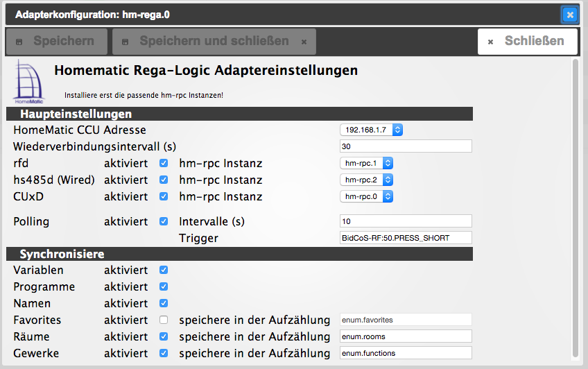

      Hallo Leute,
      Ich habe gestern meinen hm- rega adapter auf die neueste Version (1.2.1) upgedated und bekomm ihn nun nicht mehr zum laufen. im Log wird folgende meldung ausgegeben (die kann ich leider als Neuling gar nicht interpretieren).
      host-ioBroker 2016-07-26 03:48:03.510 info Restart adapter system.adapter.hm-rega.0 because enabled
      host-ioBroker 2016-07-26 03:48:03.509 error instance system.adapter.hm-rega.0 terminated with code 0 (OK)
      hm-rega-0 2016-07-26 03:48:03.483 info terminating
      Error: 2016-07-26 03:48:03.356 error at Function.Module._load (module.js:312:12)
      Error: 2016-07-26 03:48:03.356 error at Module.load (module.js:356:32)
      Error: 2016-07-26 03:48:03.356 error at Object.Module._extensions..js (module.js:474:10)
      Error: 2016-07-26 03:48:03.356 error at Module._compile (module.js:456:26)
      Error: 2016-07-26 03:48:03.356 error at Object. (/opt/iobroker/node_modules/iobroker.hm-rega/node_modules/xml2js/node_modules/xmlbuilder/lib/index.js:14:4)
      Error: 2016-07-26 03:48:03.356 error at Object. (/opt/iobroker/node_modules/iobroker.hm-rega/node_modules/xml2js/node_modules/xmlbuilder/lib/index.js:5:12)
      Error: 2016-07-26 03:48:03.356 error at require (module.js:380:17)
      Error: 2016-07-26 03:48:03.356 error at Module.require (module.js:364:17)
      Error: 2016-07-26 03:48:03.356 error at Function.Module._load (module.js:280:25)
      Error: 2016-07-26 03:48:03.356 error at Function.Module._resolveFilename (module.js:338:15)
      Error: 2016-07-26 03:48:03.356 error Cannot find module 'lodash/assign'
      uncaught 2016-07-26 03:48:03.352 error exception: Cannot find module 'lodash/assign'
      hm-rega-0 2016-07-26 03:48:03.250 info subscribe hm-rpc.1.BidCoS-RF.50.PRESS_SHORT
      hm-rega-0 2016-07-26 03:48:03.208 info starting. Version 1.2.1 in /opt/iobroker/node_modules/iobroker.hm-rega
      host-ioBroker 2016-07-26 03:48:01.208 info instance system.adapter.hm-rega.0 started with pid 13878
      host-ioBroker 2016-07-26 03:48:01.173 info object change system.adapter.hm-rega.0
      Ich habe den Adapter schon mehrfach gelöscht und neu installiert, hat aber auch nichts gebracht.
      Hier findet ihr auch noch einen screenshot von den aktuellen Einstellungen des Adapters
      Kann ich den adapter sonst gegebenen falles auch wieder downgraden?
      Danke schonmal für die Hilfe!
