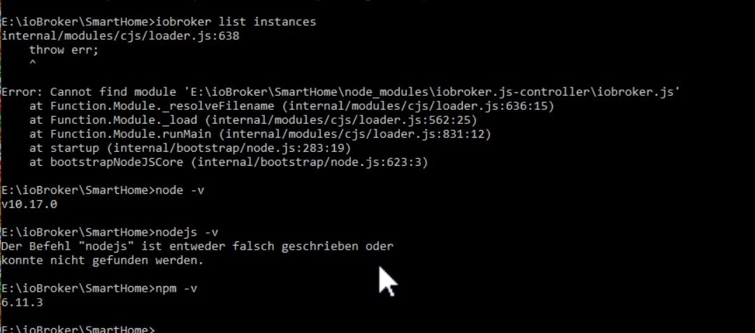

        @chhe
        Was kommt bei:
        \ioBroker\SmartHome
        iobroker list instances
        node -v
        nodejs -v
        npm -v

            Das Update war offensichtlich auch nicht erfolgreich. NPM hat ja immer noch Version 10.17

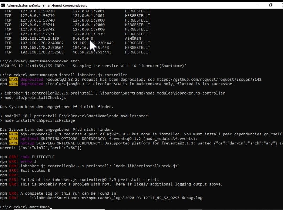

                Beim Versuch den js-controller zu updaten erhalte ich folgende Meldungen:
                • C
                  chhe last edited by

                  1. Versuch js-controller neu zu installieren:
                  E:\ioBroker\SmartHome>npm install iobroker.js-controller
                  npm WARN deprecated request@2.88.2: request has been deprecated, see https://github.com/request/request/issues/3142
                  npm WARN deprecated circular-json@0.3.3: CircularJSON is in maintenance only, flatted is its successor.
                  > iobroker.js-controller@2.2.9 preinstall E:\ioBroker\SmartHome\node_modules\iobroker.js-controller
                  > node lib/preinstallCheck.js
                  Das System kann den angegebenen Pfad nicht finden.
                  npm WARN ajv-keywords@2.1.1 requires a peer of ajv@^5.0.0 but none is installed. You must install peer dependencies yourself.
                  npm WARN optional SKIPPING OPTIONAL DEPENDENCY: fsevents@2.1.2 (node_modules\fsevents):
                  npm WARN notsup SKIPPING OPTIONAL DEPENDENCY: Unsupported platform for fsevents@2.1.2: wanted {"os":"darwin","arch":"any"} (current: {"os":"win32","arch":"x64"})
                  npm ERR! code ELIFECYCLE
                  npm ERR! errno 3
                  npm ERR! iobroker.js-controller@2.2.9 preinstall: `node lib/preinstallCheck.js`
                  npm ERR! Exit status 3
                  npm ERR!
                  npm ERR! Failed at the iobroker.js-controller@2.2.9 preinstall script.
                  npm ERR! This is probably not a problem with npm. There is likely additional logging output above.
                  npm ERR! A complete log of this run can be found in:
                  npm ERR!     E:\ioBroker\SmartHome\env\npm-cache\_logs\2020-03-12T14_42_58_452Z-debug.log
