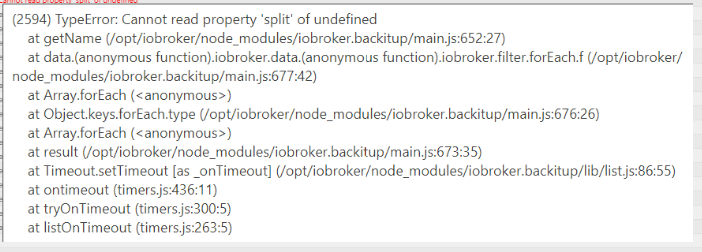

      Hallo, ich habe seit dem 29.03 nach einem Update auf die Version 1.4.5 ein Problem mit dem Backitup-Adapter.
      Ich bekomme im Log folgende Fehler sobald ich auf mein NAS zugreifen möchte. Egal ob ich es als NAS konfiguriere, oder über FTP versuche.
      host.raspberrypi	2020-03-30 11:28:35.711	error	Caught by controller[0]: at listOnTimeout (timers.js:263:5)
      host.raspberrypi	2020-03-30 11:28:35.709	error	Caught by controller[0]: at tryOnTimeout (timers.js:300:5)
      host.raspberrypi	2020-03-30 11:28:35.708	error	Caught by controller[0]: at ontimeout (timers.js:436:11)
      host.raspberrypi	2020-03-30 11:28:35.708	error	Caught by controller[0]: at Timeout.setTimeout [as _onTimeout] (/opt/iobroker/node_modules/iobroker.backitup/lib/list.js:86:55)
      host.raspberrypi	2020-03-30 11:28:35.708	error	Caught by controller[0]: at result (/opt/iobroker/node_modules/iobroker.backitup/main.js:673:35)
      host.raspberrypi	2020-03-30 11:28:35.707	error	Caught by controller[0]: at Array.forEach (<anonymous>)
      host.raspberrypi	2020-03-30 11:28:35.707	error	Caught by controller[0]: at Object.keys.forEach.type (/opt/iobroker/node_modules/iobroker.backitup/main.js:676:26)
      host.raspberrypi	2020-03-30 11:28:35.706	error	Caught by controller[0]: at data.(anonymous function).iobroker.data.(anonymous function).iobroker.filter.forEach.f (/opt/iobroker/node_modules/iobroker.backitup/main.js:677:42)
      host.raspberrypi	2020-03-30 11:28:35.706	error	Caught by controller[0]: at getName (/opt/iobroker/node_modules/iobroker.backitup/main.js:652:27)
      host.raspberrypi	2020-03-30 11:28:35.705	error	Caught by controller[0]: TypeError: Cannot read property 'split' of undefined
      backitup.0	2020-03-30 11:28:34.880	info	(26954) Terminated (NO_ERROR): Without reason
      backitup.0	2020-03-30 11:28:34.878	info	(26954) terminating
      backitup.0	2020-03-30 11:28:34.863	info	(26954) cleaned everything up...
      backitup.0	2020-03-30 11:28:34.860	error	(26954) TypeError: Cannot read property 'split' of undefined at getName (/opt/iobroker/node_modules/iobroker.backitup/main.js:652:27) at data.(anonymous function).iobroker.data.(anonymous func
      backitup.0	2020-03-30 11:28:34.858	error	(26954) uncaught exception: Cannot read property 'split' of undefined
      backitup.0	2020-03-30 11:28:32.573	info	(26954) [ccu] backup was activated at 01:00 every 5 day(s)
      backitup.0	2020-03-30 11:28:32.558	info	(26954) [iobroker] backup was activated at 03:00 every 2 day(s)
      backitup.0	2020-03-30 11:28:32.489	info	(26954) starting. Version 1.4.5 in /opt/iobroker/node_modules/iobroker.backitup, node: v10.19.0
      Ich habe am 29.03 ein update vom Adapter gemacht. Direkt nach dem Update hat der Fehler begonnen. Ein Downgrade auf die alte Version bringt aber auch nichts.
      Backups auf den Internen Backupordner funktionieren ohne Probleme.

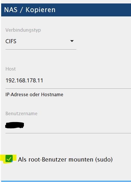

        • Bastelritius
          Bastelritius @simatec last edited by
          @simatec: Das wäre aber seltsam. Bis zum Update hat alles funktioniert. Es sei denn es wurde an der Config etwas geändert zwischen beiden Versionen.
          Woran erkennst Du, das es ein Fehler in der NAS Config ist? Wenn iobroker das NAS nicht mounten kann würde doch diese Fehlermeldung kommen:
          2787) Error: Command failed: sudo mount -t cifs -o username=RasPi,password=****,rw,file_mode=0777,dir_mode=0777 //192.168.178.21/iobroker /opt/iobroker/backups mount error(2): No such file or directo....
          Dieser Fehler kommt aber nicht.
          Der beschriebene Fehler kommt ja auch wenn ich auf einen FTP zugreifen möchte.

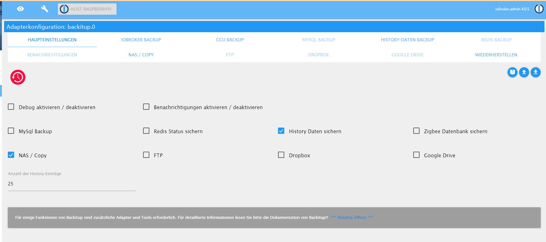

            • Bastelritius
              Meinst Du das?

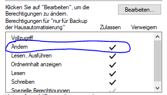

                        simatec Developer Most Active @Bastelritius last edited by
                        @Bastelritius
                        Dann ist da anscheinend irgendwas mit deinem NAS nicht ok. Kann der User eventuell nicht auf deinem NAS lesen? Das könnte den Fehler erklären

                            • Bastelritius
                              @simatec: wie gesagt, ich habe nichts verändert und vor dem Upgrade hat es funktioniert. Wenn ich das NAS manuell mounte mit dem selben Benutzer kann ich darauf lesen und schreiben. Am Benutzer mit dem ich mich am NAS anmelde kann es also nicht liegen. Kann mit den Berechtigungen auf meinem RasPi irgendwas passiert sein. Wie kann ich das kontrollieren?
