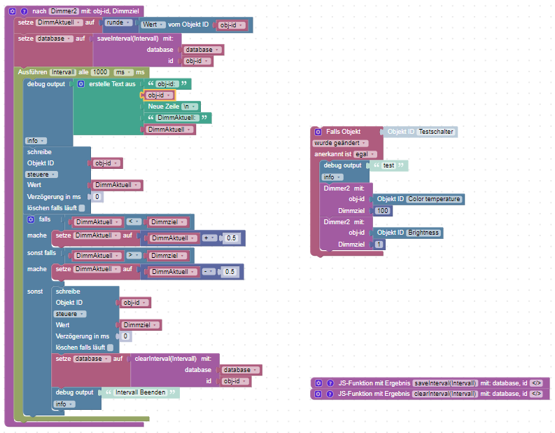

        azmo @ticaki last edited by
        @ticaki
        Na dann danke dass du uns deine Zeit schenkst 🙂

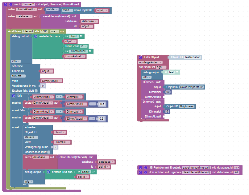

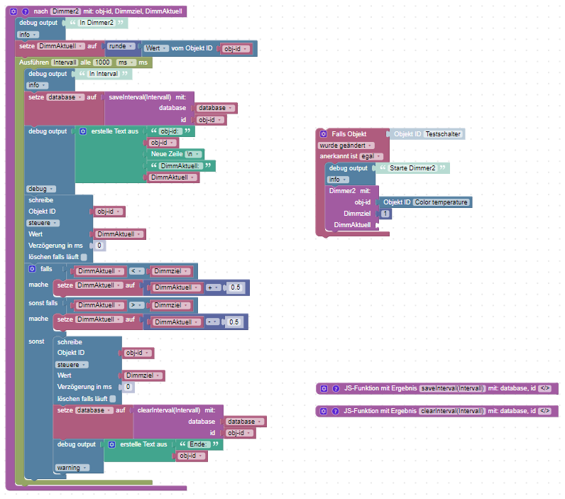

        var obj_id, Dimmziel, DimmAktuell, database, id, Intervall;
         * Beschreibe diese Funktion …
        function Dimmer2(obj_id, Dimmziel, DimmAktuell) {
          DimmAktuell = Math.round(getState(obj_id).val);
          database = saveInterval_Intervall_(database, obj_id);
          Intervall = setInterval(function () {
            console.log((['obj-id: ',obj_id,'\n','DimmAktuell: ',DimmAktuell].join('')));
            setStateDelayed(obj_id, DimmAktuell, false, parseInt(0, 10), false);
            if (DimmAktuell < Dimmziel) {
              DimmAktuell = DimmAktuell + 0.5;
            } else if (DimmAktuell > Dimmziel) {
              DimmAktuell = DimmAktuell - 0.5;
            } else {
              setStateDelayed(obj_id, Dimmziel, false, parseInt(0, 10), false);
              database = clearInterval_Intervall_(database, obj_id);
              console.log(('Ende: ' + String(obj_id)));
          }, 1000);
        function saveInterval_Intervall_(database, id) {
            if (database === undefined) database = {};
            database[id] = Intervall;
            return database;
        function clearInterval_Intervall_(database, id) {
            if (database === undefined) return {};
            if (database[id] === undefined) return database;
            if (database[id]) {
                clearInterval(database[id]);
                database[id] = null;
            return database;
        on({id: '0_userdata.0.Eigene_Datenpunkte.Testschalter', change: "ne"}, function (obj) {
          var value = obj.state.val;
          console.log('test');
          Dimmer2('tradfri.0.L-65546.lightbulb.colorTemperature', 90, null);
          Dimmer2('tradfri.0.L-65546.lightbulb.brightness', 5, null);
        //JTNDeG1sJTIweG1sbnMlM0QlMjJodHRwJTNBJTJGJTJGd3d3LnczLm9yZyUyRjE5OTklMkZ4aHRtbCUyMiUzRSUzQ3ZhcmlhYmxlcyUzRSUzQ3ZhcmlhYmxlJTIwdHlwZSUzRCUyMiUyMiUyMGlkJTNEJTIyJTNEV19wJTJDJTVCb3QlNUUoYWpJeTBOYW01JTdEJTIyJTNFb2JqLWlkJTNDJTJGdmFyaWFibGUlM0UlM0N2YXJpYWJsZSUyMHR5cGUlM0QlMjIlMjIlMjBpZCUzRCUyMnB3VyU1RG1tfjE2QUp3dmFCJTJGak1wcCUyMiUzRURpbW16aWVsJTNDJTJGdmFyaWFibGUlM0UlM0N2YXJpYWJsZSUyMHR5cGUlM0QlMjIlMjIlMjBpZCUzRCUyMiUyRjNhakUzVi0lN0NuQlIxISUzQkdiSzFhJTIyJTNFRGltbUFrdHVlbGwlM0MlMkZ2YXJpYWJsZSUzRSUzQ3ZhcmlhYmxlJTIwdHlwZSUzRCUyMiUyMiUyMGlkJTNEJTIyb19qTjFhJTVEOEVqOS5VJTIzRW9PMCl6JTIyJTNFZGF0YWJhc2UlM0MlMkZ2YXJpYWJsZSUzRSUzQ3ZhcmlhYmxlJTIwdHlwZSUzRCUyMiUyMiUyMGlkJTNEJTIyLnFRMjdnJTQwYyU3QiUyQ3ZwJTIzLlJ2QVolMjN5JTIyJTNFaWQlM0MlMkZ2YXJpYWJsZSUzRSUzQ3ZhcmlhYmxlJTIwdHlwZSUzRCUyMnVuZGVmaW5lZCUyMiUyMGlkJTNEJTIySW50ZXJ2YWxsJTIyJTNFSW50ZXJ2YWxsJTNDJTJGdmFyaWFibGUlM0UlM0MlMkZ2YXJpYWJsZXMlM0UlM0NibG9jayUyMHR5cGUlM0QlMjJwcm9jZWR1cmVzX2RlZm5vcmV0dXJuJTIyJTIwaWQlM0QlMjJNNiU3QzhPNHhyMiU1RSU3Q3NFQ3oqfmUlMkJEJTIyJTIweCUzRCUyMi04MzclMjIlMjB5JTNEJTIyLTQxMzglMjIlM0UlM0NtdXRhdGlvbiUzRSUzQ2FyZyUyMG5hbWUlM0QlMjJvYmotaWQlMjIlMjB2YXJpZCUzRCUyMiUzRFdfcCUyQyU1Qm90JTVFKGFqSXkwTmFtNSU3RCUyMiUzRSUzQyUyRmFyZyUzRSUzQ2FyZyUyMG5hbWUlM0QlMjJEaW1temllbCUyMiUyMHZhcmlkJTNEJTIycHdXJTVEbW1+MTZBSnd2YUIlMkZqTXBwJTIyJTNFJTNDJTJGYXJnJTNFJTNDYXJnJTIwbmFtZSUzRCUyMkRpbW1Ba3R1ZWxsJTIyJTIwdmFyaWQlM0QlMjIlMkYzYWpFM1YtJTdDbkJSMSElM0JHYksxYSUyMiUzRSUzQyUyRmFyZyUzRSUzQyUyRm11dGF0aW9uJTNFJTNDZmllbGQlMjBuYW1lJTNEJTIyTkFNRSUyMiUzRURpbW1lcjIlM0MlMkZmaWVsZCUzRSUzQ2NvbW1lbnQlMjBwaW5uZWQlM0QlMjJmYWxzZSUyMiUyMGglM0QlMjI4MCUyMiUyMHclM0QlMjIxNjAlMjIlM0VCZXNjaHJlaWJlJTIwZGllc2UlMjBGdW5rdGlvbiUyMCVFMiU4MCVBNiUzQyUyRmNvbW1lbnQlM0UlM0NzdGF0ZW1lbnQlMjBuYW1lJTNEJTIyU1RBQ0slMjIlM0UlM0NibG9jayUyMHR5cGUlM0QlMjJ2YXJpYWJsZXNfc2V0JTIyJTIwaWQlM0QlMjJhWiU0MDdHJTVCUSUzRmYpMU0lN0JLSiUzRHMzdyUzQSUyMiUzRSUzQ2ZpZWxkJTIwbmFtZSUzRCUyMlZBUiUyMiUyMGlkJTNEJTIyJTJGM2FqRTNWLSU3Q25CUjEhJTNCR2JLMWElMjIlMjB2YXJpYWJsZXR5cGUlM0QlMjIlMjIlM0VEaW1tQWt0dWVsbCUzQyUyRmZpZWxkJTNFJTNDdmFsdWUlMjBuYW1lJTNEJTIyVkFMVUUlMjIlM0UlM0NibG9jayUyMHR5cGUlM0QlMjJtYXRoX3JvdW5kJTIyJTIwaWQlM0QlMjJfJTNBWDJtS21xJTI1RCUyRiU2MDElM0QlMkNKQTYlMjVKJTIyJTNFJTNDZmllbGQlMjBuYW1lJTNEJTIyT1AlMjIlM0VST1VORCUzQyUyRmZpZWxkJTNFJTNDdmFsdWUlMjBuYW1lJTNEJTIyTlVNJTIyJTNFJTNDc2hhZG93JTIwdHlwZSUzRCUyMm1hdGhfbnVtYmVyJTIyJTIwaWQlM0QlMjJ6KkNJd1RzOXV1SEclNUQlMkMtVnZCSDAlMjIlM0UlM0NmaWVsZCUyMG5hbWUlM0QlMjJOVU0lMjIlM0UzLjElM0MlMkZmaWVsZCUzRSUzQyUyRnNoYWRvdyUzRSUzQ2Jsb2NrJTIwdHlwZSUzRCUyMmdldF92YWx1ZV92YXIlMjIlMjBpZCUzRCUyMlQlN0RfaCU1QkpJN3M0SUolMjQlNUVjVmhxJTNCbiUyMiUzRSUzQ2ZpZWxkJTIwbmFtZSUzRCUyMkFUVFIlMjIlM0V2YWwlM0MlMkZmaWVsZCUzRSUzQ3ZhbHVlJTIwbmFtZSUzRCUyMk9JRCUyMiUzRSUzQ3NoYWRvdyUyMHR5cGUlM0QlMjJ0ZXh0JTIyJTIwaWQlM0QlMjJzJTNCJTdCcHI5TCU1QnklMkMtJTNCeFQlM0R5TkI5MCUyMiUzRSUzQ2ZpZWxkJTIwbmFtZSUzRCUyMlRFWFQlMjIlM0UlM0MlMkZmaWVsZCUzRSUzQyUyRnNoYWRvdyUzRSUzQ2Jsb2NrJTIwdHlwZSUzRCUyMnZhcmlhYmxlc19nZXQlMjIlMjBpZCUzRCUyMnlkMyUyM0I5YlpFJTJDUyUzRDhGOTRBYkolN0QlMjIlM0UlM0NmaWVsZCUyMG5hbWUlM0QlMjJWQVIlMjIlMjBpZCUzRCUyMiUzRFdfcCUyQyU1Qm90JTVFKGFqSXkwTmFtNSU3RCUyMiUyMHZhcmlhYmxldHlwZSUzRCUyMiUyMiUzRW9iai1pZCUzQyUyRmZpZWxkJTNFJTNDJTJGYmxvY2slM0UlM0MlMkZ2YWx1ZSUzRSUzQyUyRmJsb2NrJTNFJTNDJTJGdmFsdWUlM0UlM0MlMkZibG9jayUzRSUzQyUyRnZhbHVlJTNFJTNDbmV4dCUzRSUzQ2Jsb2NrJTIwdHlwZSUzRCUyMnZhcmlhYmxlc19zZXQlMjIlMjBpZCUzRCUyMiUyQkgodGZKJTNGKkglN0NIaFdySlpCTyU3QyU3RCUyMiUzRSUzQ2ZpZWxkJTIwbmFtZSUzRCUyMlZBUiUyMiUyMGlkJTNEJTIyb19qTjFhJTVEOEVqOS5VJTIzRW9PMCl6JTIyJTIwdmFyaWFibGV0eXBlJTNEJTIyJTIyJTNFZGF0YWJhc2UlM0MlMkZmaWVsZCUzRSUzQ3ZhbHVlJTIwbmFtZSUzRCUyMlZBTFVFJTIyJTNFJTNDYmxvY2slMjB0eXBlJTNEJTIycHJvY2VkdXJlc19jYWxsY3VzdG9tcmV0dXJuJTIyJTIwaWQlM0QlMjJaa3QlNjAlMkJWZWElNURIfn5jazVfRHRlRiUyMiUzRSUzQ211dGF0aW9uJTIwbmFtZSUzRCUyMnNhdmVJbnRlcnZhbChJbnRlcnZhbGwpJTIyJTNFJTNDYXJnJTIwbmFtZSUzRCUyMmRhdGFiYXNlJTIyJTNFJTNDJTJGYXJnJTNFJTNDYXJnJTIwbmFtZSUzRCUyMmlkJTIyJTNFJTNDJTJGYXJnJTNFJTNDJTJGbXV0YXRpb24lM0UlM0N2YWx1ZSUyMG5hbWUlM0QlMjJBUkcwJTIyJTNFJTNDYmxvY2slMjB0eXBlJTNEJTIydmFyaWFibGVzX2dldCUyMiUyMGlkJTNEJTIyZ2RfKDZwJTI0cWZPUiU0MClHKCUzQSklMkZvYyUyMiUzRSUzQ2ZpZWxkJTIwbmFtZSUzRCUyMlZBUiUyMiUyMGlkJTNEJTIyb19qTjFhJTVEOEVqOS5VJTIzRW9PMCl6JTIyJTIwdmFyaWFibGV0eXBlJTNEJTIyJTIyJTNFZGF0YWJhc2UlM0MlMkZmaWVsZCUzRSUzQyUyRmJsb2NrJTNFJTNDJTJGdmFsdWUlM0UlM0N2YWx1ZSUyMG5hbWUlM0QlMjJBUkcxJTIyJTNFJTNDYmxvY2slMjB0eXBlJTNEJTIydmFyaWFibGVzX2dldCUyMiUyMGlkJTNEJTIyMSUzRGJsRi1BUSUyNU9NNGJoSiU2MHclNUViZCUyMiUzRSUzQ2ZpZWxkJTIwbmFtZSUzRCUyMlZBUiUyMiUyMGlkJTNEJTIyJTNEV19wJTJDJTVCb3QlNUUoYWpJeTBOYW01JTdEJTIyJTIwdmFyaWFibGV0eXBlJTNEJTIyJTIyJTNFb2JqLWlkJTNDJTJGZmllbGQlM0UlM0MlMkZibG9jayUzRSUzQyUyRnZhbHVlJTNFJTNDJTJGYmxvY2slM0UlM0MlMkZ2YWx1ZSUzRSUzQ25leHQlM0UlM0NibG9jayUyMHR5cGUlM0QlMjJ0aW1lb3V0c19zZXRpbnRlcnZhbCUyMiUyMGlkJTNEJTIyT3J+OEYlM0JwcyElM0ZfUWslNUU5UGNZdkIlMjIlM0UlM0NmaWVsZCUyMG5hbWUlM0QlMjJOQU1FJTIyJTNFSW50ZXJ2YWxsJTNDJTJGZmllbGQlM0UlM0NmaWVsZCUyMG5hbWUlM0QlMjJJTlRFUlZBTCUyMiUzRTEwMDAlM0MlMkZmaWVsZCUzRSUzQ2ZpZWxkJTIwbmFtZSUzRCUyMlVOSVQlMjIlM0VtcyUzQyUyRmZpZWxkJTNFJTNDc3RhdGVtZW50JTIwbmFtZSUzRCUyMlNUQVRFTUVOVCUyMiUzRSUzQ2Jsb2NrJTIwdHlwZSUzRCUyMmRlYnVnJTIyJTIwaWQlM0QlMjIlNUJOKUhuVHhMOWkhOSU3REctJTNBVVVHJTJDJTIyJTNFJTNDZmllbGQlMjBuYW1lJTNEJTIyU2V2ZXJpdHklMjIlM0Vsb2clM0MlMkZmaWVsZCUzRSUzQ3ZhbHVlJTIwbmFtZSUzRCUyMlRFWFQlMjIlM0UlM0NzaGFkb3clMjB0eXBlJTNEJTIydGV4dCUyMiUyMGlkJTNEJTIyJTIzMmYlM0ZtVnlvSl9uLjhRTVdHJTI1WSU1RCUyMiUzRSUzQ2ZpZWxkJTIwbmFtZSUzRCUyMlRFWFQlMjIlM0V0ZXN0JTNDJTJGZmllbGQlM0UlM0MlMkZzaGFkb3clM0UlM0NibG9jayUyMHR5cGUlM0QlMjJ0ZXh0X2pvaW4lMjIlMjBpZCUzRCUyMnN1dSUzQSpRSENHJTYwN1ApJTdCYzAlN0MqcjMlMjIlM0UlM0NtdXRhdGlvbiUyMGl0ZW1zJTNEJTIyNSUyMiUzRSUzQyUyRm11dGF0aW9uJTNFJTNDdmFsdWUlMjBuYW1lJTNEJTIyQUREMCUyMiUzRSUzQ2Jsb2NrJTIwdHlwZSUzRCUyMnRleHQlMjIlMjBpZCUzRCUyMmkyQjFNaGFWKCU1QiU1RV8xWCg0JTYwOG8lMkMlMjIlM0UlM0NmaWVsZCUyMG5hbWUlM0QlMjJURVhUJTIyJTNFb2JqLWlkJTNBJTIwJTNDJTJGZmllbGQlM0UlM0MlMkZibG9jayUzRSUzQyUyRnZhbHVlJTNFJTNDdmFsdWUlMjBuYW1lJTNEJTIyQUREMSUyMiUzRSUzQ2Jsb2NrJTIwdHlwZSUzRCUyMnZhcmlhYmxlc19nZXQlMjIlMjBpZCUzRCUyMikoLnQ3Mnk0SiUzQW8lMjV1VjlYJTVEJTdEUyUyNCUyMiUzRSUzQ2ZpZWxkJTIwbmFtZSUzRCUyMlZBUiUyMiUyMGlkJTNEJTIyJTNEV19wJTJDJTVCb3QlNUUoYWpJeTBOYW01JTdEJTIyJTIwdmFyaWFibGV0eXBlJTNEJTIyJTIyJTNFb2JqLWlkJTNDJTJGZmllbGQlM0UlM0MlMkZibG9jayUzRSUzQyUyRnZhbHVlJTNFJTNDdmFsdWUlMjBuYW1lJTNEJTIyQUREMiUyMiUzRSUzQ2Jsb2NrJTIwdHlwZSUzRCUyMnRleHRfbmV3bGluZSUyMiUyMGlkJTNEJTIyb0NvX0lDJTJDdWZkMypxNWF+VzRyeiUyMiUzRSUzQ2ZpZWxkJTIwbmFtZSUzRCUyMlR5cGUlMjIlM0UlNUNuJTNDJTJGZmllbGQlM0UlM0MlMkZibG9jayUzRSUzQyUyRnZhbHVlJTNFJTNDdmFsdWUlMjBuYW1lJTNEJTIyQUREMyUyMiUzRSUzQ2Jsb2NrJTIwdHlwZSUzRCUyMnRleHQlMjIlMjBpZCUzRCUyMipyNERsJTJGJTNBQkNaei4lMjNEN1BvaHYzJTIyJTNFJTNDZmllbGQlMjBuYW1lJTNEJTIyVEVYVCUyMiUzRURpbW1Ba3R1ZWxsJTNBJTIwJTNDJTJGZmllbGQlM0UlM0MlMkZibG9jayUzRSUzQyUyRnZhbHVlJTNFJTNDdmFsdWUlMjBuYW1lJTNEJTIyQURENCUyMiUzRSUzQ2Jsb2NrJTIwdHlwZSUzRCUyMnZhcmlhYmxlc19nZXQlMjIlMjBpZCUzRCUyMm8lN0JSaWMlM0ZpeXBRY0VhRFklMkJuYyU1RFclMjIlM0UlM0NmaWVsZCUyMG5hbWUlM0QlMjJWQVIlMjIlMjBpZCUzRCUyMiUyRjNhakUzVi0lN0NuQlIxISUzQkdiSzFhJTIyJTIwdmFyaWFibGV0eXBlJTNEJTIyJTIyJTNFRGltbUFrdHVlbGwlM0MlMkZmaWVsZCUzRSUzQyUyRmJsb2NrJTNFJTNDJTJGdmFsdWUlM0UlM0MlMkZibG9jayUzRSUzQyUyRnZhbHVlJTNFJTNDbmV4dCUzRSUzQ2Jsb2NrJTIwdHlwZSUzRCUyMmNvbnRyb2xfZXglMjIlMjBpZCUzRCUyMiU3RGdvciU3QjFkJTNGYVIzNWdFdjN0b3hEJTIyJTNFJTNDZmllbGQlMjBuYW1lJTNEJTIyVFlQRSUyMiUzRWZhbHNlJTNDJTJGZmllbGQlM0UlM0NmaWVsZCUyMG5hbWUlM0QlMjJDTEVBUl9SVU5OSU5HJTIyJTNFRkFMU0UlM0MlMkZmaWVsZCUzRSUzQ3ZhbHVlJTIwbmFtZSUzRCUyMk9JRCUyMiUzRSUzQ3NoYWRvdyUyMHR5cGUlM0QlMjJmaWVsZF9vaWQlMjIlMjBpZCUzRCUyMiUzRmh4OXYlN0QlM0ZXVmw1VyUyQ1MlM0JKJTI1UWVGJTIyJTNFJTNDZmllbGQlMjBuYW1lJTNEJTIyb2lkJTIyJTNFT2JqZWN0JTIwSUQlM0MlMkZmaWVsZCUzRSUzQyUyRnNoYWRvdyUzRSUzQ2Jsb2NrJTIwdHlwZSUzRCUyMnZhcmlhYmxlc19nZXQlMjIlMjBpZCUzRCUyMlNmUSU3QndlcWRCJTNBc1clMjREY2MlNDBVdVUlMjIlM0UlM0NmaWVsZCUyMG5hbWUlM0QlMjJWQVIlMjIlMjBpZCUzRCUyMiUzRFdfcCUyQyU1Qm90JTVFKGFqSXkwTmFtNSU3RCUyMiUyMHZhcmlhYmxldHlwZSUzRCUyMiUyMiUzRW9iai1pZCUzQyUyRmZpZWxkJTNFJTNDJTJGYmxvY2slM0UlM0MlMkZ2YWx1ZSUzRSUzQ3ZhbHVlJTIwbmFtZSUzRCUyMlZBTFVFJTIyJTNFJTNDc2hhZG93JTIwdHlwZSUzRCUyMmxvZ2ljX2Jvb2xlYW4lMjIlMjBpZCUzRCUyMmM4RiUyNSElNUQlNjBaMVRkQjJWJTdCYyU1QiUyNCU3REklMjIlM0UlM0NmaWVsZCUyMG5hbWUlM0QlMjJCT09MJTIyJTNFVFJVRSUzQyUyRmZpZWxkJTNFJTNDJTJGc2hhZG93JTNFJTNDYmxvY2slMjB0eXBlJTNEJTIydmFyaWFibGVzX2dldCUyMiUyMGlkJTNEJTIyZSUyM0RULX4pX3FxVFklNjBaZkNjanVkJTIyJTNFJTNDZmllbGQlMjBuYW1lJTNEJTIyVkFSJTIyJTIwaWQlM0QlMjIlMkYzYWpFM1YtJTdDbkJSMSElM0JHYksxYSUyMiUyMHZhcmlhYmxldHlwZSUzRCUyMiUyMiUzRURpbW1Ba3R1ZWxsJTNDJTJGZmllbGQlM0UlM0MlMkZibG9jayUzRSUzQyUyRnZhbHVlJTNFJTNDdmFsdWUlMjBuYW1lJTNEJTIyREVMQVlfTVMlMjIlM0UlM0NzaGFkb3clMjB0eXBlJTNEJTIybWF0aF9udW1iZXIlMjIlMjBpZCUzRCUyMiU0MCUyM0Q3SUQteiU2MG0lN0NwKV9VQ0QlM0JObiUyMiUzRSUzQ2ZpZWxkJTIwbmFtZSUzRCUyMk5VTSUyMiUzRTAlM0MlMkZmaWVsZCUzRSUzQyUyRnNoYWRvdyUzRSUzQyUyRnZhbHVlJTNFJTNDbmV4dCUzRSUzQ2Jsb2NrJTIwdHlwZSUzRCUyMmNvbnRyb2xzX2lmJTIyJTIwaWQlM0QlMjIlM0RwWCUyNGhTYyU2MHglM0IlMkMlM0RSJTdEOSU1QiU3RDRidSUyMiUzRSUzQ211dGF0aW9uJTIwZWxzZWlmJTNEJTIyMSUyMiUyMGVsc2UlM0QlMjIxJTIyJTNFJTNDJTJGbXV0YXRpb24lM0UlM0N2YWx1ZSUyMG5hbWUlM0QlMjJJRjAlMjIlM0UlM0NibG9jayUyMHR5cGUlM0QlMjJsb2dpY19jb21wYXJlJTIyJTIwaWQlM0QlMjI2VCUyQ2olMkN+ZnZjSW0lM0QlM0RYUi1QRkRNJTIyJTNFJTNDZmllbGQlMjBuYW1lJTNEJTIyT1AlMjIlM0VMVCUzQyUyRmZpZWxkJTNFJTNDdmFsdWUlMjBuYW1lJTNEJTIyQSUyMiUzRSUzQ2Jsb2NrJTIwdHlwZSUzRCUyMnZhcmlhYmxlc19nZXQlMjIlMjBpZCUzRCUyMnMlM0R5em5WJTNBRjNyaCU3QmolMkIhNSUyNXUqISUyMiUzRSUzQ2ZpZWxkJTIwbmFtZSUzRCUyMlZBUiUyMiUyMGlkJTNEJTIyJTJGM2FqRTNWLSU3Q25CUjEhJTNCR2JLMWElMjIlMjB2YXJpYWJsZXR5cGUlM0QlMjIlMjIlM0VEaW1tQWt0dWVsbCUzQyUyRmZpZWxkJTNFJTNDJTJGYmxvY2slM0UlM0MlMkZ2YWx1ZSUzRSUzQ3ZhbHVlJTIwbmFtZSUzRCUyMkIlMjIlM0UlM0NibG9jayUyMHR5cGUlM0QlMjJ2YXJpYWJsZXNfZ2V0JTIyJTIwaWQlM0QlMjIoISUyQzVQRyUyMzAydCU3QjQlMkZNViUyNFprTDYlMjIlM0UlM0NmaWVsZCUyMG5hbWUlM0QlMjJWQVIlMjIlMjBpZCUzRCUyMnB3VyU1RG1tfjE2QUp3dmFCJTJGak1wcCUyMiUyMHZhcmlhYmxldHlwZSUzRCUyMiUyMiUzRURpbW16aWVsJTNDJTJGZmllbGQlM0UlM0MlMkZibG9jayUzRSUzQyUyRnZhbHVlJTNFJTNDJTJGYmxvY2slM0UlM0MlMkZ2YWx1ZSUzRSUzQ3N0YXRlbWVudCUyMG5hbWUlM0QlMjJETzAlMjIlM0UlM0NibG9jayUyMHR5cGUlM0QlMjJ2YXJpYWJsZXNfc2V0JTIyJTIwaWQlM0QlMjIlMkNMNS4oLXVqSUc5RDFFQUV0ekRHJTIyJTNFJTNDZmllbGQlMjBuYW1lJTNEJTIyVkFSJTIyJTIwaWQlM0QlMjIlMkYzYWpFM1YtJTdDbkJSMSElM0JHYksxYSUyMiUyMHZhcmlhYmxldHlwZSUzRCUyMiUyMiUzRURpbW1Ba3R1ZWxsJTNDJTJGZmllbGQlM0UlM0N2YWx1ZSUyMG5hbWUlM0QlMjJWQUxVRSUyMiUzRSUzQ2Jsb2NrJTIwdHlwZSUzRCUyMm1hdGhfYXJpdGhtZXRpYyUyMiUyMGlkJTNEJTIyJTdCNm4lMjRwb1dDdDklM0ZUNHcxRkhQUWclMjIlM0UlM0NmaWVsZCUyMG5hbWUlM0QlMjJPUCUyMiUzRUFERCUzQyUyRmZpZWxkJTNFJTNDdmFsdWUlMjBuYW1lJTNEJTIyQSUyMiUzRSUzQ3NoYWRvdyUyMHR5cGUlM0QlMjJtYXRoX251bWJlciUyMiUyMGlkJTNEJTIyM2FLZ0NuZ1J0USU1QkJtJTdCUlIqMVAlNUUlMjIlM0UlM0NmaWVsZCUyMG5hbWUlM0QlMjJOVU0lMjIlM0UxJTNDJTJGZmllbGQlM0UlM0MlMkZzaGFkb3clM0UlM0NibG9jayUyMHR5cGUlM0QlMjJ2YXJpYWJsZXNfZ2V0JTIyJTIwaWQlM0QlMjJ6NXdjLVooUlUlMjRvJTIzWHc3UUVCNVMlMjIlM0UlM0NmaWVsZCUyMG5hbWUlM0QlMjJWQVIlMjIlMjBpZCUzRCUyMiUyRjNhakUzVi0lN0NuQlIxISUzQkdiSzFhJTIyJTIwdmFyaWFibGV0eXBlJTNEJTIyJTIyJTNFRGltbUFrdHVlbGwlM0MlMkZmaWVsZCUzRSUzQyUyRmJsb2NrJTNFJTNDJTJGdmFsdWUlM0UlM0N2YWx1ZSUyMG5hbWUlM0QlMjJCJTIyJTNFJTNDc2hhZG93JTIwdHlwZSUzRCUyMm1hdGhfbnVtYmVyJTIyJTIwaWQlM0QlMjIlMkZ1QSUyQkdrbWc5LmtUNiU2MEVTLmh+eSUyMiUzRSUzQ2ZpZWxkJTIwbmFtZSUzRCUyMk5VTSUyMiUzRTAuNSUzQyUyRmZpZWxkJTNFJTNDJTJGc2hhZG93JTNFJTNDJTJGdmFsdWUlM0UlM0MlMkZibG9jayUzRSUzQyUyRnZhbHVlJTNFJTNDJTJGYmxvY2slM0UlM0MlMkZzdGF0ZW1lbnQlM0UlM0N2YWx1ZSUyMG5hbWUlM0QlMjJJRjElMjIlM0UlM0NibG9jayUyMHR5cGUlM0QlMjJsb2dpY19jb21wYXJlJTIyJTIwaWQlM0QlMjJGUGFsZyUyRmVsKiU3Qy51ITFCSGMlMjVVTiUyMiUzRSUzQ2ZpZWxkJTIwbmFtZSUzRCUyMk9QJTIyJTNFR1QlM0MlMkZmaWVsZCUzRSUzQ3ZhbHVlJTIwbmFtZSUzRCUyMkElMjIlM0UlM0NibG9jayUyMHR5cGUlM0QlMjJ2YXJpYWJsZXNfZ2V0JTIyJTIwaWQlM0QlMjJ4cSUzRlkhYiUyNSUyQ2gpbChOdDUtQzNJTCUyMiUzRSUzQ2ZpZWxkJTIwbmFtZSUzRCUyMlZBUiUyMiUyMGlkJTNEJTIyJTJGM2FqRTNWLSU3Q25CUjEhJTNCR2JLMWElMjIlMjB2YXJpYWJsZXR5cGUlM0QlMjIlMjIlM0VEaW1tQWt0dWVsbCUzQyUyRmZpZWxkJTNFJTNDJTJGYmxvY2slM0UlM0MlMkZ2YWx1ZSUzRSUzQ3ZhbHVlJTIwbmFtZSUzRCUyMkIlMjIlM0UlM0NibG9jayUyMHR5cGUlM0QlMjJ2YXJpYWJsZXNfZ2V0JTIyJTIwaWQlM0QlMjJqdDQhJTI1U2klN0M0fiU1RSU1QiU3RCU1RSlDT1UlMkZEJTIyJTNFJTNDZmllbGQlMjBuYW1lJTNEJTIyVkFSJTIyJTIwaWQlM0QlMjJwd1clNURtbX4xNkFKd3ZhQiUyRmpNcHAlMjIlMjB2YXJpYWJsZXR5cGUlM0QlMjIlMjIlM0VEaW1temllbCUzQyUyRmZpZWxkJTNFJTNDJTJGYmxvY2slM0UlM0MlMkZ2YWx1ZSUzRSUzQyUyRmJsb2NrJTNFJTNDJTJGdmFsdWUlM0UlM0NzdGF0ZW1lbnQlMjBuYW1lJTNEJTIyRE8xJTIyJTNFJTNDYmxvY2slMjB0eXBlJTNEJTIydmFyaWFibGVzX3NldCUyMiUyMGlkJTNEJTIyZ3ZqeiU2MEdQKElDeiUyRiUzRm0tdDNiNHYlMjIlM0UlM0NmaWVsZCUyMG5hbWUlM0QlMjJWQVIlMjIlMjBpZCUzRCUyMiUyRjNhakUzVi0lN0NuQlIxISUzQkdiSzFhJTIyJTIwdmFyaWFibGV0eXBlJTNEJTIyJTIyJTNFRGltbUFrdHVlbGwlM0MlMkZmaWVsZCUzRSUzQ3ZhbHVlJTIwbmFtZSUzRCUyMlZBTFVFJTIyJTNFJTNDYmxvY2slMjB0eXBlJTNEJTIybWF0aF9hcml0aG1ldGljJTIyJTIwaWQlM0QlMjJBcyU2MENRWkEubWREJTNBJTYwJTdDTXZGIVhHJTIyJTNFJTNDZmllbGQlMjBuYW1lJTNEJTIyT1AlMjIlM0VNSU5VUyUzQyUyRmZpZWxkJTNFJTNDdmFsdWUlMjBuYW1lJTNEJTIyQSUyMiUzRSUzQ3NoYWRvdyUyMHR5cGUlM0QlMjJtYXRoX251bWJlciUyMiUyMGlkJTNEJTIyM2FLZ0NuZ1J0USU1QkJtJTdCUlIqMVAlNUUlMjIlM0UlM0NmaWVsZCUyMG5hbWUlM0QlMjJOVU0lMjIlM0UxJTNDJTJGZmllbGQlM0UlM0MlMkZzaGFkb3clM0UlM0NibG9jayUyMHR5cGUlM0QlMjJ2YXJpYWJsZXNfZ2V0JTIyJTIwaWQlM0QlMjIxcSU1QiglMjMtMSUzRiUyRiUyNHRVS2d5MzVzR0YlMjIlM0UlM0NmaWVsZCUyMG5hbWUlM0QlMjJWQVIlMjIlMjBpZCUzRCUyMiUyRjNhakUzVi0lN0NuQlIxISUzQkdiSzFhJTIyJTIwdmFyaWFibGV0eXBlJTNEJTIyJTIyJTNFRGltbUFrdHVlbGwlM0MlMkZmaWVsZCUzRSUzQyUyRmJsb2NrJTNFJTNDJTJGdmFsdWUlM0UlM0N2YWx1ZSUyMG5hbWUlM0QlMjJCJTIyJTNFJTNDc2hhZG93JTIwdHlwZSUzRCUyMm1hdGhfbnVtYmVyJTIyJTIwaWQlM0QlMjJYSm0lM0Q1YUlNLSU3QkklM0JkWCliJTJGJTYwSGYlMjIlM0UlM0NmaWVsZCUyMG5hbWUlM0QlMjJOVU0lMjIlM0UwLjUlM0MlMkZmaWVsZCUzRSUzQyUyRnNoYWRvdyUzRSUzQyUyRnZhbHVlJTNFJTNDJTJGYmxvY2slM0UlM0MlMkZ2YWx1ZSUzRSUzQyUyRmJsb2NrJTNFJTNDJTJGc3RhdGVtZW50JTNFJTNDc3RhdGVtZW50JTIwbmFtZSUzRCUyMkVMU0UlMjIlM0UlM0NibG9jayUyMHR5cGUlM0QlMjJjb250cm9sX2V4JTIyJTIwaWQlM0QlMjJGRUE4aHklMkZJSikxelIlM0YlNUJWMEYlMjRCJTIyJTNFJTNDZmllbGQlMjBuYW1lJTNEJTIyVFlQRSUyMiUzRWZhbHNlJTNDJTJGZmllbGQlM0UlM0NmaWVsZCUyMG5hbWUlM0QlMjJDTEVBUl9SVU5OSU5HJTIyJTNFRkFMU0UlM0MlMkZmaWVsZCUzRSUzQ3ZhbHVlJTIwbmFtZSUzRCUyMk9JRCUyMiUzRSUzQ3NoYWRvdyUyMHR5cGUlM0QlMjJmaWVsZF9vaWQlMjIlMjBpZCUzRCUyMiUzRmh4OXYlN0QlM0ZXVmw1VyUyQ1MlM0JKJTI1UWVGJTIyJTNFJTNDZmllbGQlMjBuYW1lJTNEJTIyb2lkJTIyJTNFT2JqZWN0JTIwSUQlM0MlMkZmaWVsZCUzRSUzQyUyRnNoYWRvdyUzRSUzQ2Jsb2NrJTIwdHlwZSUzRCUyMnZhcmlhYmxlc19nZXQlMjIlMjBpZCUzRCUyMiUyRmduUkslN0RKMUhNJTJCUC44WW4lM0ElNjAlN0Q1JTIyJTNFJTNDZmllbGQlMjBuYW1lJTNEJTIyVkFSJTIyJTIwaWQlM0QlMjIlM0RXX3AlMkMlNUJvdCU1RShhakl5ME5hbTUlN0QlMjIlMjB2YXJpYWJsZXR5cGUlM0QlMjIlMjIlM0VvYmotaWQlM0MlMkZmaWVsZCUzRSUzQyUyRmJsb2NrJTNFJTNDJTJGdmFsdWUlM0UlM0N2YWx1ZSUyMG5hbWUlM0QlMjJWQUxVRSUyMiUzRSUzQ3NoYWRvdyUyMHR5cGUlM0QlMjJsb2dpY19ib29sZWFuJTIyJTIwaWQlM0QlMjJjOEYlMjUhJTVEJTYwWjFUZEIyViU3QmMlNUIlMjQlN0RJJTIyJTNFJTNDZmllbGQlMjBuYW1lJTNEJTIyQk9PTCUyMiUzRVRSVUUlM0MlMkZmaWVsZCUzRSUzQyUyRnNoYWRvdyUzRSUzQ2Jsb2NrJTIwdHlwZSUzRCUyMnZhcmlhYmxlc19nZXQlMjIlMjBpZCUzRCUyMkwlNURHZUhlb05lMkRjJTVCaDBFblYlNDB5JTIyJTNFJTNDZmllbGQlMjBuYW1lJTNEJTIyVkFSJTIyJTIwaWQlM0QlMjJwd1clNURtbX4xNkFKd3ZhQiUyRmpNcHAlMjIlMjB2YXJpYWJsZXR5cGUlM0QlMjIlMjIlM0VEaW1temllbCUzQyUyRmZpZWxkJTNFJTNDJTJGYmxvY2slM0UlM0MlMkZ2YWx1ZSUzRSUzQ3ZhbHVlJTIwbmFtZSUzRCUyMkRFTEFZX01TJTIyJTNFJTNDc2hhZG93JTIwdHlwZSUzRCUyMm1hdGhfbnVtYmVyJTIyJTIwaWQlM0QlMjI2dFpEQm0lN0IlNUQlMkMlN0NmU1klN0MlMjVQKmFfNyUyMiUzRSUzQ2ZpZWxkJTIwbmFtZSUzRCUyMk5VTSUyMiUzRTAlM0MlMkZmaWVsZCUzRSUzQyUyRnNoYWRvdyUzRSUzQyUyRnZhbHVlJTNFJTNDbmV4dCUzRSUzQ2Jsb2NrJTIwdHlwZSUzRCUyMnZhcmlhYmxlc19zZXQlMjIlMjBpZCUzRCUyMiU1RHRZdklhdF9UNlg0ZE1hJTNGNWZCZiUyMiUzRSUzQ2ZpZWxkJTIwbmFtZSUzRCUyMlZBUiUyMiUyMGlkJTNEJTIyb19qTjFhJTVEOEVqOS5VJTIzRW9PMCl6JTIyJTIwdmFyaWFibGV0eXBlJTNEJTIyJTIyJTNFZGF0YWJhc2UlM0MlMkZmaWVsZCUzRSUzQ3ZhbHVlJTIwbmFtZSUzRCUyMlZBTFVFJTIyJTNFJTNDYmxvY2slMjB0eXBlJTNEJTIycHJvY2VkdXJlc19jYWxsY3VzdG9tcmV0dXJuJTIyJTIwaWQlM0QlMjJvTSU1RFdsWSU3QmVXTyFmJTVELUZrSCU1RVd4JTIyJTNFJTNDbXV0YXRpb24lMjBuYW1lJTNEJTIyY2xlYXJJbnRlcnZhbChJbnRlcnZhbGwpJTIyJTNFJTNDYXJnJTIwbmFtZSUzRCUyMmRhdGFiYXNlJTIyJTNFJTNDJTJGYXJnJTNFJTNDYXJnJTIwbmFtZSUzRCUyMmlkJTIyJTNFJTNDJTJGYXJnJTNFJTNDJTJGbXV0YXRpb24lM0UlM0N2YWx1ZSUyMG5hbWUlM0QlMjJBUkcwJTIyJTNFJTNDYmxvY2slMjB0eXBlJTNEJTIydmFyaWFibGVzX2dldCUyMiUyMGlkJTNEJTIyRkxXeDc1JTdEJTJDaiU1RWd3MCU0MCUzQk1WJTI1JTNBdiUyMiUzRSUzQ2ZpZWxkJTIwbmFtZSUzRCUyMlZBUiUyMiUyMGlkJTNEJTIyb19qTjFhJTVEOEVqOS5VJTIzRW9PMCl6JTIyJTIwdmFyaWFibGV0eXBlJTNEJTIyJTIyJTNFZGF0YWJhc2UlM0MlMkZmaWVsZCUzRSUzQyUyRmJsb2NrJTNFJTNDJTJGdmFsdWUlM0UlM0N2YWx1ZSUyMG5hbWUlM0QlMjJBUkcxJTIyJTNFJTNDYmxvY2slMjB0eXBlJTNEJTIydmFyaWFibGVzX2dldCUyMiUyMGlkJTNEJTIyJTQwJTJDVS5QeDh4d1IlN0NObEklMkJxZSUyNEZDJTIyJTNFJTNDZmllbGQlMjBuYW1lJTNEJTIyVkFSJTIyJTIwaWQlM0QlMjIlM0RXX3AlMkMlNUJvdCU1RShhakl5ME5hbTUlN0QlMjIlMjB2YXJpYWJsZXR5cGUlM0QlMjIlMjIlM0VvYmotaWQlM0MlMkZmaWVsZCUzRSUzQyUyRmJsb2NrJTNFJTNDJTJGdmFsdWUlM0UlM0MlMkZibG9jayUzRSUzQyUyRnZhbHVlJTNFJTNDbmV4dCUzRSUzQ2Jsb2NrJTIwdHlwZSUzRCUyMmRlYnVnJTIyJTIwaWQlM0QlMjJyRU4lN0IlMkIlMkMhQVVZJTJCdW9FTmVPJTdDJTdCSyUyMiUzRSUzQ2ZpZWxkJTIwbmFtZSUzRCUyMlNldmVyaXR5JTIyJTNFbG9nJTNDJTJGZmllbGQlM0UlM0N2YWx1ZSUyMG5hbWUlM0QlMjJURVhUJTIyJTNFJTNDc2hhZG93JTIwdHlwZSUzRCUyMnRleHQlMjIlMjBpZCUzRCUyMiU0MDYlN0JXKU0lNDBoJTJDbiUyNVFJQ2VveSU3QmVuJTIyJTNFJTNDZmllbGQlMjBuYW1lJTNEJTIyVEVYVCUyMiUzRUludGVydmFsbCUyMEJlZW5kZW4lM0MlMkZmaWVsZCUzRSUzQyUyRnNoYWRvdyUzRSUzQ2Jsb2NrJTIwdHlwZSUzRCUyMnRleHRfam9pbiUyMiUyMGlkJTNEJTIyfnclN0MuMW9mJTdEZnFhcCUyRlMlM0QlMkMwRHcwJTIyJTNFJTNDbXV0YXRpb24lMjBpdGVtcyUzRCUyMjIlMjIlM0UlM0MlMkZtdXRhdGlvbiUzRSUzQ3ZhbHVlJTIwbmFtZSUzRCUyMkFERDAlMjIlM0UlM0NibG9jayUyMHR5cGUlM0QlMjJ0ZXh0JTIyJTIwaWQlM0QlMjI3V28lMjVyR0tBJTQwSnRLJTNGNnItOWJZKCUyMiUzRSUzQ2ZpZWxkJTIwbmFtZSUzRCUyMlRFWFQlMjIlM0VFbmRlJTNBJTIwJTNDJTJGZmllbGQlM0UlM0MlMkZibG9jayUzRSUzQyUyRnZhbHVlJTNFJTNDdmFsdWUlMjBuYW1lJTNEJTIyQUREMSUyMiUzRSUzQ2Jsb2NrJTIwdHlwZSUzRCUyMnZhcmlhYmxlc19nZXQlMjIlMjBpZCUzRCUyMlMlMkM3QyUyQzJfJTNGU1N+V0k2TGlMRlNNJTIyJTNFJTNDZmllbGQlMjBuYW1lJTNEJTIyVkFSJTIyJTIwaWQlM0QlMjIlM0RXX3AlMkMlNUJvdCU1RShhakl5ME5hbTUlN0QlMjIlMjB2YXJpYWJsZXR5cGUlM0QlMjIlMjIlM0VvYmotaWQlM0MlMkZmaWVsZCUzRSUzQyUyRmJsb2NrJTNFJTNDJTJGdmFsdWUlM0UlM0MlMkZibG9jayUzRSUzQyUyRnZhbHVlJTNFJTNDJTJGYmxvY2slM0UlM0MlMkZuZXh0JTNFJTNDJTJGYmxvY2slM0UlM0MlMkZuZXh0JTNFJTNDJTJGYmxvY2slM0UlM0MlMkZzdGF0ZW1lbnQlM0UlM0MlMkZibG9jayUzRSUzQyUyRm5leHQlM0UlM0MlMkZibG9jayUzRSUzQyUyRm5leHQlM0UlM0MlMkZibG9jayUzRSUzQyUyRnN0YXRlbWVudCUzRSUzQyUyRmJsb2NrJTNFJTNDJTJGbmV4dCUzRSUzQyUyRmJsb2NrJTNFJTNDJTJGbmV4dCUzRSUzQyUyRmJsb2NrJTNFJTNDJTJGc3RhdGVtZW50JTNFJTNDJTJGYmxvY2slM0UlM0NibG9jayUyMHR5cGUlM0QlMjJvbl9leHQlMjIlMjBpZCUzRCUyMlpJdkt4alo0X2FzLlN4bGxBZCU3RG4lMjIlMjB4JTNEJTIyLTEzOCUyMiUyMHklM0QlMjItMzg2MiUyMiUzRSUzQ211dGF0aW9uJTIwaXRlbXMlM0QlMjIxJTIyJTNFJTNDJTJGbXV0YXRpb24lM0UlM0NmaWVsZCUyMG5hbWUlM0QlMjJDT05ESVRJT04lMjIlM0VuZSUzQyUyRmZpZWxkJTNFJTNDZmllbGQlMjBuYW1lJTNEJTIyQUNLX0NPTkRJVElPTiUyMiUzRSUzQyUyRmZpZWxkJTNFJTNDdmFsdWUlMjBuYW1lJTNEJTIyT0lEMCUyMiUzRSUzQ3NoYWRvdyUyMHR5cGUlM0QlMjJmaWVsZF9vaWQlMjIlMjBpZCUzRCUyMkNoZHpnISU3QmxQUiU1QkZEVFlnJTVCMEYlMjQlMjIlM0UlM0NmaWVsZCUyMG5hbWUlM0QlMjJvaWQlMjIlM0UwX3VzZXJkYXRhLjAuRWlnZW5lX0RhdGVucHVua3RlLlRlc3RzY2hhbHRlciUzQyUyRmZpZWxkJTNFJTNDJTJGc2hhZG93JTNFJTNDJTJGdmFsdWUlM0UlM0NzdGF0ZW1lbnQlMjBuYW1lJTNEJTIyU1RBVEVNRU5UJTIyJTNFJTNDYmxvY2slMjB0eXBlJTNEJTIyZGVidWclMjIlMjBpZCUzRCUyMldQOSUyNGt1IW5sV1d1ZiUyRlEyKVolM0JwJTIyJTNFJTNDZmllbGQlMjBuYW1lJTNEJTIyU2V2ZXJpdHklMjIlM0Vsb2clM0MlMkZmaWVsZCUzRSUzQ3ZhbHVlJTIwbmFtZSUzRCUyMlRFWFQlMjIlM0UlM0NzaGFkb3clMjB0eXBlJTNEJTIydGV4dCUyMiUyMGlkJTNEJTIyRiU1QiU3RCU0ME9pU3l6JTNCbSklMkZybTYlMkIlM0Z6JTI0JTIyJTNFJTNDZmllbGQlMjBuYW1lJTNEJTIyVEVYVCUyMiUzRXRlc3QlM0MlMkZmaWVsZCUzRSUzQyUyRnNoYWRvdyUzRSUzQyUyRnZhbHVlJTNFJTNDbmV4dCUzRSUzQ2Jsb2NrJTIwdHlwZSUzRCUyMnByb2NlZHVyZXNfY2FsbG5vcmV0dXJuJTIyJTIwaWQlM0QlMjJWODEuYXp6JTYwXylldn5LJTNGNnNGR1glMjIlM0UlM0NtdXRhdGlvbiUyMG5hbWUlM0QlMjJEaW1tZXIyJTIyJTNFJTNDYXJnJTIwbmFtZSUzRCUyMm9iai1pZCUyMiUzRSUzQyUyRmFyZyUzRSUzQ2FyZyUyMG5hbWUlM0QlMjJEaW1temllbCUyMiUzRSUzQyUyRmFyZyUzRSUzQ2FyZyUyMG5hbWUlM0QlMjJEaW1tQWt0dWVsbCUyMiUzRSUzQyUyRmFyZyUzRSUzQyUyRm11dGF0aW9uJTNFJTNDdmFsdWUlMjBuYW1lJTNEJTIyQVJHMCUyMiUzRSUzQ2Jsb2NrJTIwdHlwZSUzRCUyMmZpZWxkX29pZCUyMiUyMGlkJTNEJTIyR0U5VypsKDU1R29yMmt1KklwJTVEJTdCJTIyJTNFJTNDZmllbGQlMjBuYW1lJTNEJTIyb2lkJTIyJTNFdHJhZGZyaS4wLkwtNjU1NDYubGlnaHRidWxiLmNvbG9yVGVtcGVyYXR1cmUlM0MlMkZmaWVsZCUzRSUzQyUyRmJsb2NrJTNFJTNDJTJGdmFsdWUlM0UlM0N2YWx1ZSUyMG5hbWUlM0QlMjJBUkcxJTIyJTNFJTNDYmxvY2slMjB0eXBlJTNEJTIybWF0aF9udW1iZXIlMjIlMjBpZCUzRCUyMnp0ckFsSiUyQlAlM0FrTTlmTyU1RGVWN0xLJTIyJTNFJTNDZmllbGQlMjBuYW1lJTNEJTIyTlVNJTIyJTNFOTAlM0MlMkZmaWVsZCUzRSUzQyUyRmJsb2NrJTNFJTNDJTJGdmFsdWUlM0UlM0NuZXh0JTNFJTNDYmxvY2slMjB0eXBlJTNEJTIycHJvY2VkdXJlc19jYWxsbm9yZXR1cm4lMjIlMjBpZCUzRCUyMmowc2pqZEwhUm0lMjVpSiUyMzRzJTJDUCUzQkYlMjIlM0UlM0NtdXRhdGlvbiUyMG5hbWUlM0QlMjJEaW1tZXIyJTIyJTNFJTNDYXJnJTIwbmFtZSUzRCUyMm9iai1pZCUyMiUzRSUzQyUyRmFyZyUzRSUzQ2FyZyUyMG5hbWUlM0QlMjJEaW1temllbCUyMiUzRSUzQyUyRmFyZyUzRSUzQ2FyZyUyMG5hbWUlM0QlMjJEaW1tQWt0dWVsbCUyMiUzRSUzQyUyRmFyZyUzRSUzQyUyRm11dGF0aW9uJTNFJTNDdmFsdWUlMjBuYW1lJTNEJTIyQVJHMCUyMiUzRSUzQ2Jsb2NrJTIwdHlwZSUzRCUyMmZpZWxkX29pZCUyMiUyMGlkJTNEJTIyWiUyNUZsJTI0cyElN0NsTnglMjR2eEoyNnZGeiUyMiUzRSUzQ2ZpZWxkJTIwbmFtZSUzRCUyMm9pZCUyMiUzRXRyYWRmcmkuMC5MLTY1NTQ2LmxpZ2h0YnVsYi5icmlnaHRuZXNzJTNDJTJGZmllbGQlM0UlM0MlMkZibG9jayUzRSUzQyUyRnZhbHVlJTNFJTNDdmFsdWUlMjBuYW1lJTNEJTIyQVJHMSUyMiUzRSUzQ2Jsb2NrJTIwdHlwZSUzRCUyMm1hdGhfbnVtYmVyJTIyJTIwaWQlM0QlMjJOUSUzQSU1RGg1LUR2NX5tJTJDJTdDTHolMjVoR0MlMjIlM0UlM0NmaWVsZCUyMG5hbWUlM0QlMjJOVU0lMjIlM0U1JTNDJTJGZmllbGQlM0UlM0MlMkZibG9jayUzRSUzQyUyRnZhbHVlJTNFJTNDJTJGYmxvY2slM0UlM0MlMkZuZXh0JTNFJTNDJTJGYmxvY2slM0UlM0MlMkZuZXh0JTNFJTNDJTJGYmxvY2slM0UlM0MlMkZzdGF0ZW1lbnQlM0UlM0MlMkZibG9jayUzRSUzQ2Jsb2NrJTIwdHlwZSUzRCUyMnByb2NlZHVyZXNfZGVmY3VzdG9tcmV0dXJuJTIyJTIwaWQlM0QlMjJ6JTJDOEdqUUxFNTF2eFZUdCU1RUYqUXIlMjIlMjB4JTNEJTIyLTEzNyUyMiUyMHklM0QlMjItMzI4OCUyMiUzRSUzQ211dGF0aW9uJTIwc3RhdGVtZW50cyUzRCUyMmZhbHNlJTIyJTNFJTNDYXJnJTIwbmFtZSUzRCUyMmRhdGFiYXNlJTIyJTIwdmFyaWQlM0QlMjJvX2pOMWElNUQ4RWo5LlUlMjNFb08wKXolMjIlM0UlM0MlMkZhcmclM0UlM0NhcmclMjBuYW1lJTNEJTIyaWQlMjIlMjB2YXJpZCUzRCUyMi5xUTI3ZyU0MGMlN0IlMkN2cCUyMy5SdkFaJTIzeSUyMiUzRSUzQyUyRmFyZyUzRSUzQyUyRm11dGF0aW9uJTNFJTNDZmllbGQlMjBuYW1lJTNEJTIyTkFNRSUyMiUzRXNhdmVJbnRlcnZhbChJbnRlcnZhbGwpJTNDJTJGZmllbGQlM0UlM0NmaWVsZCUyMG5hbWUlM0QlMjJTQ1JJUFQlMjIlM0VhV1lnS0dSaGRHRmlZWE5sSUQwOVBTQjFibVJsWm1sdVpXUXBJR1JoZEdGaVlYTmxJRDBnZTMwN0RRcGtZWFJoWW1GelpWdHBaRjBnUFNCSmJuUmxjblpoYkd3N0RRcHlaWFIxY200Z1pHRjBZV0poYzJVNyUzQyUyRmZpZWxkJTNFJTNDY29tbWVudCUyMHBpbm5lZCUzRCUyMmZhbHNlJTIyJTIwaCUzRCUyMjgwJTIyJTIwdyUzRCUyMjE2MCUyMiUzRUJlc2NocmVpYmUlMjBkaWVzZSUyMEZ1bmt0aW9uJTIwJUUyJTgwJUE2JTNDJTJGY29tbWVudCUzRSUzQyUyRmJsb2NrJTNFJTNDYmxvY2slMjB0eXBlJTNEJTIycHJvY2VkdXJlc19kZWZjdXN0b21yZXR1cm4lMjIlMjBpZCUzRCUyMiU3Q2s2VnFZUTZzRmMlNUVNLUklNUUuJTYwOTYlMjIlMjB4JTNEJTIyLTEzOCUyMiUyMHklM0QlMjItMzI2MyUyMiUzRSUzQ211dGF0aW9uJTIwc3RhdGVtZW50cyUzRCUyMmZhbHNlJTIyJTNFJTNDYXJnJTIwbmFtZSUzRCUyMmRhdGFiYXNlJTIyJTIwdmFyaWQlM0QlMjJvX2pOMWElNUQ4RWo5LlUlMjNFb08wKXolMjIlM0UlM0MlMkZhcmclM0UlM0NhcmclMjBuYW1lJTNEJTIyaWQlMjIlMjB2YXJpZCUzRCUyMi5xUTI3ZyU0MGMlN0IlMkN2cCUyMy5SdkFaJTIzeSUyMiUzRSUzQyUyRmFyZyUzRSUzQyUyRm11dGF0aW9uJTNFJTNDZmllbGQlMjBuYW1lJTNEJTIyTkFNRSUyMiUzRWNsZWFySW50ZXJ2YWwoSW50ZXJ2YWxsKSUzQyUyRmZpZWxkJTNFJTNDZmllbGQlMjBuYW1lJTNEJTIyU0NSSVBUJTIyJTNFYVdZZ0tHUmhkR0ZpWVhObElEMDlQU0IxYm1SbFptbHVaV1FwSUhKbGRIVnliaUI3ZlRzTkNtbG1JQ2hrWVhSaFltRnpaVnRwWkYwZ1BUMDlJSFZ1WkdWbWFXNWxaQ2tnY21WMGRYSnVJR1JoZEdGaVlYTmxPdzBLYVdZZ0tHUmhkR0ZpWVhObFcybGtYU2tnZXcwS0lDQWdJR05zWldGeVNXNTBaWEoyWVd3b1pHRjBZV0poYzJWYmFXUmRLVHNOQ2lBZ0lDQmtZWFJoWW1GelpWdHBaRjBnUFNCdWRXeHNPdzBLZlEwS2NtVjBkWEp1SUdSaGRHRmlZWE5sT3clM0QlM0QlM0MlMkZmaWVsZCUzRSUzQ2NvbW1lbnQlMjBwaW5uZWQlM0QlMjJmYWxzZSUyMiUyMGglM0QlMjI4MCUyMiUyMHclM0QlMjIxNjAlMjIlM0VCZXNjaHJlaWJlJTIwZGllc2UlMjBGdW5rdGlvbiUyMCVFMiU4MCVBNiUzQyUyRmNvbW1lbnQlM0UlM0MlMkZibG9jayUzRSUzQyUyRnhtbCUzRQ==
          ticaki Developer last edited by ticaki
          Tausche den Code innerhalb von saveInterval gegen diesen hier:
          if (database[id] !== undefined && database[id]) clearInterval(database[id]);
          return database;
          Damit wird bei mehrfach Aufrufen der alte gelöscht.
          Das hier ist von mehr Erfolg gesegnet als das was ich versuche 😁 Ich möchte die Ausgabe des Float-Adapters mit der Script-Engine in ein png umwandeln.
            azmo @ticaki last edited by azmo
            Moin!
            Ich habe die Änderungen entsprechend deiner Hinweise umgesetzt.
            Dennoch bleibt es beim Fehlerverhalten. Ich habe das ganze jetzt noch einmal mit nur einer Instanz getestet, gleicher Fehler (Dimm Farbe von 11 auf 15). Jetzt bin ich ganz verwirrt, da muss sich etwas neues eingeschlichen haben. Er gibt den Debug "Ende" korrekt aus. Aber beendet nicht.
            10.4.2020, 14:05:25.458	[info ]: javascript.0 (1293) Start javascript script.js.Zeitsteuerung.Lichtsteuerung_Dimmertest
            10.4.2020, 14:05:25.464	[info ]: javascript.0 (1293) script.js.Zeitsteuerung.Lichtsteuerung_Dimmertest: registered 1 subscription and 0 schedules
            10.4.2020, 14:05:26.547	[info ]: javascript.0 (1293) script.js.Zeitsteuerung.Lichtsteuerung_Dimmertest: test
            10.4.2020, 14:05:27.548	[info ]: javascript.0 (1293) script.js.Zeitsteuerung.Lichtsteuerung_Dimmertest: obj-id: tradfri.0.L-65546.lightbulb.colorTemperature
            DimmAktuell: 11
            10.4.2020, 14:05:28.549	[info ]: javascript.0 (1293) script.js.Zeitsteuerung.Lichtsteuerung_Dimmertest: obj-id: tradfri.0.L-65546.lightbulb.colorTemperature
            DimmAktuell: 11.5
            10.4.2020, 14:05:29.549	[info ]: javascript.0 (1293) script.js.Zeitsteuerung.Lichtsteuerung_Dimmertest: obj-id: tradfri.0.L-65546.lightbulb.colorTemperature
            DimmAktuell: 12
            10.4.2020, 14:05:30.549	[info ]: javascript.0 (1293) script.js.Zeitsteuerung.Lichtsteuerung_Dimmertest: obj-id: tradfri.0.L-65546.lightbulb.colorTemperature
            DimmAktuell: 12.5
            10.4.2020, 14:05:31.550	[info ]: javascript.0 (1293) script.js.Zeitsteuerung.Lichtsteuerung_Dimmertest: obj-id: tradfri.0.L-65546.lightbulb.colorTemperature
            DimmAktuell: 13
            10.4.2020, 14:05:32.550	[info ]: javascript.0 (1293) script.js.Zeitsteuerung.Lichtsteuerung_Dimmertest: obj-id: tradfri.0.L-65546.lightbulb.colorTemperature
            DimmAktuell: 13.5
            10.4.2020, 14:05:33.550	[info ]: javascript.0 (1293) script.js.Zeitsteuerung.Lichtsteuerung_Dimmertest: obj-id: tradfri.0.L-65546.lightbulb.colorTemperature
            DimmAktuell: 14
            10.4.2020, 14:05:34.551	[info ]: javascript.0 (1293) script.js.Zeitsteuerung.Lichtsteuerung_Dimmertest: obj-id: tradfri.0.L-65546.lightbulb.colorTemperature
            DimmAktuell: 14.5
            10.4.2020, 14:05:35.551	[info ]: javascript.0 (1293) script.js.Zeitsteuerung.Lichtsteuerung_Dimmertest: obj-id: tradfri.0.L-65546.lightbulb.colorTemperature
            DimmAktuell: 15
            10.4.2020, 14:05:35.552	[info ]: javascript.0 (1293) script.js.Zeitsteuerung.Lichtsteuerung_Dimmertest: Ende: tradfri.0.L-65546.lightbulb.colorTemperature
            10.4.2020, 14:05:36.551	[info ]: javascript.0 (1293) script.js.Zeitsteuerung.Lichtsteuerung_Dimmertest: obj-id: tradfri.0.L-65546.lightbulb.colorTemperature
            DimmAktuell: 15
            10.4.2020, 14:05:36.552	[info ]: javascript.0 (1293) script.js.Zeitsteuerung.Lichtsteuerung_Dimmertest: Ende: tradfri.0.L-65546.lightbulb.colorTemperature
            10.4.2020, 14:05:37.551	[info ]: javascript.0 (1293) script.js.Zeitsteuerung.Lichtsteuerung_Dimmertest: obj-id: tradfri.0.L-65546.lightbulb.colorTemperature
            DimmAktuell: 15
            10.4.2020, 14:05:37.552	[info ]: javascript.0 (1293) script.js.Zeitsteuerung.Lichtsteuerung_Dimmertest: Ende: tradfri.0.L-65546.lightbulb.colorTemperature
            10.4.2020, 14:05:38.551	[info ]: javascript.0 (1293) script.js.Zeitsteuerung.Lichtsteuerung_Dimmertest: obj-id: tradfri.0.L-65546.lightbulb.colorTemperature
            DimmAktuell: 15
            10.4.2020, 14:05:38.552	[info ]: javascript.0 (1293) script.js.Zeitsteuerung.Lichtsteuerung_Dimmertest: Ende: tradfri.0.L-65546.lightbulb.colorTemperature
            10.4.2020, 14:05:39.170	[info ]: javascript.0 (1293) Stop script script.js.Zeitsteuerung.Lichtsteuerung_Dimmertest

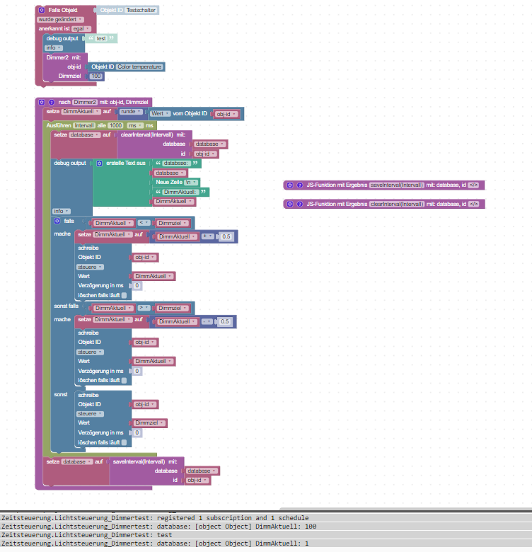

              ticaki Developer @azmo last edited by ticaki
              @azmo

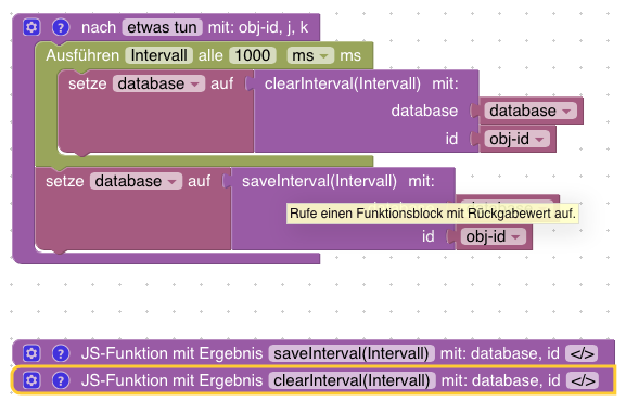

              Oh hab in deinem Bild eine Fehler übersehen. saveInterval kann natürlich nur den Interval sichern, wenn der gestartet wurde. Verschiebe den Aufruf hinter starte zyklische Ausführung.

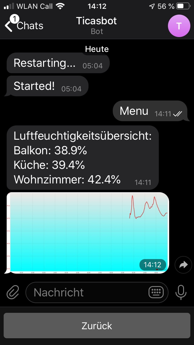

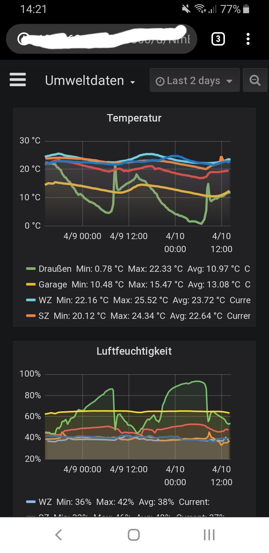

              Zu meinem Projekt - das soll mal in die Richtung gehen:
              aber hab noch eine zu große Verzögerung drin

                Also für Telegram...
                Habe noch gar nicht gewusst dass das mit Grafiken geht. Auch interessant. Finde mein Grafana schicker aber Telegram ist sicher bequemer unterwegs...
                  Ich hab doch gerade erst hinbekommen, dass ich das Flot Diagramm über eine headless Chromiumbrowser und ein Nodemodul in ein png umwandeln kann. Optik kommt am Ende, wenn mir die Funktionen gefallen. 😁
                    azmo last edited by azmo
                    @ticaki
                    Na klar muss das erst laufen ^^

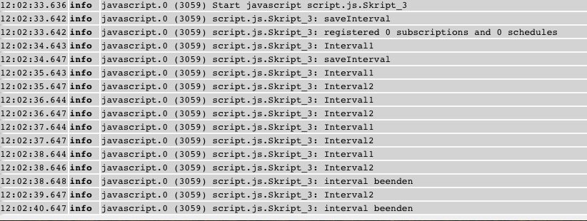

                    So, habe es ausprobiert - nächster Bug:
                    10.4.2020, 19:09:33.268	[info ]: javascript.0 (1293) Start javascript script.js.Zeitsteuerung.Lichtsteuerung_Dimmertest
                    10.4.2020, 19:09:33.272	[info ]: javascript.0 (1293) script.js.Zeitsteuerung.Lichtsteuerung_Dimmertest: registered 1 subscription and 0 schedules
                    10.4.2020, 19:09:34.706	[info ]: javascript.0 (1293) script.js.Zeitsteuerung.Lichtsteuerung_Dimmertest: Starte Dimmer2
                    10.4.2020, 19:09:34.706	[info ]: javascript.0 (1293) script.js.Zeitsteuerung.Lichtsteuerung_Dimmertest: In Dimmer2
                    10.4.2020, 19:09:35.707	[info ]: javascript.0 (1293) script.js.Zeitsteuerung.Lichtsteuerung_Dimmertest: In Interval
                    10.4.2020, 19:09:36.707	[info ]: javascript.0 (1293) script.js.Zeitsteuerung.Lichtsteuerung_Dimmertest: In Interval
                    10.4.2020, 19:09:46.874	[info ]: javascript.0 (1293) Stop script script.js.Zeitsteuerung.Lichtsteuerung_Dimmertest

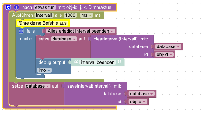

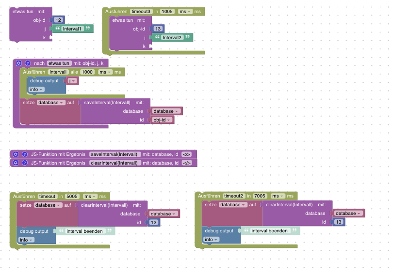

                    Hier nochmal der Aufbau und der Inhalt der beiden Funktionen:
                    saveInterval:
                    return database;
                    clearInterval:
                    if (database[id]) {
                    return database;
                    Wie ich das verstehe, stoppt er jetzt mit saveInterval. Alles was danach kommen soll, passiert nicht mehr.

                                                        <field name="oid">Object ID</field>
                                                      <block type="variables_get" id="SfQ{weqdB:sW$Dcc@UuU">
                                                        <field name="VAR" id="=W_p,[ot^(ajIy0Nam5}" variabletype="">obj-id</field>
                                                      <shadow type="logic_boolean" id="c8F%!]`Z1TdB2V{c[$}I">
                                                      <block type="variables_get" id="e#DT-~)_qqTY`ZfCcjud">
                                                        <field name="VAR" id="/3ajE3V-|nBR1!;GbK1a" variabletype="">DimmAktuell</field>
                                                    <value name="DELAY_MS">
                                                      <shadow type="math_number" id="@#D7ID-z`m|p)_UCD;Nn">
                                                        <field name="NUM">0</field>
                                                      <block type="controls_if" id="=pX$hSc`x;,=R}9[}4bu">
                                                        <mutation elseif="1" else="1"></mutation>
                                                          <block type="logic_compare" id="6T,j,~fvcIm==XR-PFDM">
                                                            <field name="OP">LT</field>
                                                              <block type="variables_get" id="s=yznV:F3rh{j+!5%u*!">
                                                              <block type="variables_get" id="(!,5PG#02t{4/MV$ZkL6">
                                                                <field name="VAR" id="pwW]mm~16AJwvaB/jMpp" variabletype="">Dimmziel</field>
                                                          <block type="variables_set" id=",L5.(-ujIG9D1EAEtzDG">
                                                              <block type="math_arithmetic" id="{6n$poWCt9?T4w1FHPQg">
                                                                <field name="OP">ADD</field>
                                                                  <shadow type="math_number" id="3aKgCngRtQ[Bm{RR*1P^">
                                                                    <field name="NUM">1</field>
                                                                  <block type="variables_get" id="z5wc-Z(RU$o#Xw7QEB5S">
                                                                  <shadow type="math_number" id="/uA+Gkmg9.kT6`ES.h~y">
                                                                    <field name="NUM">0.5</field>
                                                        <value name="IF1">
                                                          <block type="logic_compare" id="FPalg/el*|.u!1BHc%UN">
                                                            <field name="OP">GT</field>
                                                              <block type="variables_get" id="xq?Y!b%,h)l(Nt5-C3IL">
                                                              <block type="variables_get" id="jt4!%Si|4~^[}^)COU/D">
                                                        <statement name="DO1">
                                                          <block type="variables_set" id="gvjz`GP(ICz/?m-t3b4v">
                                                              <block type="math_arithmetic" id="As`CQZA.mdD:`|MvF!XG">
                                                                  <block type="variables_get" id="1q[(#-1?/$tUKgy35sGF">
                                                                  <shadow type="math_number" id="XJm=5aIM-{I;dX)b/`Hf">
                                                        <statement name="ELSE">
                                                          <block type="control_ex" id="FEA8hy/IJ)1zR?[V0F$B">
                                                            <value name="OID">
                                                              <shadow type="field_oid" id="?hx9v}?WVl5W,S;J%QeF">
                                                              <block type="variables_get" id="/gnRK}J1HM+P.8Yn:`}5">
                                                              <block type="variables_get" id="L]GeHeoNe2Dc[h0EnV@y">
                                                              <shadow type="math_number" id="6tZDBm{],|fSY|%P*a_7">
                                                              <block type="variables_set" id="]tYvIat_T6X4dMa?5fBf">
                                                                <field name="VAR" id="o_jN1a]8Ej9.U#EoO0)z" variabletype="">database</field>
                                                                  <block type="procedures_callcustomreturn" id="oM]WlY{eWO!f]-FkH^Wx">
                                                                    <mutation name="clearInterval(Intervall)">
                                                                      <arg name="database"></arg>
                                                                      <arg name="id"></arg>
                                                                    </mutation>
                                                                    <value name="ARG0">
                                                                      <block type="variables_get" id="FLWx75},j^gw0@;MV%:v">
                                                                    <value name="ARG1">
                                                                      <block type="variables_get" id="@,U.Px8xwR|NlI+qe$FC">
                                                                  <block type="debug" id="rEN{+,!AUY+uoENeO|{K">
                                                                    <field name="Severity">warn</field>
                                                                    <value name="TEXT">
                                                                      <shadow type="text" id="@6{W)M@h,n%QICeoy{en">
                                                                        <field name="TEXT">Intervall Beenden</field>
                                                                      <block type="text_join" id="~w|.1of}fqap/S=,0Dw0">
                                                                        <value name="ADD0">
                                                                          <block type="text" id="7Wo%rGKA@JtK?6r-9bY(">
                                                                            <field name="TEXT">Ende: </field>
                                                                        <value name="ADD1">
                                                                          <block type="variables_get" id="S,7C,2_?SS~WI6LiLFSM">
                      <block type="on_ext" id="ZIvKxjZ4_as.SxllAd}n" x="-138" y="-3862">
                        <value name="OID0">
                          <shadow type="field_oid" id="Chdzg!{lPR[FDTYg[0F$">
                            <field name="oid">0_userdata.0.Eigene_Datenpunkte.Testschalter</field>
                          <block type="debug" id="WP9$ku!nlWWuf/Q2)Z;p">
                            <value name="TEXT">
                              <shadow type="text" id="F[}@OiSyz;m)/rm6+?z$">
                                <field name="TEXT">Starte Dimmer2</field>
                              <block type="procedures_callnoreturn" id="V81.azz`_)ev~K?6sFGX">
                                <mutation name="Dimmer2">
                                  <arg name="obj-id"></arg>
                                  <arg name="Dimmziel"></arg>
                                  <arg name="DimmAktuell"></arg>
                                </mutation>
                                <value name="ARG0">
                                  <block type="field_oid" id="GE9W*l(55Gor2ku*Ip]{">
                                    <field name="oid">tradfri.0.L-65546.lightbulb.colorTemperature</field>
                                <value name="ARG1">
                                  <block type="math_number" id="ztrAlJ+P:kM9fO]eV7LK">
                      <block type="procedures_defcustomreturn" id="z,8GjQLE51vxVTt^F*Qr" x="-137" y="-3288">
                        <mutation statements="false">
                          <arg name="database" varid="o_jN1a]8Ej9.U#EoO0)z"></arg>
                          <arg name="id" varid=".qQ27g@c{,vp#.RvAZ#y"></arg>
                        </mutation>
                        <field name="NAME">saveInterval(Intervall)</field>
                        <field name="SCRIPT">aWYgKGRhdGFiYXNlID09PSB1bmRlZmluZWQpIGRhdGFiYXNlID0ge307DQppZiAoZGF0YWJhc2VbaWRdICE9PSB1bmRlZmluZWQgJiYgZGF0YWJhc2VbaWRdKSBjbGVhckludGVydmFsKGRhdGFiYXNlW2lkXSk7DQpkYXRhYmFzZVtpZF0gPSBJbnRlcnZhbGw7DQpyZXR1cm4gZGF0YWJhc2U7</field>
                      <block type="procedures_defcustomreturn" id="|k6VqYQ6sFc^M-I^.`96" x="-138" y="-3237">
                        </mutation>
                        <field name="NAME">clearInterval(Intervall)</field>
                        <field name="SCRIPT">aWYgKGRhdGFiYXNlID09PSB1bmRlZmluZWQpIHJldHVybiB7fTsNCmlmIChkYXRhYmFzZVtpZF0gPT09IHVuZGVmaW5lZCkgcmV0dXJuIGRhdGFiYXNlOw0KaWYgKGRhdGFiYXNlW2lkXSkgew0KICAgIGNsZWFySW50ZXJ2YWwoZGF0YWJhc2VbaWRdKTsNCiAgICBkYXRhYmFzZVtpZF0gPSBudWxsOw0KfQ0KcmV0dXJuIGRhdGFiYXNlOw==</field>

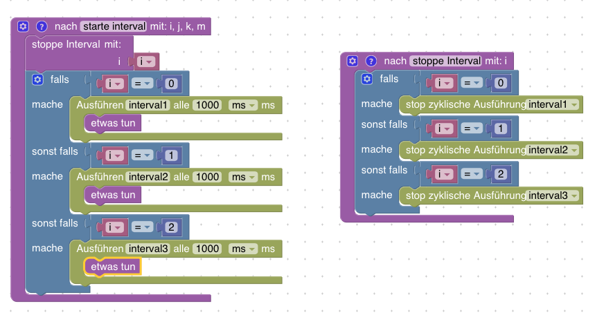

                      @azmo
                      Save Interval muß unterhalb und außerhalb von starte zyklische Ausführung(nenne ich ab jetzt Interval) sein. Wie ich es oben mal gezeigt habe.
                      Du mußt die Ausführung von Interval starten um eine Referenz zu haben und sie dann sofort speichern. Der Interval startet nicht sofort.
                      Hier nochmal:
                        @ticaki
                        Unterhalb! Das war es!
                        Eigentlich logisch, der Intervall muss ja erst definiert sein bevor er etwas damit machen kann m(
                        Aber jedenfalls:
                        HEUREKA! Es klappt!
                        DANKE!
                        Jetzt muss ich nur noch die alte Funktion ersetzen und dann ist das nächste Projekt an der Reihe ^^
