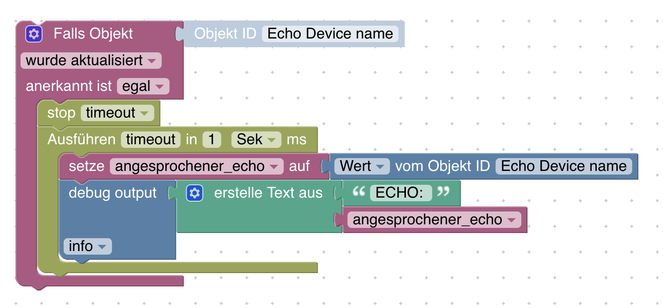

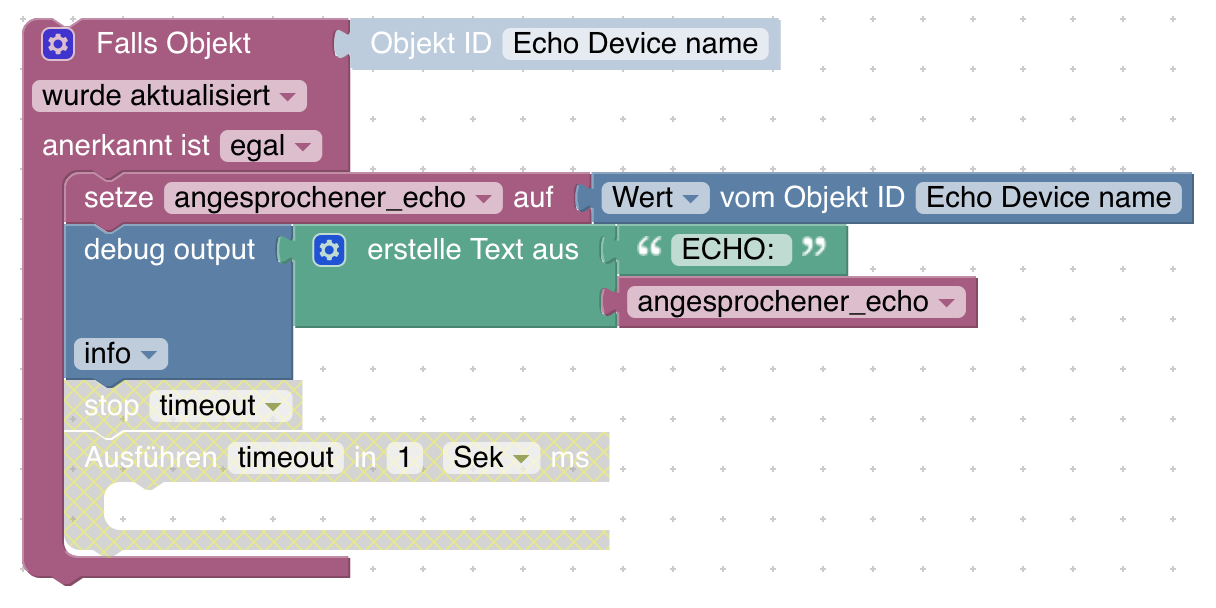

                @bigd-73
                wenn Du einfach mal Debugbausteine nimmst, wirst Du staunen welche Alexa zum Teil was hört...
                <block xmlns="http://www.w3.org/1999/xhtml" type="on_ext" id="?gr$o@h!NTpz7ncFkw9" x="37" y="137"> <mutation items="1"></mutation> <field name="CONDITION">any</field> <field name="ACK_CONDITION"></field> <value name="OID0"> <shadow type="field_oid" id=",JW*_Fne3n279T7:v^/D"> <field name="oid">alexa2.0.History.name</field> </shadow> </value> <statement name="STATEMENT"> <block type="timeouts_cleartimeout" id="eOvj$H9PlgC35bl*#^yn"> <field name="NAME">timeout</field> <next> <block type="timeouts_settimeout" id="]|Sd2-#AhJAE${RdAC2G"> <field name="NAME">timeout</field> <field name="DELAY">1</field> <field name="UNIT">sec</field> <statement name="STATEMENT"> <block type="variables_set" id="Yps_^d-kW+oe5cQMJ@@q"> <field name="VAR" id="tx]izPXI!BeK19VCX$" variabletype="">angesprochener_echo</field> <value name="VALUE"> <block type="get_value" id="~@yqzw9b:kyhv;sWile*"> <field name="ATTR">val</field> <field name="OID">alexa2.0.History.name</field> </block> </value> <next> <block type="debug" id="aZK+dR0ArHW/.T7s0TJG"> <field name="Severity">log</field> <value name="TEXT"> <shadow type="text" id="8Sjo6Q$aWu%%ozq^o^CL"> <field name="TEXT">test</field> </shadow> <block type="text_join" id="RGiVPIa(4NV*u.uhLA;F"> <mutation items="2"></mutation> <value name="ADD0"> <block type="text" id="S@z*(X!Yxn_Ym4^bVBDi"> <field name="TEXT">ECHO: </field> </block> </value> <value name="ADD1"> <block type="variables_get" id="AgP?eSw.F.CmS3tI0w3s"> <field name="VAR" id="tx]izPXI!BeK19V`CX$" variabletype="">angesprochener_echo</field>
                20:20:45.576	info	javascript.0 (2286) script.js.18_Test.ECHO_Test: ECHO: Wohnzimmer
                20:20:49.776	info	javascript.0 (2286) script.js.18_Test.ECHO_Test: ECHO: Flur
                20:20:49.790	info	javascript.0 (2286) script.js.18_Test.ECHO_Test: ECHO: Wohnzimmer
                20:20:49.804	info	javascript.0 (2286) script.js.18_Test.ECHO_Test: ECHO: Küche
                20:20:51.859	info	javascript.0 (2286) script.js.18_Test.ECHO_Test: ECHO: Wohnzimmer
                20:20:59.709	info	javascript.0 (2286) script.js.18_Test.ECHO_Test: ECHO: Wohnzimmer
                Und die stehen recht weit auseinander...., aber die Türen sind/waren offen.
