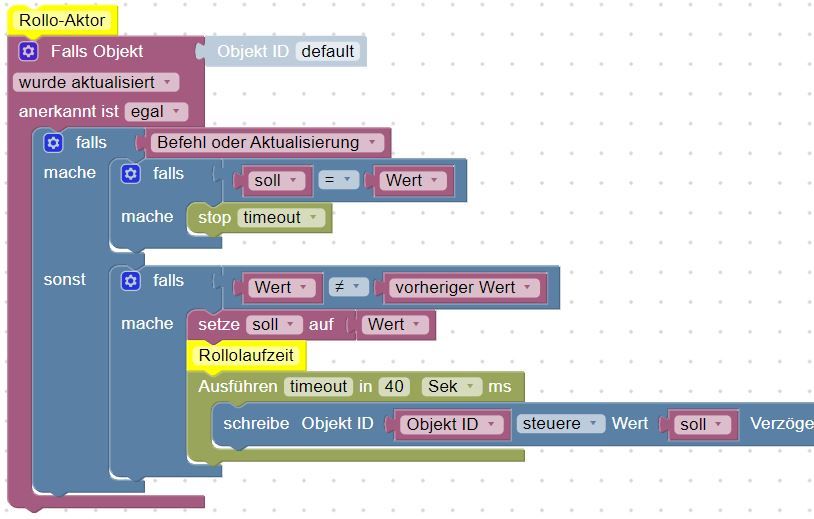

              Versuche es mal so:
               <variables>
                 <variable type="" id="V*8SecbOYtdYL9J2Van6">soll</variable>
                 <variable type="undefined" id="timeout">timeout</variable>
               </variables>
               <block type="comment" id="RgU^FnFCeCG_^Y(n|v11" x="63" y="-13">
                 <field name="COMMENT">Rollo-Aktor</field>
                   <block type="on_ext" id="T+m`])pthE4_/)0c*(0q">
                     <value name="OID0">
                       <shadow type="field_oid" id="#Xdo7tmN|+t~RtIf=37P">
                       <block type="controls_if" id="-$8{Ruml{`Qoi-^0g2D`">
                           <block type="on_source" id="gNOVaU5R67SYrH=kMQDy">
                             <field name="ATTR">state.ack</field>
                           <block type="controls_if" id="axAh.K[$bN8D}G:qJEk3">
                               <block type="logic_compare" id="*1Iuc|oaj(69[!}`/K_I">
                                 <field name="OP">EQ</field>
                                   <block type="variables_get" id="j{~6nAgws8dt;HIcCyZ0">
                                     <field name="VAR" id="V*8SecbOYtdYL9J2Van6" variabletype="">soll</field>
                                   <block type="on_source" id="n;uB,)b1K`MC.K$[[#0z">
                               <block type="timeouts_cleartimeout" id="#H91=^8g1qS.DR!uKi_z">
                         <statement name="ELSE">
                           <block type="controls_if" id="hx_UgF=#TXr$#.]3kZn-">
                               <block type="logic_compare" id="cqIWn@pqC}p5RE[qG@aM">
                                 <field name="OP">NEQ</field>
                                   <block type="on_source" id="1Js7~v99vM2NE![EK=uk">
                                   <block type="on_source" id="8gh(8~j*:r!f{a);P%!n">
                                     <field name="ATTR">oldState.val</field>
                               <block type="variables_set" id="JF1d5qm(@kADj.U:Y_7w">
                                   <block type="on_source" id="]]O{h!-K=v+bkT[A__Tn">
                                   <block type="comment" id="Igmu@H4dny_-b83dcQ,D">
                                     <field name="COMMENT">Rollolaufzeit</field>
                                       <block type="timeouts_settimeout" id="9,8Pim2S3B`0e{!m#wXA">
                                         <field name="DELAY">40</field>
                                           <block type="control_ex" id="BM^Z@TKLWjul@o+qBVTW" inline="true">
                                             <value name="OID">
                                               <shadow type="field_oid" id="tn5Ne#?fV0)mN2$/d{-h">
                                                 <field name="oid">Object ID</field>
                                               <block type="on_source" id="F%sycofU*{erdq^cwI=a">
                                                 <field name="ATTR">id</field>
                                               <shadow type="logic_boolean" id="z-vY3}.J}w/FR4QzJY5N">
                                               <block type="variables_get" id="_zC%ow0d1y./++~T:M{J">
                                             <value name="DELAY_MS">
                                               <shadow type="math_number" id="mhn]=?1`Z|KH:xj6x:%F">
                                                 <field name="NUM">0</field>
              AnamCara 1 Reply Last reply Reply Quote 1

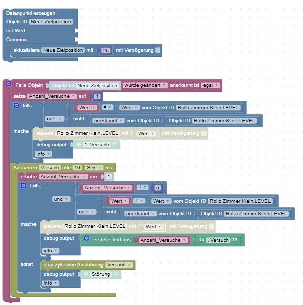

                            Sicherheitshalber empfehle ich dir in deinen Skripte die Anzahl der Versuche zu limitieren.

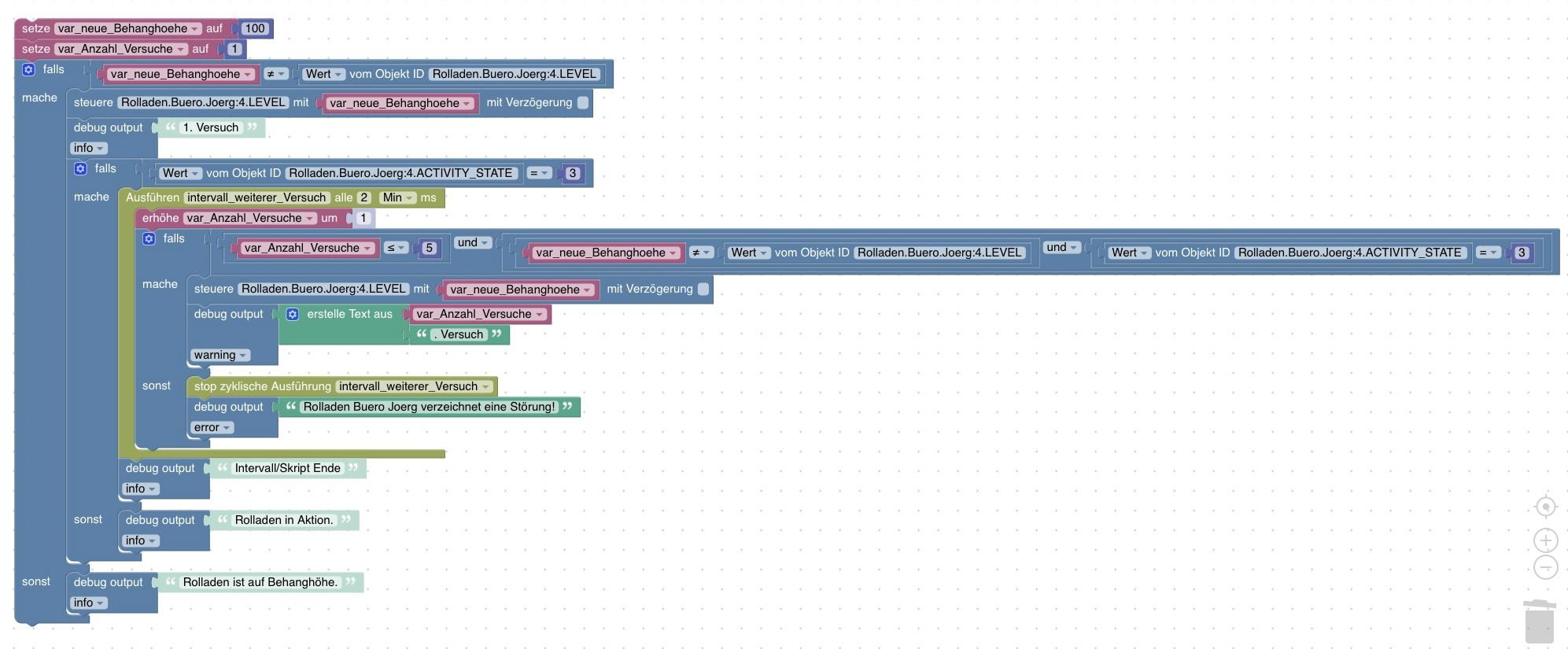

                            Guten Morgen,
                            ich hatte erst noch ein anderes Problem zu lösen, meine Skripte liefen gar nicht mehr. Ich hatte eine einfache Steuerung mit der Astro-Funktion gebaut und darunter dann die ganzen "Steuere Objekt ID"'s liegen. Als ich aber eine CRON Zeitsteuerung darüber gesetzt hatte ging nichts mehr. Also habe ich erst mal den CRON wieder herausgenommen, da die Vierschachtelung wohl nicht funktionierte.
                            Danach habe ich mir mal Dein Skript angesehen. Schlussendlich habe ich es etwas anders umgesetzt, denn ich denke mal in Deinem Skript geht es darum individuell die Behanghöhe "Neue Zielposition" eingeben zu können und dann geht die Steuerung los...
                            Bei mir soll das ganze "erst einmal" etwas statischer von statten gehen und ich habe das nun so gesetzt:

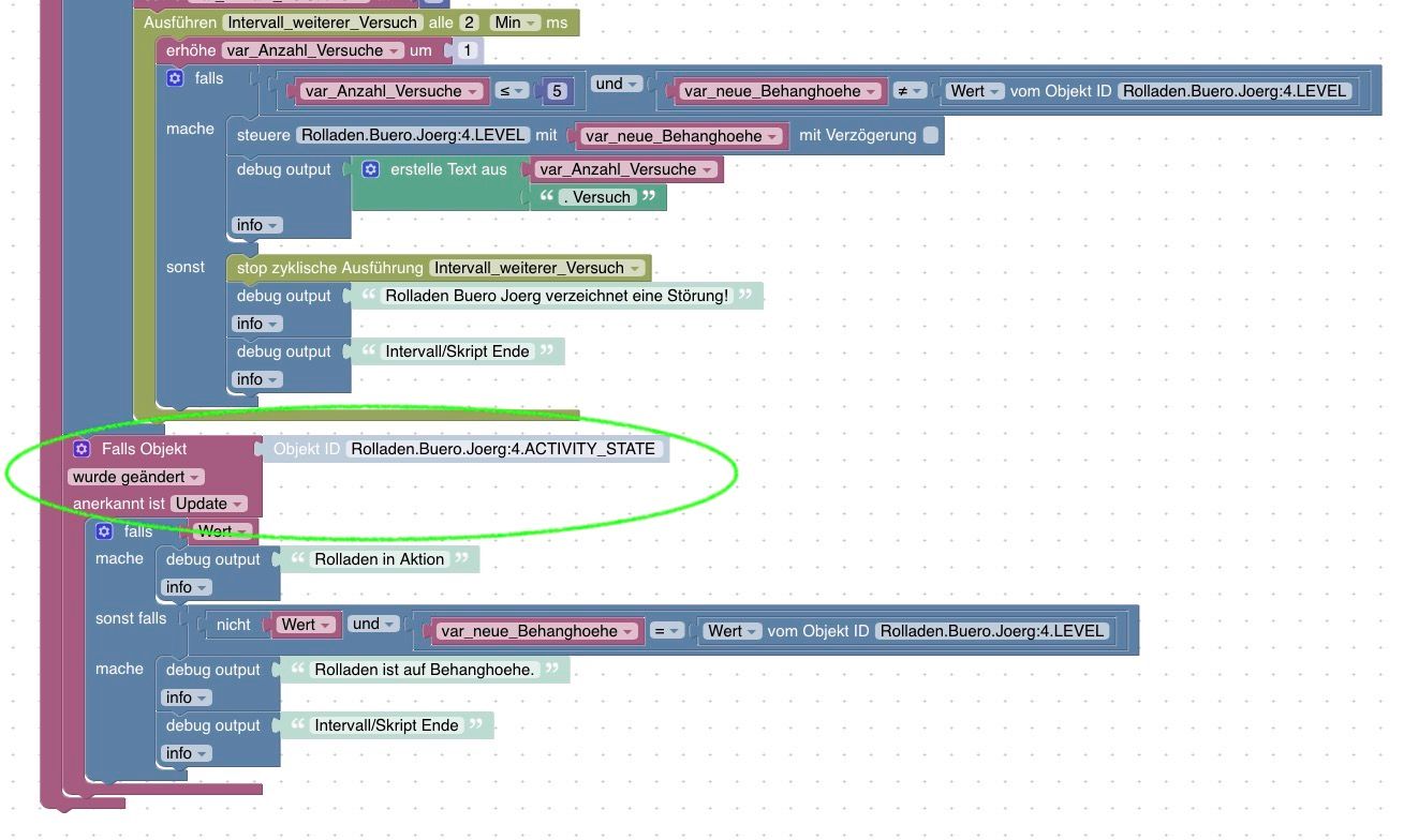

                            Im Grunde sollte das Rollo ja den Befehl zum steuern der Behanghöhe erhalten haben wenn es danach in Bewegung ist.
                            (P.S. was macht denn "anerkannt von Objekt ID" ?)
                            Wenn das so okay ist, müsste ich das nun für 12 Rolladen machen. Ich denke mal den Block jetzt 11 mal zu kopieren und abzuändern ist aus Sicht eines Programmierers nicht das gelbe vom Ei. Ich bin zwar kein Programmierer aber ich habe genug Code gesehen um zu erahnen, dass eine Schleife oder besser wohl ein Array mit den Rolladen besser wäre?
                            Das Skript oben habe ich jetzt noch nicht richtig testen können, denn es funktioniert im Moment direkt beim ersten Lauf 🙂 ich hatte zunächst Dein Skript zu quasi 100% übernommen, aber dabei wurde nie ins Log geschrieben, das es gerade der 2.,3.,4. oder 5. Versuch ist der läuft, es kam immer die Meldung Störung, obwohl der Rolladen noch bei der Arbeit war, deshalb habe ich den Intervall nach oben korrigiert.
                            DAN78 2 Replies Last reply Reply Quote 0

                              Das "anerkannt von Objekt ID" gibt Rückmeldung ob dein Befehl ausgeführt wurde
                              In deinem Skript oben fragst du ab ob das Rollo läuft. Mit activiti up/down...
                              So was probierte ich auch mal für eine andere Anwendung, funktionierte dann nicht wirklich.
                              Mein Lösungsansatz zu deiner Frage: "Wie stellt ihr sicher, dass das Rollo auch wirklich gefahren ist." war folgender.
                              1. Die Rollade fährt.
                              2. Nach ein paar Minuten wird kontrolliert ob die aktuelle Bahnhöhe der angesteuerten entspricht, und ob diese per Rückmeldung bestätigt sei.
                              3. Falls nicht zurück zu punkt 1

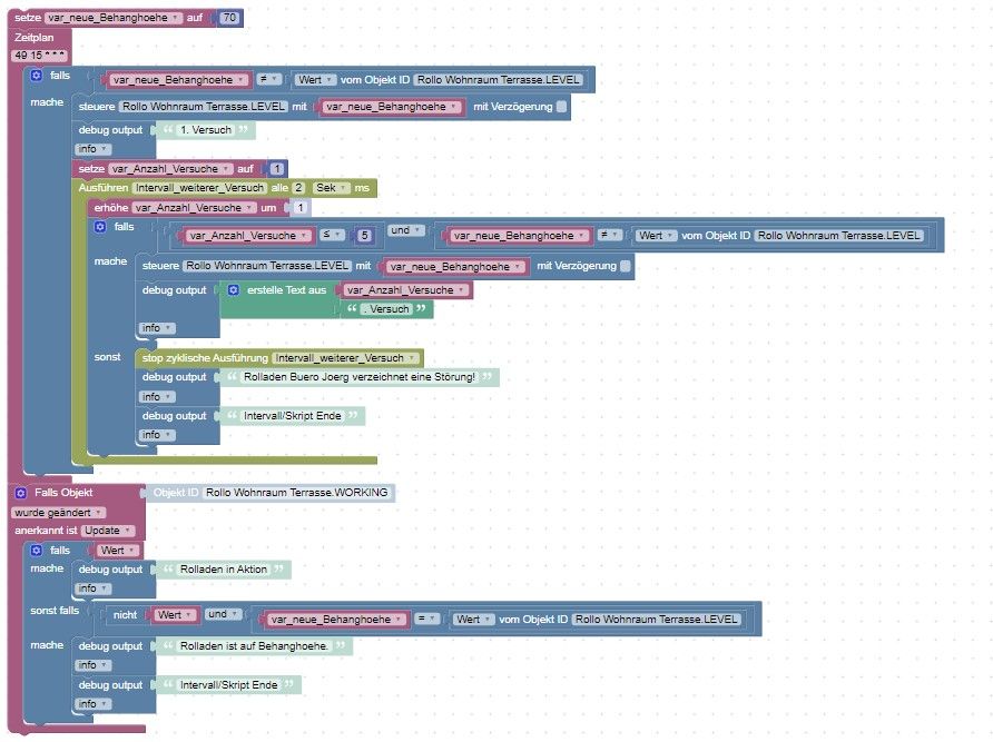

                              Falls du unter "meinem Skript" hingegen das Rolladenskript meitest welches ich 2018 hochgeladen habe,
                              bitte ich dich dieses nicht zu verwenden! Das beinhaltet Astro und mehrere Spielereien.
                              Zwar funktioniert es, ist aber für den Zweck viel zu unübersichtlich, wenn nicht schlecht ausgeführt.
                              Das war damals mein erstes Programm 🙂 ich konnte es nicht besser.
                              Aktuell bin ich dabei ein neues Rolladenskript zu erstellen, werde dann den Schinken im Post ersetzen. Habe nicht die Berechtigung meine Posts zu löschen.

                                  • DAN78
                                    DAN78 @AnamCara last edited by DAN78
                                    @AnamCara Probier mal das Skript. Ich glaube du wolltest das haben
                                      <variables>
                                        <variable type="" id="fGkS8jJx-UC*s0yHpdv*">var_neue_Behanghoehe</variable>
                                        <variable type="" id="Yyk;+Ej*G^q;$$=E8S}l">var_Anzahl_Versuche</variable>
                                        <variable type="undefined" id="Intervall_weiterer_Versuch">Intervall_weiterer_Versuch</variable>

                                    • AnamCara
                                      AnamCara @DAN78 last edited by AnamCara
                                      Dankeschön @DAN78
                                      nur eine kurze Rückfrage ich habe leider kein .WORKING objekt das ich abfragen kann in HMip oder habe ich etwas übersehen?
                                      Wenn ich das Skript ausführe, dann laufen gleich alle 1-5 Versuche durch, ich habe deshalb den Intervall von 2 Sek. auf 2 Minuten geändert. Bei mir habe ich dann anstelle von WORKING den ACTIVITY__STATE gewählt. Jetzt kommt im Log dann nur noch folgendes
                                      javascript.0 2020-04-24 07:57:15.215 info (878) script.js.Test.Pruefung: Rolladen in Aktion
                                      javascript.0 2020-04-24 07:57:00.213 info (878) script.js.Test.Pruefung: Rolladen in Aktion
                                      javascript.0 2020-04-24 07:57:00.025 info (878) script.js.Test.Pruefung: 1. Versuch
                                      Sollte mich der zweite "Rolladen in Aktion" Eintrag stören? 🤔
                                      DAN78 1 Reply Last reply Reply Quote 0
                                      • DAN78
                                        @AnamCara
                                        Zum zweiten Log-Eintrag:
                                        Was hast du im Trigger? (Objekt ID geändert oder aktualisiert / anerkannt egal oder update)
                                        Habe die von HM (ohne IP), kann oder wird sein dass die Datenpunkte nicht identisch sind.
                                        Activity wird bei HMIP vermutlich dieselbe Funktion haben wie Working und Stop bei HM.
                                        Du kannt das Ganze evtl auch mit Direction verknüpfen. (states: 0=NONE; 1=UP; 2=DOWN; 3=UNDEFINED)
                                        Hatte die 2 Sekunden in Intervall um das Blockly zu testen.
                                        AnamCara 1 Reply Last reply Reply Quote 0
                                        • AnamCara
                                          @DAN78 sagte in Überprüfen ob Aktor Steuerbefehl erhalten hat...:
                                          Ich habe als Trigger "Falls Objekt Rolladen.Buero.Joerg:4.ACTIVITY_STATE wurde geändert".
