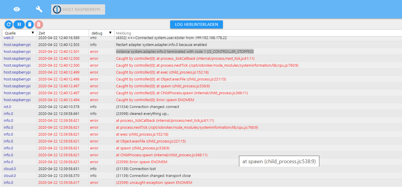

          Homoran Global Moderator Administrators @Thunder1504 last edited by
          @Thunder1504 LOG bitte als Text in Code-tags posten!
          dann kann ich nämlich das ENOMEM einfach kopieren.
          RAM ist voll

                        host.raspberrypi	2020-04-22 18:47:17.974	error	Caught by controller[1]: at Function.Module.runMain (internal/modules/cjs/loader.js:754:12)
                        host.raspberrypi	2020-04-22 18:47:17.973	error	Caught by controller[1]: at Function.Module._load (internal/modules/cjs/loader.js:531:3)
                        host.raspberrypi	2020-04-22 18:47:17.973	error	Caught by controller[1]: at tryModuleLoad (internal/modules/cjs/loader.js:539:12)
                        host.raspberrypi	2020-04-22 18:47:17.972	error	Caught by controller[1]: at Module.load (internal/modules/cjs/loader.js:600:32)
                        host.raspberrypi	2020-04-22 18:47:17.972	error	Caught by controller[1]: at Object.Module._extensions..js (internal/modules/cjs/loader.js:712:10)
                        host.raspberrypi	2020-04-22 18:47:17.971	error	Caught by controller[1]: at Module._compile (internal/modules/cjs/loader.js:701:30)
                        host.raspberrypi	2020-04-22 18:47:17.970	error	Caught by controller[1]: at Object.<anonymous> (/opt/iobroker/node_modules/iobroker.info/main.js:48:18)
                        host.raspberrypi	2020-04-22 18:47:17.970	error	Caught by controller[1]: at getSystemVersions (/opt/iobroker/node_modules/iobroker.info/main.js:79:17)
                        host.raspberrypi	2020-04-22 18:47:17.969	error	Caught by controller[1]: TypeError: Cannot read property 'log' of undefined
                        host.raspberrypi	2020-04-22 18:47:17.969	error	Caught by controller[1]: ^
                        host.raspberrypi	2020-04-22 18:47:17.968	error	Caught by controller[1]: adapter.log.error('Could not check npm version: ' + e);
                        host.raspberrypi	2020-04-22 18:47:17.967	error	Caught by controller[1]: /opt/iobroker/node_modules/iobroker.info/main.js:79
                        host.raspberrypi	2020-04-22 18:47:17.966	error	Caught by controller[0]: /bin/sh: 1: npm: not found
                        host.raspberrypi	2020-04-22 18:47:15.794	info	instance system.adapter.info.0 started with pid 7628
                        javascript.0	2020-04-22 18:46:50.751	info	(6999) script.js.common.Waschmaschine_Status: 03. Waschmaschine Aus Zähler + , Ein Zähler =0
                        host.raspberrypi	2020-04-22 18:46:45.762	info	Restart adapter system.adapter.info.0 because enabled
                        host.raspberrypi	2020-04-22 18:46:45.761	error	instance system.adapter.info.0 terminated with code 1 (JS_CONTROLLER_STOPPED)
                        host.raspberrypi	2020-04-22 18:46:45.761	error	Caught by controller[1]: at bootstrapNodeJSCore (internal/bootstrap/node.js:622:3)
                        host.raspberrypi	2020-04-22 18:46:45.760	error	Caught by controller[1]: at startup (internal/bootstrap/node.js:283:19)
                        host.raspberrypi	2020-04-22 18:46:45.760	error	Caught by controller[1]: at Function.Module.runMain (internal/modules/cjs/loader.js:754:12)
                        host.raspberrypi	2020-04-22 18:46:45.759	error	Caught by controller[1]: at Function.Module._load (internal/modules/cjs/loader.js:531:3)
                        host.raspberrypi	2020-04-22 18:46:45.758	error	Caught by controller[1]: at tryModuleLoad (internal/modules/cjs/loader.js:539:12)
                        host.raspberrypi	2020-04-22 18:46:45.758	error	Caught by controller[1]: at Module.load (internal/modules/cjs/loader.js:600:32)
                        host.raspberrypi	2020-04-22 18:46:45.757	error	Caught by controller[1]: at Object.Module._extensions..js (internal/modules/cjs/loader.js:712:10)
                        host.raspberrypi	2020-04-22 18:46:45.757	error	Caught by controller[1]: at Module._compile (internal/modules/cjs/loader.js:701:30)
                        host.raspberrypi	2020-04-22 18:46:45.756	error	Caught by controller[1]: at Object.<anonymous> (/opt/iobroker/node_modules/iobroker.info/main.js:48:18)
                        host.raspberrypi	2020-04-22 18:46:45.755	error	Caught by controller[1]: at getSystemVersions (/opt/iobroker/node_modules/iobroker.info/main.js:79:17)
                        host.raspberrypi	2020-04-22 18:46:45.754	error	Caught by controller[1]: TypeError: Cannot read property 'log' of undefined
                        host.raspberrypi	2020-04-22 18:46:45.754	error	Caught by controller[1]: ^
                        host.raspberrypi	2020-04-22 18:46:45.753	error	Caught by controller[1]: adapter.log.error('Could not check npm version: ' + e);
                        host.raspberrypi	2020-04-22 18:46:45.752	error	Caught by controller[1]: /opt/iobroker/node_modules/iobroker.info/main.js:79
                        host.raspberrypi	2020-04-22 18:46:45.751	error	Caught by controller[0]: /bin/sh: 1: npm: not found
                        host.raspberrypi	2020-04-22 18:46:43.497	info	instance system.adapter.info.0 started with pid 7617
                        host.raspberrypi	2020-04-22 18:46:13.462	info	Restart adapter system.adapter.info.0 because enabled
                        host.raspberrypi	2020-04-22 18:46:13.460	error	instance system.adapter.info.0 terminated with code 1 (JS_CONTROLLER_STOPPED)
                        host.raspberrypi	2020-04-22 18:46:13.455	error	Caught by controller[1]: at bootstrapNodeJSCore (internal/bootstrap/node.js:622:3)
                        host.raspberrypi	2020-04-22 18:46:13.431	error	Caught by controller[1]: at startup (internal/bootstrap/node.js:283:19)
                        host.raspberrypi	2020-04-22 18:46:13.430	error	Caught by controller[1]: at Function.Module.runMain (internal/modules/cjs/loader.js:754:12)
                        host.raspberrypi	2020-04-22 18:46:13.430	error	Caught by controller[1]: at Function.Module._load (internal/modules/cjs/loader.js:531:3)
                        host.raspberrypi	2020-04-22 18:46:13.429	error	Caught by controller[1]: at tryModuleLoad (internal/modules/cjs/loader.js:539:12)
                        host.raspberrypi	2020-04-22 18:46:13.428	error	Caught by controller[1]: at Module.load (internal/modules/cjs/loader.js:600:32)
                        host.raspberrypi	2020-04-22 18:46:13.427	error	Caught by controller[1]: at Object.Module._extensions..js (internal/modules/cjs/loader.js:712:10)
                        host.raspberrypi	2020-04-22 18:46:13.427	error	Caught by controller[1]: at Module._compile (internal/modules/cjs/loader.js:701:30)
                        host.raspberrypi	2020-04-22 18:46:13.426	error	Caught by controller[1]: at Object.<anonymous> (/opt/iobroker/node_modules/iobroker.info/main.js:48:18)
                        host.raspberrypi	2020-04-22 18:46:13.425	error	Caught by controller[1]: at getSystemVersions (/opt/iobroker/node_modules/iobroker.info/main.js:79:17)
                        host.raspberrypi	2020-04-22 18:46:13.424	error	Caught by controller[1]: TypeError: Cannot read property 'log' of undefined
                        host.raspberrypi	2020-04-22 18:46:13.423	error	Caught by controller[1]: ^
                        host.raspberrypi	2020-04-22 18:46:13.423	error	Caught by controller[1]: adapter.log.error('Could not check npm version: ' + e);
                        host.raspberrypi	2020-04-22 18:46:13.422	error	Caught by controller[1]: /opt/iobroker/node_modules/iobroker.info/main.js:79
                        host.raspberrypi	2020-04-22 18:46:13.420	error	Caught by controller[0]: /bin/sh: 1: npm: not found
