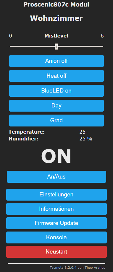

      Proscenic 807C Luftbefeuchter
      Nicht flashbar mit TuyaConvert, muß seriell geflasht werden.
      Firmware: Tasmota mit Skript " #define USE_SCRIPT // Add support for script (+17k code)"
      Adapter: Sonoff
      Vorlage:
      {"NAME":"Proscenic807c","GPIO":[255,255,255,255,255,255,0,0,255,255,255,255,255],"FLAG":15,"BASE":54}
      Script:
      >D
      p:level=0
      te=0
      hy=0
      p:anion=0
      p:heat=0
      p:bled=0
      p:fahr=0
      p:nida=0
      >E
      te=TuyaReceived#DpType2Id104
      hy=TuyaReceived#DpType2Id3
      if chg[te]>0 {
      =>publish stat/%topic%/RESULT {"temperature":"%0te%"}
      if chg[hy]>0 {
      =>publish stat/%topic%/RESULT {"humidifier":"%0hy%"}
      >S
      if chg[level]>0
      =>TuyaSend4 6,%0level%
      =>publish stat/%topic%/RESULT {"Script":">level=%0level%"}
      if chg[anion]>0 {
      =>TuyaSend1 7,%0anion%
      =>publish stat/%topic%/RESULT {"Script":">anion=%0anion%"}
      if chg[heat]>0 {
      =>TuyaSend1 101,%0heat%
      =>publish stat/%topic%/RESULT {"Script":">heat=%0heat%"}
      if chg[bled]>0 {
      =>TuyaSend1 102,%0bled%
      =>publish stat/%topic%/RESULT {"Script":">bled=%0bled%"}
      if chg[fahr]>0 {
      =>TuyaSend1 105,%0fahr%
      =>publish stat/%topic%/RESULT {"Script":">fahr=%0fahr%"}
      if chg[nida]>0 {
      =>TuyaSend1 106,%0nida%
      =>publish stat/%topic%/RESULT {"Script":">nida=%0nida%"}
      >W
      Temperature:{m} %0te%
      Humidifier:{m} %0hy% %%
      sl(0 6 level "0" "Mistlevel" "6")
      bu(anion "Anion on" "Anion off")
      bu(heat "Heat on" "Heat off")
      bu(bled "BlueLED on" "BlueLED off")
      bu(nida "Nigth" "Day")
      bu(fahr "Fahrenheit" "Grad")

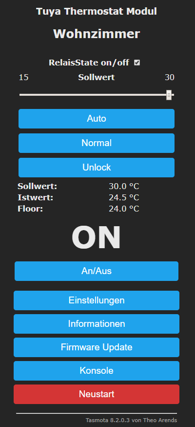

        Beca Thermostat
        Mit TuyaConvert flashbar.
        Download: tasmota-DE.zip
        Adapter: Sonoff
        Vorlage:
        {"NAME":"Tuya Thermostat","GPIO":[255,255,255,255,255,255,0,0,255,255,255,255,255],"FLAG":15,"BASE":54}
        Script:
        >D
        p:hand=1
        p:lock=0
        p:eco=0
        p:soll=0
        pin5=0
        target=0
        temp=0
        tempf=0
        >BS
        +>subscribe soll, cmnd/%topic%/soll
        +>subscribe lock, cmnd/%topic%/lock
        +>subscribe hand, cmnd/%topic%/hand
        +>subscribe eco, cmnd/%topic%/eco
        >E
        soll=TuyaReceived#DpType2Id2/2
        temp=TuyaReceived#DpType2Id3/2
        tempf=TuyaReceived#DpType2Id102/2
        if chg[temp]>0 {
        =>publish stat/%topic%/RESULT {"istwert":"%1temp%"}
        if chg[tempf]>0 {
        =>publish stat/%topic%/RESULT {"floor":"%1tempf%"}
        if chg[target]>0 {
        soll=target/2
        >F
        if chg[hand]>0 {
        =>TuyaSend4 4,%0hand%
        =>publish stat/%topic%/RESULT {"hand":"%0hand%"}
        if pin5!=pin[5] {
        pin5=pin[5]
        =>publish stat/%topic%/RESULT {"state":"%0pin5%"}
        if chg[soll]>0 {
        target=soll*2
        =>TuyaSend2 2,%target%
        =>publish stat/%topic%/RESULT {"soll":"%1soll%"}
        if chg[eco]>0 {
        =>TuyaSend1 5,%0eco%
        =>publish stat/%topic%/RESULT {"eco":"%0eco%"}
        if chg[lock]>0 {
        =>TuyaSend1 6,%0lock%
        =>publish stat/%topic%/RESULT {"lock":"%0lock%"}
        >W
        ck(pin5 "RelaisState on/off   ")
        Sollwert:{m} %1soll% °C
        Istwert:{m} %1temp% °C
        Floor:{m} %1tempf% °C
        sl(30 60 target "15" "Sollwert" "30")
        bu(hand "Hand" "Auto")
        bu(eco "Eco" "Normal")
        bu(lock "Lock" "Unlock")
        Wichtig !!!
        Es muss bei den MQTT-Einstellungen als Topic ein eindeutiger Name vergeben werden, "tasmota_%06X" funktioniert nicht.

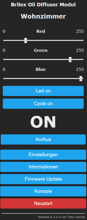

                  Brilex Oil Diffuser
                  Brilex Oil Diffuser
                  Adapter: Sonoff
                  Vorlage:
                  {"NAME":"Brilex Oil Diffuser","GPIO":[255,255,255,255,255,255,0,0,255,255,255,255,255],"FLAG":0,"BASE":54}
                  Script:
                  >D
                  color=""
                  col1=""
                  led=0
                  mled=0
                  p:red=0
                  p:green=0
                  p:blue=0
                  >E
                  mled=TuyaReceived#DpType4Id6
                  led=TuyaReceived#DpType1Id5
                  if chg[led]>0 {
                  =>TuyaSend1 5,%0led%
                  =>publish stat/%topic%/RESULT {"Script":">led=%0led%"}
                  if chg[mled]>0 {
                  =>TuyaSend4 6,%0mled%
                  =>publish stat/%topic%/RESULT {"Script":">cycle=%0mled%"}
                  >F
                  color=hn(red)+hn(green)+hn(blue)
                  if color!=col1 {
                  col1=color
                  mled=0
                  led=1
                  =>TuyaSend3 8,%color%64646464
                  =>publish stat/%topic%/RESULT {"Script":">red=%0red%"}
                  =>publish stat/%topic%/RESULT {"Script":">green=%0green%"}
                  =>publish stat/%topic%/RESULT {"Script":">blue=%0blue%"}
                  >W
                  sl(0 255 red "0" "Red" "255")
                  sl(0 255 green "0" "Green" "255")
                  sl(0 255 blue "0" "Blue" "255")
                  bu(led "Led on" "LED off")
                  bu(mled "Cycle on" "Cycle off")
