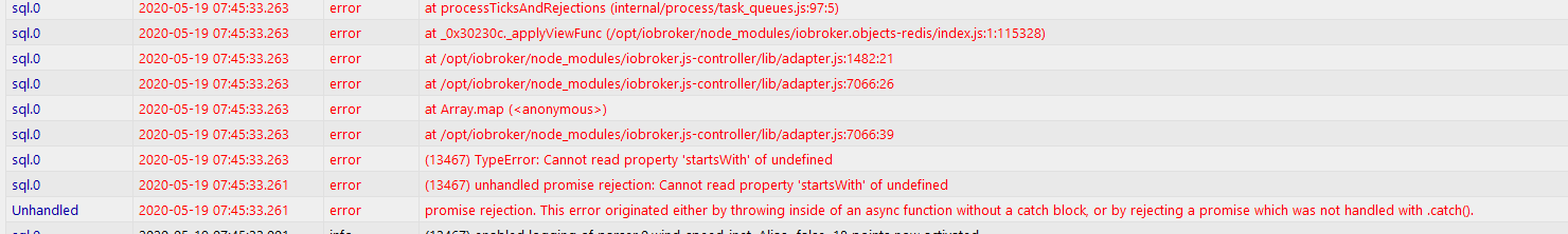

      nach dem update auf 1.13.0 startet der sql adapter nicht mehr.
      folgendes ist im log zu finden.
      sql.0	2020-05-18 18:34:29.779	error	at processTicksAndRejections (internal/process/task_queues.js:97:5)
      sql.0	2020-05-18 18:34:29.779	error	at _0x30230c._applyViewFunc (/opt/iobroker/node_modules/iobroker.objects-redis/index.js:1:115328)
      sql.0	2020-05-18 18:34:29.779	error	at /opt/iobroker/node_modules/iobroker.js-controller/lib/adapter.js:1482:21
      sql.0	2020-05-18 18:34:29.779	error	at /opt/iobroker/node_modules/iobroker.js-controller/lib/adapter.js:7066:26
      sql.0	2020-05-18 18:34:29.779	error	at Array.map (<anonymous>)
      sql.0	2020-05-18 18:34:29.779	error	at /opt/iobroker/node_modules/iobroker.js-controller/lib/adapter.js:7066:39
      sql.0	2020-05-18 18:34:29.779	error	(31880) TypeError: Cannot read property 'startsWith' of undefined
      sql.0	2020-05-18 18:34:29.776	error	(31880) unhandled promise rejection: Cannot read property 'startsWith' of undefined Unhandled	2020-05-18 18:34:29.776	error	promise rejection. This error originated either by throwing inside of an async function without a catch block, or by rejecting a promise which was not handled with .catch().
      sql.0	2020-05-18 18:28:32.141	error	(31422) TypeError: Cannot read property 'startsWith' of undefined at /opt/iobroker/node_modules/iobroker.js-controller/lib/adapter.js:7066:39 at Array.map (<anonymous>) at /opt/iobroker/no
      sql.0	2020-05-18 18:28:32.138	error	(31422) unhandled promise rejection: Cannot read property 'startsWith' of undefined
      sql.0	2020-05-18 18:28:32.138	error	Unhandled promise rejection. This error originated either by throwing inside of an async function without a catch block, or by rejecting a promise which was not handled with .catch().
      Mod-Edit: Code/Log in Code Tags gepackt. Bitte benutzt die Code Tags Funktion -> </>
      Hier gehts zur Hilfe.
        madison last edited by
        nach downgrade auf 1.12.5 läuft der adapter wieder.
        sieht nach einem bug in der version 1.13.0 aus!

          das Gleiche hier:

            C-3po @madison last edited by
            @madison said in sql startet nach update nicht mehr:
            Jo,
            Hier das selbe Ergebnis. Nur seltsam das es in der History noch eine 1.12.6 gibt. Selbige aber nicht Installierbar ist.
            Mit 1.12.5 wieder io.

                Es gibt hierzu auch ein Github Issue: https://github.com/ioBroker/ioBroker.sql/issues/120
                peer69 created this issue in ioBroker/ioBroker.sql
                closed Adapter crashes after update to 1.13.0 #120

                    Habe auch auf die 1.13.0 aktualisiert (Vermute von der 1.12.5). Instanz ist permanent neu gestartet.
                    Habe dann den Downgrade auf 1.12.5 und bekomme seitdem folgende Fehlermeldung.
                    sql.0	2020-05-19 07:34:49.602	info	(4756) No Data
                    sql.0	2020-05-19 07:34:24.964	error	(4756) Error: Packets out of order. Got: 1 Expected: 0
                    Egal welche Version ich auch installiere, die Meldung kommt jetzt immer. Hat jemand ne Idee was das sein könnte?
                    Edit:
                    Downgrade auf 1.9.4 und danach upgrade auf 1.12.5 hat geholfen, warum auch immer...

                      bei mir gleiches Problem, aber Downgrade auf 1.12.5 hat fehlerfrei geklappt. Downgrade von 1.13.0 auf 1.12.6 hat bei mir gar nicht funktioniert.

                        Kann ich auch bestätigen! Das mit der nicht existenten 1.12.6 ist auch fies. Wird ohne Fehler installiert, doch danach ist immer noch 1.13.0 installiert. Wollte schon über die Console installieren als ich diesen Hinweis hier bekam.
                          Berchemer last edited by Berchemer
                          Schließe mich an.
                          Habe jetzt die 1.12.6 gar nicht erst versucht sondern direkt auf 1.12.5 downgegraded und alles ist wieder gut.
                          Danke für die Warnung mit der 1.12.6 🙂

                            Vielen Dank für das Posting. Dachte nur bei mir wäre was im Eimer. 1.12.5 funktiniert auf Anhieb!

                                hat die Version 1.13.1 schon jemand getestet?
                                C Feuersturm 2 Replies Last reply Reply Quote 0
                                • C
                                  @madison
                                  Jupp
                                  eben gerade
                                  Rennt wieder.
