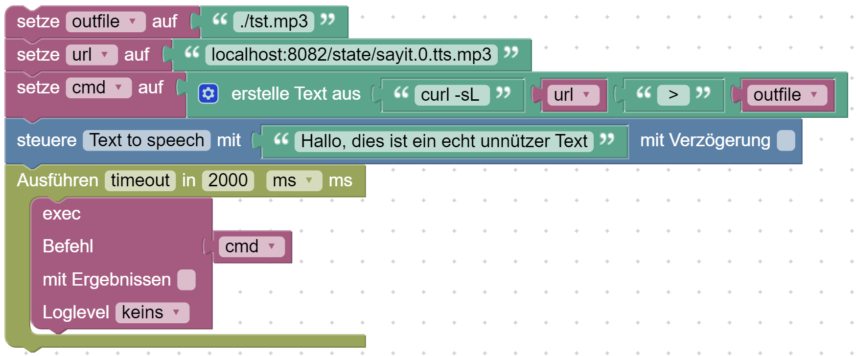

                                fastfoot @fastfoot last edited by
                                @fastfoot sagte in BUG: sayit funktioniert unter win nicht zuverlässig.:
                                evtl. musst du noch den timeout anpassen, je nach Länge deines Textes
                                hier noch eine Version für die Blockly Fraktion
                                 <variables>
                                   <variable id="W~_^HE%Iga5n.*fPdW;B">outfile</variable>
                                   <variable id="z_pVL7.qbcGrbBrmTenF">url</variable>
                                   <variable id="]^eO7?rtWHTfOD)d{,je">cmd</variable>
                                 </variables>
                                 <block type="variables_set" id="K!1=]xXNLcV%_;O8_moY" x="45" y="78">
                                   <field name="VAR" id="W~_^HE%Iga5n.*fPdW;B">outfile</field>
                                     <block type="text" id="D~q[!co?DcpN8GJ^Gm]E">
                                       <field name="TEXT">./tst.mp3</field>
                                     <block type="variables_set" id="UbHJQ7(P?2U*Y39|s_wx">
                                       <field name="VAR" id="z_pVL7.qbcGrbBrmTenF">url</field>
                                         <block type="text" id="Y9N`m/ks7.Lh^~NFl{`)">
                                           <field name="TEXT">localhost:8082/state/sayit.0.tts.mp3</field>
                                         <block type="variables_set" id="!Rv8i+YxzgFe|-!vV43%">
                                           <field name="VAR" id="]^eO7?rtWHTfOD)d{,je">cmd</field>
                                             <block type="text_join" id="mPNwYvTJ@8l:/Db*G*R2" inline="true">
                                               <mutation items="4"></mutation>
                                               <value name="ADD0">
                                                 <block type="text" id="L[7r6VHfZH5DFuXa:ssB">
                                                   <field name="TEXT">curl -sL </field>
                                               <value name="ADD1">
                                                 <block type="variables_get" id="`$*khLv1k;:oTW]_f8Qv">
                                               <value name="ADD2">
                                                 <block type="text" id="4DPjK%Ap5|n:LQ^2C0t=">
                                                   <field name="TEXT"> &gt; </field>
                                               <value name="ADD3">
                                                 <block type="variables_get" id="{x:z]6MCBt`v`$mRN?rh">
                                             <block type="control" id="T9GI)E(k5$yyI;?/r;%?">
                                               <field name="OID">sayit.0.tts.text</field>
                                                 <block type="text" id="!}aB{aNW!yhWO|KPonc=">
                                                   <field name="TEXT">Hallo, dies ist ein echt unnützer Text</field>
                                                 <block type="timeouts_settimeout" id="se9)rFor]=weJDW=dYd%">
                                                   <field name="DELAY">2000</field>
                                                   <field name="UNIT">ms</field>
                                                     <block type="exec" id=";f7mWOxP)C:ATEQq=CCc">
                                                       <mutation xmlns="http://www.w3.org/1999/xhtml" with_statement="false"></mutation>
                                                       <field name="WITH_STATEMENT">FALSE</field>
                                                       <field name="LOG"></field>
                                                       <value name="COMMAND">
                                                         <shadow type="text" id="u-?64-sg%3,3/7HCl.-r">
                                                           <field name="TEXT"></field>
                                                         <block type="variables_get" id="[bCY$YRq2es63B$Q`NPQ">

                                          Durch o.g. Script von @fastfoot konnte ich zuverlässig die mp3 kopieren und damit weiter arbeiten.
                                          Schön dass es endlich funktioniert, hier dann noch die Version mit getBinaryState(), die hat den Vorteil, dass man keine URL braucht sondern direkt mit dem DP arbeiten kann, ausserdem muss bei den beiden anderen Versionen jeweils der WEB-Adapter laufen, das ist hier nicht nötig.
                                          const fs = require('fs');
                                          const idMP3 = 'sayit.0.tts.mp3';
                                          const outfile = '/opt/iobroker/Test.mp3';
                                          setState('sayit.0.tts.text','Hallo, dies ist ein ziemlich unnützer Text');
                                          setTimeout(function(){
                                              getBinaryState(idMP3, function (err, data) {
                                                  fs.writeFile(outfile, data, function (err) {
                                                      if(err) log('Fehler!');
                                          }, 2000);
                                          • apollon77
                                            apollon77 @bahnuhr last edited by
                                            @bahnuhr hey, ich kann am Ende mur wiederholen was ich oben schon zu a gesagt habe: diese Datei ist niemals für eine direkte Benutzung gedacht gewesen. Auch die Cache files nicht.
                                            Von daher ist Lösung c die sinnvollste und richtige.
