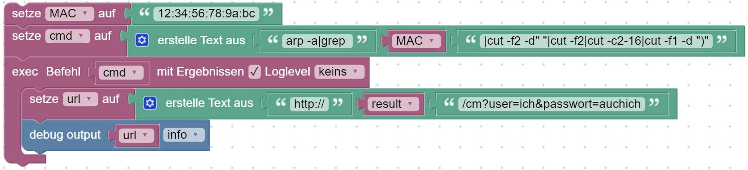

    5. [gelöst] Gerät per Mac Adr & Blockly ansprechen
      fastfoot @Aphofis last edited by

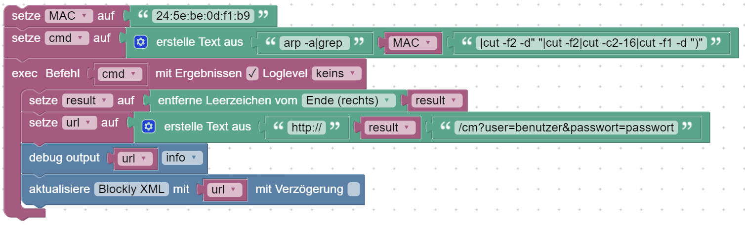

      @Aphofis sagte in Gerät per Mac Adr & Blockly ansprechen:
      @fastfoot
      wohin muss den der block
       <variables>
         <variable id="aQubq9Vy-qj1gT{2OW;x">MAC</variable>
         <variable id="@[II(5R#h[a47`qET5k.">cmd</variable>
         <variable id="Fk6H`kq}eo!FPH!Ld2Ii">result</variable>
         <variable id="0@Y{~/hRy0d:vMQ1kCo@">url</variable>
       </variables>
       <block type="variables_set" id="Gj`MNS[$a0S:B!TUcx-%" x="38" y="138">
         <field name="VAR" id="aQubq9Vy-qj1gT{2OW;x">MAC</field>
           <block type="text" id="V?)NQY:Z1bfh@J6KO8xg">
             <field name="TEXT">24:5e:be:0d:f1:b9</field>
           <block type="variables_set" id="$c5Ud:#38C(q.uOF_;YC">
             <field name="VAR" id="@[II(5R#h[a47`qET5k.">cmd</field>
               <block type="text_join" id="2t+}?FeN#iG0J=~8q#|w" inline="true">
                 <value name="ADD0">
                   <block type="text" id="w;^U.Vi%Z+6O=_j{oVD(">
                     <field name="TEXT">arp -a|grep </field>
                 <value name="ADD1">
                   <block type="variables_get" id="tH;y-cdpJdNS0#XCa8{X">
                 <value name="ADD2">
                   <block type="text" id="/t^Hm3;6![lRLzr3V@FX">
                     <field name="TEXT">|cut -f2 -d" "|cut -f2|cut -c2-16|cut -f1 -d ")"</field>
               <block type="exec" id="Ra4`1SB0/Eog44pt9iJZ" inline="true">
                 <mutation xmlns="http://www.w3.org/1999/xhtml" with_statement="true"></mutation>
                 <field name="WITH_STATEMENT">TRUE</field>
                 <field name="LOG"></field>
                 <value name="COMMAND">
                   <shadow type="text" id="@QX{2frW2vhyd`CI;c:s">
                     <field name="TEXT">arp -a|grep 24:5e:be:0d:f1:b9|cut -f2 -d" "|cut -f2|cut -c2-16|cut -f1 -d ")"</field>
                   <block type="variables_get" id="|uJ{n?p{=za?mcVLIRON">
                   <block type="variables_set" id="?iyp2/H]@8^4[PC2zLRB">
                     <field name="VAR" id="Fk6H`kq}eo!FPH!Ld2Ii">result</field>
                       <block type="text_trim" id="n^cdC!!B_}1rfyX0Jf54">
                         <field name="MODE">RIGHT</field>
                         <value name="TEXT">
                           <shadow type="text">
                             <field name="TEXT">abc</field>
                           <block type="variables_get" id=",|hfzf!Nd.fM|aAqMvS3">
                       <block type="variables_set" id="2;J*T*TpGNH`Ml_U^%63">
                         <field name="VAR" id="0@Y{~/hRy0d:vMQ1kCo@">url</field>
                           <block type="text_join" id="uNUY7tNxUZ3!oh#}bHXB" inline="true">
                             <value name="ADD0">
                               <block type="text" id="2GJK-1Bvmp)s6NC9.,:2">
                                 <field name="TEXT">http://</field>
                             <value name="ADD1">
                               <block type="variables_get" id="/Dkdf,;.$]{U?-+%6q]I">
                             <value name="ADD2">
                               <block type="text" id="W[)hj~HEq7,*GOK28V%|">
                                 <field name="TEXT">/cm?user=benutzer&amp;passwort=passwort</field>
                           <block type="debug" id="?{mh|9:IPCBzf@bm4g=y" inline="true">
                             <value name="TEXT">
                               <shadow type="text" id="g/_Y3S(JG]HJS{wR6YI[">
                               <block type="variables_get" id="63@w*D4._cHwf:)n~#Nh">
                               <block type="update" id="QIux{@Cmil$IGVm2^=AS">
                                 <field name="OID">0_userdata.0.BlocklyXML</field>
                                   <block type="variables_get" id="o09,K@:bm8P/u6/rKMsj">
      Aphofis 1 Reply Last reply Reply Quote 0

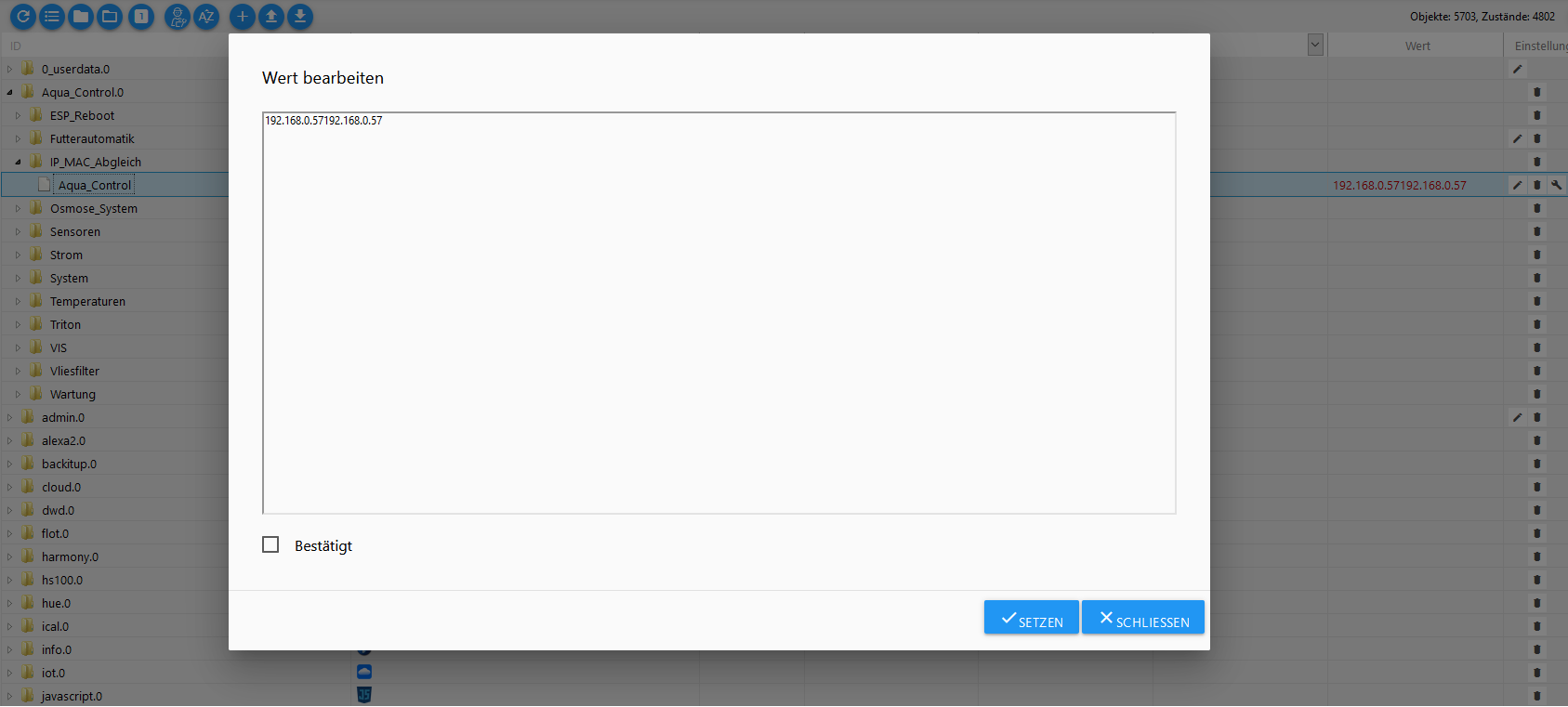

        @fastfoot
        ist nur die Frage warum im Datenpunkt zweimal die IP ausgegeben wird!
        192.168.0.57192.168.0.57
        was sagt denn der LOG, bzw wenn du den DP kopierst? Ist vlt nur eine Sache der Optik, bei mir ist das nicht! Auch nicht mit deinem Blockly

          Aphofis @fastfoot last edited by Aphofis
          @fastfoot sagte in Gerät per Mac Adr & Blockly ansprechen:
          jetzt kommen fehler!!!
          der erste Blockly war besser nur das halt im datenpunkt die IP doppelt angegeben ist

          Kopierte Datenpunkt Ausgabe ist so:
            @Aphofis
            das liegt an deinem DP!!! auch die reine IP ist ein string und keine number. Musst du abändern, ist dann evtl auch der Grund für das doppelte Erscheinen

                • Aphofis
                  @fastfoot
                  ist so trotzdessen doppelte IP
                  Aqua_Control	state     IP MAC Abgleich.Aqua_Control      state	       string			192.168.0.57 192.168.0.57

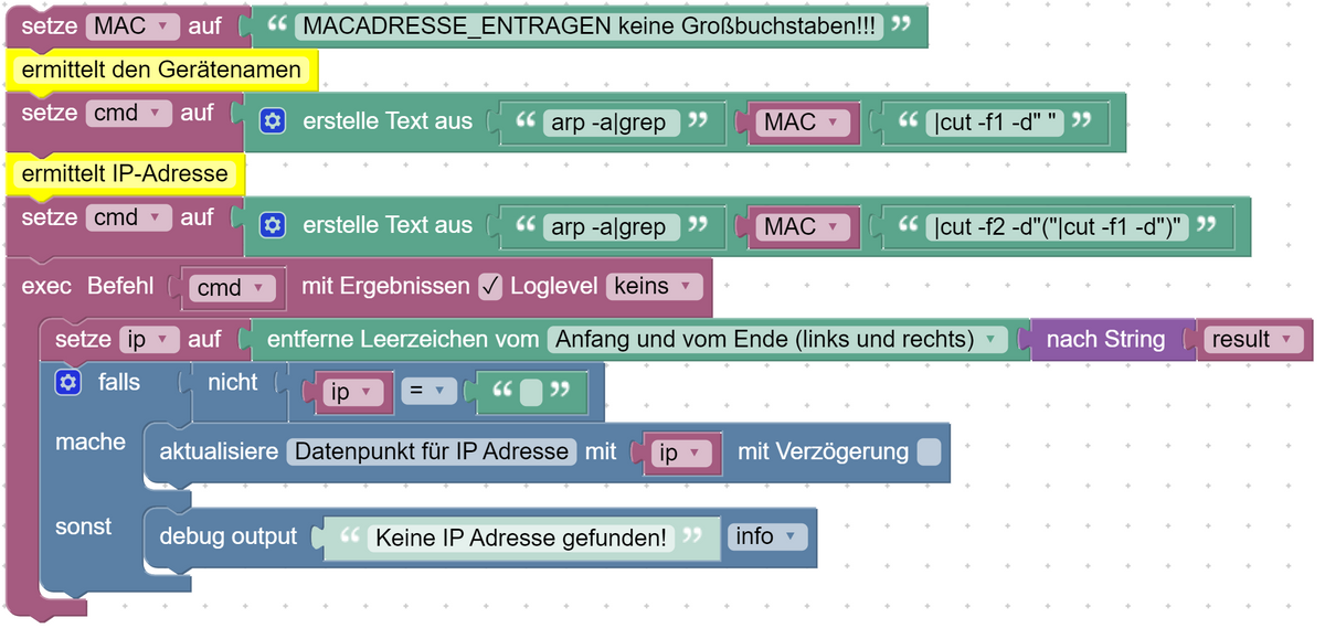

                                      da fällt mir jetzt auch nichts mehr ein, die Länge der IP beträgt 14 Zeichen. Ich denke es liegt an deinem DP oder ein anderes Skrip ist noch im Spiel. Du könntest noch den DP neu erstellen, mit type=string. Ansonsten wäre interessant was denn Andere hier für Ergebnisse haben. Hier noch einmal das Endergebnis:
                                       <variables>
                                         <variable id="0N!Pxj|%o,hrP:$Wm2WE">ip</variable>
                                       </variables>
                                             <field name="TEXT">MACADRESSE_ENTRAGEN keine Großbuchstaben!!!</field>
                                           <block type="comment" id="H;=Y7NT2TXV-Gs]VB$O+">
                                             <field name="COMMENT">ermittelt den Gerätenamen</field>
                                               <block type="variables_set" id="ANCrs)lzX+xxTghREp[.">
                                                   <block type="text_join" id="IxyBhYQL+iZa#PFe)9~7" inline="true">
                                                     <value name="ADD0">
                                                       <block type="text" id="0s)wG{GvjG1.@@+V/aSr">
                                                     <value name="ADD1">
                                                       <block type="variables_get" id="{S|p_K(0Lf_(^t{(8,b?">
                                                     <value name="ADD2">
                                                       <block type="text" id="I^t@Iu.(q%D!J*WaRFQa">
                                                         <field name="TEXT">|cut -f1 -d" "</field>
                                                   <block type="comment" id="+Ys6+MxbbJZ#NA)9)0{2">
                                                     <field name="COMMENT">ermittelt IP-Adresse</field>
                                                             <value name="ADD0">
                                                             <value name="ADD1">
                                                             <value name="ADD2">
                                                                 <field name="TEXT">|cut -f2 -d"("|cut -f1 -d")"</field>
                                                           <block type="exec" id="2!bNa75D5snVE!jky@@." inline="true">
                                                               <shadow type="text" id="^!S#xfBrYSkE3IIEA|rP">
                                                               <block type="variables_get" id="OCMYegrGVigEscI9|L(L">
                                                               <block type="variables_set" id="L]J.=sLuX-3~:q^phHdI">
                                                                 <field name="VAR" id="0N!Pxj|%o,hrP:$Wm2WE">ip</field>
                                                                   <block type="text_trim" id="ieQ%=JdT2@lsW*HynVxx">
                                                                     <field name="MODE">BOTH</field>
                                                                     <value name="TEXT">
                                                                       <shadow type="text" id="PYvpEBV*CvA*:pz@RD@9">
                                                                       <block type="convert_tostring" id="Lm-b^FX_25OE0xK.;2lJ">
                                                                           <block type="variables_get" id="=({0X#Vd(gZfW5P7YuI(">
                                                                   <block type="controls_if" id="z`?p:wuv4qf@FB.^P`IN">
                                                                       <block type="logic_negate" id="oS4QJFW.#h11BEG)C]6#">
                                                                         <value name="BOOL">
                                                                           <block type="logic_compare" id="kmSbl@isO%v0V2M2KV%q">
                                                                             <field name="OP">EQ</field>
                                                                               <block type="variables_get" id="!2hJmAo:{WQVvmo#MSpw">
                                                                               <block type="text" id="D,uO-gM;I-Q]GD6b~D,0">
                                                                                 <field name="TEXT"></field>
                                                                       <block type="update" id="[8fA(|Z;CZFWcXyOVkM.">
                                                                         <field name="OID">0_userdata.0.ipaddress</field>
                                                                           <block type="variables_get" id="57Ns7WblYc`pSoPfT[we">
                                                                     <statement name="ELSE">
                                                                       <block type="debug" id="[[H]7mGw_,7D]-2K[vi9" inline="true">
                                                                         <value name="TEXT">
                                                                           <shadow type="text" id="FP4|qtV]4IE}b_oww8Gh">
                                                                             <field name="TEXT">Keine IP Adresse gefunden!</field>
                                      • liv-in-sky
                                        liv-in-sky @fastfoot last edited by liv-in-sky
                                        @fastfoot
                                        habe es getestet - arp funktioniert jetzt bei mir
                                        die richtge ipadresse steht im datenpunkt - so wie es sein soll
                                          fastfoot @liv-in-sky last edited by fastfoot
                                          @liv-in-sky sagte in Gerät per Mac Adr & Blockly ansprechen:
                                          @fastfoot
                                          Danke fürs Testen, somit bleibt nur die Fage weshalb es beim Fragesteller doppelt eingetragen wird.

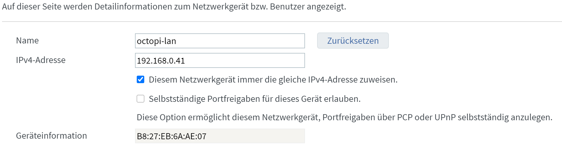

                                            @fastfoot
                                            Also ich hab den DP noch mal neu erstellt und den Blockly Code komplett noch mal neu gemacht und ich hatte mal in der Pi Konsole den Befehl eingegeben und arp postet zweimal den Geräte Namen und keine IP adresse!
                                            arp -a|grep 2c:f4:32:57:b7:14 |cut -f1 -d" "
                                            ergibt in der Konsolen Ausgabe folgendes
                                            Aqua-Control.fritz.box
                                            gebe ich die zweite abfrage in die Konsole ein! kommt das
                                            pi@AquaPi:~ $ arp -a|grep 2c:f4:32:57:b7:14 |cut -f2 -d"("|cut -f1 -d")"
                                            192.168.0.5
                                            192.168.0.57
                                            192.168.0.5
                                            Wieder hat das Gerät in der Fritzbox eine neue IP bekommen vorher war es die 57 jetzt ist es die 5 obwohl die 57 für das Gerät fixiert ist. Ich weiß auch nicht mehr weiter
