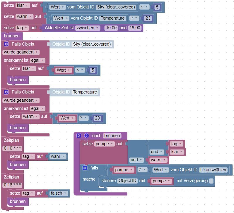

                    paul53 @ludino last edited by paul53
                    @ludino sagte:
                    wenn keine Wolken oder so am Himmel sind.
                    "weatherunderground.0.forecastHourly.0h.sky" zeigt den Bewölkungsgrad.
                     <variables>
                       <variable id=",M31ZIHriy(;VTv#AabD">klar</variable>
                       <variable id="z)bBrT_=Qa}nntTZyK]t">pumpe</variable>
                       <variable id="J6UJa*F5f#(..*aQUelj">warm</variable>
                       <variable id="iDUQK#=PvhD$XCt1$7TB">tag</variable>
                     </variables>
                     <block type="variables_set" id="GqifyOyD:O]k~eJ3y!5%" x="112" y="-63">
                       <field name="VAR" id=",M31ZIHriy(;VTv#AabD">klar</field>
                         <block type="logic_compare" id="hPYymt1#X.H=)4_OTyH*">
                           <field name="OP">LT</field>
                             <block type="get_value" id="=L=H%QR)T9wg@pUGqjAF">
                               <field name="OID">weatherunderground.0.forecastHourly.0h.sky</field>
                             <block type="math_number" id="!z0[S|Iz)wcUOy#+g%+5">
                               <field name="NUM">5</field>
                         <block type="variables_set" id="DMB@g$d?{X|WwJ5[(*iN">
                           <field name="VAR" id="J6UJa*F5f#(..*aQUelj">warm</field>
                             <block type="logic_compare" id="JNUNK5Ki=?}_h.rPZ*dC">
                               <field name="OP">GTE</field>
                                 <block type="get_value" id="Yqao*$4xuQ|$DR}`1s3K">
                                   <field name="OID">weatherunderground.0.forecastHourly.0h.temp</field>
                                 <block type="math_number" id=";pX+k0vIBdBg1aVvKY@R">
                                   <field name="NUM">23</field>
                             <block type="variables_set" id=",bUQt9cy]3[.!Ks)*tci">
                               <field name="VAR" id="iDUQK#=PvhD$XCt1$7TB">tag</field>
                                 <block type="time_compare" id="_~_gcv8RFP)g|TT^)GfV">
                                   <mutation xmlns="http://www.w3.org/1999/xhtml" end_time="true"></mutation>
                                   <field name="START_TIME">10:00</field>
                                   <field name="END_TIME">16:00</field>
                                 <block type="procedures_callnoreturn" id="[,Z.57D?maKZn8;a034C">
                                   <mutation name="brunnen"></mutation>
                                     <block type="on_ext" id="G,4a0%9h^oM]/]YjMy^?">
                                       <value name="OID0">
                                         <shadow type="field_oid" id="V-xsTXHio}fBZffuETLI">
                                           <field name="oid">weatherunderground.0.forecastHourly.0h.sky</field>
                                         <block type="variables_set" id="|A/S2w[w,ATG!oU,N,tX">
                                             <block type="logic_compare" id="Dq)AkU/7P?Bs6zXm~Vq[">
                                                 <block type="on_source" id="lLtD~VhI0%nGZJ,f4}=t">
                                                 <block type="math_number" id=":G!Psg~Oor5Zf11[@x,E">
                                             <block type="procedures_callnoreturn" id="v1W.eS@:RWXTEq?TKVc3">
                                         <block type="on_ext" id="Luxc,f2koS4})TMAt+67">
                                           <value name="OID0">
                                             <shadow type="field_oid" id="85l=_1{:i}`gQ:qJL}.Z">
                                               <field name="oid">weatherunderground.0.forecastHourly.0h.temp</field>
                                             <block type="variables_set" id="jp=*S-M6~u5wu3Yf3NR}">
                                                 <block type="logic_compare" id="R+tcC)P-#%*rd%1cJ;3t">
                                                     <block type="on_source" id="]pRi71f/t61Yh9U=prsr">
                                                     <block type="math_number" id="H}O23feXzQON`4eDw!De">
                                                 <block type="procedures_callnoreturn" id="xejO1ZRhE0q^mB@rC,2c">
                                             <block type="schedule" id="{_u3e:-{yb|2HNhtxw4z">
                                               <field name="SCHEDULE">0 10 * * *</field>
                                                 <block type="variables_set" id="3{xDEMIYa6=p{k^4ore-">
                                                     <block type="logic_boolean" id="-k9eykRfZTx|V!iTWDTH">
                                                     <block type="procedures_callnoreturn" id="IMGyR6.}I),dR805JJbg">
                                                 <block type="schedule" id="R5*C-VR*0|@eaDpd;{1z">
                                                   <field name="SCHEDULE">0 16 * * *</field>
                                                     <block type="variables_set" id="3h8ZSPW?Qwm57rr;YEEp">
                                                         <block type="logic_boolean" id="4_cKvoa2?c5@Wm/)o5p3">
                                                         <block type="procedures_callnoreturn" id="zBMW;!_@@$hxQ^xU[rq7">
                     <block type="procedures_defnoreturn" id="vzGMQ,t2DcGWWUAdkFqw" x="362" y="387">
                       <field name="NAME">brunnen</field>
                       <statement name="STACK">
                         <block type="variables_set" id="zWk*}({DUc7Pd=qhz!II">
                           <field name="VAR" id="z)bBrT_=Qa}nntTZyK]t">pumpe</field>
                             <block type="logic_operation" id="G{W:SE]wzuk,)PBv00ll" inline="false">
                               <field name="OP">AND</field>
                                 <block type="logic_operation" id="qx]wOPscc{gEJuFBz$$B" inline="false">
                                     <block type="variables_get" id="_^G%eS:^u+o#W:xByTgP">
                                     <block type="variables_get" id="PdZSfAj6TZLOHZuE4g#V">
                                 <block type="variables_get" id="sM{|2T!!TpLvoJXEd(wE">
                             <block type="controls_if" id="0nrCy5=7SznT.aaV2W,O">
                                 <block type="logic_compare" id="Y^q#3@j)YK79`273n*=H">
                                   <field name="OP">NEQ</field>
                                     <block type="variables_get" id="0MZE@27S-tLv!D]2MmKe">
                                     <block type="get_value" id="jU,iT51B6xN%Aqd#|-7W">
                                       <field name="OID">ID auswählen</field>
                                 <block type="control" id="o1,Sl?cF:wXh]0BDACtL">
                                     <block type="variables_get" id="![S{0H,(Fvlued*cZ9=^">

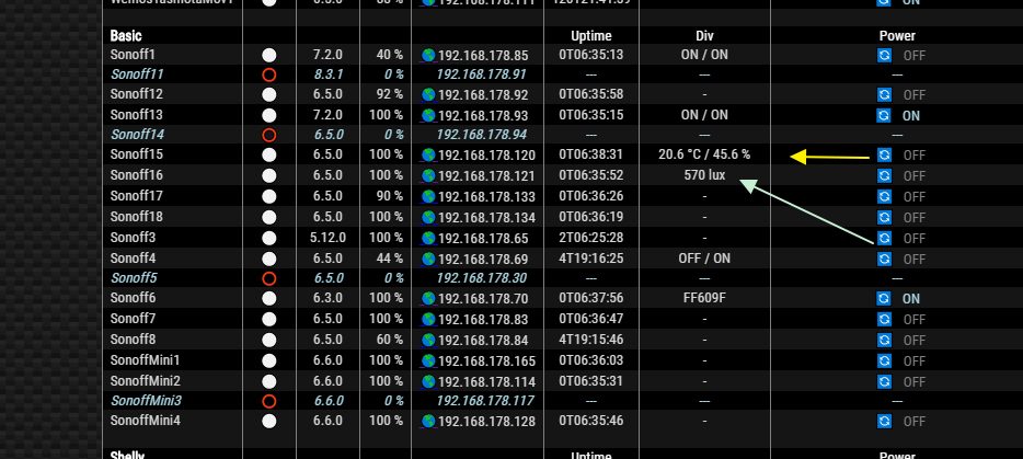

                    • liv-in-sky
                      liv-in-sky @ludino last edited by liv-in-sky
                      @ludino bei mir stimmen die wetterdaten eigentlich fast nie - liegt wohl an der gegend
                      habe daher einen sonoff (tasmota) mit lichtmesser am fenster verbaut und einen sonoff mit tempfühler (sonoff innen - tempfühler außerhalb)
                      damit kann man das alles sehr einfach steuern und hat die tatsächlichen werte

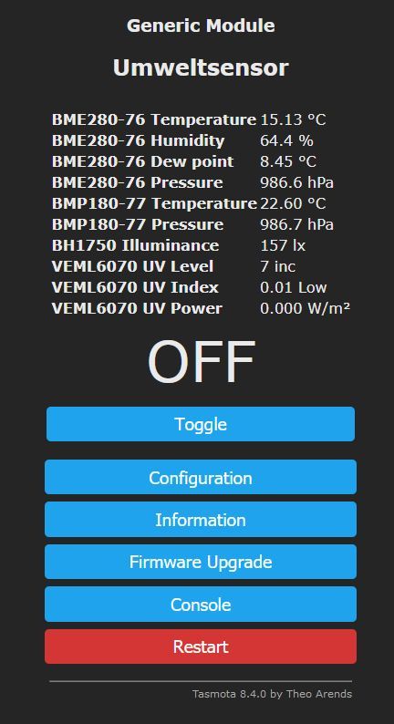

                        • Chaot
                          Chaot @ludino last edited by
                          @ludino
                          Warum machst du dir keinen passenden Sensor dran. Ich würde da einen BH1750 nehmen und dann auf den gewünschten Helligkeitswert triggern. Werte kommen über den Sonoff Adapter in den iobroker.
                          Der VEML 6070 macht nur die reine UV Strahlung und zeigt auch teilweise bei leichter Bewölkung an. Beim BH1750 hast du direkt den Helligkeitswert. Dazu noch eine kleine Verzögerung falls gerade mal eine Wolke durchhuscht oder sich einer vor den Sensor stellt und fertig sollte es sein.
