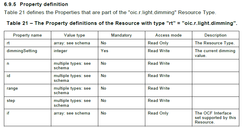

      2020-10-20 13_11_27-OCF_Resource_Type_Specification_v2.2.0.pdf - Example Light Dimming.png
      Source: OCF Spec v.2.2.0 Resource Types

          Example oic.r.light.dimming:
            "swagger": "2.0",
            "info": {
              "title": "Dimming",
              "version": "2019-02-15",
              "license": {
                "name": "OCF Data Model License",
                "url": "https://github.com/openconnectivityfoundation/core/blob/e28a9e0a92e17042ba3e83661e4c0fbce8bdc4ba/LICENSE.md",
                "x-copyright": "copyright 2016-2017, 2019 Open Connectivity Foundation, Inc. All rights reserved."
              "termsOfService": "https://openconnectivityfoundation.github.io/core/DISCLAIMER.md"
            "schemes": ["http"],
            "consumes": ["application/json"],
            "produces": ["application/json"],
            "paths": {
              "/DimmingResURI" : {
                "get": {
                  "description": "This Resource describes a dimming function.\nThe Property \"dimmingSetting\" is an integer showing the current dimming level.\nIf Property \"step\" is present then it represents the increment between dimmer values.\nWhen the Property \"range\" is omitted, then the range is [0,100].\nA value of 0 means total dimming; a value of 100 means no dimming.",
                  "parameters": [
                    {"$ref": "#/parameters/interface"}
                  "responses": {
                      "200": {
                        "description" : "",
                        "x-example":
                            "rt": ["oic.r.light.dimming"],
                            "if": ["oic.if.a", "oic.if.baseline"],
                            "dimmingSetting": 30,
                            "step": 5,
                            "range": [0, 100]
                        "schema": { "$ref": "#/definitions/Dimming" }
                "post": {
                  "description": "Sets the desired dimming level.\n",
                  "parameters": [
                    {"$ref": "#/parameters/interface"},
                      "name": "body",
                      "in": "body",
                      "required": true,
                      "schema": { "$ref": "#/definitions/Dimming" },
                      "x-example":
                          "dimmingSetting": 40
                  "responses": {
                      "200": {
                        "description" : "Indicates that the dimming was changed.\nThe new dimming level is provided in the response.\n",
                        "x-example":
                      "403": {
                        "description": "This response is generated by the OCF Server when the client sends:\n  An update with an out of range property value for dimmingSetting.\nThe server responds with the current resource representation.\n",
                        "x-example":
            "parameters": {
              "interface": {
                "in": "query",
                "name": "if",
                "type": "string",
                "enum": ["oic.if.a", "oic.if.baseline"]
            "definitions": {
              "Dimming" : {
                "properties": {
                  "rt": {
                    "description": "The Resource Type.",
                    "items": {
                      "enum": ["oic.r.light.dimming"],
                      "maxLength": 64,
                      "type": "string"
                    "minItems": 1,
                    "uniqueItems": true,
                    "readOnly": true,
                    "type": "array"
                  "dimmingSetting": {
                    "description": "The current dimming value.",
                    "type": "integer"
                  "n": {
                      "$ref": "https://openconnectivityfoundation.github.io/core/schemas/oic.common.properties.core-schema.json#/definitions/n"
                  "id": {
                      "$ref": "https://openconnectivityfoundation.github.io/core/schemas/oic.common.properties.core-schema.json#/definitions/id"
                  "range": {
                      "$ref": "https://openconnectivityfoundation.github.io/IoTDataModels/schemas/oic.baseresource.properties-schema.json#/definitions/range_integer"
                  "step": {
                      "$ref": "https://openconnectivityfoundation.github.io/IoTDataModels/schemas/oic.baseresource.properties-schema.json#/definitions/step_integer"
                  "if": {
                    "description": "The OCF Interface set supported by this Resource.",
                    "items": {
                      "enum": [
                        "oic.if.a",
                        "oic.if.baseline"
                      "type": "string"
                    "minItems": 2,
                    "readOnly": true,
                    "type": "array"
                "type": "object",
                "required": ["dimmingSetting"]
          Source: https://openconnectivityfoundation.github.io/IoTDataModels/DimmingResURI.swagger.json
