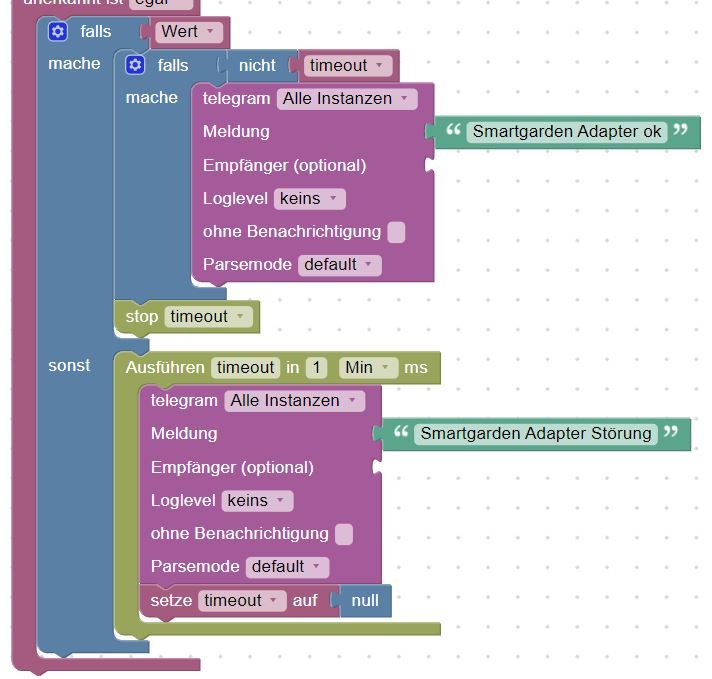

        paul53 @chucky666 last edited by
        @chucky666 sagte:
        Leider bekomme ich bei jedem neustart des Adapter eine Meldung .
        Versuche es mal so:
         <variables>
         </variables>
         <block type="on" id="|oop/yS.D[S_H*w}l6;V" x="112" y="37">
             <block type="controls_if" id="e/A!Tz|8n7UWCm5SO)jG">
                 <block type="on_source" id="c0WO7s!s*4$Gmyx[xssS">
                 <block type="controls_if" id="Y|V8*2_{ic|%8)]u[2ts">
                     <block type="logic_negate" id="3fWb[pkbwMoEVU8$Lr7b">
                       <value name="BOOL">
                         <block type="variables_get" id="USQ9;9*#vfqFR,L`Juu[">
                           <field name="VAR" id="timeout" variabletype="timeout">timeout</field>
                     <block type="telegram" id="/6bh]nUVoKpB_7ot~+h]">
                       <field name="LOG"></field>
                       <value name="MESSAGE">
                         <shadow type="text" id="{/wxo2z-FQ$c4~]Ec8m)">
                         <block type="text" id="Y*`#d^P/A5$qamow5RLD">
                           <field name="TEXT">Smartgarden Adapter ok</field>
                     <block type="timeouts_cleartimeout" id="GFora}/C60=HhgNOL?,^">
               <statement name="ELSE">
                 <block type="timeouts_settimeout" id="KgDG$r~4{k]6JcCO[Mzk">
                   <field name="DELAY">1</field>
                     <block type="telegram" id="~vm]dQCXFngAQa/2$4|k">
                         <shadow type="text" id="=P0W9{KgAZs}9]Ostb!S">
                         <block type="text" id=".[ToY].Zy`f:.a`69;qY">
                           <field name="TEXT">Smartgarden Adapter Störung</field>
                         <block type="variables_set" id="JE2^;d+uxFURDmS1`+w^">
                             <block type="logic_null" id="o18@I|^(~@jot*C:-w6v"></block>

          @paul53 sagte in Telegram Meldung wenn Adapter in störung:
          <xml xmlns="https://developers.google.com/blockly/xml"> <variables> <variable type="timeout" id="timeout">timeout</variable> </variables> <block type="on" id="|oop/yS.D[S_Hw}l6;V" x="112" y="37"> <field name="OID">Object ID</field> <field name="CONDITION">ne</field> <field name="ACK_CONDITION"></field> <statement name="STATEMENT"> <block type="controls_if" id="e/A!Tz|8n7UWCm5SO)jG"> <mutation else="1"></mutation> <value name="IF0"> <block type="on_source" id="c0WO7s!s4$Gmyx[xssS"> <field name="ATTR">state.val</field> </block> </value> <statement name="DO0"> <block type="controls_if" id="Y|V82_{ic|%8)]u[2ts"> <value name="IF0"> <block type="logic_negate" id="3fWb[pkbwMoEVU8$Lr7b"> <value name="BOOL"> <block type="variables_get" id="USQ9;9#vfqFR,LJuu["> <field name="VAR" id="timeout" variabletype="timeout">timeout</field> </block> </value> </block> </value> <statement name="DO0"> <block type="telegram" id="/6bh]nUVoKpB_7ot~+h]"> <field name="INSTANCE"></field> <field name="LOG"></field> <field name="SILENT">FALSE</field> <field name="PARSEMODE">default</field> <value name="MESSAGE"> <shadow type="text" id="{/wxo2z-FQ$c4~]Ec8m)"> <field name="TEXT">text</field> </shadow> <block type="text" id="Y*#d^P/A5$qamow5RLD"> <field name="TEXT">Smartgarden Adapter ok</field> </block> </value> </block> </statement> <next> <block type="timeouts_cleartimeout" id="GFora}/C60=HhgNOL?,^"> <field name="NAME">timeout</field> </block> </next> </block> </statement> <statement name="ELSE"> <block type="timeouts_settimeout" id="KgDG$r~4{k]6JcCO[Mzk"> <field name="NAME">timeout</field> <field name="DELAY">1</field> <field name="UNIT">min</field> <statement name="STATEMENT"> <block type="telegram" id="~vm]dQCXFngAQa/2$4|k"> <field name="INSTANCE"></field> <field name="LOG"></field> <field name="SILENT">FALSE</field> <field name="PARSEMODE">default</field> <value name="MESSAGE"> <shadow type="text" id="=P0W9{KgAZs}9]Ostb!S"> <field name="TEXT">text</field> </shadow> <block type="text" id=".[ToY].Zyf:.a69;qY"> <field name="TEXT">Smartgarden Adapter Störung</field> </block> </value> <next> <block type="variables_set" id="JE2^;d+uxFURDmS1`+w^"> <field name="VAR" id="timeout" variabletype="timeout">timeout</field> <value name="VALUE"> <block type="logic_null" id="o18@I|^(~@jot*C:-w6v"></block> </value> </block> </next> </block> </statement> </block> </statement> </block> </statement> </block> </xml>
          danke für deine Hilfe
          leider klappt es nicht, wenn ich den adapter Neustarte, bekomme ich 2 nachrichten mit Störung
            paul53 @chucky666 last edited by paul53
            @chucky666 sagte:
            Dann ist wohl eine Minute zu kurz ?
            Wird auf "wurde geändert" getriggert ?
            chucky666 1 Reply Last reply Reply Quote 0

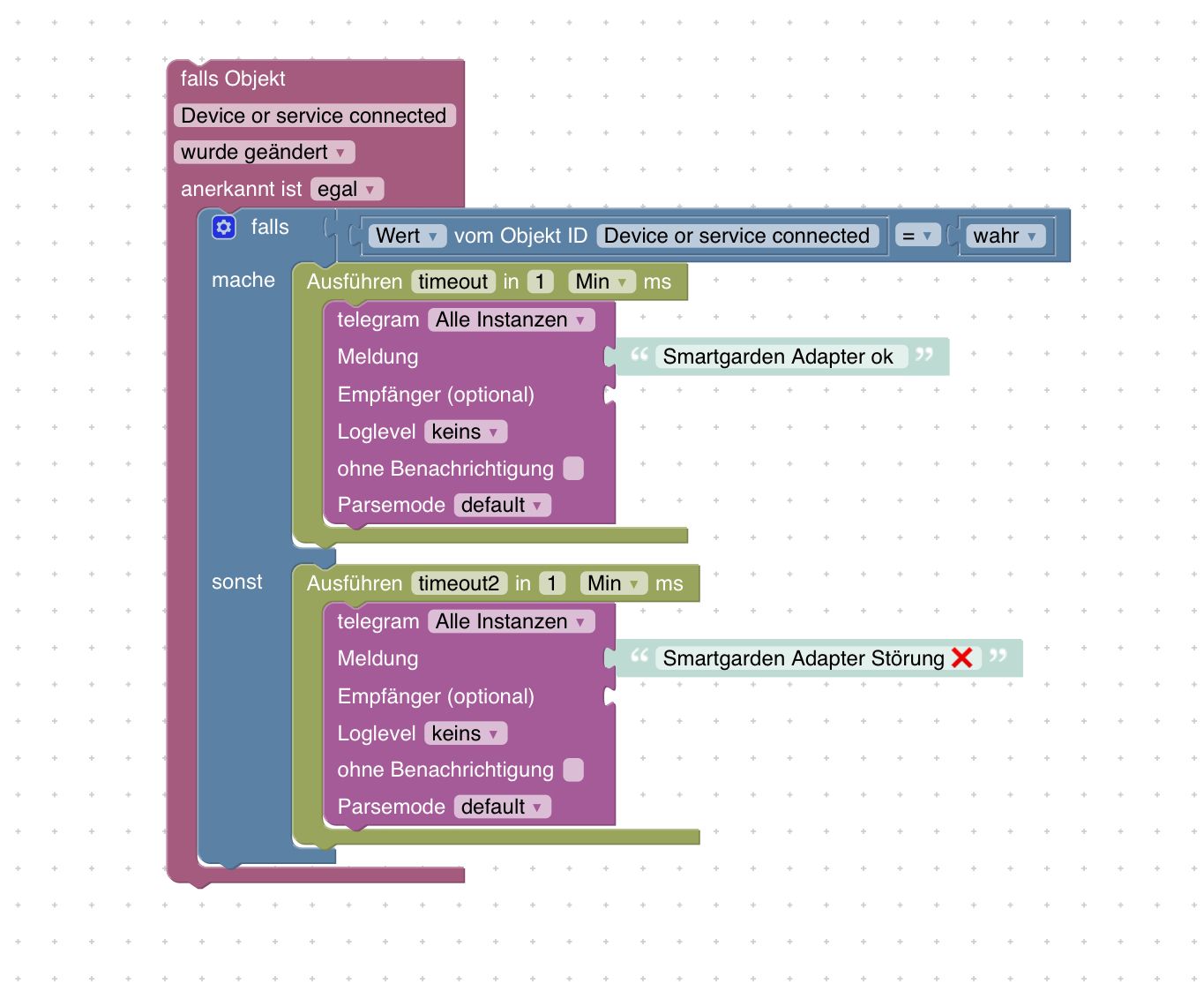

            • chucky666
              chucky666 @paul53 last edited by
              @chucky666 sagte:
              ich versuche mal 5 min
              ja ist auf wurde geändert
              • chucky666
                gleiches spiel . wenn ich den Adapter ausschalte und wieder anschalte , kommt nach ca.5 min die Meldung Störung
                  @chucky666 sagte:
                  Obwohl der Datenpunkt "Device or service connected" auf true wechselt ? Dann poste bitte den erzeugten Javascript-Code ohne die letzte Zeile in Code tags.
                  • chucky666
                    @chucky666 sagte:
                    ich muss jetzt erstmal zur Arbeit
                    ich glaube ich habe den falschen Datenpunkt
                    • chucky666
                      Jetzt klappt es , danke
