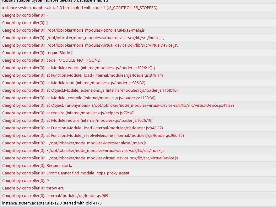

              bei mir erscheinen die gleichen Fehlermeldungen seit dem Update auf 3.2.8.
              host.raspberrypi	2020-07-17 13:46:15.780	error	instance system.adapter.alexa2.0 terminated with code 1 (JS_CONTROLLER_STOPPED)
              host.raspberrypi	2020-07-17 13:46:15.779	error	Caught by controller[0]: }
              host.raspberrypi	2020-07-17 13:46:15.779	error	Caught by controller[0]: ]
              host.raspberrypi	2020-07-17 13:46:15.779	error	Caught by controller[0]: '/opt/iobroker/node_modules/iobroker.alexa2/main.js'
              host.raspberrypi	2020-07-17 13:46:15.778	error	Caught by controller[0]: '/opt/iobroker/node_modules/virtual-device-sdk/lib/src/Index.js',
              host.raspberrypi	2020-07-17 13:46:15.778	error	Caught by controller[0]: '/opt/iobroker/node_modules/virtual-device-sdk/lib/src/VirtualDevice.js',
              host.raspberrypi	2020-07-17 13:46:15.778	error	Caught by controller[0]: requireStack: [
              host.raspberrypi	2020-07-17 13:46:15.778	error	Caught by controller[0]: code: 'MODULE_NOT_FOUND',
              host.raspberrypi	2020-07-17 13:46:15.778	error	Caught by controller[0]: at Module.require (internal/modules/cjs/loader.js:1026:19) {
              host.raspberrypi	2020-07-17 13:46:15.777	error	Caught by controller[0]: at Function.Module._load (internal/modules/cjs/loader.js:879:14)
              host.raspberrypi	2020-07-17 13:46:15.777	error	Caught by controller[0]: at Module.load (internal/modules/cjs/loader.js:986:32)
              host.raspberrypi	2020-07-17 13:46:15.777	error	Caught by controller[0]: at Object.Module._extensions..js (internal/modules/cjs/loader.js:1158:10)
              host.raspberrypi	2020-07-17 13:46:15.777	error	Caught by controller[0]: at Module._compile (internal/modules/cjs/loader.js:1138:30)
              host.raspberrypi	2020-07-17 13:46:15.776	error	Caught by controller[0]: at Object.<anonymous> (/opt/iobroker/node_modules/virtual-device-sdk/lib/src/VirtualDevice.js:41:23)
              host.raspberrypi	2020-07-17 13:46:15.776	error	Caught by controller[0]: at require (internal/modules/cjs/helpers.js:72:18)
              host.raspberrypi	2020-07-17 13:46:15.776	error	Caught by controller[0]: at Module.require (internal/modules/cjs/loader.js:1026:19)
              host.raspberrypi	2020-07-17 13:46:15.776	error	Caught by controller[0]: at Function.Module._load (internal/modules/cjs/loader.js:842:27)
              host.raspberrypi	2020-07-17 13:46:15.775	error	Caught by controller[0]: at Function.Module._resolveFilename (internal/modules/cjs/loader.js:966:15)
              host.raspberrypi	2020-07-17 13:46:15.775	error	Caught by controller[0]: - /opt/iobroker/node_modules/iobroker.alexa2/main.js
              host.raspberrypi	2020-07-17 13:46:15.775	error	Caught by controller[0]: - /opt/iobroker/node_modules/virtual-device-sdk/lib/src/Index.js
              host.raspberrypi	2020-07-17 13:46:15.775	error	Caught by controller[0]: - /opt/iobroker/node_modules/virtual-device-sdk/lib/src/VirtualDevice.js
              host.raspberrypi	2020-07-17 13:46:15.774	error	Caught by controller[0]: Require stack:
              host.raspberrypi	2020-07-17 13:46:15.774	error	Caught by controller[0]: Error: Cannot find module 'https-proxy-agent'
              host.raspberrypi	2020-07-17 13:46:15.774	error	Caught by controller[0]: ^
              host.raspberrypi	2020-07-17 13:46:15.773	error	Caught by controller[0]: throw err;
              host.raspberrypi	2020-07-17 13:46:15.773	error	Caught by controller[0]: internal/modules/cjs/loader.js:969

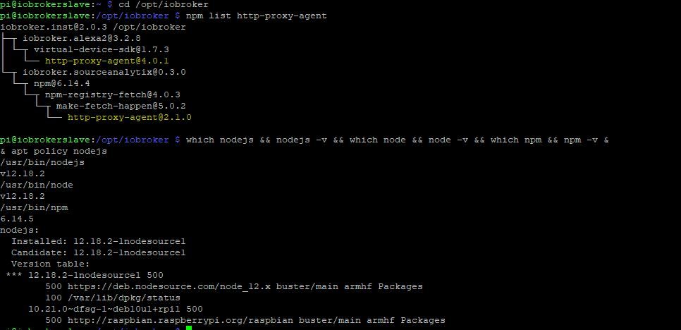

              pi@raspberrypi:~ $ cd /opt/iobroker/
              pi@raspberrypi:/opt/iobroker $ npm list http-proxy-agent
              iobroker.inst@2.0.3 /opt/iobroker
              ├─┬ iobroker.alexa2@3.2.8
              │ └─┬ virtual-device-sdk@1.7.3
              │   └── http-proxy-agent@4.0.1
              ├─┬ iobroker.unifi@0.5.5
              │ └─┬ node-unifi@1.3.3
              │   └─┬ snyk@1.346.0
              │     └─┬ proxy-agent@3.1.1
              │       ├── http-proxy-agent@2.1.0
              │       └─┬ pac-proxy-agent@3.0.1
              │         └── http-proxy-agent@2.1.0
              └─┬ iobroker.vis-weather@2.5.2
                └─┬ npm@6.14.5
                  └─┬ npm-registry-fetch@4.0.4
                    └─┬ make-fetch-happen@5.0.2
              /usr/bin/nodejs
              v12.18.2
              /usr/bin/node
              v12.18.2
              /usr/bin/npm
              6.14.5
                Installed: 12.18.2-1nodesource1
                Candidate: 12.18.2-1nodesource1
               *** 12.18.2-1nodesource1 500
                      500 https://deb.nodesource.com/node_12.x buster/main arm64 Packages
                   10.21.0~dfsg-1~deb10u1 500
                      500 http://deb.debian.org/debian-security buster/updates/main arm64 Packages
                   10.19.0~dfsg1-1 500
                      500 http://deb.debian.org/debian buster/main arm64 Packages

                                        host.raspberrypi	2020-07-19 14:20:20.839	error	instance system.adapter.alexa2.0 terminated with code 1 (JS_CONTROLLER_STOPPED)
                                        host.raspberrypi	2020-07-19 14:20:20.839	error	Caught by controller[0]: }
                                        host.raspberrypi	2020-07-19 14:20:20.838	error	Caught by controller[0]: ]
                                        host.raspberrypi	2020-07-19 14:20:20.838	error	Caught by controller[0]: '/opt/iobroker/node_modules/iobroker.alexa2/main.js'
                                        host.raspberrypi	2020-07-19 14:20:20.838	error	Caught by controller[0]: '/opt/iobroker/node_modules/virtual-device-sdk/lib/src/Index.js',
                                        host.raspberrypi	2020-07-19 14:20:20.838	error	Caught by controller[0]: '/opt/iobroker/node_modules/virtual-device-sdk/lib/src/VirtualDevice.js',
                                        host.raspberrypi	2020-07-19 14:20:20.838	error	Caught by controller[0]: requireStack: [
                                        host.raspberrypi	2020-07-19 14:20:20.838	error	Caught by controller[0]: code: 'MODULE_NOT_FOUND',
                                        host.raspberrypi	2020-07-19 14:20:20.837	error	Caught by controller[0]: at Module.require (internal/modules/cjs/loader.js:1026:19) {
                                        host.raspberrypi	2020-07-19 14:20:20.837	error	Caught by controller[0]: at Function.Module._load (internal/modules/cjs/loader.js:879:14)
                                        host.raspberrypi	2020-07-19 14:20:20.837	error	Caught by controller[0]: at Module.load (internal/modules/cjs/loader.js:986:32)
                                        host.raspberrypi	2020-07-19 14:20:20.837	error	Caught by controller[0]: at Object.Module._extensions..js (internal/modules/cjs/loader.js:1158:10)
                                        host.raspberrypi	2020-07-19 14:20:20.837	error	Caught by controller[0]: at Module._compile (internal/modules/cjs/loader.js:1138:30)
                                        host.raspberrypi	2020-07-19 14:20:20.836	error	Caught by controller[0]: at Object.<anonymous> (/opt/iobroker/node_modules/virtual-device-sdk/lib/src/VirtualDevice.js:41:23)
                                        host.raspberrypi	2020-07-19 14:20:20.836	error	Caught by controller[0]: at require (internal/modules/cjs/helpers.js:72:18)
                                        host.raspberrypi	2020-07-19 14:20:20.836	error	Caught by controller[0]: at Module.require (internal/modules/cjs/loader.js:1026:19)
                                        host.raspberrypi	2020-07-19 14:20:20.836	error	Caught by controller[0]: at Function.Module._load (internal/modules/cjs/loader.js:842:27)
                                        host.raspberrypi	2020-07-19 14:20:20.836	error	Caught by controller[0]: at Function.Module._resolveFilename (internal/modules/cjs/loader.js:966:15)
                                        host.raspberrypi	2020-07-19 14:20:20.835	error	Caught by controller[0]: - /opt/iobroker/node_modules/iobroker.alexa2/main.js
                                        host.raspberrypi	2020-07-19 14:20:20.835	error	Caught by controller[0]: - /opt/iobroker/node_modules/virtual-device-sdk/lib/src/Index.js
                                        host.raspberrypi	2020-07-19 14:20:20.835	error	Caught by controller[0]: - /opt/iobroker/node_modules/virtual-device-sdk/lib/src/VirtualDevice.js
                                        host.raspberrypi	2020-07-19 14:20:20.835	error	Caught by controller[0]: Require stack:
                                        host.raspberrypi	2020-07-19 14:20:20.835	error	Caught by controller[0]: Error: Cannot find module 'https-proxy-agent'
                                        host.raspberrypi	2020-07-19 14:20:20.835	error	Caught by controller[0]: ^
                                        host.raspberrypi	2020-07-19 14:20:20.834	error	Caught by controller[0]: throw err;
                                        host.raspberrypi	2020-07-19 14:20:20.834	error	Caught by controller[0]: internal/modules/cjs/loader.js:969
                                          Thomas Braun Most Active @Chrischo last edited by
                                          @Chrischo nodejs sauber?
                                          C 1 Reply Last reply Reply Quote 0
                                          • C
                                            Chrischo @Thomas Braun last edited by
                                            @Thomas-Braun wie überprüfe ich die "Sauberkeit"?
                                            Augenscheinlich macht es keine Probleme.
