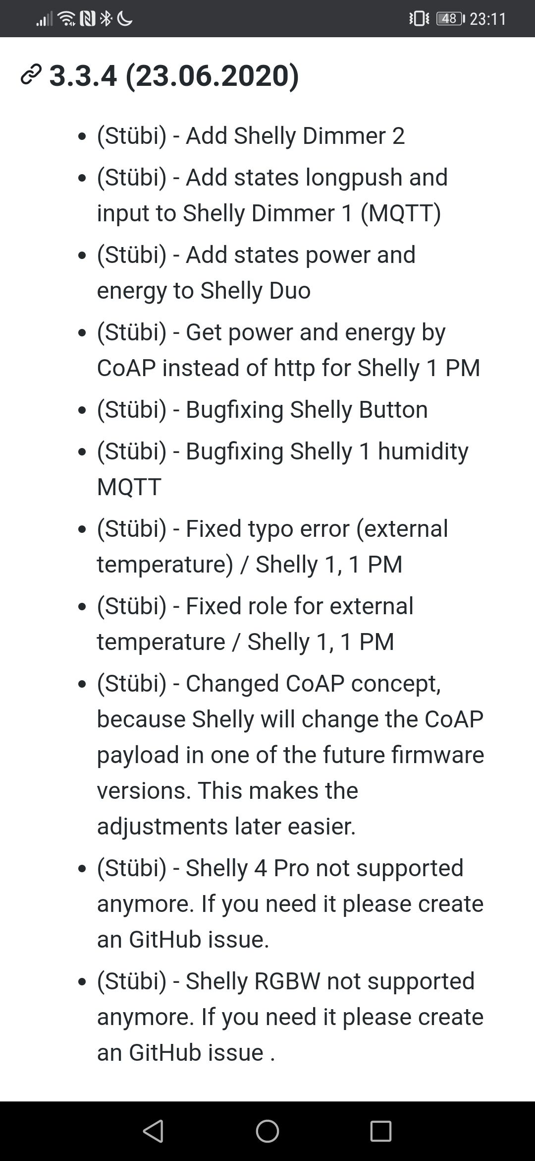

        Der 4 pro wird nicht mehr unterstützt

            harrym @SMARTY.ML last edited by
            @SMARTY-ML Adapter Version 3.3.5 installieren.
            Version 3.3.5
            @schmupu schmupu released this 4 days ago · 3 commits to master since this release
            (Stübi) - Add Shelly 4 Pro
            (Stübi) - Bugfixing Shelly RGBW2, sate lights.switch color mode
            (Stübi) - Add Shelly DW2
            (Stübi) - Add states longpush and input to Shelly Dimmer 1 (CoAP and MQTT)
            (Stübi) - Add states longpush and input to Shelly Dimmer 2 (CoAP and MQTT)
            (Stübi) - Add states longpush and input to Shelly 1, 1 PM, 2, 2.5 (CoAP)
            (Stübi) - Add state input to Shelly RGBW2 (CoAP)
            (Stübi) - Add state deviceid (Issue #193)"
