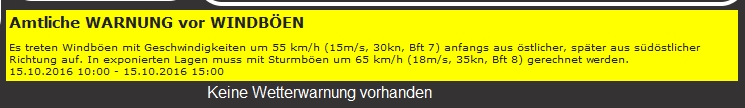

      ich mache das so: 261_bildschirmfoto_2016-10-15_um_12.28.10.jpg
      Widget:````
      [{"tpl":"tplMetroTileDialog","data":{"visibility-cond":"!=","visibility-val":"","hover":false,"transform":"true","bg_class":"ribbed-orange","icon_width":"60%","icon_class":"icon-lightning-3","icon_badge":"","badge_bg_class":"","brand_bg_class":"","dialog_draggable":"true","dialog_icon_class":"icon-lightning-4","contains_view":"Dialog_DWD","label":"DWD Warnung","icon_height":"60%","name":"DWD Warnung View","dialog_flat":true,"dialog_width":"500px","dialog_height":"700px","dialog_title":"Warnung des deutschen Wetterdienstes","dialog_modal":true,"visibility-oid":"dwd.0.warning.description","locked":false,"icon_src":"","gestures-offsetX":0,"gestures-offsetY":0,"signals-cond-0":"==","signals-val-0":true,"signals-icon-0":"/vis/signals/lowbattery.png","signals-icon-size-0":0,"signals-blink-0":false,"signals-horz-0":0,"signals-vert-0":0,"signals-hide-edit-0":false,"signals-cond-1":"==","signals-val-1":true,"signals-icon-1":"/vis/signals/lowbattery.png","signals-icon-size-1":0,"signals-blink-1":false,"signals-horz-1":0,"signals-vert-1":0,"signals-hide-edit-1":false,"signals-cond-2":"==","signals-val-2":true,"signals-icon-2":"/vis/signals/lowbattery.png","signals-icon-size-2":0,"signals-blink-2":false,"signals-horz-2":0,"signals-vert-2":0,"signals-hide-edit-2":false,"visibility-groups-action":"hide"},"style":{"left":"903px","top":"40px","width":"110px","height":"110px","z-index":"30"},"widgetSet":"metro"}]
      Also
      dwd.0.warning.description!/````
      Pix

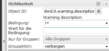

        Bei mir geht das irgendwie nicht.
        Hast du unter: Wert für bedingung: "" eingegeben oder woher kommt das aus deinem Codeschnipsel?
         ![639_dwd3.jpg](/assets/uploads/files/639_dwd3.jpg)  ![639_dwd2.jpg](/assets/uploads/files/639_dwd2.jpg)
          pix last edited by
          Nein, habe ich nicht, sondern != (siehe Screenshot).

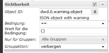

              @navino:
              Durch try and error habe ich jetzt eine Lösung gefunden, die ich zwar logisch nicht verstehe, es klappt aber.
              Wenn es keine Warnung gibt hat der Datenpunkt den value {}, müsste eigentlich also anders formuliert werden. `
              Genau da wollte ich dich hin haben!
              Du hast eine json Tabelle ohne Inhalt, also zeige den Ersatztext an.
              Wieso ist das für dich unlogisch?
              Ich hatte ein anderes Feld genommen (bin wieder nicht am PC!) und analog zu pix einfach === geschrieben und das bedingungsfeld leer gelassen

                Wieso ist das für dich unlogisch? `
                Dann erstmal Danke für die Unterstützung von unterwegs aus!!
                Glaube mir bitte aber auch das man wahnsinnig wird, wenn man bei solchen einfachen Sachen nicht weiterkommt.
                Also, wenn die Json-Tabelle leer ist steht im Datenpunkt {} und es gibt keine Wetterwarnung.
                Also müsste die Formulierung so lauten:
                Wenn ich den Text also verbergen möchte wenn die JSON-Tabelle gefüllt ist (Warnung vorhanden)
                muss die Bedingung lauten != {} mit anderen Worten : ungleich JSON-Tabelle leer
                bei mir klappt es aber mit == {} mit anderen Worten : gleich JSON-Tabelle leer.
                Das ist falsch herum!
                • N
                  navino last edited by
                  es geht jetzt auch mit der Description
                  keine Ahnung was ich falsch gemacht habe, kommt wohl in die Schublade für ungeklärte Fälle 😞

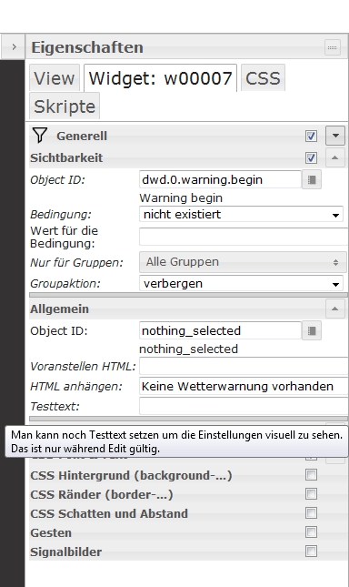

                    pix last edited by
                    Bedeutet ungleich leer.
                      Also nochmal:
                      @Homoran:
                      Der Punkt heisst "Sichtbarkeit", also muss eine Bedingung her, die wahr wird, wenn das Widget gezeigt werden soll. `
                      Die Gruppenfunktion unter der verbergen steht hat IMHO nichts damit zu tun, sondern dient dazu Widgets je nach benutzerstatus anzuzeigen oder nicht.
                      Hier gibt es nur ein sichtbar, wenn….
                      @navino:
                      bei mir klappt es aber mit == {} mit anderen Worten : gleich JSON-Tabelle leer. `
                      Das ist in sich korrekt, aber wie bereits gesagt geht es hier um Sichtbarkeit und nicht um verbergen.
                      @pix
                      Danke, dachte ich also richtig, dann ist dein Ansatz für diesen Fall leider falsch 😉
                      Rainer
                        pix last edited by
                        Hallo Rainer, hab ja nur weiter oben mit Screenshot gepostet, wie es bei mir funktioniert.
                        Wenn Beschreibung leer, dann widget nicht anzeigen.
