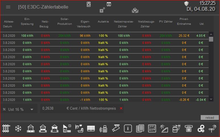

      EDIT:
      ich habe das Skript von ArnoD mit Hilfe von paul53 weiter aufgebohrt un um die Kostenberechnung für die Privatentnahme erweitert. Ebenfalls 2 States hinzu um die Stromkosten und mittlerweile wechselhafte MWST über vis anzupassen.
      EDIT:
      Taelle erweitert um aktuelle Mwst und aktueller Strompreis und log Ausgabe.
      EDIT:
      Skript erweitert, es werden nunzusätzlich alleDaten in eine CSV Datei geschrieben.

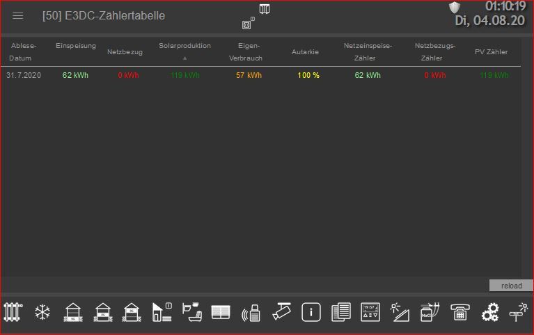

      widget.txt

                  @ArnoD
                  hier das widget zum script ( matrial design Tabelle)
                  [{"tpl":"tplVis-materialdesign-Table","data":{"oid":"javascript.1.PVAnlage.Stromzaehler.Zaehlerstaende.JsonTable","g_fixed":false,"g_visibility":false,"g_css_font_text":false,"g_css_background":true,"g_css_shadow_padding":false,"g_css_border":false,"g_gestures":false,"g_signals":false,"g_last_change":false,"countCols":"8","tableLayout":"cardOutlined","showHeader":true,"headerTextSize":"small","showColumn0":true,"colType0":"text","textAlign0":"center","showColumn1":true,"colType1":"text","textAlign1":"center","signals-cond-0":"==","signals-val-0":true,"signals-icon-0":"/vis/signals/lowbattery.png","signals-icon-size-0":0,"signals-blink-0":false,"signals-horz-0":0,"signals-vert-0":0,"signals-hide-edit-0":false,"signals-cond-1":"==","signals-val-1":true,"signals-icon-1":"/vis/signals/lowbattery.png","signals-icon-size-1":0,"signals-blink-1":false,"signals-horz-1":0,"signals-vert-1":0,"signals-hide-edit-1":false,"signals-cond-2":"==","signals-val-2":true,"signals-icon-2":"/vis/signals/lowbattery.png","signals-icon-size-2":0,"signals-blink-2":false,"signals-horz-2":0,"signals-vert-2":0,"signals-hide-edit-2":false,"lc-type":"last-change","lc-is-interval":true,"lc-is-moment":false,"lc-format":"","lc-position-vert":"top","lc-position-horz":"right","lc-offset-vert":0,"lc-offset-horz":0,"lc-font-size":"12px","lc-font-family":"","lc-font-style":"","lc-bkg-color":"","lc-color":"","lc-border-width":"0","lc-border-style":"","lc-border-color":"","lc-border-radius":10,"lc-zindex":0,"showColumn2":true,"colType2":"text","textAlign2":"center","showColumn3":true,"colType3":"text","textAlign3":"center","showColumn4":true,"colType4":"text","textAlign4":"center","showColumn5":true,"colType5":"text","textAlign5":"center","showColumn6":true,"colType6":"text","textAlign6":"center","showColumn7":"true","colType7":"text","textAlign7":"center","showColumn8":true,"colType8":"text","textAlign8":"center","showColumn9":"true","colType9":"text","textAlign9":"center","showColumn10":"true","colType10":"text","textAlign10":"center","showColumn11":"true","colType11":"text","textAlign11":"center","showColumn12":"true","colType12":"text","textAlign12":"center","showColumn13":"true","colType13":"text","textAlign13":"center","showColumn14":"true","colType14":"text","textAlign14":"center","showColumn15":"true","colType15":"text","textAlign15":"center","showColumn16":"true","colType16":"text","textAlign16":"center","showColumn17":"true","colType17":"text","textAlign17":"center","headerRowHeight":"50","label0":"Ablese-<br>Datum","colTextColor0":"#9c9c9c","prefix0":"","colorHeaderRowText":"#9c9c9c","dividers":"#9c9c9c","colorBackground":"rgb(50,50,50)","colorHeaderRowBackground":"rgb(50,50,50)","columnWidth0":"","label1":"Einspeisung","label2":"Netzbezug","label3":"Solarproduktion","suffix3":"","suffix2":"","suffix1":"","label4":"Eigen-<br>Verbrauch","suffix4":"","label5":"Autarkie","suffix5":"","label6":"Netzeinspeise-<br>Zähler","suffix6":"","label7":"Netzbezugs-<br>Zähler","suffix7":"","label8":"PV Zähler","suffix8":"","label9":"Datum","suffix9":"","label10":"Dauer","rowHeight":"30","colorRowText":"#9c9c9c","borderColor":"transparent","colorRowBackground":"rgb(50,50,50)","dataJson":"","colNoWrap1":true,"colNoWrap0":true,"colNoWrap3":false,"showColumn18":"true","colType18":"text","textAlign18":"center","showColumn19":"true","colType19":"text","textAlign19":"center","showColumn20":"true","colType20":"text","textAlign20":"center","colNoWrap5":true,"colNoWrap4":false,"colNoWrap6":true,"colNoWrap7":true,"colNoWrap8":true,"colNoWrap9":true,"colNoWrap10":true,"visibility-cond":"==","visibility-val":1,"visibility-groups-action":"hide","colTextColor2":"red","colTextColor10":"lightgreen","fixedHeader":true,"colTextColor3":"green","colTextColor1":"lightgreen","colTextColor4":"orange","colTextColor5":"yellow","colNoWrap2":true,"columnWidth6":"120","colTextColor6":"lightgreen","colTextColor7":"red","colTextColor8":"green","columnWidth7":"120","columnWidth3":"110","columnWidth4":"120"},"style":{"left":"0px","top":"1px","width":"942px","height":"430px","z-index":"1","background-color":"rgb(50,50,50)","overflow-x":"auto","overflow-y":"auto"},"widgetSet":"materialdesign"}]

                            so ich habe mal den 1. Beitrag aktualisiert...
                            hier findet sich dann immer das aktuellste Skript..
                            ich habe das Skript von ArnoD mit Hilfe von paul53 weiter aufgebohrt und zusätzlich um die Kostenberechnung für die Privatentnahme erweitert. Ebenfalls 2 States hinzu um die Stromkosten und mittlerweile wechselhafte MWST über vis anzupassen.
                            Die widgets gibts noch obendrauf...
                            Wie das ganze aussieht... siehe im 1. Beitrag
