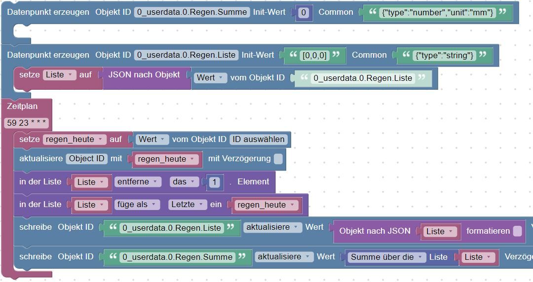

              paul53 @G.Hawk last edited by paul53
              @Martin-0 sagte:
              drei Tage zusammen rechnet und das dann immer die letzten drei Tage sind.
              Prinzip:
               <variables>
                 <variable id="rq{##2}brF,H1z%75~/w">Liste</variable>
                 <variable id="QPe?Ou3i?s5i$GZ]RgQ$">regen_heute</variable>
               </variables>
               <block type="create" id="nv(4QW_Yc*WF}5~#c8ai" inline="true" x="87" y="-38">
                 <field name="NAME">0_userdata.0.Regen.Summe</field>
                   <block type="math_number" id="5cdmh:rGuK2=?CE-Iz+C">
                     <field name="NUM">0</field>
                 <value name="COMMON">
                   <block type="text" id=":=Y/DRPU6KX,QR+y:*[=">
                     <field name="TEXT">{"type":"number","unit":"mm"}</field>
                   <block type="create" id="w2aXX+,#|:IJF~Jt[nw3" inline="true">
                     <field name="NAME">0_userdata.0.Regen.Liste</field>
                       <block type="text" id=":Q`./R$`N-h!]cMlLZrv">
                         <field name="TEXT">[0,0,0]</field>
                       <block type="text" id="4`J!WIn~FLikOJEpggr3">
                         <field name="TEXT">{"type":"string"}</field>
                       <block type="variables_set" id="ctvQuB(=dril+qij,U;2">
                         <field name="VAR" id="rq{##2}brF,H1z%75~/w">Liste</field>
                           <block type="convert_json2object" id="hs5#qjmV;#%if`|ni)ig">
                               <block type="get_value_var" id="VH4[k!l:Z/I21BZ~#DOX">
                                 <value name="OID">
                                   <shadow type="text" id="ET%`1Bx|Mta}PXul9=JF">
                                     <field name="TEXT">0_userdata.0.Regen.Liste</field>
                       <block type="schedule" id="UV4%O=Jcbk523]]01mu}">
                         <field name="SCHEDULE">59 23 * * *</field>
                           <block type="variables_set" id="2M}Njb/0|6p3KHC~T,#E">
                             <field name="VAR" id="QPe?Ou3i?s5i$GZ]RgQ$">regen_heute</field>
                               <block type="get_value" id="opp*9~+Zf]YA(Y}yto/x">
                                 <field name="OID">ID auswählen</field>
                               <block type="update" id="7-*h)oAAMpBW7Vdqho8=">
                                   <block type="variables_get" id="Ttu.^n}F8VFo]q8PR_hl">
                                   <block type="lists_getIndex" id="hMhb2Do0$5}^#)%|!vNe">
                                     <mutation statement="true" at="true"></mutation>
                                     <field name="MODE">REMOVE</field>
                                       <block type="variables_get" id="aOV_X-/%%InaofARE4T[">
                                     <value name="AT">
                                       <block type="math_number" id="9,WtnKAb[So8a|N+4[/J">
                                         <field name="NUM">1</field>
                                       <block type="lists_setIndex" id="y$),/rr:epg]zb!STeC{">
                                         <mutation at="false"></mutation>
                                         <field name="WHERE">LAST</field>
                                         <value name="LIST">
                                           <block type="variables_get" id="c(!}.eH%KS/+G,[|bLCU">
                                         <value name="TO">
                                           <block type="variables_get" id="wc%9bkz]EXzyocS*#/=n">
                                           <block type="control_ex" id="7z/rGz}ajk[RQ#-y*AJW" inline="true">
                                             <field name="TYPE">true</field>
                                             <value name="OID">
                                               <shadow type="field_oid" id=";xx+[xd(jUFCy!hfIgeD">
                                                 <field name="oid">Object ID</field>
                                               <block type="text" id="LK#Grgo7noU1%~oi*PB;">
                                               <shadow type="logic_boolean" id="kDs4-TkQ0`qfc%!/U.nJ">
                                               <block type="convert_object2json" id="=yL/pZ[m*K`gbHXI8*i0">
                                                 <field name="PRETTIFY">FALSE</field>
                                                   <block type="variables_get" id="PI;04iQJ{+kcj~Em:Q;/">
                                             <value name="DELAY_MS">
                                               <shadow type="math_number" id="a+K=G{437Zs3.ibo1Zl}">
                                               <block type="control_ex" id="9w#Kd|j@KDGY4$u0PkqI" inline="true">
                                                 <value name="OID">
                                                   <shadow type="field_oid">
                                                   <block type="text" id="Cny?uquJAUC|gXmcy8pn">
                                                     <field name="TEXT">0_userdata.0.Regen.Summe</field>
                                                   <shadow type="logic_boolean" id="olhS:dGNkMt7N^Syq,}v">
                                                   <block type="math_on_list" id="*;eg.@GGST!R-qY/T(fO">
                                                     <mutation op="SUM"></mutation>
                                                     <field name="OP">SUM</field>
                                                     <value name="LIST">
                                                       <block type="variables_get" id="ufP}zO2wJm-LPBl7zmL5">
                                                   <shadow type="math_number" id="^?F2$tv9L-2t_|[N;wCU">

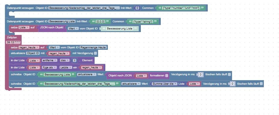

              • G
                G.Hawk @paul53 last edited by
                Das ist der Hammer. Vielen Dank. Funktioniert einwandfrei nach den ersten Tests.
                Aber einige Fragen habe ich noch:
                Die Datenpunkte am Anfang müssen wohl stehenbleiben.
                Wenn ich ich die deaktiviere, dann funktioniert es nicht, aber warum?

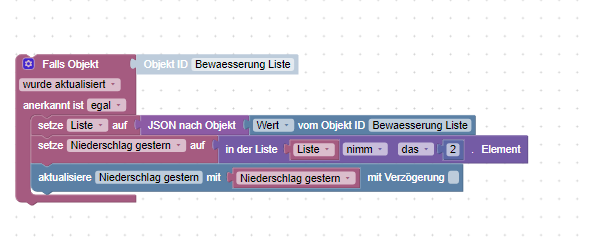

                Ich mache mal ein Bild von dem angepassten Blockly.
                Eigentlich liegen die Datenpunkte da: javascript.0.Bewaesserung.Niederschlag_der_letzten_drei_Tage_Station
                Aber in dem Blockly darf ich nur "Bewaesserung.Niederschlag_der_letzten_drei_Tage_Station" schreiben, sonst legt er mir unter "javascript.0. den gleichen order nochmal an.
                G paul53 2 Replies Last reply Reply Quote 0

                  G.Hawk @G.Hawk last edited by
                    @Martin-0 sagte:
                    "Datenpunkt erzeugen" wird nur einmal benötigt und kann dann gelöscht / deaktiviert werden. In dem Fall muss aber "setze Liste auf ..." vor den Zeitplan gesetzt werden, da die Liste sonst nach jedem Skriptstart verloren ist.

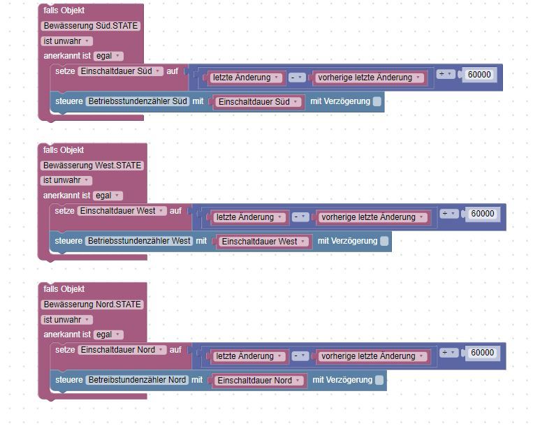

                                      Ich habe eben noch einen Betriebsstundenzähler gemacht für die Bewässerungsventile.
                                      Das funktioniert auch, nur müsste sich dieser drei Tage später wieder auf null stellen.
                                      Kann mir jemand sagen, wie ich das mache?
                                          @Martin-0 sagte:
                                          Weshalb nach 3 Tagen ?
                                          Besserer Trigger: ist kleiner als letztes (Änderung wahr --> falsch)
