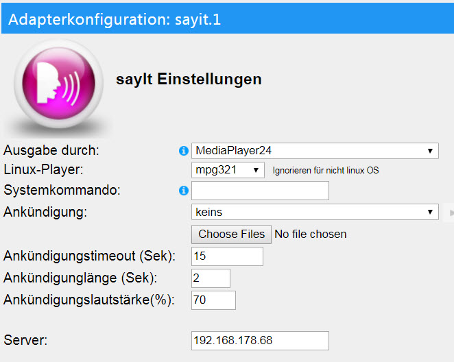

            Habe das zur Zeit so eingestellt:
            Browser instanz über Widget ermittelt:
            SayIt Adapter so eingestellt: (Keys sind natürlich eingetragen)
            ObJecte sind dann so:
            Wenn ich jetzt in der Text Zeile enter Drücke bekomme ich die Ansage "Hallo Dutchman".

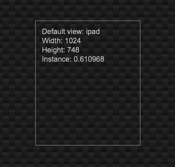

              Kannst du mir bitten noch den code vom widget geben um die browser instance heraus zu bekommen ?
              • wendy2702
                wendy2702 last edited by
                @Dutchman:
                great danke, hab ich was fuers wochenende um mit zu spielen.
                Kannst du mir bitten noch den code vom widget geben um die browser instance heraus zu bekommen ? `
                Ist das Basic Screen resolution Widget:
                ! [{"tpl":"tplScreenResolution","data":{"g_fixed":false,"g_visibility":false,"g_css_font_text":true,"g_css_background":false,"g_css_shadow_padding":false,"g_css_border":false,"g_gestures":false,"g_signals":false,"visibility-cond":"==","visibility-val":1,"visibility-groups-action":"hide","signals-cond-0":"==","signals-val-0":true,"signals-icon-0":"/vis/signals/lowbattery.png","signals-icon-size-0":0,"signals-blink-0":false,"signals-horz-0":0,"signals-vert-0":0,"signals-hide-edit-0":false,"signals-cond-1":"==","signals-val-1":true,"signals-icon-1":"/vis/signals/lowbattery.png","signals-icon-size-1":0,"signals-blink-1":false,"signals-horz-1":0,"signals-vert-1":0,"signals-hide-edit-1":false,"signals-cond-2":"==","signals-val-2":true,"signals-icon-2":"/vis/signals/lowbattery.png","signals-icon-size-2":0,"signals-blink-2":false,"signals-horz-2":0,"signals-vert-2":0,"signals-hide-edit-2":false},"style":{"left":"303px","top":"100px","width":"170px","height":"202px","color":"#FFFFFF"},"widgetSet":"basic"}]
