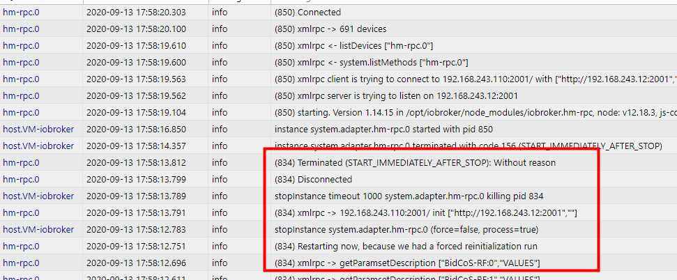

                • bahnuhr
                  bahnuhr Forum Testing Most Active last edited by bahnuhr
                  callback eingetragen
                  hm-rpc.0 gestartet
                  hm-rpc.0	2020-09-13 17:56:33.570	info	(834) xmlrpc <- newDevices 691
                  hm-rpc.0	2020-09-13 17:56:32.134	info	(834) Connected
                  hm-rpc.0	2020-09-13 17:56:32.032	info	(834) xmlrpc -> 0 devices
                  hm-rpc.0	2020-09-13 17:56:31.592	info	(834) xmlrpc <- listDevices ["hm-rpc.0"]
                  hm-rpc.0	2020-09-13 17:56:31.581	info	(834) xmlrpc <- system.listMethods ["hm-rpc.0"]
                  hm-rpc.0	2020-09-13 17:56:31.541	info	(834) xmlrpc client is trying to connect to 192.168.243.110:2001/ with ["http://192.168.243.12:2001","hm-rpc.0"]
                  hm-rpc.0	2020-09-13 17:56:31.540	info	(834) xmlrpc server is trying to listen on 192.168.243.12:2001
                  hm-rpc.0	2020-09-13 17:56:30.936	info	(834) starting. Version 1.14.15 in /opt/iobroker/node_modules/iobroker.hm-rpc, node: v12.18.3, js-controller: 3.1.6
                  das sieht ok aus.
                  aber nach ein paar Sekunden kommt dies (hm-rega ist noch nicht ! gestartet)
                  hm-rpc.0	2020-09-13 17:57:20.912	info	(834) xmlrpc -> getParamsetDescription ["MEQ0992607:0","VALUES"]
                  hm-rpc.0	2020-09-13 17:57:20.827	info	(834) xmlrpc -> getParamsetDescription ["MEQ0992607:1","VALUES"]
                  hm-rpc.0	2020-09-13 17:57:20.667	info	(834) xmlrpc -> getParamsetDescription ["MEQ0992675:0","VALUES"]
                  hm-rpc.0	2020-09-13 17:57:20.579	info	(834) xmlrpc -> getParamsetDescription ["MEQ0992675:1","VALUES"]
                  hm-rpc.0	2020-09-13 17:57:20.402	info	(834) xmlrpc -> getParamsetDescription ["MEQ1097299:0","VALUES"]
                  hm-rpc.0	2020-09-13 17:57:20.236	info	(834) xmlrpc -> getParamsetDescription ["MEQ1097299:1","VALUES"]
                  hm-rpc.0	2020-09-13 17:57:20.024	info	(834) xmlrpc -> getParamsetDescription ["MEQ1097299:2","VALUES"]
                  hm-rpc.0	2020-09-13 17:57:19.847	info	(834) xmlrpc -> getParamsetDescription ["MEQ1097299:3","VALUES"]
                  hm-rpc.0	2020-09-13 17:57:19.654	info	(834) xmlrpc -> getParamsetDescription ["MEQ1425139:0","VALUES"]
                  hm-rpc.0	2020-09-13 17:57:19.599	info	(834) xmlrpc -> getParamsetDescription ["MEQ1425139:1","VALUES"]
                  hm-rpc.0	2020-09-13 17:57:19.412	info	(834) xmlrpc -> getParamsetDescription ["NEQ0046063:0","VALUES"]
                  hm-rpc.0	2020-09-13 17:57:19.342	info	(834) xmlrpc -> getParamsetDescription ["NEQ0046063:1","VALUES"]
                  hm-rpc.0	2020-09-13 17:57:19.198	info	(834) xmlrpc -> getParamsetDescription ["NEQ0322032:0","VALUES"]
                  hm-rpc.0	2020-09-13 17:57:19.176	info	(834) xmlrpc -> getParamsetDescription ["NEQ0322032:1","VALUES"]
                  hm-rpc.0	2020-09-13 17:57:19.064	info	(834) xmlrpc -> getParamsetDescription ["NEQ0530138:0","VALUES"]
                  hm-rpc.0	2020-09-13 17:57:19.012	info	(834) xmlrpc -> getParamsetDescription ["NEQ0530138:1","VALUES"]
                  hm-rpc.0	2020-09-13 17:57:18.959	info	(834) xmlrpc -> getParamsetDescription ["NEQ0530138:2","VALUES
                  Das kann doch nicht richtig sein, oder ??
                  Und dann kam so was:
                  • bahnuhr
                    so, habs mal laufen lassen.
                    Nach 5 !! Minuten war er fertig.
                    So lange hat das bisher nicht gedauert.
                    Vielleicht ist der neu gekaufte nuc doch zu langsam 😉
                      Homoran Global Moderator Administrators @bahnuhr last edited by Homoran
                      @bahnuhr sagte in Proxmox 1.Hilfe - hm.rega und hm-rpc:
                      oder!!!
                      alles gut!
                      eher wieder Probleme im Netz!
