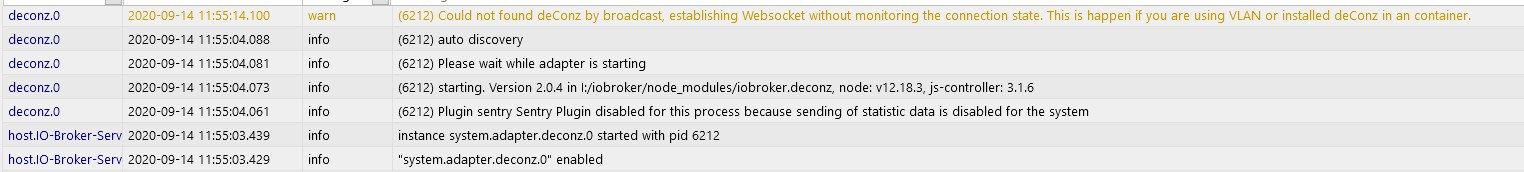

          @Thomas-Braun Nein, die DeConz Software läuft direkt mit auf meinem IO-Broker Server. Ich bin jetzt zurück auf Version 2.0.0 und das gleiche Problem. Habe den IO-Broker Server auch gerade einmal komplett neu gestartet.
          Was meinst du mit dem "richtigen LOG-File"? Wo finde ich es?
          2020-09-14 11:58:50.511 - info: host.IO-Broker-Server stopInstance system.adapter.deconz.0 send kill signal
          2020-09-14 11:58:50.581 - info: host.IO-Broker-Server iobroker upload [2] deconz.admin I:/iobroker/node_modules/iobroker.deconz/admin/instruction.png instruction.png image/png
          2020-09-14 11:58:50.645 - info: host.IO-Broker-Server iobroker upload [1] deconz.admin I:/iobroker/node_modules/iobroker.deconz/admin/index_m.html index_m.html text/html
          2020-09-14 11:58:50.709 - info: host.IO-Broker-Server iobroker upload [0] deconz.admin I:/iobroker/node_modules/iobroker.deconz/admin/deconz.png deconz.png image/png
          2020-09-14 11:58:50.774 - info: host.IO-Broker-Server iobroker Adapter "deconz" updated
          2020-09-14 11:58:51.041 - info: host.IO-Broker-Server instance system.adapter.deconz.0 terminated with code 11 (ADAPTER_REQUESTED_TERMINATION)
          2020-09-14 11:58:51.797 - info: host.IO-Broker-Server iobroker exit 0
          2020-09-14 11:58:53.521 - info: host.IO-Broker-Server instance system.adapter.deconz.0 started with pid 10388
          2020-09-14 11:58:54.200 - info: deconz.0 (10388) Plugin sentry Sentry Plugin disabled for this process because sending of statistic data is disabled for the system
          2020-09-14 11:58:54.206 - info: deconz.0 (10388) starting. Version 2.0.4 in I:/iobroker/node_modules/iobroker.deconz, node: v12.18.3, js-controller: 3.1.6
          2020-09-14 11:58:54.214 - info: deconz.0 (10388) Please wait while adapter is starting
          2020-09-14 11:58:54.233 - info: deconz.0 (10388) auto discovery
          2020-09-14 11:59:04.270 - warn: deconz.0 (10388) Could not found deConz by broadcast, establishing Websocket without monitoring the connection state. This is happen if you are using VLAN or installed deConz in an container.

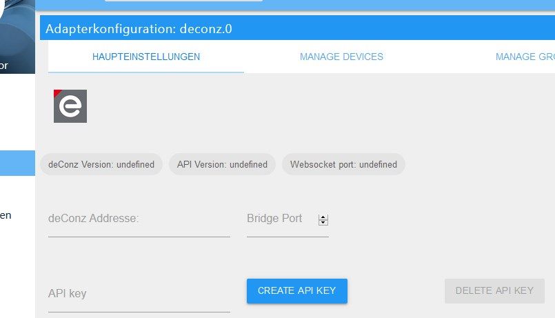

            Ein Problem habe ich gerade gefunden. Die Einstellungen bei den "Haupteinstellungen" sind nach dem Update komplett raus...

                  Ich habe es jetzt vorerst wieder zum Laufen bekommen. Vielleicht kann sich damit mal jemand beschäftigen.
                  Nach dem Update auf 2.0.4 musste die DeConz IP Adresse eingetragen und der API Key neu erzeugt werden.
                  Ich weiß nicht, ob das jetzt nur bei mir der Fall war, aber bei vorherigen Updates lief das immer ohne Neueintragung.

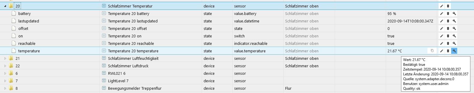

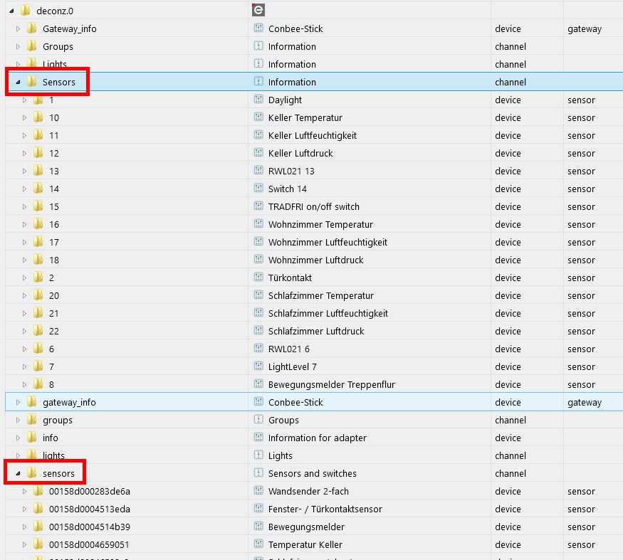

                      Der nächste Stolperstein, auf den ich gerade hereingefallen bin. Es gibt nun scheinbar bei den Objekten unterhalb des Deconz-Adapters doppelte Einträge (z.B. "sensors"). Vorher habe ich immer mit den Einträgen aus dem oberen Baum gearbeitet, jetzt musste ich auf die unteren in meinen Skripten abfragen.
                      Alle Temperatursensoren liefern aktuell bei mir keine Werte, weil ich aus dem oberen Baum abfrage.
                      Etwas verwirrend mit den doppelten Einträgen hier.
                      Hier der Temperatursensor aus dem oberen Baum. Wird seit dem Update von heute Vormittag nicht mehr mit aktuellen Werten befüllt.

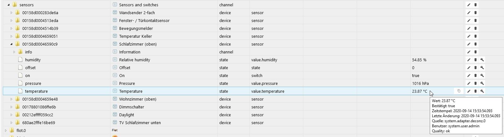

                      Hier der Eintrag aus dem anderen "sensors"-Baum

                        Thomas Braun Most Active @surfer09 last edited by
                        @surfer09
                        Wenn ich mich recht entsinne wurde das geändert in den letzten Versionen des Adapters.
                        Den ganzen Baum löschen und neu einlesen ist da angesagt. Dann sind auch die Doubletten weg.
