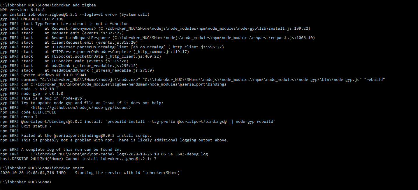

            Über die CL genau das gleiche:
            C:\iobroker_NUC\SHome>iobroker install zigbee@1.2.1
            NPM version: 6.14.6
            npm install iobroker.zigbee@1.2.1 --loglevel error (System call)
            gyp ERR! UNCAUGHT EXCEPTION
            gyp ERR! stack TypeError: tar.extract is not a function
            gyp ERR! stack     at Request.<anonymous> (C:\iobroker_NUC\SHome\nodejs\node_modules\npm\node_modules\node-gyp\lib\install.js:199:22)
            gyp ERR! stack     at Request.emit (events.js:327:22)
            gyp ERR! stack     at Request.onRequestResponse (C:\iobroker_NUC\SHome\nodejs\node_modules\npm\node_modules\request\request.js:1066:10)
            gyp ERR! stack     at ClientRequest.emit (events.js:315:20)
            gyp ERR! stack     at HTTPParser.parserOnIncomingClient [as onIncoming] (_http_client.js:596:27)
            gyp ERR! stack     at HTTPParser.parserOnHeadersComplete (_http_common.js:119:17)
            gyp ERR! stack     at TLSSocket.socketOnData (_http_client.js:469:22)
            gyp ERR! stack     at TLSSocket.emit (events.js:315:20)
            gyp ERR! stack     at addChunk (_stream_readable.js:295:12)
            gyp ERR! stack     at readableAddChunk (_stream_readable.js:271:9)
            gyp ERR! System Windows_NT 10.0.19041
            gyp ERR! command "C:\\iobroker_NUC\\SHome\\nodejs\\node.exe" "C:\\iobroker_NUC\\SHome\\nodejs\\node_modules\\npm\\node_modules\\node-gyp\\bin\\node-gyp.js" "rebuild"
            gyp ERR! cwd C:\iobroker_NUC\SHome\node_modules\zigbee-herdsman\node_modules\@serialport\bindings
            gyp ERR! node -v v12.18.3
            gyp ERR! node-gyp -v v5.1.0
            gyp ERR! This is a bug in `node-gyp`.
            gyp ERR! Try to update node-gyp and file an Issue if it does not help:
            gyp ERR!     <https://github.com/nodejs/node-gyp/issues>
            npm ERR! code ELIFECYCLE
            npm ERR! errno 7
            npm ERR! @serialport/bindings@9.0.2 install: `prebuild-install --tag-prefix @serialport/bindings@ || node-gyp rebuild`
            npm ERR! Exit status 7
            npm ERR!
            npm ERR! Failed at the @serialport/bindings@9.0.2 install script.
            npm ERR! This is probably not a problem with npm. There is likely additional logging output above.
            npm ERR! A complete log of this run can be found in:
            npm ERR!     C:\iobroker_NUC\SHome\env\npm-cache\_logs\2020-10-26T15_29_55_202Z-debug.log
            host.DESKTOP-24U17KH(SHome) Cannot install iobroker.zigbee@1.2.1: 7

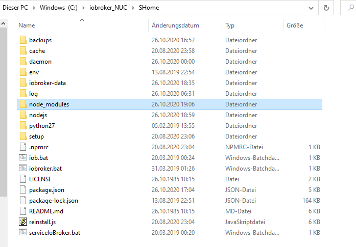

                                  DocGame @Asgothian last edited by DocGame
                                  @Asgothian
                                  Erkennst du hierauf was?
                                  In der Info steht folgendes:
                                  Plattform: Windows
                                  Betriebssystem: win32
                                  Die Architektur: x64
                                  CPUs: 6
                                  Geschwindigkeit: 2208 MHz
                                  Modell: Intel(R) Core(TM) i5-9500T CPU @ 2.20GHz
                                  RAM: 7.8 GB
                                  System-Betriebszeit: 00:00:00
                                  Node.js: v12.18.3
                                  NPM: 6.14.8
                                  Adapter-Anzahl: 308
                                  Datenträgergröße: 237.5 GiB
                                  Datenträger verfügbar: 155.6 GiB
                                  Betriebszeit: 00:07:22
                                  Aktive Instanzen: 36
                                  Alle Anderen Adapter sind grün.
                                  Wo finde ich Infos zu Node?

                                      @DocGame such doch mal nach node.exe. (ich bin kein Windows Experte.. sorry)
                                      was genau hast du ein 2. mal installiert ? node oder nen iobroker ?
                                      A
                                        DocGame @DocGame last edited by
                                        den iobroker über den Windowsinstaller. Aber erst vorhin, das wird nichts mit dem Problem zu tun haben. Will die Neue später nur wieder loswerden.
                                        Ich habe woanders gelesen, dass ich node-gyp installieren soll.
                                        Dann kommt folgende Meldung:
                                        C:\iobroker_NUC\SHome>npm install -g node-gyp
                                        npm WARN deprecated request@2.88.2: request has been deprecated, see https://github.com/request/request/issues/3142
                                        npm WARN deprecated har-validator@5.1.5: this library is no longer supported
                                        C:\iobroker_NUC\SHome\env\npm\node-gyp -> C:\iobroker_NUC\SHome\env\npm\node_modules\node-gyp\bin\node-gyp.js
                                        + node-gyp@7.1.2
                                        added 96 packages from 66 contributors in 6.297s
                                        mikeal created this issue in request/request
                                        open Request’s Past, Present and Future #3142
                                        • Asgothian
                                          Asgothian Developer @DocGame last edited by
                                          @DocGame hast du ein Backup der Konfiguration und der Skripte ?
                                            @Asgothian
                                            Ja sowohl über den Backup-Adapter, als auch das exportieren der Scripts und das sichern des iobroker-data Verzeichnisses
