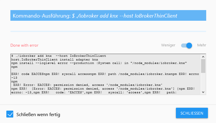

      Bei der Installation des KNX Adapters treten jedoch Probleme auf:
      1. Die aktuelle Version im IoBroker wird mit Ver. 10.0.39 angezeigt obwohl schon die 10.0.42 aktuell ist.
      2. Ein Auszug aus der Logdatei der Installation.
      $ ./iobroker add knx  --host IoBrokerThinClient
      host.IoBrokerThinClient install adapter knx
      npm install --loglevel error --production (System call) in "/node_modules/iobroker.knx"
      npm
      ERR!
       code EACCESnpm
       ERR! syscall accessnpm ERR! path /node_modules/iobroker.knxnpm ERR! errno -13
      npm
      ERR!
       Error: EACCES: permission denied, access '/node_modules/iobroker.knx'npm ERR!  [Error: EACCES: permission denied, access '/node_modules/iobroker.knx'] {npm
       ERR!   errno: -13,npm ERR!   code: 'EACCES',npm ERR!   syscall: 'access',npm ERR!   path: '/node_modules/iobroker.knx'npm ERR! }npm ERR! npm ERR! The operation was rejected by your operating system.npm ERR! It is likely you do not have the permissions to access this file as the current usernpm ERR! npm ERR! If you believe this might be a permissions issue, please double-check thenpm ERR! permissions of the file and its containing directories, or try runningnpm ERR! the command again as root/Administrator.
      npm
       ERR! A complete log of this run can be found in:npm
       ERR!     /home/iobroker/.npm/_logs/2020-11-02T17_33_16_319Z-debug.log
      Cannot install iobroker.knx: 243
      ERROR: process exited with code 25
      Dies wird angezeigt wenn ich per IoBroker Admin Oberfläche zu installieren.
