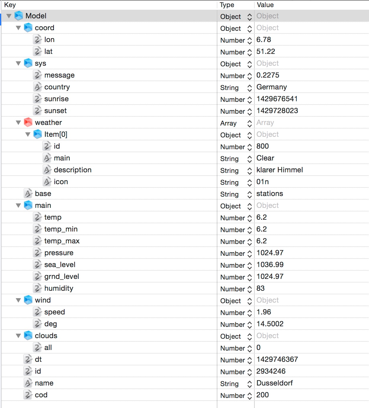

      Aktuelle Wetterdaten der eigenen Stadt:
      http://api.openweathermap.org/data/2.5/ … ic&lang=de
      {"coord":{"lon":6.78,"lat":51.22},"sys":{"message":0.2275,"country":"Germany","sunrise":1429676541,"sunset":1429728023},"weather":[{"id":800,"main":"Clear","description":"klarer Himmel","icon":"01n"}],"base":"stations","main":{"temp":6.2,"temp_min":6.2,"temp_max":6.2,"pressure":1024.97,"sea_level":1036.99,"grnd_level":1024.97,"humidity":83},"wind":{"speed":1.96,"deg":14.5002},"clouds":{"all":0},"dt":1429746367,"id":2934246,"name":"Dusseldorf","cod":200}
      Zur Info, falls jemand die Daten einer externen Wetterstation benötigt.
      Ich werde die Werte, die ich benötige als nächstes mit node-red auslesen.

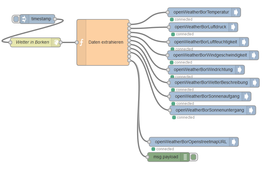

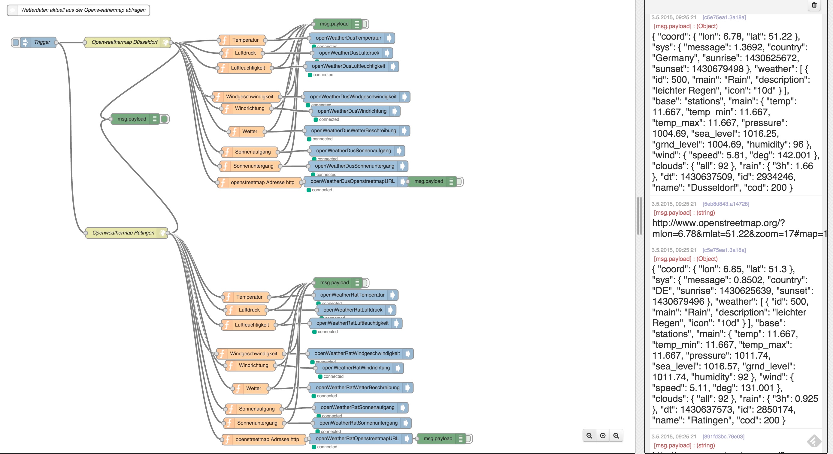

        Falls jemand die Daten aus seiner Stadt in Variablen schreiben möchte.
        Um Tipparbeit zu sparen, anbei der Flow.
        Im Beispiel für die Städte Düsseldorf und Ratingen.
        [{"id":"31f0063c.ce0ffa","type":"http request","name":"Openweathermap Düsseldorf","method":"GET","ret":"obj","url":"http://api.openweathermap.org/data/2.5/weather?q=Duesseldorf,de&units=metric&lang=de","x":576.285758972168,"y":3414.8253536224365,"z":"c8f61395.3709f","wires":[["99e0ffb0.661f","81652e01.7e9ad","5be9f9a7.a41608","57b76f72.a8489","d3eb6296.2c14a","502c6827.afd398","b15add60.4ea52","e6ba0720.1945f8","c5e75ea1.3a18a","5e981f4a.a167e"]]},{"id":"49f2a5e5.b60d5c","type":"inject","name":"Trigger","topic":"","payload":"","payloadType":"date","repeat":"","crontab":"","once":false,"x":327.5714797973633,"y":3414.8253498077393,"z":"c8f61395.3709f","wires":[["31f0063c.ce0ffa","30b66901.cf4996"]]},{"id":"8bd529ed.742ad8","type":"debug","name":"","active":false,"console":"false","complete":"false","x":1159.1746292114258,"y":3363.8253135681152,"z":"c8f61395.3709f","wires":[]},{"id":"99e0ffb0.661f","type":"function","name":"Temperatur","func":"msg.payload = msg.payload.main.temp;\n\nreturn msg;","outputs":1,"x":893.4603958129883,"y":3408.8253536224365,"z":"c8f61395.3709f","wires":[["8bd529ed.742ad8","f10a8e1b.0ef57"]]},{"id":"81652e01.7e9ad","type":"function","name":"Luftdruck","func":"msg.payload = msg.payload.main.pressure;\n\nreturn msg;","outputs":1,"x":893.4604263305664,"y":3444.8252925872803,"z":"c8f61395.3709f","wires":[["8bd529ed.742ad8","73419212.8cbe6c"]]},{"id":"5be9f9a7.a41608","type":"function","name":"Luftfeuchtigkeit","func":"msg.payload = msg.payload.main.humidity;\n\nreturn msg;","outputs":1,"x":900.4604263305664,"y":3485.8252925872803,"z":"c8f61395.3709f","wires":[["8bd529ed.742ad8","8e3e598b.71c1a8"]]},{"id":"57b76f72.a8489","type":"function","name":"Windgeschwindigkeit","func":"msg.payload = msg.payload.wind.speed;\n\nreturn msg;","outputs":1,"x":905.4604263305664,"y":3565.825170516968,"z":"c8f61395.3709f","wires":[["8bd529ed.742ad8","32593c69.cda6c4"]]},{"id":"d3eb6296.2c14a","type":"function","name":"Windrichtung","func":"msg.payload = msg.payload.wind.deg;\n\nreturn msg;","outputs":1,"x":905.4604263305664,"y":3598.8252925872803,"z":"c8f61395.3709f","wires":[["8bd529ed.742ad8","1f600994.e09ff6"]]},{"id":"c5e75ea1.3a18a","type":"debug","name":"","active":true,"console":"false","complete":"false","x":597.4604415893555,"y":3627.39656829834,"z":"c8f61395.3709f","wires":[]},{"id":"502c6827.afd398","type":"function","name":"Wetter","func":"msg.payload = msg.payload.weather[0].description;\n\nreturn msg;","outputs":1,"x":906.4604263305664,"y":3662.8252925872803,"z":"c8f61395.3709f","wires":[["8bd529ed.742ad8","c91a4fc8.36e5b"]]},{"id":"b15add60.4ea52","type":"function","name":"Sonnenaufgang","func":"msg.payload = msg.payload.sys.sunrise;\n\nreturn msg;","outputs":1,"x":914.4604263305664,"y":3719.8252925872803,"z":"c8f61395.3709f","wires":[["8bd529ed.742ad8","8dcd3e6f.7232c"]]},{"id":"e6ba0720.1945f8","type":"function","name":"Sonnenuntergang","func":"msg.payload = msg.payload.sys.sunset;\n\nreturn msg;","outputs":1,"x":915.4604263305664,"y":3758.8252925872803,"z":"c8f61395.3709f","wires":[["8bd529ed.742ad8","33693888.cc96c8"]]},{"id":"30b66901.cf4996","type":"http request","name":"Openweathermap Ratingen","method":"GET","ret":"obj","url":"http://api.openweathermap.org/data/2.5/weather?q=Ratingen,de&units=metric&lang=de","x":573.174560546875,"y":3944.254117012024,"z":"c8f61395.3709f","wires":[["c5e75ea1.3a18a","f421d300.0bde3","fa52aae3.05ad58","3e653e21.c19ac2","b2446bef.4dbb98","4262d813.bd9d28","83278cad.7cd87","17057cd8.e8fa83","663b03f3.99c4fc","18c7ceb4.e73831"]]},{"id":"7df41760.820be8","type":"comment","name":"Wetterdaten aktuell aus der Openweathermap abfragen","info":"","x":439.46033477783203,"y":3325.4921016693115,"z":"c8f61395.3709f","wires":[]},{"id":"f10a8e1b.0ef57","type":"ioBroker out","name":"","topic":"openWeatherDusTemperatur","ack":"true","autoCreate":"true","x":1198.5714111328125,"y":3402.8571548461914,"z":"c8f61395.3709f","wires":[]},{"id":"73419212.8cbe6c","type":"ioBroker out","name":"","topic":"openWeatherDusLuftdruck","ack":"true","autoCreate":"true","x":1200,"y":3444.285888671875,"z":"c8f61395.3709f","wires":[]},{"id":"8e3e598b.71c1a8","type":"ioBroker out","name":"","topic":"openWeatherDusLuftfeuchtigkeit","ack":"true","autoCreate":"true","x":1198.5714111328125,"y":3481.4287109375,"z":"c8f61395.3709f","wires":[]},{"id":"32593c69.cda6c4","type":"ioBroker out","name":"","topic":"openWeatherDusWindgeschwindigkeit","ack":"true","autoCreate":"true","x":1211.4286041259766,"y":3565.7145385742188,"z":"c8f61395.3709f","wires":[]},{"id":"1f600994.e09ff6","type":"ioBroker out","name":"","topic":"openWeatherDusWindrichtung","ack":"true","autoCreate":"true","x":1208.5714111328125,"y":3605.71435546875,"z":"c8f61395.3709f","wires":[]},{"id":"c91a4fc8.36e5b","type":"ioBroker out","name":"","topic":"openWeatherDusWetterBeschreibung","ack":"true","autoCreate":"true","x":1212.857177734375,"y":3660,"z":"c8f61395.3709f","wires":[]},{"id":"8dcd3e6f.7232c","type":"ioBroker out","name":"","topic":"openWeatherDusSonnenaufgang","ack":"true","autoCreate":"true","x":1212.857177734375,"y":3715.71435546875,"z":"c8f61395.3709f","wires":[]},{"id":"33693888.cc96c8","type":"ioBroker out","name":"","topic":"openWeatherDusSonnenuntergang","ack":"true","autoCreate":"true","x":1215.71435546875,"y":3758.571533203125,"z":"c8f61395.3709f","wires":[]},{"id":"f421d300.0bde3","type":"function","name":"Temperatur","func":"msg.payload = msg.payload.main.temp;\n\nreturn msg;","outputs":1,"x":904.2856674194336,"y":4122.85746383667,"z":"c8f61395.3709f","wires":[["15af9518.ea506b","5d2280ee.a2dd8"]]},{"id":"fa52aae3.05ad58","type":"function","name":"Luftdruck","func":"msg.payload = msg.payload.main.pressure;\n\nreturn msg;","outputs":1,"x":904.2856979370117,"y":4158.857402801514,"z":"c8f61395.3709f","wires":[["4752a912.b8ad58","5d2280ee.a2dd8"]]},{"id":"3e653e21.c19ac2","type":"function","name":"Luftfeuchtigkeit","func":"msg.payload = msg.payload.main.humidity;\n\nreturn msg;","outputs":1,"x":911.2856979370117,"y":4199.857402801514,"z":"c8f61395.3709f","wires":[["1733cc7c.e8cc34","5d2280ee.a2dd8"]]},{"id":"b2446bef.4dbb98","type":"function","name":"Windgeschwindigkeit","func":"msg.payload = msg.payload.wind.speed;\n\nreturn msg;","outputs":1,"x":916.2856979370117,"y":4279.857280731201,"z":"c8f61395.3709f","wires":[["fd89fe3b.0276","5d2280ee.a2dd8"]]},{"id":"4262d813.bd9d28","type":"function","name":"Windrichtung","func":"msg.payload = msg.payload.wind.deg;\n\nreturn msg;","outputs":1,"x":916.2856979370117,"y":4312.857402801514,"z":"c8f61395.3709f","wires":[["6d3fe98c.92c018","5d2280ee.a2dd8"]]},{"id":"83278cad.7cd87","type":"function","name":"Wetter","func":"msg.payload = msg.payload.weather[0].description;\n\nreturn msg;","outputs":1,"x":917.2856979370117,"y":4376.857402801514,"z":"c8f61395.3709f","wires":[["70d219d5.8f2de8","5d2280ee.a2dd8"]]},{"id":"17057cd8.e8fa83","type":"function","name":"Sonnenaufgang","func":"msg.payload = msg.payload.sys.sunrise;\n\nreturn msg;","outputs":1,"x":925.2856979370117,"y":4433.857402801514,"z":"c8f61395.3709f","wires":[["44aec1c.fbb514","5d2280ee.a2dd8"]]},{"id":"663b03f3.99c4fc","type":"function","name":"Sonnenuntergang","func":"msg.payload = msg.payload.sys.sunset;\n\nreturn msg;","outputs":1,"x":926.2856979370117,"y":4472.857402801514,"z":"c8f61395.3709f","wires":[["32d6a60e.cd295a","5d2280ee.a2dd8"]]},{"id":"15af9518.ea506b","type":"ioBroker out","name":"","topic":"openWeatherRatTemperatur","ack":"true","autoCreate":"true","x":1209.3966827392578,"y":4116.889265060425,"z":"c8f61395.3709f","wires":[]},{"id":"4752a912.b8ad58","type":"ioBroker out","name":"","topic":"openWeatherRatLuftdruck","ack":"true","autoCreate":"true","x":1210.8252716064453,"y":4158.317998886108,"z":"c8f61395.3709f","wires":[]},{"id":"1733cc7c.e8cc34","type":"ioBroker out","name":"","topic":"openWeatherRatLuftfeuchtigkeit","ack":"true","autoCreate":"true","x":1209.3966827392578,"y":4195.460821151733,"z":"c8f61395.3709f","wires":[]},{"id":"fd89fe3b.0276","type":"ioBroker out","name":"","topic":"openWeatherRatWindgeschwindigkeit","ack":"true","autoCreate":"true","x":1222.2538757324219,"y":4279.746648788452,"z":"c8f61395.3709f","wires":[]},{"id":"6d3fe98c.92c018","type":"ioBroker out","name":"","topic":"openWeatherRatWindrichtung","ack":"true","autoCreate":"true","x":1219.3966827392578,"y":4319.746465682983,"z":"c8f61395.3709f","wires":[]},{"id":"70d219d5.8f2de8","type":"ioBroker out","name":"","topic":"openWeatherRatWetterBeschreibung","ack":"true","autoCreate":"true","x":1223.6824493408203,"y":4374.032110214233,"z":"c8f61395.3709f","wires":[]},{"id":"44aec1c.fbb514","type":"ioBroker out","name":"","topic":"openWeatherRatSonnenaufgang","ack":"true","autoCreate":"true","x":1223.6824493408203,"y":4429.746465682983,"z":"c8f61395.3709f","wires":[]},{"id":"32d6a60e.cd295a","type":"ioBroker out","name":"","topic":"openWeatherRatSonnenuntergang","ack":"true","autoCreate":"true","x":1226.5396270751953,"y":4472.603643417358,"z":"c8f61395.3709f","wires":[]},{"id":"5d2280ee.a2dd8","type":"debug","name":"","active":false,"console":"false","complete":"false","x":1159.9999599456787,"y":4082.8571786880493,"z":"c8f61395.3709f","wires":[]},{"id":"5e981f4a.a167e","type":"function","name":"openstreetmap Adresse http","func":"\n// Koordinate inkl. Marker\nmsg.payload = \"http://www.openstreetmap.org/?mlon=\" \n       + msg.payload.coord.lon + \"&mlat=\"\n       + msg.payload.coord.lat + \"&zoom=17#map=17/\" // Zoom Stufe 17 (beide Werte anpssen, wenn Änderung gewünscht)\n       + msg.payload.coord.lat + \"/\"\n       + msg.payload.coord.lon;\nreturn msg;\n","outputs":"1","x":941.4285888671875,"y":3804.285888671875,"z":"c8f61395.3709f","wires":[["4eefbe15.b1104","5eb8d843.a14728"]]},{"id":"4eefbe15.b1104","type":"ioBroker out","name":"","topic":"openWeatherDusOpenstreetmapURL","ack":"true","autoCreate":"true","x":1210.0000305175781,"y":3801.428776741028,"z":"c8f61395.3709f","wires":[]},{"id":"5eb8d843.a14728","type":"debug","name":"","active":false,"console":"false","complete":"false","x":1421.4286499023438,"y":3801.4287071228027,"z":"c8f61395.3709f","wires":[]},{"id":"18c7ceb4.e73831","type":"function","name":"openstreetmap Adresse http","func":"\n// Koordinate inkl. Marker\nmsg.payload = \"http://www.openstreetmap.org/?mlon=\" \n       + msg.payload.coord.lon + \"&mlat=\"\n       + msg.payload.coord.lat + \"&zoom=17#map=17/\" // Zoom Stufe 17 (beide Werte anpssen, wenn Änderung gewünscht)\n       + msg.payload.coord.lat + \"/\"\n       + msg.payload.coord.lon;\nreturn msg;\n","outputs":"1","x":954.2856750488281,"y":4518.571251869202,"z":"c8f61395.3709f","wires":[["299181d2.d66e7e","891fd3bc.76e03"]]},{"id":"299181d2.d66e7e","type":"ioBroker out","name":"","topic":"openWeatherRatOpenstreetmapURL","ack":"true","autoCreate":"true","x":1222.8571166992188,"y":4515.7141399383545,"z":"c8f61395.3709f","wires":[]},{"id":"891fd3bc.76e03","type":"debug","name":"","active":false,"console":"false","complete":"false","x":1447.1428298950195,"y":4515.713824272156,"z":"c8f61395.3709f","wires":[]}]
        • derAuge
          derAuge last edited by
          Das sind die richtigen Sachen zum lernen. 😉
          Hatte auch den Ansatz.
          Jedoch mit einer Funktion. Und durch deine Hilfe konne ich nun die letzten Parammeter herausfinden.
          Ist an deinem Vorschlag angelehnt
          ! [{"id":"c85bd032.32ed08","type":"inject","name":"","topic":"","payload":"","payloadType":"date","repeat":"","crontab":"","once":false,"x":125,"y":65,"z":"9754ee99.65c0c8","wires":[["f9322c39.6b25a8"]]},{"id":"f9322c39.6b25a8","type":"http request","name":"Wetter in Borken","method":"GET","ret":"obj","url":"http://api.openweathermap.org/data/2.5/ … c8":[["a22d4c1b.313608"]]},{"id":"a22d4c1b.313608","type":"function","name":"Daten extrahieren","func":"msg1 = {};\nmsg1.payload = msg.payload.main.temp;\nmsg2 = {};\nmsg2.payload = msg.payload.main.pressure;\nmsg3 = {};\nmsg3.payload = msg.payload.main.humidity;\nmsg4 = {};\nmsg4.payload = msg.payload.wind.speed;\nmsg5 = {};\nmsg5.payload = msg.payload.wind.deg;\nmsg6 = {};\nmsg6.payload = msg.payload.weather[0].description;\nmsg7 = {};\nmsg7.payload = msg.payload.sys.sunrise;\nmsg8 = {};\nmsg8.payload = msg.payload.sys.sunset;\nmsg9 = {};\n\nmsg10 = {};\n// Koordinate inkl. Marker\nmsg10.payload = "http://www.openstreetmap.org/?mlon=" \n + msg.payload.coord.lon + "&mlat="\n + msg.payload.coord.lat + "&zoom=17#map=17/" // Zoom Stufe 17 (beide Werte anpssen, wenn Änderung gewünscht)\n + msg.payload.coord.lat + "/"\n + msg.payload.coord.lon;\n\nreturn [msg1,msg2,msg3,msg4,msg5,msg6,msg7,msg8,msg9,msg10];","outputs":"10","valid":true,"x":338,"y":141,"z":"9754ee99.65c0c8","wires":[["f09a27cf.f7bfb"],["571ec36b.2305f4"],["d599dff2.d2b74"],["f0adeafa.14cdf8"],["1cebc15a.7b89f7"],["1f7cb16d.d889cf"],["38368cd9.2b03d4"],["23c3b3ae.0960e4"],[],["a7734dac.696ef8","f47ee89.9694618"]]},{"id":"f09a27cf.f7bfb","type":"ioBroker out","name":"","topic":"openWeatherBorTemperatur","ack":"true","autoCreate":"true","x":666.396728515625,"y":43.031829833984375,"z":"9754ee99.65c0c8","wires":[]},{"id":"571ec36b.2305f4","type":"ioBroker out","name":"","topic":"openWeatherBorLuftdruck","ack":"true","autoCreate":"true","x":663.8253173828125,"y":91.4605712890625,"z":"9754ee99.65c0c8","wires":[]},{"id":"d599dff2.d2b74","type":"ioBroker out","name":"","topic":"openWeatherBorLuftfeuchtigkeit","ack":"true","autoCreate":"true","x":680.396728515625,"y":139.6033935546875,"z":"9754ee99.65c0c8","wires":[]},{"id":"f0adeafa.14cdf8","type":"ioBroker out","name":"","topic":"openWeatherBorWindgeschwindigkeit","ack":"true","autoCreate":"true","x":695.25390625,"y":182.88922119140625,"z":"9754ee99.65c0c8","wires":[]},{"id":"1cebc15a.7b89f7","type":"ioBroker out","name":"","topic":"openWeatherBorWindrichtung","ack":"true","autoCreate":"true","x":673.396728515625,"y":229.8890380859375,"z":"9754ee99.65c0c8","wires":[]},{"id":"1f7cb16d.d889cf","type":"ioBroker out","name":"","topic":"openWeatherBorWetterBeschreibung","ack":"true","autoCreate":"true","x":698.6824951171875,"y":272.1746826171875,"z":"9754ee99.65c0c8","wires":[]},{"id":"38368cd9.2b03d4","type":"ioBroker out","name":"","topic":"openWeatherBorSonnenaufgang","ack":"true","autoCreate":"true","x":685.6824951171875,"y":316.8890380859375,"z":"9754ee99.65c0c8","wires":[]},{"id":"23c3b3ae.0960e4","type":"ioBroker out","name":"","topic":"openWeatherBorSonnenuntergang","ack":"true","autoCreate":"true","x":694.5396728515625,"y":361.7462463378906,"z":"9754ee99.65c0c8","wires":[]},{"id":"a7734dac.696ef8","type":"ioBroker out","name":"","topic":"openWeatherBorOpenstreetmapURL","ack":"true","autoCreate":"true","x":632.825439453125,"y":464.6033935546875,"z":"9754ee99.65c0c8","wires":[]},{"id":"f47ee89.9694618","type":"debug","name":"","active":true,"console":"false","complete":"false","x":551,"y":514,"z":"9754ee99.65c0c8","wires":[]}]
          Was ist nun der Vorteil / Nachteil ob man es mit einer oder mehreren Funktionen macht?

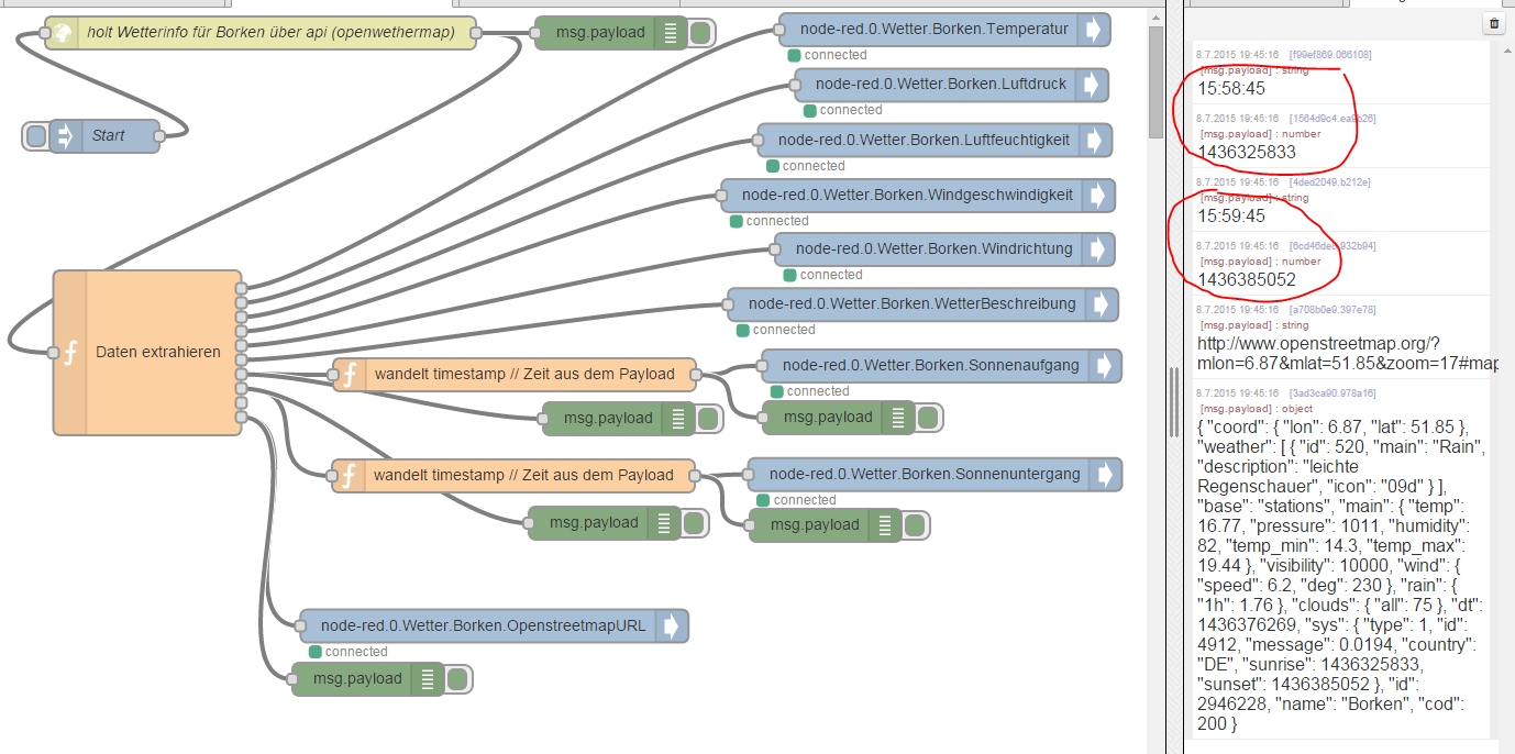

              Habe (nach Datenverlust node-red Update) den Flow wieder eingerichtet und den Anweisungen von ruhr70 gefolgt (Danke für die Erklärungen).
              Nun wird das UNIX-Datum sauber gewandelt
              Nun stellt sich die Frage:
              schicken die falsche Infos?
              • Wetter.Borken.Sonnenaufgang 15:58:45
              Wetter.Borken.Sonnenuntergang 15:59:45
              ! [{"id":"fa31ff8f.80d708","type":"inject","name":"Start","topic":"","payload":"","payloadType":"none","repeat":"","crontab":"","once":false,"x":97,"y":117,"z":"2cd3b4a8.0e4174","wires":[["506d3a8c.ac6554"]]},{"id":"506d3a8c.ac6554","type":"http request","name":"holt Wetterinfo für Borken über api (openwethermap)","method":"GET","ret":"obj","url":"http://api.openweathermap.org/data/2.5/ … 74":[["eb988301.d6d57","3ad3ca90.978a16"]]},{"id":"eb988301.d6d57","type":"function","name":"Daten extrahieren","func":"msg1 = {};\nmsg1.payload = msg.payload.main.temp;\nmsg2 = {};\nmsg2.payload = msg.payload.main.pressure;\nmsg3 = {};\nmsg3.payload = msg.payload.main.humidity;\nmsg4 = {};\nmsg4.payload = msg.payload.wind.speed;\nmsg5 = {};\nmsg5.payload = msg.payload.wind.deg;\nmsg6 = {};\nmsg6.payload = msg.payload.weather[0].description;\nmsg7 = {};\nmsg7.payload = msg.payload.sys.sunrise;\nmsg8 = {};\nmsg8.payload = msg.payload.sys.sunset;\nmsg9 = {};\n\nmsg10 = {};\n// Koordinate inkl. Marker\nmsg10.payload = "http://www.openstreetmap.org/?mlon=" \n + msg.payload.coord.lon + "&mlat="\n + msg.payload.coord.lat + "&zoom=17#map=17/" // Zoom Stufe 17 (beide Werte anpssen, wenn Änderung gewünscht)\n + msg.payload.coord.lat + "/"\n + msg.payload.coord.lon;\n\nreturn [msg1,msg2,msg3,msg4,msg5,msg6,msg7,msg8,msg9,msg10];","outputs":"10","noerr":0,"x":136,"y":314,"z":"2cd3b4a8.0e4174","wires":[["cf581be3.4d61c"],["a77254f5.4b33f"],["a108d2f6.73ac08"],["725a5cf7.76233c"],["cecc69dd.611648"],["2d946d5c.6c9cea"],["3a9fad41.c56052","1564d9c4.ea9b26"],["7c8cb6a1.837348","6cd46de8.932b94"],[],["30ce4c89.0a7d74","a708b0e9.397e78"]]},{"id":"cf581be3.4d61c","type":"ioBroker out","name":"","topic":"node-red.0.Wetter.Borken.Temperatur","ack":"true","autoCreate":"true","x":861.396728515625,"y":20,"z":"2cd3b4a8.0e4174","wires":[]},{"id":"a77254f5.4b33f","type":"ioBroker out","name":"","topic":"node-red.0.Wetter.Borken.Luftdruck","ack":"true","autoCreate":"true","x":867.8253173828125,"y":70.4605712890625,"z":"2cd3b4a8.0e4174","wires":[]},{"id":"a108d2f6.73ac08","type":"ioBroker out","name":"","topic":"node-red.0.Wetter.Borken.Luftfeuchtigkeit","ack":"true","autoCreate":"true","x":852.396728515625,"y":120.6033935546875,"z":"2cd3b4a8.0e4174","wires":[]},{"id":"725a5cf7.76233c","type":"ioBroker out","name":"","topic":"node-red.0.Wetter.Borken.Windgeschwindigkeit","ack":"true","autoCreate":"true","x":837.25390625,"y":170.88922119140625,"z":"2cd3b4a8.0e4174","wires":[]},{"id":"cecc69dd.611648","type":"ioBroker out","name":"","topic":"node-red.0.Wetter.Borken.Windrichtung","ack":"true","autoCreate":"true","x":861.396728515625,"y":219.8890380859375,"z":"2cd3b4a8.0e4174","wires":[]},{"id":"2d946d5c.6c9cea","type":"ioBroker out","name":"","topic":"node-red.0.Wetter.Borken.WetterBeschreibung","ack":"true","autoCreate":"true","x":841.6824951171875,"y":270.1746826171875,"z":"2cd3b4a8.0e4174","wires":[]},{"id":"e05ce497.e20268","type":"ioBroker out","name":"","topic":"node-red.0.Wetter.Borken.Sonnenaufgang","ack":"true","autoCreate":"true","x":858.6824951171875,"y":325.8890380859375,"z":"2cd3b4a8.0e4174","wires":[]},{"id":"c78b0c07.5cbd98","type":"ioBroker out","name":"","topic":"node-red.0.Wetter.Borken.Sonnenuntergang","ack":"true","autoCreate":"true","x":852.5396728515625,"y":424.7462463378906,"z":"2cd3b4a8.0e4174","wires":[]},{"id":"30ce4c89.0a7d74","type":"ioBroker out","name":"","topic":"node-red.0.Wetter.Borken.OpenstreetmapURL","ack":"true","autoCreate":"true","x":451.825439453125,"y":562.6033935546875,"z":"2cd3b4a8.0e4174","wires":[]},{"id":"a708b0e9.397e78","type":"debug","name":"","active":true,"console":"false","complete":"false","x":337,"y":611,"z":"2cd3b4a8.0e4174","wires":[]},{"id":"3ad3ca90.978a16","type":"debug","name":"","active":true,"console":"false","complete":"false","x":558,"y":23,"z":"2cd3b4a8.0e4174","wires":[]},{"id":"3a9fad41.c56052","type":"function","name":"wandelt timestamp // Zeit aus dem Payload","func":"// (1) wandelt timestamp ins ISO Datumformat um\n//msg.timestamp= new Date().toISOString()\n\n// (2) beliebiges Datum festlegbar: hier: YYYY-MM-DD HH:MM.SS\n// (Ausgabeformat wird danz am Ende zusammengestellt)\nvar now = new Date(msg.payload); // Zeit aus dem Payload\nvar year = now.getFullYear();\nvar month = now.getMonth()+1; \nvar day = now.getDate();\nvar hour = now.getHours();\nvar minute = now.getMinutes();\nvar second = now.getSeconds(); \nif(month.toString().length == 1) {\nvar month = '0'+month;\n}\nif(day.toString().length == 1) {\nvar day = '0'+day;\n} \nif(hour.toString().length == 1) {\nvar hour = '0'+hour;\n}\nif(minute.toString().length == 1) {\nvar minute = '0'+minute;\n}\nif(second.toString().length == 1) {\nvar second = '0'+second;\n} \n//msg.timestamp = year+'-'+month+'-'+day+' '+hour+':'+minute+':'+second;\nmsg.payload = hour+':'+minute+':'+second;\n\nreturn msg;","outputs":1,"noerr":0,"x":470,"y":334,"z":"2cd3b4a8.0e4174","wires":[["e05ce497.e20268","f99ef869.066108"]]},{"id":"7c8cb6a1.837348","type":"function","name":"wandelt timestamp // Zeit aus dem Payload","func":"// (1) wandelt timestamp ins ISO Datumformat um\n//msg.timestamp= new Date().toISOString()\n\n// (2) beliebiges Datum festlegbar: hier: YYYY-MM-DD HH:MM.SS\n// (Ausgabeformat wird danz am Ende zusammengestellt)\nvar now = new Date(msg.payload); // Zeit aus dem Payload\nvar year = now.getFullYear();\nvar month = now.getMonth()+1; \nvar day = now.getDate();\nvar hour = now.getHours();\nvar minute = now.getMinutes();\nvar second = now.getSeconds(); \nif(month.toString().length == 1) {\nvar month = '0'+month;\n}\nif(day.toString().length == 1) {\nvar day = '0'+day;\n} \nif(hour.toString().length == 1) {\nvar hour = '0'+hour;\n}\nif(minute.toString().length == 1) {\nvar minute = '0'+minute;\n}\nif(second.toString().length == 1) {\nvar second = '0'+second;\n} \n//msg.timestamp = year+'-'+month+'-'+day+' '+hour+':'+minute+':'+second;\nmsg.payload = hour+':'+minute+':'+second;\n\nreturn msg;","outputs":1,"noerr":0,"x":469,"y":426,"z":"2cd3b4a8.0e4174","wires":[["c78b0c07.5cbd98","4ded2049.b212e"]]},{"id":"1564d9c4.ea9b26","type":"debug","name":"","active":true,"console":"false","complete":"false","x":565,"y":374,"z":"2cd3b4a8.0e4174","wires":[]},{"id":"f99ef869.066108","type":"debug","name":"","active":true,"console":"false","complete":"false","x":765,"y":373,"z":"2cd3b4a8.0e4174","wires":[]},{"id":"6cd46de8.932b94","type":"debug","name":"","active":true,"console":"false","complete":"false","x":552,"y":469,"z":"2cd3b4a8.0e4174","wires":[]},{"id":"4ded2049.b212e","type":"debug","name":"","active":true,"console":"false","complete":"false","x":753,"y":471,"z":"2cd3b4a8.0e4174","wires":[]}]
              oder habe ich etwas verbogen?
              Jürgen
              PS.: Leider funktioniert "var isoZeit = new Date(mparseInt(sg.payload.sys.sunrise))" nicht

                    • ruhr70
                      ruhr70 last edited by
                      So, habe mir das angesehen (mit den falschen Zeiten).
                      Dir fehlen ein paar Sekunden.
                      Dein msg.payload liefert die Sekunden seit dem 1.1.1970.
                      Die Funktion:
                      Arbeitet mir den Millisekunden seit dem 1.1.1970
                      Du musst msg.payload noch mit 1.000 multiplizieren. Dann stimmen auch die Zeiten.
                      Wg. dem ISO habe ich noch nicht geschaut.
