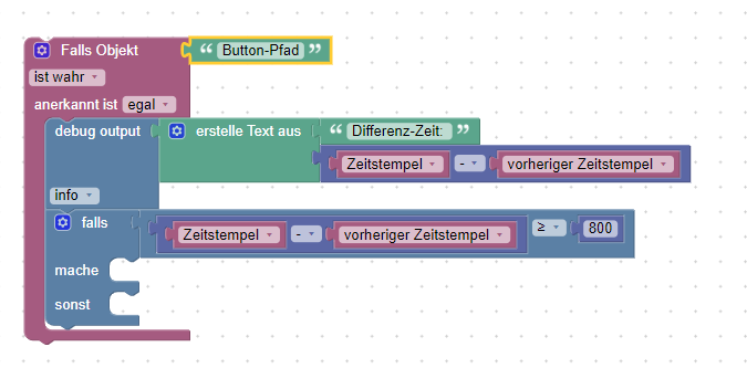

        MCU @Raducanu last edited by
        @Raducanu
          Raducanu @MCU last edited by
          @MCU
          Perfekt, vielen Dank
