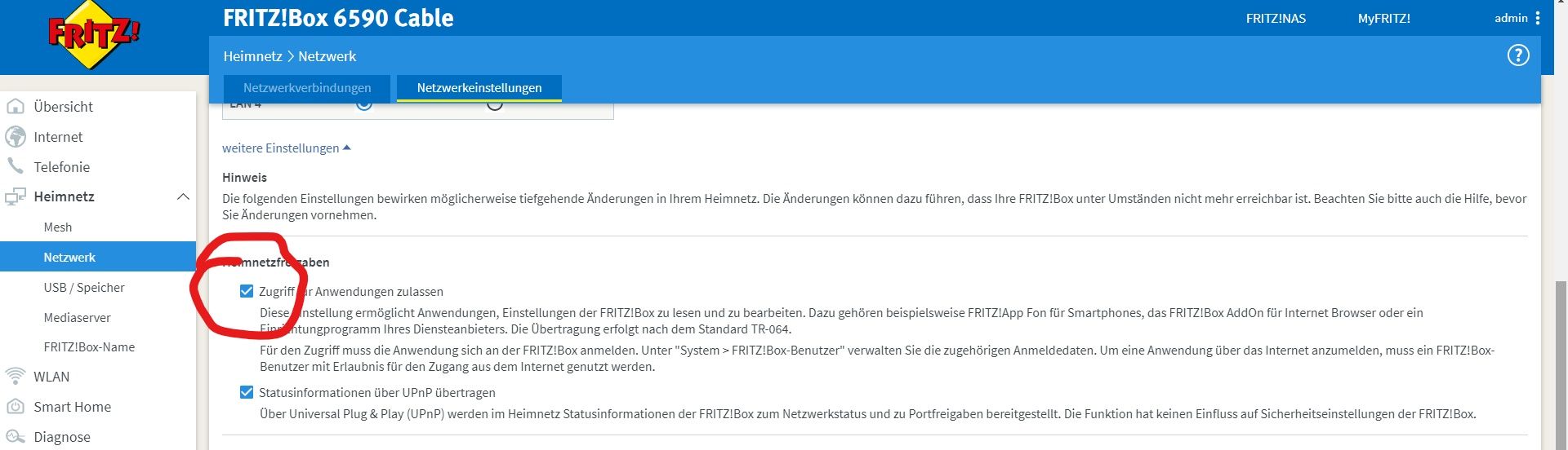

        sigi234 Forum Testing Most Active @Trusit last edited by
        @Trusit
          Trusit @sigi234 last edited by
          @sigi234
          Super vielen dank!
          Der Adapter startet nun.
