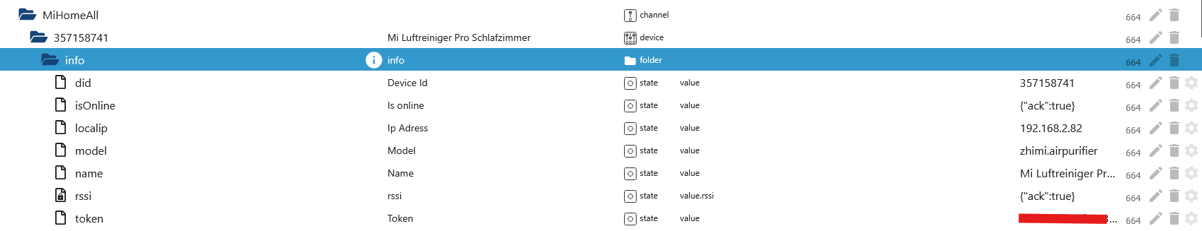

          Jetzt habe ich mit dem Windows Tool alle Xiaomi Daten.
          Allerdings legt das Skript einen Ordner an, mit genau nur den Daten.
          Name, Token....
          Keine Geräte Daten.
          Dazu noch ne Warnung.
          javascript.0	2025-11-13 09:47:23.685	info	State value to set for "javascript.0.MiHomeAll.357158741.info.rssi" has to be type "number" but received type "object"
          javascript.0	2025-11-13 09:47:23.622	warn	Read-only state "javascript.0.MiHomeAll.357158741.info.rssi" has been written without ack-flag with value "null"
          javascript.0	2025-11-13 09:47:23.487	info	script.js.MiHome: registered 1 subscription, 0 schedules, 0 messages, 0 logs and 0 file subscriptions
          javascript.0	2025-11-13 09:47:23.486	info	script.js.MiHome: Preparing device Mi Luftreiniger Pro Schlafzimmer
          javascript.0	2025-11-13 09:47:23.486	info	script.js.MiHome: Found 1 local devices.

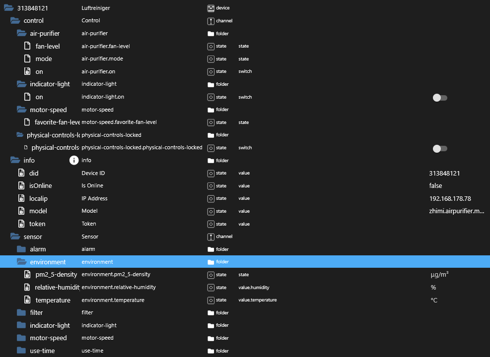

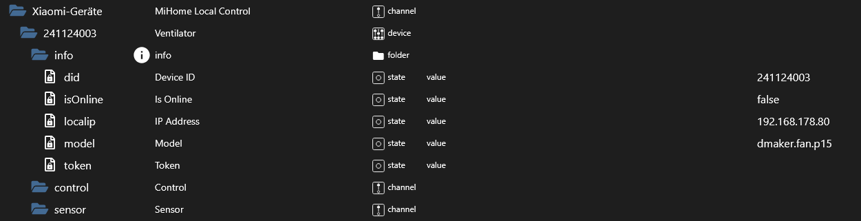

              hab mich mal auch auf die schnelle daran versucht, Datenpunkte werden angelegt, sollte funktionieren, hab hier nur mal meinen 3H eingetragen
              const SkriptVersion = "0.3.4-fixed"; // vom 14.11.2025 - LOKALE STEUERUNG MIT TOKENS - MIoT STRUKTUR - REORGANISIERT - Power read-only
              const mihome = require('node-mihome');
              // 🔑 KONFIGURATION - TOKENS & LOKALE IPs
              // Token-Auslesen: https://github.com/PiotrMachowski/Xiaomi-cloud-tokens-extractor
              const devices = [
                     name: "Mi Air Purifier 3/3H",
                     model: "zhimi.airpurifier.mb3",
                     did: "xxxxxxxxx",
                     localip: "10.1.1.92",
                     token: "xxxxxxxxxxxxxxxxxxxxxxxxx",
                     enabled: true
              const praefix0 = "javascript.0.MiHomeDE";
              const refresh = 10000;
              const logging = true;
              // DEVICE DEFINITIONS - MIoT STRUKTUR - REORGANISIERT
              const DefineDevice = [];
              // Luftreiniger MB3 (3H)
              DefineDevice[0] = {
                 description: "Purifier 3H",
                 setter: {
                     "air-purifier.mode": async function (obj, val) {
                         try {
                             await device[obj].setMode(val);
                             log("✅ Mode set to: " + val);
                         } catch(e) {
                             log("❌ setMode error: " + e.message, "error");
                     "air-purifier.fan-level": async function (obj, val) {
                         try {
                             await device[obj].setFanLevel(val);
                             log("✅ Fan level set to: " + val);
                         } catch(e) {
                             log("❌ setFanLevel error: " + e.message, "error");
                     "motor-speed.favorite-fan-level": async function (obj, val) {
                         try {
                             await device[obj].setFavLevel(val);
                             log("✅ Favorite level set to: " + val);
                         } catch(e) {
                             log("❌ setFavLevel error: " + e.message, "error");
                     "indicator-light.on": async function (obj, val) {
                         try {
                             await device[obj].setLcdBrightness(val ? 2 : 0);
                             log("✅ Indicator light set to: " + (val ? 'on' : 'off'));
                         } catch(e) {
                             log("❌ setLcdBrightness error: " + e.message, "error");
                     "physical-controls-locked.physical-controls-locked": async function (obj, val) {
                         try {
                             await device[obj].setChildLock(val);
                             log("✅ Child lock set to: " + val);
                         } catch(e) {
                             log("❌ setChildLock error: " + e.message, "error");
                 control: [
                     { name: "air-purifier.on", type: "boolean", role: "switch", read: true, write: false },
                     { name: "air-purifier.mode", type: "number", read: true, write: true, min: 0, max: 3, states: { 0: "auto", 1: "sleep", 2: "favorite", 3: "fanset" } },
                     { name: "air-purifier.fan-level", type: "number", read: true, write: true, min: 1, max: 3 },
                     { name: "motor-speed.favorite-fan-level", type: "number", read: true, write: true, min: 0, max: 14 },
                     { name: "indicator-light.on", type: "boolean", role: "switch", read: true, write: true },
                     { name: "physical-controls-locked.physical-controls-locked", type: "boolean", role: "switch", read: true, write: true }
                 sensor: [
                     { name: "alarm.alarm", type: "boolean", role: "switch", read: true, write: false },
                     { name: "indicator-light.brightness", type: "number", read: true, write: false, min: 0, max: 2 },
                     { name: "environment.temperature", type: "number", role: "value.temperature", read: true, write: false, unit: "°C" },
                     { name: "motor-speed.motor-speed", type: "number", read: true, write: false, unit: "rpm" },
                     { name: "use-time.use-time", type: "number", read: true, write: false, unit: "h" },
                     { name: "environment.relative-humidity", type: "number", role: "value.humidity", read: true, write: false, unit: "%" },
                     { name: "environment.pm2_5-density", type: "number", read: true, write: false, unit: "μg/m³" },
                     { name: "filter.filter-life-level", type: "number", read: true, write: false, unit: "%" },
                     { name: "filter.filter-used-time", type: "number", read: true, write: false, unit: "h" }
              // AB HIER NICHT ÄNDERN
              let device = [];
              const States = [];
              let DpCount = 0;
              let GenericDpRefreshIntervalObj;
              const DefineDeviceInfo = [
                 { id: "localip", name: "IP Address", type: "string", read: true, write: false },
                 { id: "token", name: "Token", type: "string", read: true, write: false },
                 { id: "did", name: "Device ID", type: "string", read: true, write: false },
                 { id: "model", name: "Model", type: "string", read: true, write: false },
                 { id: "isOnline", name: "Is Online", type: "boolean", read: true, write: false }
              log("Starting AllMyMi V." + SkriptVersion);
              log("Devices configured: " + devices.length);
              function CorrectChannelId(cid) {
                 let temp = cid;
                 if (typeof temp !== "string") {
                     temp = JSON.stringify(cid);
                 temp = cid.replace(/\./g, "-");
                 temp = cid.replace(/:/g, ".");
                 return temp;
              function PrepareGenericDps(did) {
                 if (logging) log("Preparing generic DPs for: " + did);
                 for (let y in DefineDeviceInfo) {
                     States[DpCount] = {
                         id: praefix0 + "." + did + ".info." + DefineDeviceInfo[y].id,
                         initial: "",
                         forceCreation: false,
                         common: {
                             read: DefineDeviceInfo[y].read,
                             write: DefineDeviceInfo[y].write,
                             type: DefineDeviceInfo[y].type,
                             role: "value",
                             unit: DefineDeviceInfo[y].unit || ""
                     DpCount++;
              function PrepareDeviceDps(did, model) {
                 if (logging) log("Preparing device DPs for model: " + model);
                 for (let x in DefineDevice) {
                     if (DefineDevice[x].model === model) {
                         // Control Datenpunkte
                         if (DefineDevice[x].control) {
                             for (let y in DefineDevice[x].control) {
                                 let channelId = CorrectChannelId(DefineDevice[x].control[y].name);
                                 States[DpCount] = {
                                     id: praefix0 + "." + did + ".control." + channelId,
                                     initial: "",
                                     common: DefineDevice[x].control[y]
                                 DpCount++;
                         // Sensor Datenpunkte
                         if (DefineDevice[x].sensor) {
                             for (let y in DefineDevice[x].sensor) {
                                 let channelId = CorrectChannelId(DefineDevice[x].sensor[y].name);
                                 States[DpCount] = {
                                     id: praefix0 + "." + did + ".sensor." + channelId,
                                     initial: "",
                                     common: DefineDevice[x].sensor[y]
                                 DpCount++;
              function CreateStates() {
                 if (logging) log("Creating States...");
                 let numStates = States.length;
                 log("Total states to create: " + numStates);
                 if (numStates === 0) {
                     log("❌ No states to create! Check device configuration.", "error");
                     return;
                 States.forEach(function (state) {
                     createState(state.id, state.initial, state.forceCreation, state.common, function () {
                         numStates--;
                             log("✅ " + States.length + " States created!");
                             setObject(praefix0, {
                                 type: 'channel',
                                 common: { name: "MiHome Local Control" },
                                 native: {}
                             for (let i = 0; i < devices.length; i++) {
                                 if (devices[i].enabled) {
                                     setObject(praefix0 + "." + devices[i].did, {
                                         type: 'device',
                                         common: { name: devices[i].name },
                                         native: {}
                                     setObject(praefix0 + "." + devices[i].did + ".control", {
                                         type: 'channel',
                                         common: { name: "Control" },
                                         native: {}
                                     setObject(praefix0 + "." + devices[i].did + ".sensor", {
                                         type: 'channel',
                                         common: { name: "Sensor" },
                                         native: {}
                             Init();
              async function Init() {
                 log("🚀 Initializing local device connections...");
                 mihome.miioProtocol.init();
                 let deviceCount = 0;
                     if (!devices[i].enabled) {
                         if (logging) log("Device " + devices[i].name + " is disabled, skipping");
                         continue;
                     try {
                         log("Connecting to: " + devices[i].name + " (" + devices[i].localip + ")");
                         device[deviceCount] = mihome.device({
                             model: devices[i].model,
                             address: devices[i].localip,
                             token: devices[i].token,
                             refresh: refresh
                         device[deviceCount].model = devices[i].model;
                         device[deviceCount].deviceConfig = devices[i];
                         device[deviceCount].deviceIndex = i;
                         device[deviceCount].isOnline = false;
                         device[deviceCount].data = {};
                         device[deviceCount].on('properties', (data) => {
                             if (typeof data !== "undefined" && Object.keys(data).length > 0) {
                                 RefreshDps(deviceCount, data);
                         device[deviceCount].on('connected', () => {
                             log("✅ Device connected: " + devices[i].name);
                             device[deviceCount].isOnline = true;
                             setState(praefix0 + "." + devices[i].did + ".info.isOnline", true, true);
                         device[deviceCount].on('disconnected', () => {
                             log("⚠️ Device disconnected: " + devices[i].name);
                             setState(praefix0 + "." + devices[i].did + ".info.isOnline", false, true);
                         await device[deviceCount].init();
                         log("✅ Device initialized: " + devices[i].name);
                         // Set device info
                         setState(praefix0 + "." + devices[i].did + ".info.did", devices[i].did, true);
                         setState(praefix0 + "." + devices[i].did + ".info.model", devices[i].model, true);

                                  • Siggi0904
                                    Siggi0904 last edited by
                                    Mein Ventilator sieht in den Datenpunkten so aus:
                                    Und mein Luftreiniger so:
                                    Leider alles ohne aktuelle Werte.
                                    • crunchip
                                      crunchip Forum Testing Most Active @Siggi0904 last edited by
                                      @siggi0904 sagte in [Vorlage] Xiaomi Airpurifier 3H u.a. inkl. Token auslesen.:
                                      @crunchip sagte in [Vorlage] Xiaomi Airpurifier 3H u.a. inkl. Token auslesen.:
                                      Sensordaten werden allerdings nicht ausgelesen
                                      490
