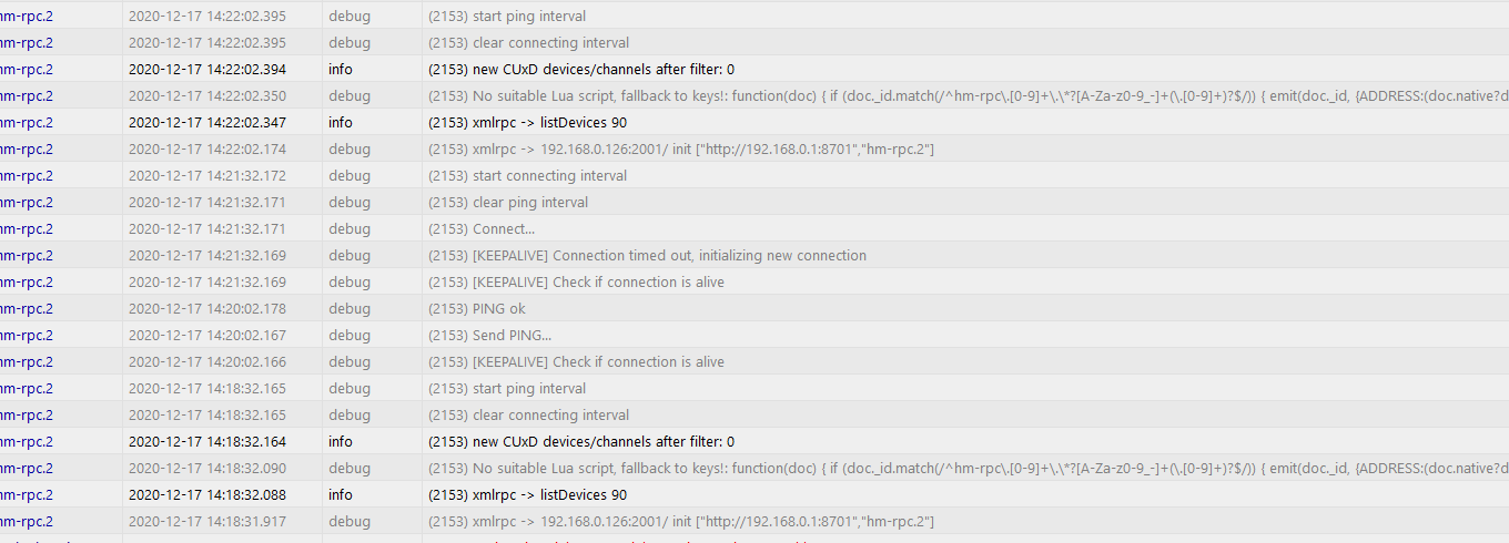

            @Homoran
            m-rpc.2	2020-12-17 17:36:48.630	debug	(15530) PING ok
            hm-rpc.2	2020-12-17 17:36:48.621	debug	(15530) Send PING...
            hm-rpc.2	2020-12-17 17:36:48.620	debug	(15530) [KEEPALIVE] Check if connection is alive
            hm-rpc.2	2020-12-17 17:35:18.619	debug	(15530) start ping interval
            hm-rpc.2	2020-12-17 17:35:18.619	debug	(15530) clear connecting interval
            hm-rpc.2	2020-12-17 17:35:18.618	info	(15530) new CUxD devices/channels after filter: 0
            hm-rpc.2	2020-12-17 17:35:18.578	debug	(15530) No suitable Lua script, fallback to keys!: function(doc) { if (doc._id.match(/^hm-rpc\.[0-9]+\.\*?[A-Za-z0-9_-]+(\.[0-9]+)?$/)) { emit(doc._id, {ADDRESS:(doc.native?doc.native.ADDRESS:'')
            hm-rpc.2	2020-12-17 17:35:18.576	info	(15530) xmlrpc -> listDevices 90
            hm-rpc.2	2020-12-17 17:35:18.379	debug	(15530) xmlrpc -> 192.168.0.126:2001/ init ["http://192.168.0.1:8701","hm-rpc.2"]
            hm-rpc.2	2020-12-17 17:34:48.377	debug	(15530) start connecting interval
            hm-rpc.2	2020-12-17 17:34:48.377	debug	(15530) clear ping interval
            hm-rpc.2	2020-12-17 17:34:48.376	debug	(15530) Connect...
            hm-rpc.2	2020-12-17 17:34:48.375	debug	(15530) [KEEPALIVE] Connection timed out, initializing new connection
            hm-rpc.2	2020-12-17 17:34:48.374	debug	(15530) [KEEPALIVE] Check if connection is alive
            hm-rpc.2	2020-12-17 17:33:18.385	debug	(15530) PING ok
            hm-rpc.2	2020-12-17 17:33:18.374	debug	(15530) Send PING...
            hm-rpc.2	2020-12-17 17:33:18.373	debug	(15530) [KEEPALIVE] Check if connection is alive
            hm-rpc.2	2020-12-17 17:31:48.372	debug	(15530) start ping interval
            hm-rpc.2	2020-12-17 17:31:48.372	debug	(15530) clear connecting interval
            hm-rpc.2	2020-12-17 17:31:48.371	info	(15530) new CUxD devices/channels after filter: 0
            hm-rpc.2	2020-12-17 17:31:48.329	debug	(15530) No suitable Lua script, fallback to keys!: function(doc) { if (doc._id.match(/^hm-rpc\.[0-9]+\.\*?[A-Za-z0-9_-]+(\.[0-9]+)?$/)) { emit(doc._id, {ADDRESS:(doc.native?doc.native.ADDRESS:'')
            hm-rpc.2	2020-12-17 17:31:48.327	info	(15530) xmlrpc -> listDevices 90
            hm-rpc.2	2020-12-17 17:31:48.153	debug	(15530) xmlrpc -> 192.168.0.126:2001/ init ["http://192.168.0.1:8701","hm-rpc.2"]
            hm-rpc.2	2020-12-17 17:31:18.151	debug	(15530) start connecting interval
            hm-rpc.2	2020-12-17 17:31:18.150	debug	(15530) clear ping interval
            hm-rpc.2	2020-12-17 17:31:18.150	debug	(15530) Connect...
            hm-rpc.2	2020-12-17 17:31:18.149	debug	(15530) [KEEPALIVE] Connection timed out, initializing new connection
            hm-rpc.2	2020-12-17 17:31:18.148	debug	(15530) [KEEPALIVE] Check if connection is alive
            host.raspberrypi-IOB	2020-12-17 17:30:16.000	info	instance system.adapter.ical.0 terminated with code 0 (NO_ERROR)

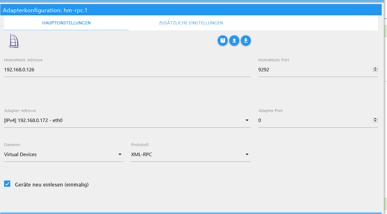

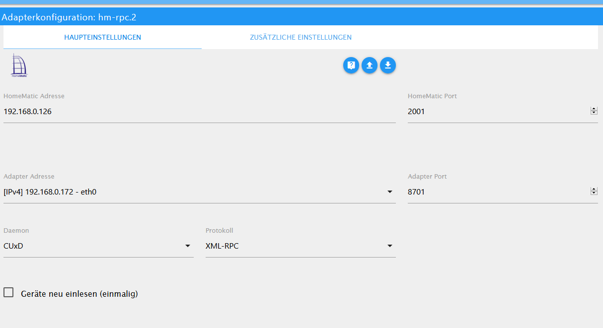

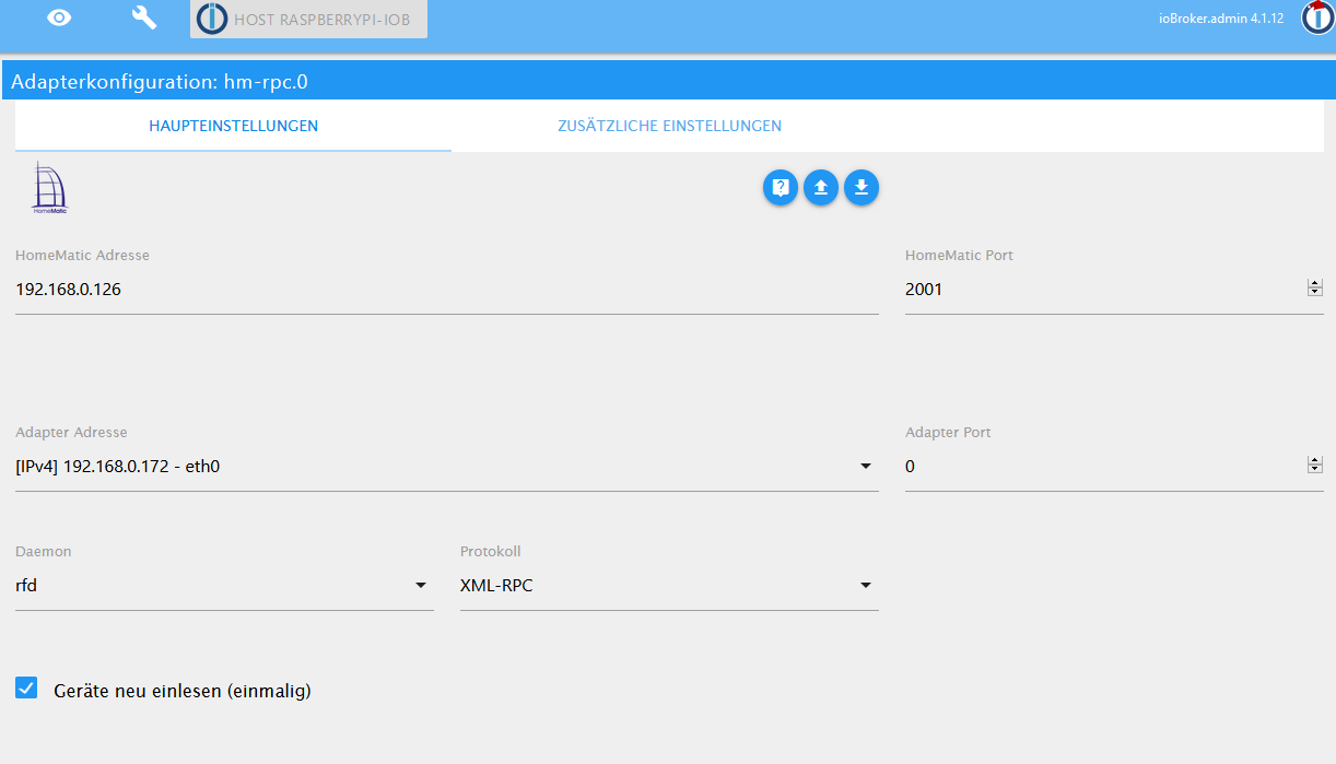

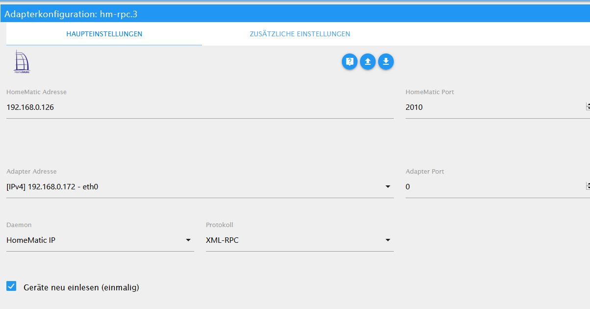

                2020-12-17 18_14_41-instances - ioBroker.png 2020-12-17 18_15_24-Raspberrymatic IOBroker Temperaturen keine Aktualisieung – Opera.png 2020-12-17 18_15_49-instances - ioBroker.png 2020-12-17 18_16_12-instances - ioBroker.png
                  Homoran Global Moderator Administrators @AlphaII last edited by Homoran
                  @AlphaII sagte in Raspberrymatic IOBroker Temperaturen keine Aktualisieung:
                  Auf der 192.168.0.1 läuft der Router
                  das hab ich mir gedacht, deswegen auch deine Probleme.
                  Auch wenn du mir immer noch nicht deine vollständigen Einstellungen zeigst, hast du gesagt:
                  Adapter Callback ist allerdings 192.168.0.1
                  Dann schickt die CCU ihre Daten genau dorthin - zu dem Router
                  Wie du schön sehen kannst, hat ioBroker nie Daten bekommen, sonst wäre der Haken bei "neu einlesen" längst weg
