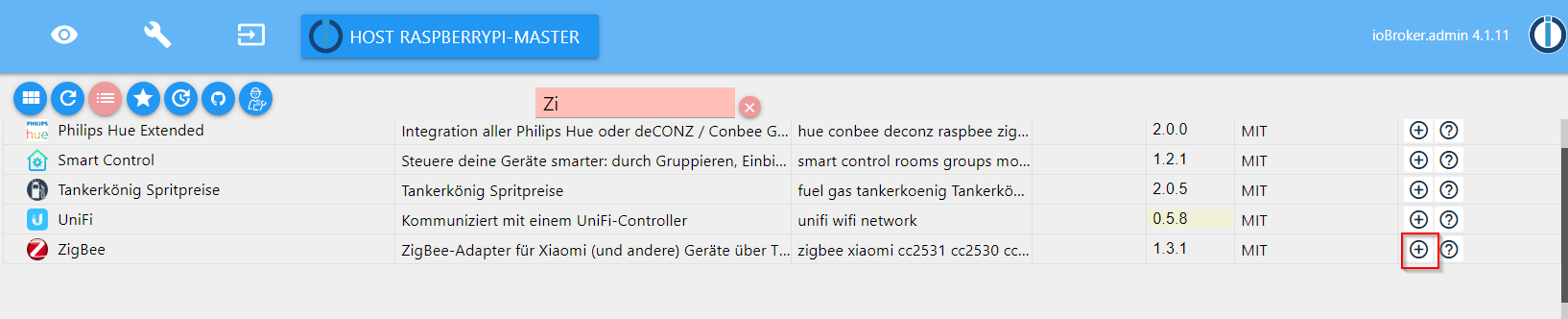

      Hallo Ich kann keine Instanz desdes Zigbee adapters im ioBroker installieren

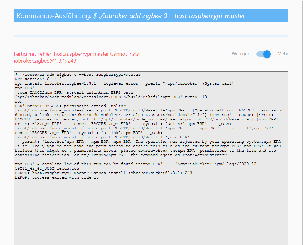

      wenn ich es versuche bekomme ich immer folgenden Error log
      $ ./iobroker add zigbee  --host raspberrypi-master
      NPM version: 6.14.8
      npm install iobroker.zigbee@1.3.1 --loglevel error --prefix "/opt/iobroker" (System call)
      npm ERR! code EACCESnpm ERR! syscall unlinknpm ERR! path /opt/iobroker/node_modules/.serialport.DELETE/build/Makefilenpm ERR! errno -13
      npm ERR! Error: EACCES: permission denied, unlink '/opt/iobroker/node_modules/.serialport.DELETE/build/Makefile'npm ERR!  [OperationalError: EACCES: permission denied, unlink '/opt/iobroker/node_modules/.serialport.DELETE/build/Makefile'] {npm ERR!   cause: [Error: EACCES: permission denied, unlink '/opt/iobroker/node_modules/.serialport.DELETE/build/Makefile'] {npm ERR!     errno: -13,npm ERR!     code: 'EACCES',npm ERR!     syscall: 'unlink',npm ERR!     path: '/opt/iobroker/node_modules/.serialport.DELETE/build/Makefile'npm ERR!   },npm ERR!   errno: -13,npm ERR!   code: 'EACCES',npm ERR!   syscall: 'unlink',npm ERR!   path: '/opt/iobroker/node_modules/.serialport.DELETE/build/Makefile',npm ERR!   parent: 'iobroker'npm ERR! }npm ERR! npm ERR! The operation was rejected by your operating system.npm ERR! It is likely you do not have the permissions to access this file as the current usernpm ERR! npm ERR! If you believe this might be a permissions issue, please double-check thenpm ERR! permissions of the file and its containing directories, or try runningnpm ERR! the command again as root/Administrator.
      npm ERR! A complete log of this run can be found in:npm ERR!     /home/iobroker/.npm/_logs/2020-12-18T23_12_11_752Z-debug.log
      ERROR: host.raspberrypi-master Cannot install iobroker.zigbee@1.3.1: 243
      ERROR: process exited with code 25

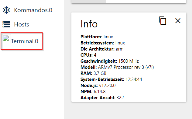

                   Runlevel 5   2020-12-19 00:00
          iobroker
          iobroker tty dialout audio bluetooth gpio i2c
          /opt/iobroker$

            @Laxs Du meldest dich nicht als User 'iobroker' an. Das ist ein Systemuser und der hat auch kein Passwort. Hast du dir einen Standarduser angelegt, der iobroker heißt? Das wäre ungeschickt.
            [Edith:] Es wird wohl der Terminal-Adapter genutzt. Ich empfehle per SSH auf den Rechner zu gehen.
            Und bitte die kompletten Ein- und Ausgaben zeigen, nix wegkürzen.

                Laxs @Thomas Braun last edited by
                @Thomas-Braun
                wenn ich den Terminal von der ioBroker Admin dann geht er als iobroker rein
                dachte das ist dann auch der user den der ioBroker Admin zur installation der Zigbee instanz verwendet, da ich die Instanz aus der ioBroker.admin Oberfläche installier
                hier bekomme ich dann auch den Fehler
                Wenn ich über SSH auf den Pi gehe nutze ich einen anderen User

                  Thomas Braun Most Active @Laxs last edited by Thomas Braun
                  @Laxs
                  Das ist ein Master/Slave Setup?
                  Versuch mal
                  iobroker stop
                  iobroker fix
                  Ich vermute das Grundsystem könnte auch aktualisiert werden:
                  sudo apt update
                  sudo apt upgrade
                  sudo reboot
                  Am Rande: Den terminal-Adapter braucht es eigentlich nicht, würde ich rauskicken. Du hast doch eine Konsole direkt systemseitig.
                  Den Runlevel würde ich auch auf 3 setzen, es hängt ja kein Display dran, wenn ich das richtig sehe.
                    @Thomas-Braun
                    danke Dir das hat geholfen.
                    Jetzt funktioniert es wieder.
