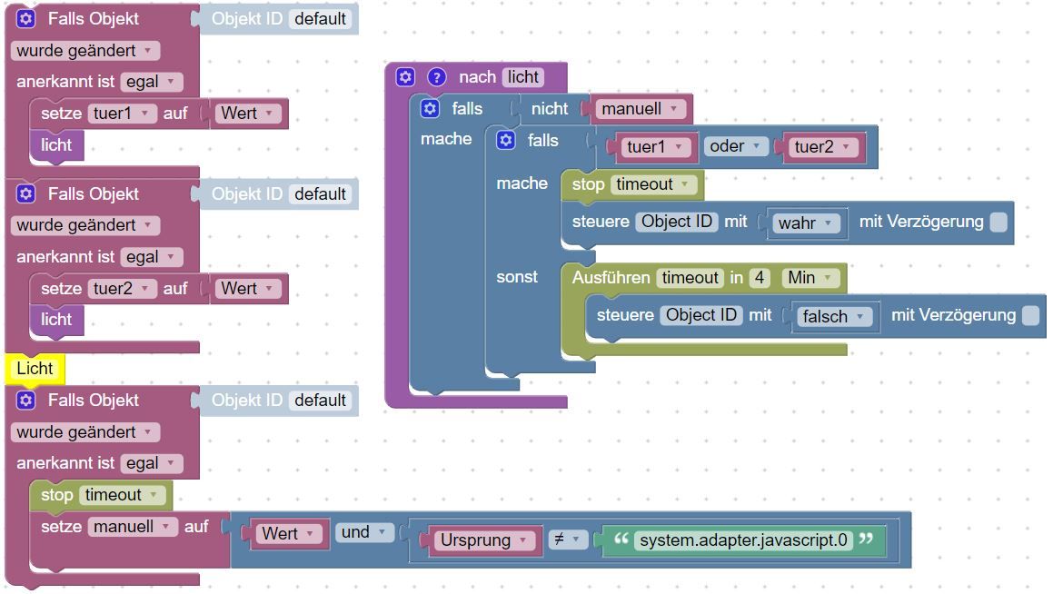

        paul53 @burgerking68 last edited by paul53
        @burgerking68
        Vorschlag:
         <variables>
           <variable id="9edRg.`~|ddTBJ^H!~QN">tuer1</variable>
           <variable id="g@MdLAs[%D4EbK^iC0$I">tuer2</variable>
           <variable id="{yAQS:~/f9N!~9^ETuw2">manuell</variable>
         </variables>
         <block type="on_ext" id="Np:Z}qL-u`%S|S,]sHBl" x="62" y="38">
           <value name="OID0">
             <shadow type="field_oid" id="{r2;sWJD2DX~92OC=`Q]">
             <block type="variables_set" id="O=q?5oBbs$pH(9.e0kB#">
               <field name="VAR" id="9edRg.`~|ddTBJ^H!~QN">tuer1</field>
                 <block type="on_source" id="UF0sNEu)eNQx?.LSzuKK">
                 <block type="procedures_callnoreturn" id="Mk[T__|awhIQ:O0OP?sY">
                   <mutation name="licht"></mutation>
             <block type="on_ext" id="SN#q5*lF-H3A$,p.F#w0">
               <value name="OID0">
                 <shadow type="field_oid" id="o@de|%dEPo-lyR@GbdU@">
                 <block type="variables_set" id="h=av]8Qz^/zrX(bJIhR$">
                   <field name="VAR" id="g@MdLAs[%D4EbK^iC0$I">tuer2</field>
                     <block type="on_source" id="r2G#IOBDm4Qrh)a|RVF`">
                     <block type="procedures_callnoreturn" id="uN/n$s[Z9)!/_))~!-V0">
                 <block type="comment" id="dI_lkVafGw@xa@?ROi|n">
                   <field name="COMMENT">Licht</field>
                     <block type="on_ext" id="-ktj0OJC??j)uJbNIhY;">
                       <value name="OID0">
                         <shadow type="field_oid" id="}|6,i{_5pgung$nPU?q7">
                         <block type="timeouts_cleartimeout" id="yec7(VK!FL{B8;PVlPcs">
                             <block type="variables_set" id="IwR/u=SzM`=c8M,kSQEh">
                               <field name="VAR" id="{yAQS:~/f9N!~9^ETuw2">manuell</field>
                                 <block type="logic_operation" id="VRSfXfCDOaD@%n3JDy4/">
                                   <field name="OP">AND</field>
                                     <block type="on_source" id="Zt%ZUxE]5=f$2h58-i5v">
                                     <block type="logic_compare" id="5J?0^5z[gtX9?c_zRe!d">
                                       <field name="OP">NEQ</field>
                                         <block type="on_source" id="Cuc:}L2E|pYz~.JC#{m@">
                                           <field name="ATTR">state.from</field>
                                         <block type="text" id="QyS)b3`]%HoTUHE7?3SI">
                                           <field name="TEXT">system.adapter.javascript.0</field>
         <block type="procedures_defnoreturn" id="9o[]^%1S+,)K=(vJ;/fD" x="387" y="88">
           <field name="NAME">licht</field>
           <statement name="STACK">
             <block type="controls_if" id="I-MjD+8x9VfudfXxsecb">
                 <block type="logic_negate" id="cl/=hGxJ;5_G7S@bJsTE">
                   <value name="BOOL">
                     <block type="variables_get" id="C^(Ddcqvt7^y^+QVl]/_">
                 <block type="controls_if" id="BBVR3UZCh*K-6qfAH#4P">
                     <block type="logic_operation" id="QNpc,rQq}-)g2tVe;ooc">
                       <field name="OP">OR</field>
                         <block type="variables_get" id="cO.{R0IZ%j{/~API(kDL">
                         <block type="variables_get" id="T@DpAk6DhpYexu^cD,L;">
                     <block type="timeouts_cleartimeout" id="6nevAZH-HwSaU+Uo+1NO">
                         <block type="control" id="2q)}+/|J.t=eIuk=]MnA">
                             <block type="logic_boolean" id="FMn+O!FhEsV,[:9z#,}M">
                   <statement name="ELSE">
                     <block type="timeouts_settimeout" id="(8m$o!C1]SDb-|uwU)q^">
                       <field name="DELAY">4</field>
                         <block type="control" id="9KV,-0@[by=wif0}/;}9">
                             <block type="logic_boolean" id="w`]SLF^M%H%|v:.)N=/q">
          @paul53 : Danke...ich werde es mal schnellstmöglich testen und mich dann "im nächsten Jahr" dazu melden! 👍
