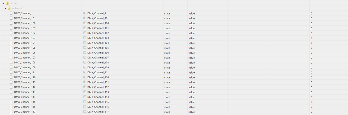

      Leider erhalte ich diese Fehlermeldungen im LOG, sobald ich das Script starte:
      javascript.0	2021-01-07 11:00:53.200	warn	(4588) This object will not be created in future versions. Please report this to the developer.
      javascript.0	2021-01-07 11:00:53.200	warn	(4588) Object javascript.0.artnet.universe0.DMX_Channel_512 is invalid: obj.common.type has an invalid value (int) but has to be one of number, string, boolean, array, object, mixed, file, json
      javascript.0	2021-01-07 11:00:53.200	warn	(4588) Object javascript.0.artnet.universe0.DMX_Channel_511 is invalid: obj.common.type has an invalid value (int) but has to be one of number, string, boolean, array, object, mixed, file, json
      javascript.0	2021-01-07 11:00:53.200	warn	(4588) Object javascript.0.artnet.universe0.DMX_Channel_510 is invalid: obj.common.type has an invalid value (int) but has to be one of number, string, boolean, array, object, mixed, file, json
      javascript.0	2021-01-07 11:00:53.200	warn	(4588) Object javascript.0.artnet.universe0.DMX_Channel_509 is invalid: obj.common.type has an invalid value (int) but has to be one of number, string, boolean, array, object, mixed, file, json
      javascript.0	2021-01-07 11:00:53.200	warn	(4588) Object javascript.0.artnet.universe0.DMX_Channel_508 is invalid: obj.common.type has an invalid value (int) but has to be one of number, string, boolean, array, object, mixed, file, json
      javascript.0	2021-01-07 11:00:53.200	warn	(4588) Object javascript.0.artnet.universe0.DMX_Channel_507 is invalid: obj.common.type has an invalid value (int) but has to be one of number, string, boolean, array, object, mixed, file, json
      javascript.0	2021-01-07 11:00:53.200	warn	(4588) Object javascript.0.artnet.universe0.DMX_Channel_506 is invalid: obj.common.type has an invalid value (int) but has to be one of number, string, boolean, array, object, mixed, file, json
      javascript.0	2021-01-07 11:00:53.200	warn	(4588) Object javascript.0.artnet.universe0.DMX_Channel_505 is invalid: obj.common.type has an invalid value (int) but has to be one of number, string, boolean, array, object, mixed, file, json
      javascript.0	2021-01-07 11:00:53.200	warn	(4588) Object javascript.0.artnet.universe0.DMX_Channel_504 is invalid: obj.common.type has an invalid value (int) but has to be one of number, string, boolean, array, object, mixed, file, json
      javascript.0	2021-01-07 11:00:53.200	warn	(4588) Object javascript.0.artnet.universe0.DMX_Channel_503 is invalid: obj.common.type has an invalid value (int) but has to be one of number, string, boolean, array, object, mixed, file, json
      javascript.0	2021-01-07 11:00:53.200	warn	(4588) Object javascript.0.artnet.universe0.DMX_Channel_502 is invalid: obj.common.type has an invalid value (int) but has to be one of number, string, boolean, array, object, mixed, file, json
      javascript.0	2021-01-07 11:00:53.200	warn	(4588) Object javascript.0.artnet.universe0.DMX_Channel_501 is invalid: obj.common.type has an invalid value (int) but has to be one of number, string, boolean, array, object, mixed, file, json
      javascript.0	2021-01-07 11:00:53.200	warn	(4588) Object javascript.0.artnet.universe0.DMX_Channel_500 is invalid: obj.common.type has an invalid value (int) but has to be one of number, string, boolean, array, object, mixed, file, json
      Kann mir jemand sagen wo das Problem liegt bzw. helfen das Script zum Laufen zu bringen?
      Danke.
      Beste Grüße
        paul53 @Qlink last edited by
        @Qlink
        Ändere Zeilen 49, 50 in:
                            type: 'number',
                            role: 'level',
        Q 1 Reply Last reply Reply Quote 1
        • Q
          Qlink @paul53 last edited by
          Vielen Dank für die Hilfe. Jetzt läuft das Script wieder sauber ohne Fehlermeldung durch 🙂

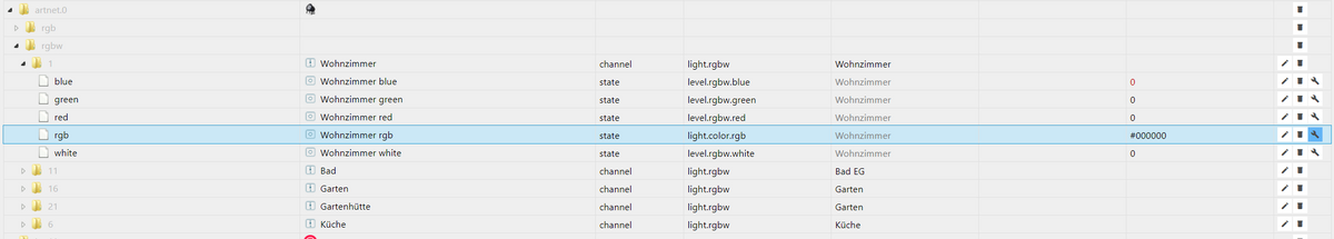

            Das Script funktioniert dank deiner Hilfe jetzt wie es soll und ich kann für jeden Farbkanal einen Wert von 0-255 vergeben.
            Was allerdings noch fehlt ist die Möglichkeit für z.B. die Kanäle 1-4, oder 5-8 (RGBW) einen Hex Wert angeben zu können, damit man Mischfarben darstellen kann bzw. mit Colorpicker Widgets, welche nahezu alle die Eingabe eines Hexwerts brauchen eine beliebige Farbe direkt anwählen zu können.
            Es müsste also folgende Möglichkeiten im Script geben:
            • Kanalgruppen angeben z.B. 1-4 oder 9-12 je nachdem ob RGBW oder RGB
            • für diese Kanalgruppen müsste dann ein zusätzlicher Datenpunkt angelegt werden, welcher dann die einzelnen RGB(W) Werte in einen Hexwert umrechnet und vice versa, also ein eingebauter Konverter wie z.B. hier https://ncalculators.com/digital-computation/rgb-to-hex-converter.htm
            Ähnlich wie beim artnet Adapter... der funktioniert allerdings leider nicht so gut, stabil und flüssig wie das Script
            Leider ist der Macher des Scripts seit mehreren Jahren im Forum nicht mehr aktiv.
            Lässt sich diese Funktionalität im Script entsprechend erweitern und falls ja, könntest du das eventuell machen ?
            Beste Grüße
