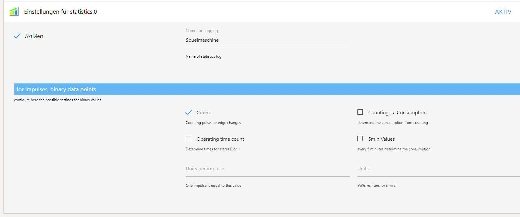

      Der Statistics Adapter (v 1.0.2) berechnet nicht die Anzahl der sich ändernden States von einem Objekt. Weiß jemand was zu tun ist?
      statistics.0	2021-01-12 16:57:49.883	warn	(26236) [STATE CHANGE] wrong value => false on sonoff.0.Spuelmaschine.POWER => check the other adapter where value comes from
      statistics.0	2021-01-12 16:57:49.883	debug	(26236) [STATE CHANGE] stateChange => false [true]
        "from": "system.adapter.sonoff.0",
        "user": "system.user.admin",
        "ts": 1576948666312,
        "common": {
          "name": "Spuelmaschine POWER",
          "type": "boolean",
          "role": "switch",
          "read": true,
          "write": true,
          "storeMap": true,
          "custom": {
            "influxdb.0": {
              "enabled": true,
              "changesOnly": false,
              "debounce": 0,
              "maxLength": 10,
              "retention": 0,
              "changesRelogInterval": 0,
              "changesMinDelta": 0,
              "storageType": "",
              "aliasId": ""
            "statistics.0": {
              "enabled": true,
              "logName": "Spuelmaschine",
              "count": true,
              "sumCount": false,
              "timeCount": false,
              "fiveMin": false,
              "groupFactor": "",
              "impUnit": "",
              "impUnitPerImpulse": "",
              "sumIgnoreMinus": true,
              "sumDelta": false,
              "avg": false,
              "minmax": false,
              "sumGroup": ""
        "native": {},
        "acl": {
          "object": 1636,
          "owner": "system.user.admin",
          "ownerGroup": "system.group.administrator",
          "state": 1636
        "_id": "sonoff.0.Spuelmaschine.POWER",
        "type": "state"
