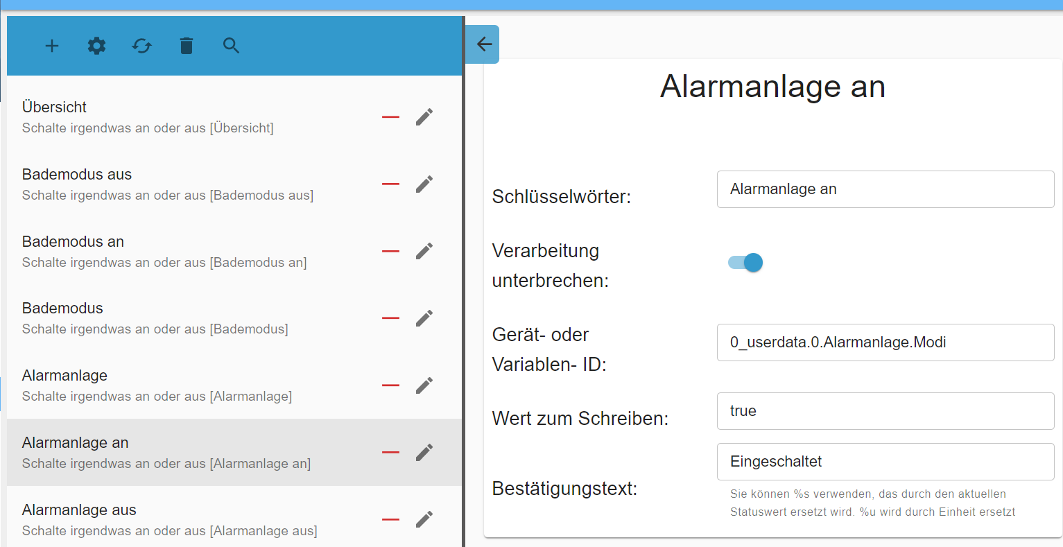

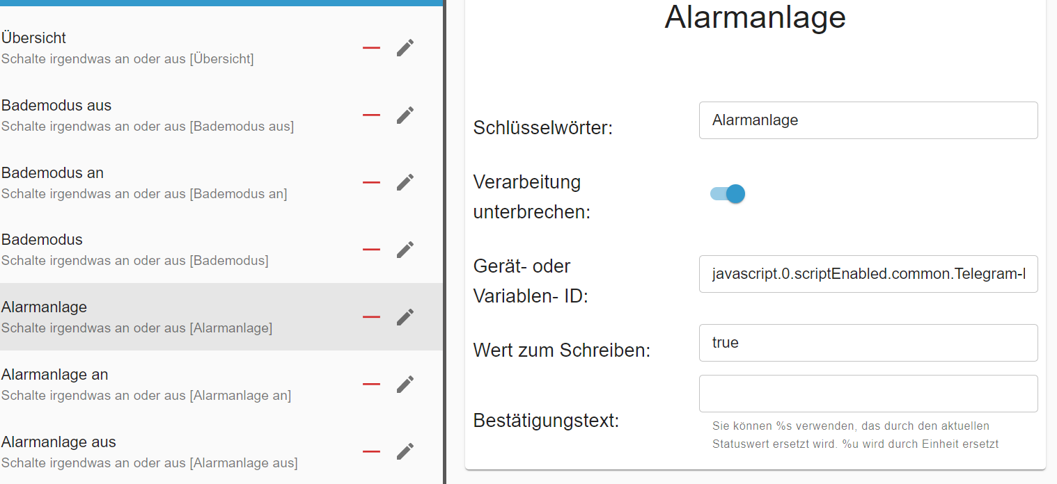

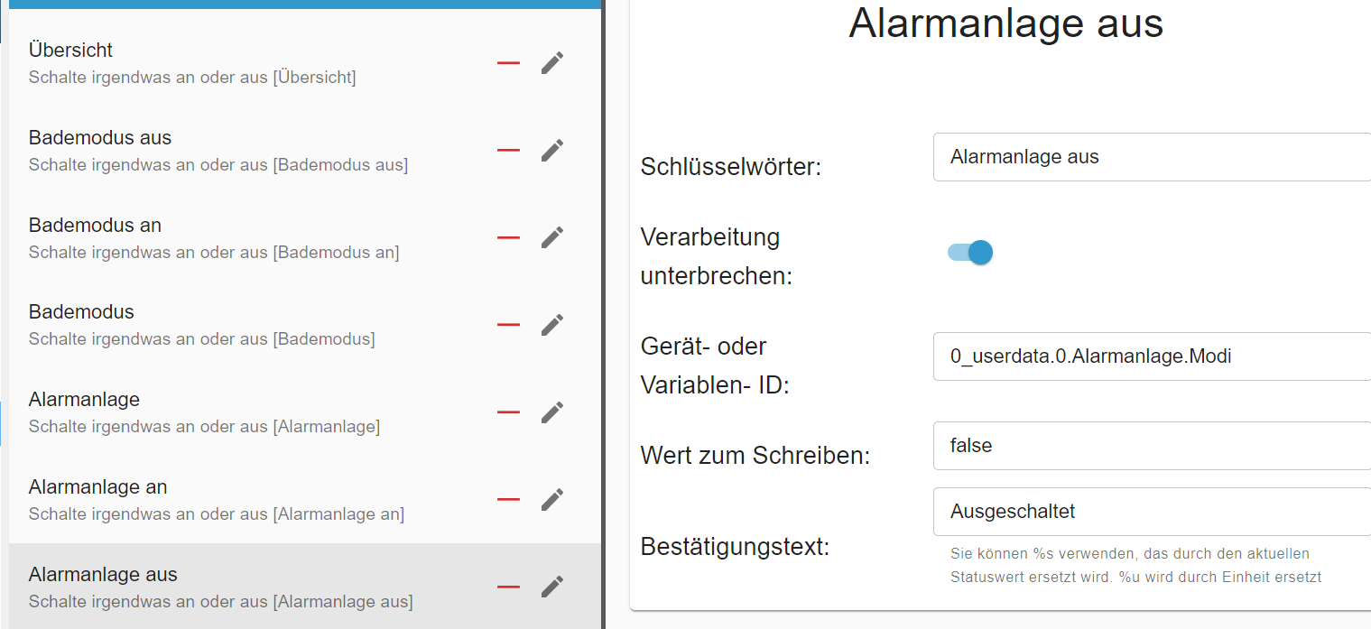

      Was ich aus dem Log sehen kann, ist dass er beim Aufruf von Alarmanlage an oder aus, immer auf das Menue wechseln will... 😞
      Hier das Log:
      text2command.0	2021-01-23 16:36:37.724	info	(28154) Response: undefined
      text2command.0	2021-01-23 16:36:37.587	info	(28154) Control ID javascript.0.scriptEnabled.common.Telegram-Menu.Start with : true
      text2command.0	2021-01-23 16:36:37.586	info	(28154) processText: "Übersicht"
      text2command.0	2021-01-23 16:36:33.159	info	(28154) Response: undefined
      text2command.0	2021-01-23 16:36:33.123	info	(28154) Control ID javascript.0.scriptEnabled.common.Telegram-Menu.Alarmanlage with : true
      text2command.0	2021-01-23 16:36:33.122	info	(28154) processText: "Alarmanlage aus"
      text2command.0	2021-01-23 16:36:31.702	info	(28154) Response: undefined
      text2command.0	2021-01-23 16:36:31.660	info	(28154) Control ID javascript.0.scriptEnabled.common.Telegram-Menu.Alarmanlage with : true
      text2command.0	2021-01-23 16:36:31.659	info	(28154) processText: "Alarmanlage an"
      text2command.0	2021-01-23 16:36:29.555	info	(28154) Response: undefined
      text2command.0	2021-01-23 16:36:29.523	info	(28154) Control ID javascript.0.scriptEnabled.common.Telegram-Menu.Alarmanlage with : true
      text2command.0	2021-01-23 16:36:29.522	info	(28154) processText: "Alarmanlage"
      text2command.0	2021-01-23 16:36:27.888	info	(28154) Response: undefined
      text2command.0	2021-01-23 16:36:27.854	info	(28154) Control ID javascript.0.scriptEnabled.common.Telegram-Menu.Start with : true
      text2command.0	2021-01-23 16:36:27.853	info	(28154) processText: "Übersicht"
      text2command.0	2021-01-23 16:36:26.330	info	(28154) Response: undefined
      text2command.0	2021-01-23 16:36:26.293	info	(28154) Control ID 0_userdata.0.Bademodus.Bademodus_aktiv with : false
      text2command.0	2021-01-23 16:36:26.292	info	(28154) processText: "Bademodus aus"
      text2command.0	2021-01-23 16:36:24.661	info	(28154) Response: undefined
      text2command.0	2021-01-23 16:36:24.588	info	(28154) Control ID 0_userdata.0.Bademodus.Bademodus_aktiv with : true
      text2command.0	2021-01-23 16:36:24.587	info	(28154) processText: "Bademodus an"
      text2command.0	2021-01-23 16:36:23.218	info	(28154) Response: undefined
      text2command.0	2021-01-23 16:36:23.178	info	(28154) Control ID javascript.0.scriptEnabled.common.Telegram-Menu.Bademodus with : true
      text2command.0	2021-01-23 16:36:23.177	info	(28154) processText: "Bademodus"
      text2command.0	2021-01-23 16:36:16.153	info	(28154) Response: undefined
      text2command.0	2021-01-23 16:36:16.127	info	(28154) Control ID javascript.0.scriptEnabled.common.Telegram-Menu.Start with : true
      text2command.0	2021-01-23 16:36:16.125	info	(28154) processText: "Übersicht"
      Hier die Aufrufe im test2command:
      hat jemand eine Idee?
      Danke schon mal 🙂
