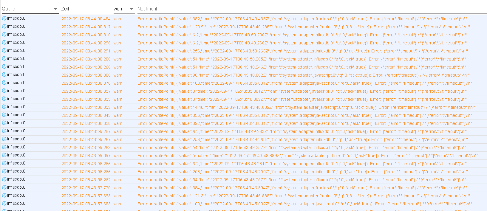

          Aus dem ioBroker Log.
          Es läuft eine Influxdb 1.8 (influxdb.0) und eine 2.0 Instanz (influxdb.1), beide liefern Fehlermeldungen.

          Aus dem Docker Log:
          WARN: Write to InfluxDB failed (attempt: 1). m [HttpError]: unexpected error writing points to database: timeout
              at IncomingMessage.<anonymous> (/opt/iobroker/node_modules/@influxdata/influxdb-client/src/impl/node/NodeHttpTransport.ts:318:13)
              at IncomingMessage.emit (node:events:525:35)
              at IncomingMessage.emit (node:domain:489:12)
              at endReadableNT (node:internal/streams/readable:1358:12)
              at processTicksAndRejections (node:internal/process/task_queues:83:21) {
            statusCode: 500,
            statusMessage: 'Internal Server Error',
            body: '{"code":"internal error","message":"unexpected error writing points to database: timeout"}',
            contentType: 'application/json; charset=utf-8',
            json: {
              code: 'internal error',
              message: 'unexpected error writing points to database: timeout'
            _retryAfter: 0

            	2023-01-21 11:02:57.327	warn	Error on writePoint("{"value":1793,"time":"2023-01-21T10:02:46.725Z","from":"system.adapter.javascript.0","q":0,"ack":true}): Error: connect ECONNREFUSED 192.168.178.181:8086 / "connect ECONNREFUSED 192.168.178.181:8086""
            influxdb.0
            	2023-01-21 11:02:57.327	warn	Point could not be written to database: iobdata
            influxdb.0
            	2023-01-21 11:02:57.325	info	Add point that had error for modbus.1.holdingRegisters.40206_M_AC_Power to buffer again, error-count=8
            influxdb.0
            	2023-01-21 11:02:57.325	warn	Error on writePoint("{"value":993,"time":"2023-01-21T09:58:33.448Z","from":"system.adapter.modbus.1","q":0,"ack":true}): Error: connect ECONNREFUSED 192.168.178.181:8086 / "connect ECONNREFUSED 192.168.178.181:8086""
            influxdb.0
            	2023-01-21 11:02:57.325	warn	Point could not be written to database: iobdata
            influxdb.0
            	2023-01-21 11:02:57.323	info	Add point that had error for javascript.0.Solar.Wechselrichter.ACTotalRealPower to buffer again, error-count=8
            influxdb.0
            	2023-01-21 11:02:57.323	warn	Error on writePoint("{"value":982,"time":"2023-01-21T09:58:53.367Z","from":"system.adapter.javascript.0","q":0,"ack":true}): Error: connect ECONNREFUSED 192.168.178.181:8086 / "connect ECONNREFUSED 192.168.178.181:8086""
            influxdb.0
            	2023-01-21 11:02:57.323	warn	Point could not be written to database: iobdata
            influxdb.0
            	2023-01-21 11:02:57.322	info	Add point that had error for javascript.0.Solar.Wechselrichter.ACTotalRealPower to buffer again, error-count=7
            influxdb.0
            	2023-01-21 11:02:57.322	warn	Error on writePoint("{"value":862,"time":"2023-01-21T10:00:33.398Z","from":"system.adapter.javascript.0","q":0,"ack":true}): Error: connect ECONNREFUSED 192.168.178.181:8086 / "connect ECONNREFUSED 192.168.178.181:8086""
            influxdb.0
            	2023-01-21 11:02:57.322	warn	Point could not be written to database: iobdata
            influxdb.0
            	2023-01-21 11:02:57.320	info	Add point that had error for javascript.0.Solar.Wechselrichter.Hausverbrauch to buffer again, error-count=7
            influxdb.0
            	2023-01-21 11:02:57.320	warn	Error on writePoint("{"value":848,"time":"2023-01-21T10:02:33.339Z","from":"system.adapter.javascript.0","q":0,"ack":true}): Error: connect ECONNREFUSED 192.168.178.181:8086 / "connect ECONNREFUSED 192.168.178.181:8086""
