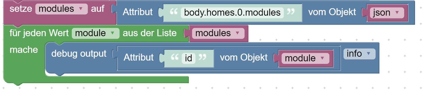

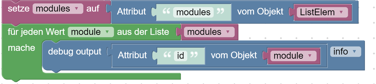

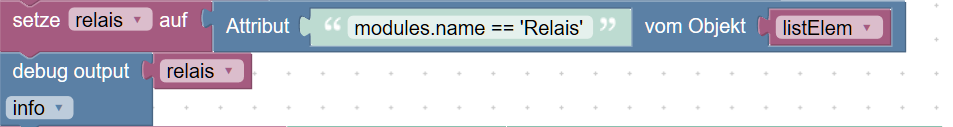

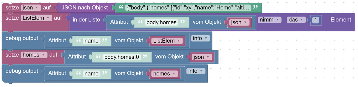

                                fastfoot @Newpicsel last edited by
                                @newpicsel sagte in Brauche hilfe json Array verschachtelung zu parsen:
                                das kann doch nicht wahr sein, ich werde noch bekloppt!
                                ich glaube da stimmt was nicht mit Blockly, bin aber nicht ganz sicher. So gehts aber

                                 <block type="variables_set" id="|o?viYz(YZ#CAw+}Z|3K" x="-163" y="-112">
                                   <field name="VAR" id="/vB;1BX-M-`@P2gBXZC;">json</field>
                                     <block type="convert_json2object" id="aieJ~X.TrK9_At(m$P:.">
                                         <block type="text" id="9m5.@`_eUqd|i6hWLx.(">
                                           <field name="TEXT">{"body":{"homes":[{"id":"xy","name":"Home","altitude":8,"coordinates":["xy","xy"],"country":"DE","timezone":"Europe\/Berlin","rooms":[{"id":"xy","name":"Schlafzimmer","type":"bedroom","module_ids":["xy"]},{"id":"xy","name":"Kinderzimmer","type":"custom","module_ids":["xy"]},{"id":"xy","name":"K\u00fcche","type":"kitchen","module_ids":["xy"]},{"id":"xy","name":"Wohnzimmer","type":"custom","module_ids":["xy"]},{"id":"xy","name":"Badezimmer","type":"bathroom","module_ids":["xy"]}],"modules":[{"id":"xy","type":"NAPlug","name":"Relais","setup_date":1512123665,"modules_bridged":["xy","xy","xy","xy","xy"]},{"id":"xy","type":"NRV","name":"K\u00fcche","setup_date":1514020470,"room_id":"xy","bridge":"xy"},{"id":"xy","type":"NRV","name":"Badezimmer","setup_date":1514023382,"room_id":"xy","bridge":"xy"},{"id":"xy","type":"NRV","name":"Kinderzimmer","setup_date":1514032377,"room_id":"xy","bridge":"xy"},{"id":"xy","type":"NRV","name":"Schlafzimmer","setup_date":1512123670,"room_id":"xy","bridge":"xy"},{"id":"xy","type":"NRV","name":"Wohnzimmer","setup_date":1512123670,"room_id":"xy","bridge":"xy"}],"therm_schedules":[{"timetable":[{"zone_id":1,"m_offset":0},{"zone_id":3,"m_offset":180},{"zone_id":1,"m_offset":240},{"zone_id":3,"m_offset":300},{"zone_id":9373,"m_offset":360},{"zone_id":0,"m_offset":480},{"zone_id":7690,"m_offset":1200},{"zone_id":6622,"m_offset":1320},{"zone_id":1,"m_offset":1380},{"zone_id":3,"m_offset":1620},{"zone_id":1,"m_offset":1680},{"zone_id":3,"m_offset":1740},{"zone_id":9373,"m_offset":1800},{"zone_id":0,"m_offset":1920},{"zone_id":7690,"m_offset":2640},{"zone_id":6622,"m_offset":2760},{"zone_id":1,"m_offset":2820},{"zone_id":3,"m_offset":3060},{"zone_id":1,"m_offset":3120},{"zone_id":3,"m_offset":3180},{"zone_id":9373,"m_offset":3240},{"zone_id":0,"m_offset":3360},{"zone_id":7690,"m_offset":4080},{"zone_id":6622,"m_offset":4200},{"zone_id":1,"m_offset":4260},{"zone_id":3,"m_offset":4500},{"zone_id":1,"m_offset":4560},{"zone_id":3,"m_offset":4620},{"zone_id":9373,"m_offset":4680},{"zone_id":0,"m_offset":4800},{"zone_id":7690,"m_offset":5520},{"zone_id":6622,"m_offset":5640},{"zone_id":1,"m_offset":5700},{"zone_id":3,"m_offset":5940},{"zone_id":1,"m_offset":6000},{"zone_id":3,"m_offset":6060},{"zone_id":9373,"m_offset":6120},{"zone_id":0,"m_offset":6240},{"zone_id":7690,"m_offset":6960},{"zone_id":6622,"m_offset":7140},{"zone_id":1,"m_offset":7200},{"zone_id":9373,"m_offset":7620},{"zone_id":3,"m_offset":7680},{"zone_id":0,"m_offset":7740},{"zone_id":7690,"m_offset":8400},{"zone_id":6622,"m_offset":8580},{"zone_id":1,"m_offset":8640},{"zone_id":9373,"m_offset":9060},{"zone_id":3,"m_offset":9120},{"zone_id":0,"m_offset":9180},{"zone_id":7690,"m_offset":9840},{"zone_id":6622,"m_offset":9960},{"zone_id":1,"m_offset":10020}],"zones":[{"name":"Komfort","id":0,"type":0,"rooms_temp":[{"room_id":"xy","temp":19},{"room_id":"xy","temp":20},{"room_id":"xy","temp":19},{"room_id":"xy","temp":18},{"room_id":"xy","temp":20}]},{"name":"Nacht","id":1,"type":1,"rooms_temp":[{"room_id":"xy","temp":19},{"room_id":"xy","temp":20},{"room_id":"xy","temp":19},{"room_id":"xy","temp":17},{"room_id":"xy","temp":18}]},{"name":"Eco","id":4,"type":5,"rooms_temp":[{"room_id":"xy","temp":18},{"room_id":"xy","temp":18},{"room_id":"xy","temp":18},{"room_id":"xy","temp":18},{"room_id":"xy","temp":18}]},{"name":"Aufstehen","id":9373,"type":4,"rooms_temp":[{"room_id":"xy","temp":19},{"room_id":"xy","temp":20},{"room_id":"xy","temp":19},{"room_id":"xy","temp":19},{"room_id":"xy","temp":19}]},{"name":"Schlafen","id":6622,"type":4,"rooms_temp":[{"room_id":"xy","temp":19},{"room_id":"xy","temp":20},{"room_id":"xy","temp":19},{"room_id":"xy","temp":20},{"room_id":"xy","temp":19}]},{"name":"Schlarfzimmer Warm","id":7690,"type":4,"rooms_temp":[{"room_id":"xy","temp":19},{"room_id":"xy","temp":20},{"room_id":"xy","temp":19},{"room_id":"xy","temp":19},{"room_id":"xy","temp":19}]},{"name":"Komfort+","id":3,"type":8,"rooms_temp":[{"room_id":"xy","temp":19},{"room_id":"xy","temp":20},{"room_id":"xy","temp":19},{"room_id":"xy","temp":19},{"room_id":"xy","temp":20}]}],"name":"Winter","default":false,"away_temp":16,"hg_temp":7,"id":"xy","selected":true,"type":"therm"},{"timetable":[{"zone_id":1,"m_offset":0},{"zone_id":0,"m_offset":360},{"zone_id":4,"m_offset":480},{"zone_id":0,"m_offset":1020},{"zone_id":1,"m_offset":1320},{"zone_id":0,"m_offset":1800},{"zone_id":4,"m_offset":1920},{"zone_id":0,"m_offset":2460},{"zone_id":1,"m_offset":2760},{"zone_id":0,"m_offset":3240},{"zone_id":4,"m_offset":3360},{"zone_id":0,"m_offset":3900},{"zone_id":1,"m_offset":4200},{"zone_id":0,"m_offset":4680},{"zone_id":4,"m_offset":4800},{"zone_id":0,"m_offset":5340},{"zone_id":1,"m_offset":5640},{"zone_id":0,"m_offset":6120},{"zone_id":4,"m_offset":6240},{"zone_id":3,"m_offset":6660},{"zone_id":0,"m_offset":6960},{"zone_id":1,"m_offset":7140},{"zone_id":0,"m_offset":7620},{"zone_id":3,"m_offset":7740},{"zone_id":0,"m_offset":8400},{"zone_id":1,"m_offset":8580},{"zone_id":0,"m_offset":9060},{"zone_id":3,"m_offset":9180},{"zone_id":0,"m_offset":9840},{"zone_id":1,"m_offset":9960}],"zones":[{"name":"","id":1,"type":1,"rooms_temp":[{"room_id":"xy","temp":16},{"room_id":"xy","temp":16},{"room_id":"xy","temp":16},{"room_id":"xy","temp":16},{"room_id":"xy","temp":16}]},{"name":"Eco","id":4,"type":5,"rooms_temp":[{"room_id":"xy","temp":16},{"room_id":"xy","temp":16},{"room_id":"xy","temp":16},{"room_id":"xy","temp":16},{"room_id":"xy","temp":16}]},{"name":"Komfort","id":0,"type":0,"rooms_temp":[{"room_id":"xy","temp":18},{"room_id":"xy","temp":18},{"room_id":"xy","temp":18},{"room_id":"xy","temp":18},{"room_id":"xy","temp":18}]},{"name":"Komfort+","id":3,"type":8,"rooms_temp":[{"room_id":"xy","temp":18},{"room_id":"xy","temp":18},{"room_id":"xy","temp":18},{"room_id":"xy","temp":18},{"room_id":"xy","temp":18}]}],"name":"Sommer","default":false,"away_temp":12,"hg_temp":7,"id":"xy","type":"therm"}],"therm_mode":"schedule","therm_setpoint_default_duration":60,"schedules":[{"timetable":[{"zone_id":1,"m_offset":0},{"zone_id":3,"m_offset":180},{"zone_id":1,"m_offset":240},{"zone_id":3,"m_offset":300},{"zone_id":9373,"m_offset":360},{"zone_id":0,"m_offset":480},{"zone_id":7690,"m_offset":1200},{"zone_id":6622,"m_offset":1320},{"zone_id":1,"m_offset":1380},{"zone_id":3,"m_offset":1620},{"zone_id":1,"m_offset":1680},{"zone_id":3,"m_offset":1740},{"zone_id":9373,"m_offset":1800},{"zone_id":0,"m_offset":1920},{"zone_id":7690,"m_offset":2640},{"zone_id":6622,"m_offset":2760},{"zone_id":1,"m_offset":2820},{"zone_id":3,"m_offset":3060},{"zone_id":1,"m_offset":3120},{"zone_id":3,"m_offset":3180},{"zone_id":9373,"m_offset":3240},{"zone_id":0,"m_offset":3360},{"zone_id":7690,"m_offset":4080},{"zone_id":6622,"m_offset":4200},{"zone_id":1,"m_offset":4260},{"zone_id":3,"m_offset":4500},{"zone_id":1,"m_offset":4560},{"zone_id":3,"m_offset":4620},{"zone_id":9373,"m_offset":4680},{"zone_id":0,"m_offset":4800},{"zone_id":7690,"m_offset":5520},{"zone_id":6622,"m_offset":5640},{"zone_id":1,"m_offset":5700},{"zone_id":3,"m_offset":5940},{"zone_id":1,"m_offset":6000},{"zone_id":3,"m_offset":6060},{"zone_id":9373,"m_offset":6120},{"zone_id":0,"m_offset":6240},{"zone_id":7690,"m_offset":6960},{"zone_id":6622,"m_offset":7140},{"zone_id":1,"m_offset":7200},{"zone_id":9373,"m_offset":7620},{"zone_id":3,"m_offset":7680},{"zone_id":0,"m_offset":7740},{"zone_id":7690,"m_offset":8400},{"zone_id":6622,"m_offset":8580},{"zone_id":1,"m_offset":8640},{"zone_id":9373,"m_offset":9060},{"zone_id":3,"m_offset":9120},{"zone_id":0,"m_offset":9180},{"zone_id":7690,"m_offset":9840},{"zone_id":6622,"m_offset":9960},{"zone_id":1,"m_offset":10020}],"zones":[{"name":"Komfort","id":0,"type":0,"rooms_temp":[{"room_id":"yx","temp":19},{"room_id":"xy","temp":20},{"room_id":"xy","temp":19},{"room_id":"xy","temp":18},{"room_id":"xy","temp":20}],"rooms":[{"id":"xy","therm_setpoint_temperature":19},{"id":"xy","therm_setpoint_temperature":20},{"id":"xy","therm_setpoint_temperature":19},{"id":"xy","therm_setpoint_temperature":18},{"id":"xy","therm_setpoint_temperature":20}]},{"name":"Nacht","id":1,"type":1,"rooms_temp":[{"room_id":"xy","temp":19},{"room_id":"xy","temp":20},{"room_id":"xy","temp":19},{"room_id":"xy","temp":17},{"room_id":"xy","temp":18}],"rooms":[{"id":"xy","therm_setpoint_temperature":19},{"id":"xy","therm_setpoint_temperature":20},{"id":"xy","therm_setpoint_temperature":19},{"id":"xy","therm_setpoint_temperature":17},{"id":"xy","therm_setpoint_temperature":18}]},{"name":"Eco","id":4,"type":5,"rooms_temp":[{"room_id":"xy","temp":18},{"room_id":"xy","temp":18},{"room_id":"xy","temp":18},{"room_id":"xy","temp":18},{"room_id":"xy","temp":18}],"rooms":[{"id":"xy","therm_setpoint_temperature":18},{"id":"xy","therm_setpoint_temperature":18},{"id":"xy","therm_setpoint_temperature":18},{"id":"xy","therm_setpoint_temperature":18},{"id":"xy","therm_setpoint_temperature":18}]},{"name":"Aufstehen","id":9373,"type":4,"rooms_temp":[{"room_id":"xy","temp":19},{"room_id":"xy","temp":20},{"room_id":"xy","temp":19},{"room_id":"xy","temp":19},{"room_id":"xy","temp":19}],"rooms":[{"id":"xy","therm_setpoint_temperature":19},{"id":"xy","therm_setpoint_temperature":20},{"id":"xy","therm_setpoint_temperature":19},{"id":"xy","therm_setpoint_temperature":19},{"id":"xy","therm_setpoint_temperature":19}]},{"name":"Schlafen","id":6622,"type":4,"rooms_temp":[{"room_id":"xy","temp":19},{"room_id":"xy","temp":20},{"room_id":"xy","temp":19},{"room_id":"xy","temp":20},{"room_id":"xy","temp":19}],"rooms":[{"id":"xy","therm_setpoint_temperature":19},{"id":"xy","therm_setpoint_temperature":20},{"id":"xy","therm_setpoint_temperature":19},{"id":"xy","therm_setpoint_temperature":20},{"id":"xy","therm_setpoint_temperature":19}]},{"name":"Schlarfzimmer Warm","id":7690,"type":4,"rooms_temp":[{"room_id":"yx","temp":19},{"room_id":"xy","temp":20},{"room_id":"xy","temp":19},{"room_id":"xy","temp":19},{"room_id":"xy","temp":19}],"rooms":[{"id":"xy","therm_setpoint_temperature":19},{"id":"xy","therm_setpoint_temperature":20},{"id":"xy","therm_setpoint_temperature":19},{"id":"xy","therm_setpoint_temperature":19},{"id":"xy","therm_setpoint_temperature":19}]},{"name":"Komfort+","id":3,"type":8,"rooms_temp":[{"room_id":"xy","temp":19},{"room_id":"xy","temp":20},{"room_id":"xy","temp":19},{"room_id":"xy","temp":19},{"room_id":"xy","temp":20}],"rooms":[{"id":"xy","therm_setpoint_temperature":19},{"id":"xy","therm_setpoint_temperature":20},{"id":"xy","therm_setpoint_temperature":19},{"id":"xy","therm_setpoint_temperature":19},{"id":"xy","therm_setpoint_temperature":20}]}],"name":"Winter","default":false,"away_temp":16,"hg_temp":7,"id":"xy","selected":true,"type":"therm"},{"timetable":[{"zone_id":1,"m_offset":0},{"zone_id":0,"m_offset":360},{"zone_id":4,"m_offset":480},{"zone_id":0,"m_offset":1020},{"zone_id":1,"m_offset":1320},{"zone_id":0,"m_offset":1800},{"zone_id":4,"m_offset":1920},{"zone_id":0,"m_offset":2460},{"zone_id":1,"m_offset":2760},{"zone_id":0,"m_offset":3240},{"zone_id":4,"m_offset":3360},{"zone_id":0,"m_offset":3900},{"zone_id":1,"m_offset":4200},{"zone_id":0,"m_offset":4680},{"zone_id":4,"m_offset":4800},{"zone_id":0,"m_offset":5340},{"zone_id":1,"m_offset":5640},{"zone_id":0,"m_offset":6120},{"zone_id":4,"m_offset":6240},{"zone_id":3,"m_offset":6660},{"zone_id":0,"m_offset":6960},{"zone_id":1,"m_offset":7140},{"zone_id":0,"m_offset":7620},{"zone_id":3,"m_offset":7740},{"zone_id":0,"m_offset":8400},{"zone_id":1,"m_offset":8580},{"zone_id":0,"m_offset":9060},{"zone_id":3,"m_offset":9180},{"zone_id":0,"m_offset":9840},{"zone_id":1,"m_offset":9960}],"zones":[{"name":"","id":1,"type":1,"rooms_temp":[{"room_id":"xy","temp":16},{"room_id":"xy","temp":16},{"room_id":"xy","temp":16},{"room_id":"xy","temp":16},{"room_id":"xy","temp":16}],"rooms":[{"id":"xy","therm_setpoint_temperature":16},{"id":"xy","therm_setpoint_temperature":16},{"id":"xy","therm_setpoint_temperature":16},{"id":"xy","therm_setpoint_temperature":16},{"id":"xy","therm_setpoint_temperature":16}]},{"name":"Eco","id":4,"type":5,"rooms_temp":[{"room_id":"xy","temp":16},{"room_id":"xy","temp":16},{"room_id":"xy","temp":16},{"room_id":"xy","temp":16},{"room_id":"xy","temp":16}],"rooms":[{"id":"xy","therm_setpoint_temperature":16},{"id":"xy","therm_setpoint_temperature":16},{"id":"xy","therm_setpoint_temperature":16},{"id":"xy","therm_setpoint_temperature":16},{"id":"xy","therm_setpoint_temperature":16}]},{"name":"Komfort","id":0,"type":0,"rooms_temp":[{"room_id":"xy","temp":18},{"room_id":"xy","temp":18},{"room_id":"xy","temp":18},{"room_id":"xy","temp":18},{"room_id":"xy","temp":18}],"rooms":[{"id":"xy","therm_setpoint_temperature":18},{"id":"xy","therm_setpoint_temperature":18},{"id":"xy","therm_setpoint_temperature":18},{"id":"xy","therm_setpoint_temperature":18},{"id":"xy","therm_setpoint_temperature":18}]},{"name":"Komfort+","id":3,"type":8,"rooms_temp":[{"room_id":"xy","temp":18},{"room_id":"xy","temp":18},{"room_id":"xy","temp":18},{"room_id":"xy","temp":18},{"room_id":"xy","temp":18}],"rooms":[{"id":"yx","therm_setpoint_temperature":18},{"id":"yx","therm_setpoint_temperature":18},{"id":"yx","therm_setpoint_temperature":18},{"id":"yx","therm_setpoint_temperature":18},{"id":"yx","therm_setpoint_temperature":18}]}],"name":"Sommer","default":false,"away_temp":12,"hg_temp":7,"id":"xy","type":"therm"}]}],"user":{"email":"xy@web.de","language":"de-DE","locale":"de-DE","feel_like_algorithm":0,"unit_pressure":0,"unit_system":0,"unit_wind":0,"id":"xy"}},"status":"ok","time_exec":0.021591901779174805,"time_server":1611503100}</field>
                                     <block type="variables_set" id="v^97j235UN(xelt4A+Q_">
                                       <field name="VAR" id="D_M}auPlg#tJNK56ANMT">ListElem</field>
                                         <block type="lists_getIndex" id="D4gT-+2l)bhIbGTnzRFs">
                                             <block type="get_attr" id="y}}mHAa68~]}V|^4ConB">
                                               <value name="PATH">
                                                 <shadow type="text" id="x^Lr@5`Kt63:[?*cS*1+">
                                                   <field name="TEXT">body.homes</field>
                                               <value name="OBJECT">
                                                 <block type="variables_get" id="Z:Q/oC),ci+VB|/C_=#e">
                                           <value name="AT">
                                             <block type="math_number" id="i,v$65]{,wBqiepB3Y5e">
                                               <field name="NUM">1</field>
                                         <block type="debug" id="Z(eB|rR|`AfFhT5}AG0y" inline="true">
                                           <value name="TEXT">
                                             <shadow type="text" id="wI)4cgwH_(t,m8{fgY{4">
                                             <block type="get_attr" id="l]pga[gC-;TR^3%PvfWZ">
                                               <value name="PATH">
                                                 <shadow type="text" id="D7Awsg^#;YZa4B:@.@C?">
                                                   <field name="TEXT">name</field>
                                                 <block type="variables_get" id="`MS,$BaS~1d/v3libv/Z">
                                             <block type="variables_set" id="l9u`8W$*CE;MU(=%WCAs">
                                               <field name="VAR" id="9jxj.k~ts;=BDSFxGEzF">homes</field>
                                                 <block type="get_attr" id="|Xu34tHXLM~i*[P_tt*n">
                                                   <value name="PATH">
                                                     <shadow type="text" id="8hUTTD8Rv.:}$Cpud$yl">
                                                       <field name="TEXT">body.homes.0</field>
                                                     <block type="variables_get" id="-Bo!!LxO1=83y!6$F{g_">
                                                 <block type="debug" id="j8`b,;;Zi5R5Ms_6b$8e" inline="true">
                                                   <value name="TEXT">
                                                     <shadow type="text" id=";6hQuQHA?LmE{#O;ffa^">
                                                     <block type="get_attr" id="BF_{C9s+tw2skqe.(r9y">
                                                       <value name="PATH">
                                                         <shadow type="text" id="t0mkzS?1R+ZUR(6Zv-kc">
                                                         <block type="variables_get" id="2pbvCH0vG;J(MtyZDMiI">
                                F Newpicsel 2 Replies Last reply Reply Quote 1
                                  fastfoot @fastfoot last edited by
                                  @fastfoot sagte in Brauche hilfe json Array verschachtelung zu parsen:
                                  Also, auch ältere Versionen arbeiten nicht anders, bin bis auf die 4.7.4 zurück. Mich kommt aber body.homes.0 als Attribut seltsam vor. @paul53 was meinst Du dazu? In JS jedenfalls wäre das ungültig, wird in Blockly ja allerdings mit getAttr() gemacht
                                  Newpicsel 1 Reply Last reply Reply Quote 0
                                  • Newpicsel
                                    Newpicsel @fastfoot last edited by
                                    @fastfoot
                                    Unglaublich es funktioniert, sobald einmal die array "[]homes" selektiert ist, kannst danach alle werte auslesen!
                                    vielen Dank!

                                        @newpicsel Auf modules kannst du so zugreifen
                                          Also ich hab den schritt body.homes.0 nicht getestet, da ich in der liste "ListElem" auf die werte schon zugreifen kann,
                                          für ListElem so
