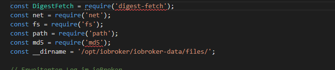

              Danke für deine Hilfe. Habe die variablen nun in "" gesetzt. Jetzt bekomme ich folgenden Fehler:
              javascript.0	2021-01-27 13:30:19.894	error	(954) at Script.runInContext (vm.js:130:18)
              javascript.0	2021-01-27 13:30:19.894	error	(954) at script.js.Dahua:517:1
              javascript.0	2021-01-27 13:30:19.894	error	(954) at new DahuaVTO (script.js.Dahua:88:26)
              javascript.0	2021-01-27 13:30:19.894	error	(954) TypeError: DigestFetch is not a constructor
              javascript.0	2021-01-27 13:30:19.894	error	(954) ^
              javascript.0	2021-01-27 13:30:19.894	error	(954) this.digestClient = new DigestFetch(
              javascript.0	2021-01-27 13:30:19.894	error	(954) script.js.Dahua: script.js.Dahua:88
              javascript.0	2021-01-27 13:30:19.893	error	(954) at Script.runInContext (vm.js:130:18)
              javascript.0	2021-01-27 13:30:19.893	error	(954) at script.js.Dahua:5:13
              javascript.0	2021-01-27 13:30:19.893	error	(954) at require (/opt/iobroker/node_modules/iobroker.javascript/lib/sandbox.js:389:36)
              javascript.0	2021-01-27 13:30:19.892	error	(954) at require (internal/modules/cjs/helpers.js:74:18)
              javascript.0	2021-01-27 13:30:19.892	error	(954) at Module.require (internal/modules/cjs/loader.js:903:19)
              javascript.0	2021-01-27 13:30:19.892	error	(954) script.js.Dahua: Error: Cannot find module '/opt/iobroker/node_modules/iobroker.javascript/lib/../../md5'
              javascript.0	2021-01-27 13:30:19.891	error	(954) at Script.runInContext (vm.js:130:18)
              javascript.0	2021-01-27 13:30:19.891	error	(954) at script.js.Dahua:1:21
              javascript.0	2021-01-27 13:30:19.891	error	(954) at require (/opt/iobroker/node_modules/iobroker.javascript/lib/sandbox.js:389:36)
              javascript.0	2021-01-27 13:30:19.891	error	(954) at require (internal/modules/cjs/helpers.js:74:18)
              javascript.0	2021-01-27 13:30:19.891	error	(954) at Module.require (internal/modules/cjs/loader.js:903:19)
              javascript.0	2021-01-27 13:30:19.891	error	(954) script.js.Dahua: Error: Cannot find module '/opt/iobroker/node_modules/iobroker.javascript/lib/../../digest-fetch'
              javascript.0	2021-01-27 13:30:19.883	info	(954) Start javascript script.js.Dahua

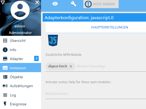

                @rettroo Hast du denn digest-fetch bei den benötigten Node Modulen im JavaScript Adapter angegeben?
                  rettroo @UncleSam last edited by
                  @unclesam
                  ist das so korrekt?
                  Ich komme der Sache näher, zumindest war MQTT schon kurz verbunden. nun geht aber die javascript Instanz auf Rot kurz nach dem Start des Scriptes.
                  host.debian	2021-01-27 14:43:01.777	info	Restart adapter system.adapter.javascript.0 because enabled

                                    @rettroo Hast du das md5 Modul installiert?
                                    const md5 = require('md5');
                                    Sollte eigentlich schief gehen, wenn du md5 nicht installiert hast, was ich etwas komisch finde. Hast du das etwa aus dem Skript gelöscht?

                                      (20360) FetchError: request to https://192.168.178.10:443/cgi-bin/magicBox.cgi?action=getSystemInfo failed, reason: unable to verify the first certificate
                                      Unter Instanzen ist jedoch MQTT gelb und auch im Script sebst sind mir einige Zeilen als Fehler unterstrichen - zB const DigestFetch = require('digest-fetch');
                                      md5 und digest-fetch sind aber in der JavaScript instanz aktiviert.

                                          rettroo @pseudoreal last edited by
                                          @pseudoreal
                                          wie von @UncleSam angemerkt würde ich das "s" mal weglassen also "http://
                                          MQTT sollte erst grün werden wenn sich das Script mit Dahua verbindet
