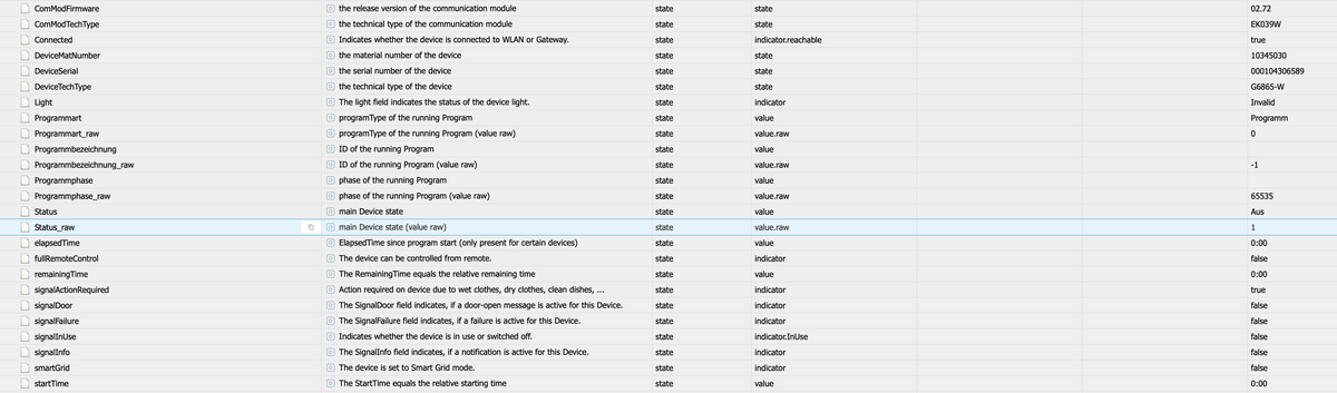

      Hier mal die Datenpunkte die der Miele Adapter anbietet:

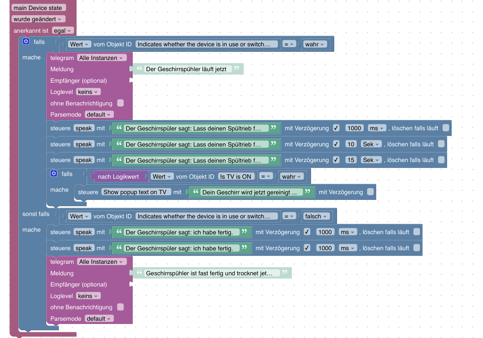

      Und hier noch mein Porgramm:
        <block type="on" id="PFig;!ecY~bEn?$[6}cr" x="-2487" y="-788">
          <field name="OID">mielecloudservice.0.Dishwashers.000104306589.Status</field>
            <block type="controls_if" id="N%meYf)qc7x#DNe^^kpb">
                <block type="logic_compare" id="pcb|hW.yHz:X`iqjrpa#">
                  <field name="OP">EQ</field>
                    <block type="get_value" id="+@t#{%e0{7;%yJ@9+|;O">
                      <field name="OID">mielecloudservice.0.Dishwashers.000104306589.signalInUse</field>
                    <block type="logic_boolean" id="Mmnp~|To,c{tB2_|z15!">
                <block type="telegram" id=")7QIw!McGP,LK#[^Tr5[">
                  <field name="LOG"></field>
                  <value name="MESSAGE">
                    <shadow type="text" id="%[n8Pg16~KHcrZw_aGq$">
                      <field name="TEXT">Der Geschirrspühler läuft jetzt</field>
                    <block type="control" id="zGN@?l6NDsOql,Fy2pXK">
                      <field name="OID">alexa2.0.Echo-Devices.G070RR138312054L.Commands.speak</field>
                      <field name="DELAY_MS">1000</field>
                      <field name="UNIT">ms</field>
                        <block type="text" id="?6Fi*U5n3/se6p.3Uxjy">
                          <field name="TEXT">Der Geschirrspüler sagt: Lass deinen Spültrieb freien lauf.</field>
                        <block type="control" id="eU:h`{W!}t`ZW^#eQp9t">
                          <field name="OID">alexa2.0.Echo-Devices.G090LF0971521B4M.Commands.speak</field>
                          <field name="DELAY_MS">10</field>
                            <block type="text" id="VB^sB^H|ln6Zsjr$u~eQ">
                            <block type="control" id="V8z*sq|6@3T%sJ8]2E^b">
                              <field name="OID">alexa2.0.Echo-Devices.G090LF11745408CD.Commands.speak</field>
                              <field name="DELAY_MS">15</field>
                                <block type="text" id="F#bEb.jtj~ZSkh}$pq`G">
                                <block type="controls_if" id="4G+~Xxtp)!)i57sW@jyd">
                                    <block type="logic_compare" id="}taX)|xaa)_({O!.xj%1">
                                        <block type="convert_toboolean" id="jAO9ABM0Ws9mb)Q$H(o8">
                                            <block type="get_value" id="I(`pzeV}L6_B6zOi[i}g">
                                              <field name="OID">lgtv.0.states.on</field>
                                        <block type="logic_boolean" id="!et#1}n`_Q5fZ,ag@/KQ">
                                    <block type="control" id="muau[PSN-D2tSo*.|bQU">
                                      <field name="OID">lgtv.0.states.popup</field>
                                        <block type="text" id="?P.ac:,=tG~elK,,nd3s">
                                          <field name="TEXT">Dein Geschirr wird jetzt gereinigt ...</field>
              <value name="IF1">
                <block type="logic_compare" id="TpW1bOB}b25r;h35?I]m">
                    <block type="get_value" id="MwtMb;6^8o]9:Bb:w1?m">
                    <block type="logic_boolean" id="@][W0!Fz6}{5QPJNc~,%">
              <statement name="DO1">
                <block type="control" id="4(8U-d-g+a%e(V?=5Kv-">
                    <block type="text" id="p$onAZ%jH@TS@T6F)x6I">
                      <field name="TEXT">Der Geschirrspüler sagt: ich habe fertig.</field>
                    <block type="control" id="mCI;s95]zYif7jPy%9RL">
                        <block type="text" id="o?h:yDp-fXTQL@(P|b`*">
                        <block type="telegram" id="7ckT$XM`:oXP+J4UxYQI">
                            <shadow type="text" id="#-ZLVQlmH),q,ePy17}f">
                              <field name="TEXT">Geschirrspühler ist fast fertig und trocknet jetzt das Geschirr.</field>

        Albert K @Accu last edited by
        @accu
        Hab keine Miele, kann also nur vermuten.
        Versuch doch mal den Status Deines Triggers zu beobachten oder über die Historie zu loggen. Vermute dass sich der öfter ändert als nur beim Start und Ende.
        Evtl. wäre "signalInUse" besser als trigger geeignet?
        • E
          ente34 @Accu last edited by
          @accu
          ... oder Programm/Phase als Trigger?
            RES_DE @Accu last edited by
            @accu Stae in Deinem Trigge rist nicht richtig, hier meldet der Trigger immer ob die Spülmaschine im WLAN sich eingeloggt hat, hat aber nichts mit dem Betrieb an/aus zu tun. Besser wäre der state "status" oder "status-raw" wohl. Schau mal wenn die maschine aus bzw. einschaltest ob der der state von false auf true wechselt. Das ist dann besserer sates.
            Für die noch verbleibende Laufzeit der Spülmaschine ist wohl der State "remainingTime" in Deinem Blockly ein zu einbauen bzw abzufragen, Vorschlag frag doch per Alexa diesen State ab und plaudert Alexa die noch verbleibende Laufzeit... müsstes Du wohl im Alexa Adapter oder in den Steuerungsskripts von Alexa hinterlegen....
