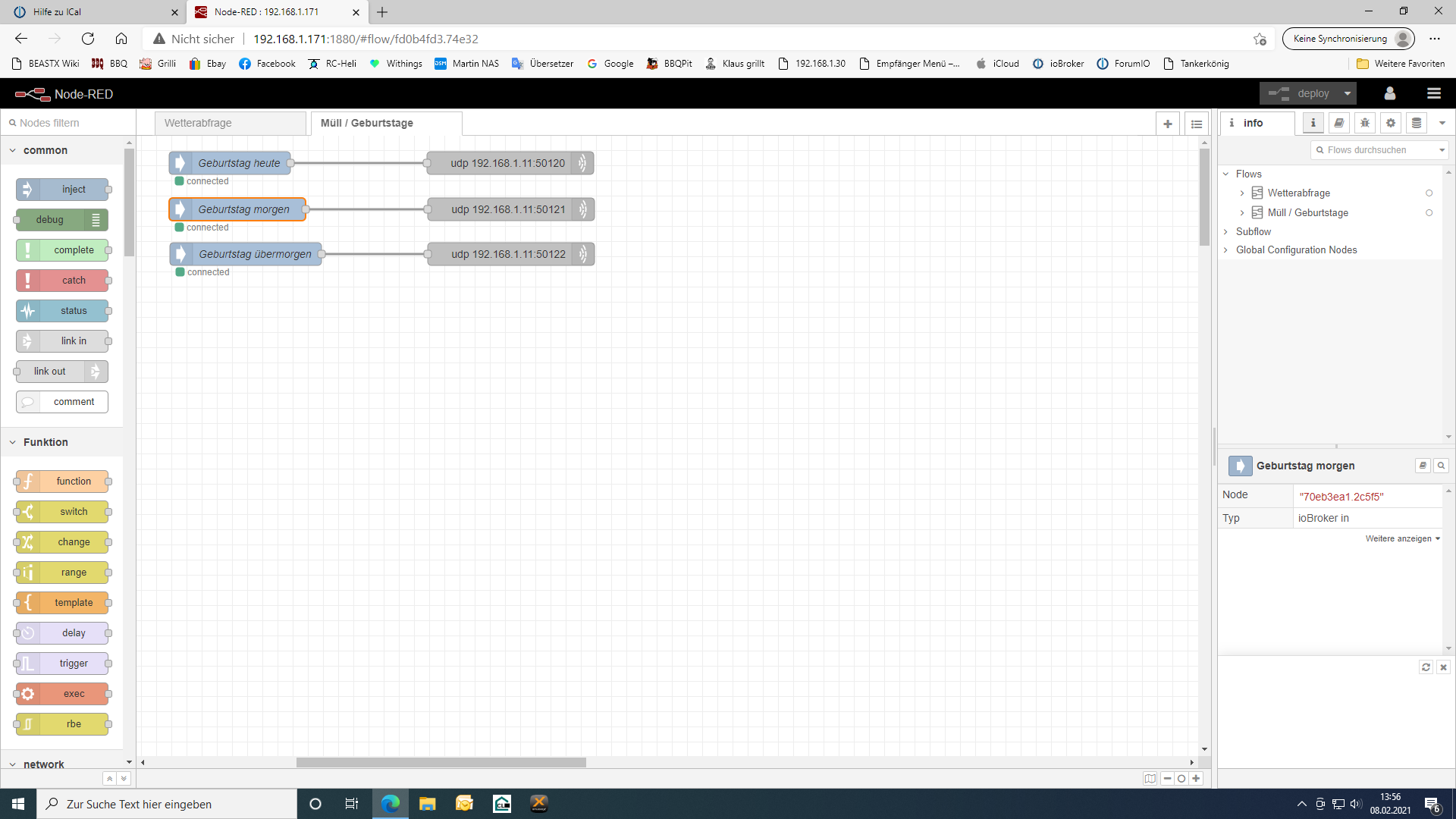

                UweW @Homoran last edited by
                @homoran meintest Du das?
                Geburtstag.docx
                wendy2702 Homoran 2 Replies Last reply Reply Quote 0
                • wendy2702
                  wendy2702 @UweW last edited by
                  @uwew kannst du das bitte hier als a) Screenshot und b) den Flow selber als text in Code Tags </> posten.
                  U 1 Reply Last reply Reply Quote 1

                    • U

                      @wendy2702 ich versuche das mal.
                              "id": "f8ba18bf.b7b9d8",
                              "type": "udp out",
                              "z": "fd0b4fd3.74e32",
                              "name": "",
                              "addr": "192.168.X.X",
                              "iface": "",
                              "port": "50XXX",
                              "ipv": "udp4",
                              "outport": "",
                              "base64": false,
                              "multicast": "false",
                              "x": 1206,
                              "y": 36,
                              "wires": []
                              "id": "7d9e3d85.844464",
                              "type": "ioBroker in",
                              "name": "Geburtstag",
                              "topic": "ical.0.events.0.today.Geburtstag",
                              "payloadType": "value",
                              "onlyack": "",
                              "func": "all",
                              "gap": "",
                              "fireOnStart": "false",
                              "x": 816,
                              "y": 36,
                              "wires": [
                                      "f8ba18bf.b7b9d8"
                      • wendy2702
