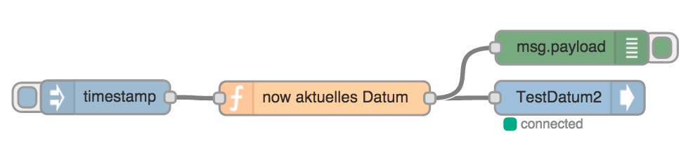

      Node-red Flow:
      [{"id":"63c5d5c5.9c3a2c","type":"function","name":"now aktuelles Datum","func":"// (1) wandelt timestamo ins ISO Datumformat um\n//msg.timestamp= new Date().toISOString()\n\n\n// (2) beliebiges Datum festlegbar: hier: YYYY-MM-DD HH:MM.SS\n//     (Ausgabeformat wird danz am Ende zusammengestellt)\nvar now     = new Date(); \nvar year    = now.getFullYear();\nvar month   = now.getMonth()+1; \nvar day     = now.getDate();\nvar hour    = now.getHours();\nvar minute  = now.getMinutes();\nvar second  = now.getSeconds(); \nif(month.toString().length == 1) {\nvar month = '0'+month;\n}\nif(day.toString().length == 1) {\nvar day = '0'+day;\n}   \nif(hour.toString().length == 1) {\nvar hour = '0'+hour;\n}\nif(minute.toString().length == 1) {\nvar minute = '0'+minute;\n}\nif(second.toString().length == 1) {\nvar second = '0'+second;\n} \n  \n//msg.timestamp = year+'-'+month+'-'+day+' '+hour+':'+minute+':'+second;\nmsg.payload = year+'-'+month+'-'+day+' '+hour+':'+minute+':'+second;\n\n\nreturn msg;","outputs":1,"x":996.2500152587891,"y":485.00000762939453,"z":"9d9dc866.626238","wires":[["d5e189e4.2a1e78","40557647.bfaa88"]]},{"id":"d5e189e4.2a1e78","type":"ioBroker out","name":"","topic":"TestDatum2","ack":"true","autoCreate":"true","x":1214.166660308838,"y":484.58338928222656,"z":"9d9dc866.626238","wires":[]},{"id":"8820471a.77dfb8","type":"inject","name":"","topic":"","payload":"","payloadType":"date","repeat":"","crontab":"","once":false,"x":801.2500228881836,"y":484.16673278808594,"z":"9d9dc866.626238","wires":[["63c5d5c5.9c3a2c"]]},{"id":"40557647.bfaa88","type":"debug","name":"","active":true,"console":"false","complete":"false","x":1216.250015258789,"y":440.00000762939453,"z":"9d9dc866.626238","wires":[]}]

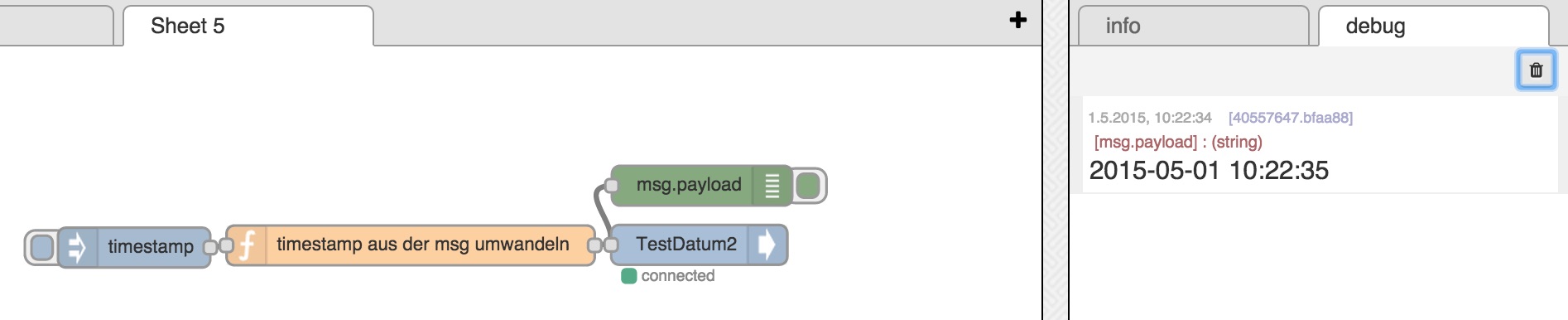

      In dem Beispiel wird nicht das Datum der Nachricht umgewandelt, sondern vom der aktuellen Zeit (Date()).
      Test und Beispiel zum Verständnis:
      Node-red Flow:
      [{"id":"76a3a5f9.895c5c","type":"function","name":"now aktuelles Datum","func":"// (1) wandelt timestamo ins ISO Datumformat um\n//msg.timestamp= new Date().toISOString()\n\n\n// (2) beliebiges Datum festlegbar: hier: YYYY-MM-DD HH:MM.SS\n// (Ausgabeformat wird danz am Ende zusammengestellt)\nvar now = new Date(); \nvar year = now.getFullYear();\nvar month = now.getMonth()+1; \nvar day = now.getDate();\nvar hour = now.getHours();\nvar minute = now.getMinutes();\nvar second = now.getSeconds(); \nif(month.toString().length == 1) {\nvar month = '0'+month;\n}\nif(day.toString().length == 1) {\nvar day = '0'+day;\n} \nif(hour.toString().length == 1) {\nvar hour = '0'+hour;\n}\nif(minute.toString().length == 1) {\nvar minute = '0'+minute;\n}\nif(second.toString().length == 1) {\nvar second = '0'+second;\n} \n\n\n// Variante1: wenn z.B. nicht ein vorhandener Payload\n// überschrieben werden soll, sondern um ein\n// Datum ergänzt werden soll. \n\n//msg.timestamp = year+'-'+month+'-'+day+' '+hour+':'+minute+':'+second;\n\n// Variante 2: Function gobt die aktuelle Zeit als payload aus\nmsg.payload = year+'-'+month+'-'+day+' '+hour+':'+minute+':'+second;\n\nreturn msg;","outputs":1,"x":1112.500015258789,"y":136.66663551330566,"z":"9d9dc866.626238","wires":[["9686a94e.697958","7237ae9e.8dc85","c557ecb1.3aa81"]]},{"id":"9686a94e.697958","type":"ioBroker out","name":"","topic":"TestDatum","ack":"true","autoCreate":"true","x":1311.6666450500488,"y":135.00000190734863,"z":"9d9dc866.626238","wires":[]},{"id":"7237ae9e.8dc85","type":"debug","name":"","active":true,"console":"false","complete":"false","x":1315.833396911621,"y":98.33335304260254,"z":"9d9dc866.626238","wires":[]},{"id":"470bde4f.b8f42","type":"inject","name":"","topic":"Beispiel Datumsformat","payload":"","payloadType":"date","repeat":"","crontab":"","once":false,"x":638.7500076293945,"y":138.33336067199707,"z":"9d9dc866.626238","wires":[["2a14ac81.d5eb54","c9fa1333.3605f"]]},{"id":"2a14ac81.d5eb54","type":"debug","name":"","active":true,"console":"false","complete":"false","x":838.7500114440918,"y":91.2500057220459,"z":"9d9dc866.626238","wires":[]},{"id":"c557ecb1.3aa81","type":"template","name":"Beispiel Object","field":"payload","template":"Topic: {{topic}} -\nTimestamp aus dem inject Node: \n{{tst}} -\nUmwandlung aus der function "now...":\n{{payload}}","x":1103.750015258789,"y":228.75000381469727,"z":"9d9dc866.626238","wires":[["5bb61570.a449ec"]]},{"id":"c9fa1333.3605f","type":"function","name":"Test msg.payload = msg.tst","func":"msg.tst = msg.payload;\nreturn msg;","outputs":1,"x":882.5000152587891,"y":136.25000190734863,"z":"9d9dc866.626238","wires":[["76a3a5f9.895c5c"]]},{"id":"5bb61570.a449ec","type":"debug","name":"","active":true,"console":"false","complete":"false","x":1332.5000190734863,"y":227.50000381469727,"z":"9d9dc866.626238","wires":[]}]

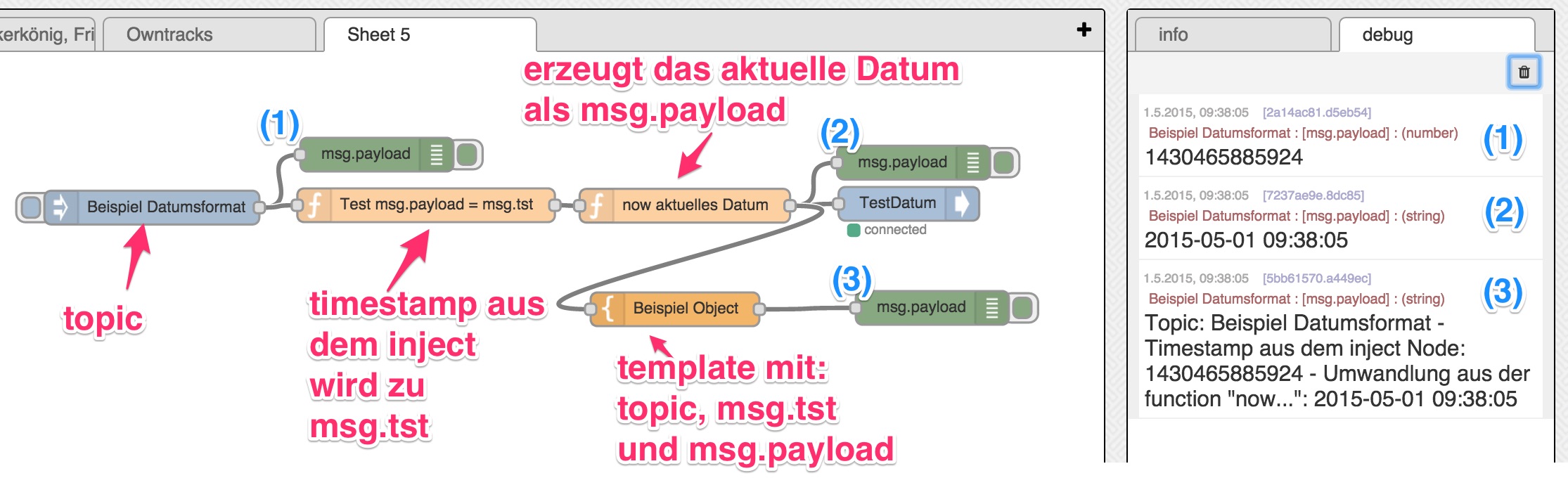

      Der Lerneffekt für mich war dabei, wie man mehrere Informationen in einer Message (msg) (=Object?) weitergibt und einzeln verarbeitet/ergänzen/ausgeben kann.
      Die msg, die zuletzt am template ankommt (template verwende ich z.B. in anderen Flows, um eine Email zusammenzubauen), enthält die Informationen ****msg.topic**** (aus dem inject node), ****msg.tst**** (Ursprung als msg.payload aus dem inject node, Umwandlung in der folgenden Funktion in msg.tst) und ****msg.payload**** aus der Funktion, die das aktuelle Datum (Date()) in ein lesbares Datumsformat umwandelt.
      ****Statt die aktuelle Zeit in der Funktion zu erzeugen soll nun die Zeit aus der msg (im Beispiel msg.payload aus dem inject node) in ein lesbares Datum umgewandelt werden:****
       ![327_2015-05-01_tst_umwandeln_3.jpg](/assets/uploads/files/327_2015-05-01_tst_umwandeln_3.jpg)

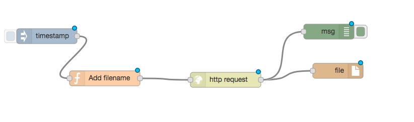

            Hallo
            Ich habe eine Frage zum Datum und speichern von Dateien.
            Wie kann ich eine Datei aus einem http request (buffer )mit einem Zeitstempel versehen ?
            /pfad/aktuelles_Datum.jpg
            Das ganze soll später für Zeitraffer sein.
            Grüsse von der Spree

                abuzze last edited by
                Hallo
                Ich kann das erst heute Abend mal testen.
                Eins verstehe ich noch nicht. —-…....und in den settings.js im functionGlobalContext hinterlegt sein——
                Wo befindet sich denn die settings.js ? Vielleicht geht es ja auch einfacher. Es soll ja nur ein Bild gespeichert werden mit aktuellem Datum.
                  rewenode last edited by
                  Dann solltest du vlt.
                  let suffix = ".jpg" //what ever
                  let date = new Date();
                  let file = date.getTime()+suffix;
                  oder ähnlich nehmen .
                  Dann sind diene Dateien auch gleich nach Datum sortiert.
                    Danke erstmal.Aber ich komme nicht weiter ,weil ich nicht weis was ich damit anfangen soll.Ich dachte das ich einfach ein functions node hinter meinem http request node habe und dann is alles gut ,aber es scheint doch etwas komplizierter zu sein.
                    Hast du vielleicht ein Beispiel wo ich mich orientieren kann ? Das wäre schön.
                      Ok. Ich glaube ich habe es selber herausgefunden.
                      msg.filename = "/root/timelapse/pic"+msg.payload+".jpg";
                      return msg;

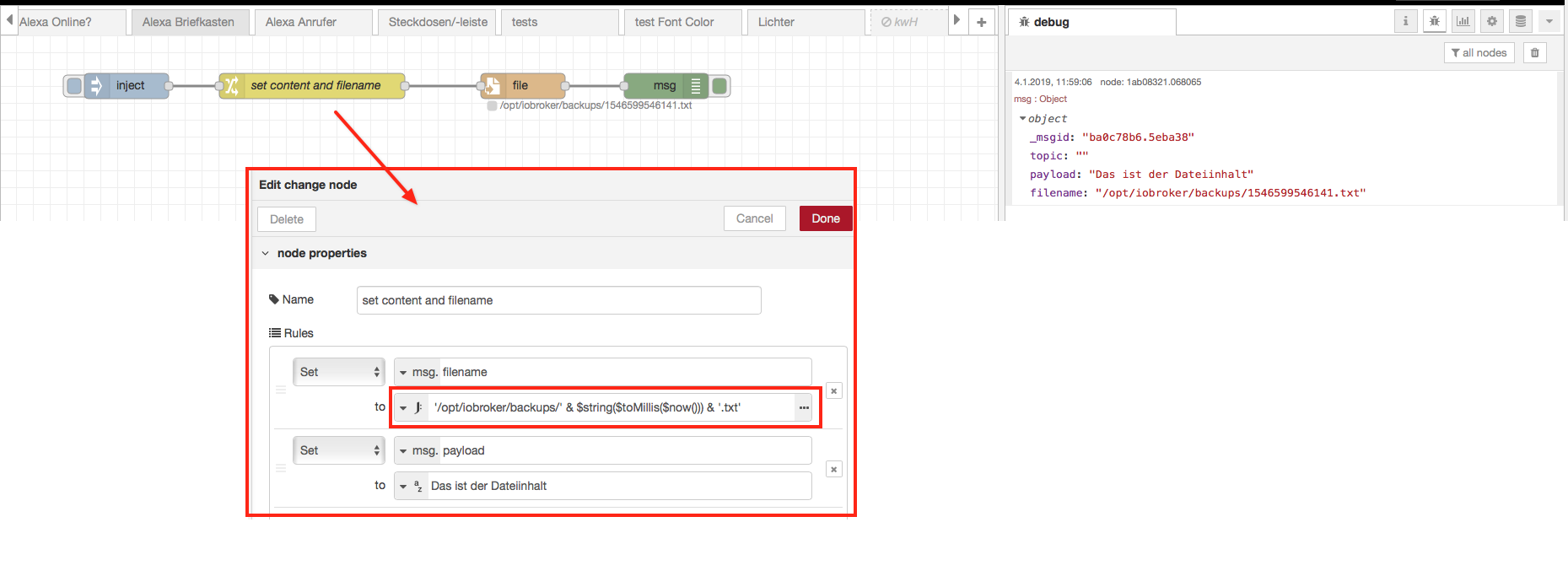

                          Stimmt. Leider kann der Dateiname im file-node nicht dynamisch gebildet werden. Und irgendwo muss der ja herkommen.
                          Aber du kannst natürlich einen change-node mit einem JSONata Ausdruck nehmen, das ist recht einfach:
                          JESONata kennt ne Reihe geeigneter date/time Funktionen:
                          http://docs.jsonata.org/date-time-functions
                          Leider ist in der iobroker-node-red Version nicht die aktuellste JSONata Version eingebunden. Das schmerzt besonders bei der function $fromMillis() die inzwischen diverse Format-Optionen kennt.
                          Man kann sich aber gut mit den JSONata Stringfunktionen behelfen:
                          http://docs.jsonata.org/string-functions
