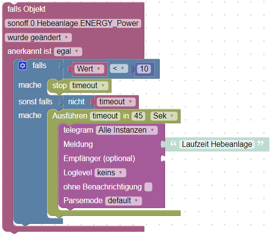

        paul53 @Thomsguy last edited by paul53
        @thomsguy sagte: wenn Sie länger als 45 Sekunden läuft eine Meldung an Telegram schickt
        Vorschlag:
          <variables>
          </variables>
          <block type="on" id="NW=tiSL1Ra_gl7.Y]dx" x="12" y="63">
            <field name="OID">sonoff.0.Hebeanlage.ENERGY_Power</field>
              <block type="controls_if" id="Eu0Y2_-zaItg-orNQlO">
                  <block type="logic_compare" id=";5taU5u]o}K]BFBgrCn/">
                    <field name="OP">LT</field>
                      <block type="on_source" id="6|JDT:f~PtE~4:D$t@mr">
                      <block type="math_number" id=":{v/)@m|-5ENHRs-QqYI">
                        <field name="NUM">10</field>
                  <block type="timeouts_cleartimeout" id="6rVkxA1B6y3#`DkFvYyC">
                <value name="IF1">
                  <block type="logic_negate" id="Xyq6PNoOtxf2g?VL3?u@">
                    <value name="BOOL">
                      <block type="variables_get" id="K])W2y[S7T4T2%Y#ft86">
                        <field name="VAR" id="timeout" variabletype="timeout">timeout</field>
                <statement name="DO1">
                  <block type="timeouts_settimeout" id="iJS8FQDpiUV?;d_MEAtC">
                    <field name="DELAY">45</field>
                      <block type="telegram" id="}ms6oI,@(8{Qe/b-cbB$">
                        <field name="LOG"></field>
                        <value name="MESSAGE">
                          <shadow type="text" id="/a.{]O)H~l.n8Q};%EkH">
                            <field name="TEXT">Laufzeit Hebeanlage</field>
