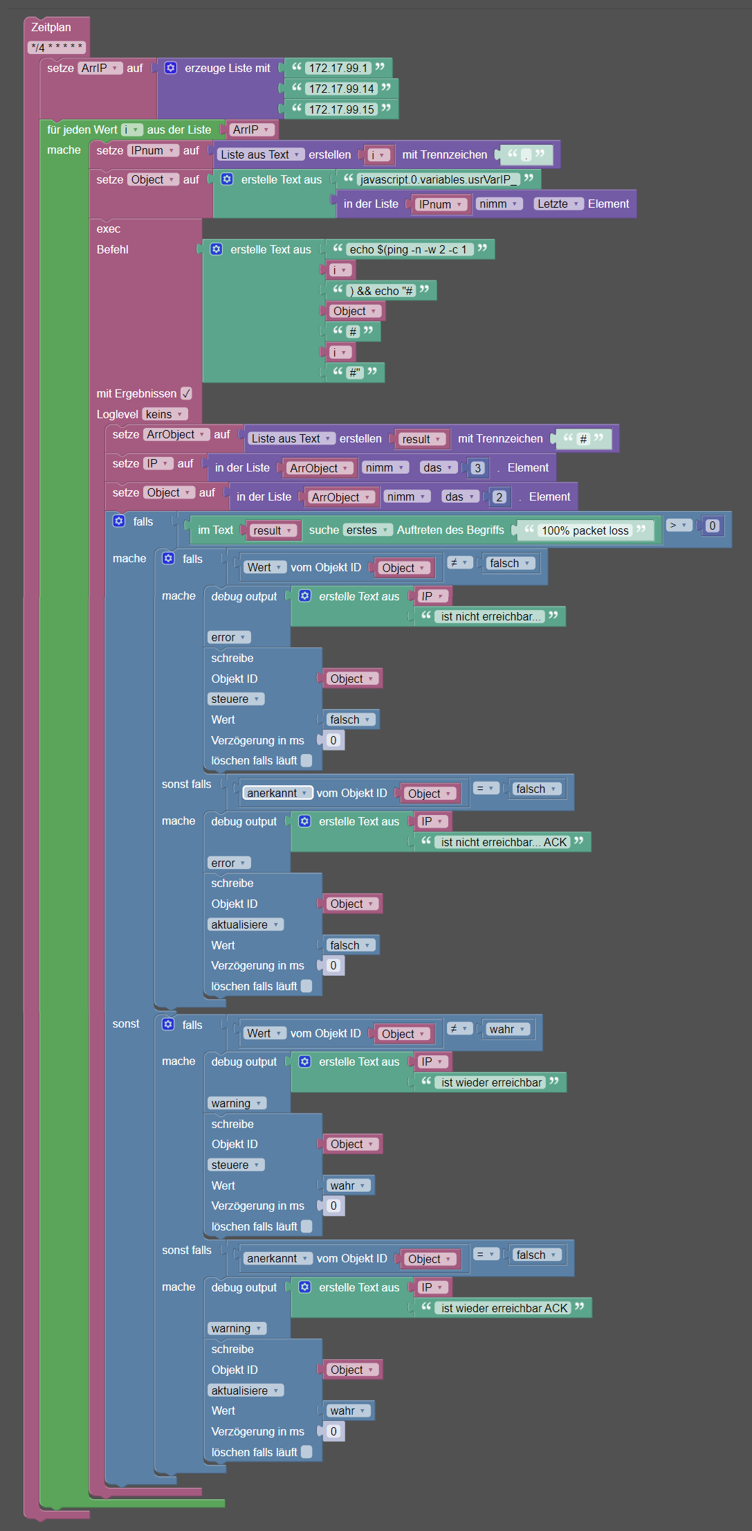

      ich habe manchmal (aber nicht immer!), das Problem, dass ich von den exec-Befehl zwei "Results" in der fast selben Millisekunde bekommen. Meine Befehle danach werden dann natürlich auch doppelt ausgeführt.
      Hier zwei Beispiele, kurz nacheinander:
      Korrekt um 10:35:24
      javascript.0	2021-02-17 10:35:24.056	warn	(2305505) script.js.Sys.IP-check: S: E: R: PING 172.17.99.14 (172.17.99.14) 56(84) bytes of data. From 172.17.99.14 icmp_seq=1 Destination Host Unreachable --- 172.17.99.14 ping statistics --- 1 pac
      javascript.0	2021-02-17 10:35:24.055	warn	(2305505) script.js.Sys.IP-check: S: E: R: PING 172.17.99.14 (172.17.99.14) 56(84) bytes of data. From 172.17.99.14 icmp_seq=1 Destination Host Unreachable --- 172.17.99.14 ping statistics --- 1 pac
      javascript.0	2021-02-17 10:35:24.037	warn	(2305505) script.js.Sys.IP-check: S: E: R: PING 172.17.99.1 (172.17.99.1) 56(84) bytes of data. 64 bytes from 172.17.99.1: icmp_seq=1 ttl=64 time=10.2 ms --- 172.17.99.1 ping statistics --- 1 packet
      javascript.0	2021-02-17 10:35:24.036	info	(2305505) script.js.Sys.IP-check: exec: echo $(echo $(ping -c 1 172.17.99.15) && echo "#javascript.0.variables.usrVarIP_15#172.17.99.15#")
      javascript.0	2021-02-17 10:35:24.025	info	(2305505) script.js.Sys.IP-check: exec: echo $(echo $(ping -c 1 172.17.99.14) && echo "#javascript.0.variables.usrVarIP_14#172.17.99.14#")
      javascript.0	2021-02-17 10:35:24.014	info	(2305505) script.js.Sys.IP-check: exec: echo $(echo $(ping -c 1 172.17.99.1) && echo "#javascript.0.variables.usrVarIP_1#172.17.99.1#")
      Doppelt um 10:35:30
      javascript.0	2021-02-17 10:35:30.068	warn	(2305505) script.js.Sys.IP-check: S: E: R: PING 172.17.99.15 (172.17.99.15) 56(84) bytes of data. From 172.17.99.15 icmp_seq=1 Destination Host Unreachable --- 172.17.99.15 ping statistics --- 1 pac
      javascript.0	2021-02-17 10:35:30.064	warn	(2305505) script.js.Sys.IP-check: S: E: R: PING 172.17.99.15 (172.17.99.15) 56(84) bytes of data. From 172.17.99.15 icmp_seq=1 Destination Host Unreachable --- 172.17.99.15 ping statistics --- 1 pac
      javascript.0	2021-02-17 10:35:30.058	warn	(2305505) script.js.Sys.IP-check: S: E: R: PING 172.17.99.14 (172.17.99.14) 56(84) bytes of data. From 172.17.99.14 icmp_seq=1 Destination Host Unreachable --- 172.17.99.14 ping statistics --- 1 pac
      javascript.0	2021-02-17 10:35:30.054	warn	(2305505) script.js.Sys.IP-check: S: E: R: PING 172.17.99.14 (172.17.99.14) 56(84) bytes of data. From 172.17.99.14 icmp_seq=1 Destination Host Unreachable --- 172.17.99.14 ping statistics --- 1 pac
      javascript.0	2021-02-17 10:35:30.035	warn	(2305505) script.js.Sys.IP-check: S: E: R: PING 172.17.99.1 (172.17.99.1) 56(84) bytes of data. 64 bytes from 172.17.99.1: icmp_seq=1 ttl=64 time=10.3 ms --- 172.17.99.1 ping statistics --- 1 packet
      javascript.0	2021-02-17 10:35:30.034	info	(2305505) script.js.Sys.IP-check: exec: echo $(echo $(ping -c 1 172.17.99.15) && echo "#javascript.0.variables.usrVarIP_15#172.17.99.15#")
      javascript.0	2021-02-17 10:35:30.022	info	(2305505) script.js.Sys.IP-check: exec: echo $(echo $(ping -c 1 172.17.99.14) && echo "#javascript.0.variables.usrVarIP_14#172.17.99.14#")
      javascript.0	2021-02-17 10:35:30.012	info	(2305505) script.js.Sys.IP-check: exec: echo $(echo $(ping -c 1 172.17.99.1) && echo "#javascript.0.variables.usrVarIP_1#172.17.99.1#")
      <block xmlns="https://developers.google.com/blockly/xml" type="schedule" id="ILF`?vp]goTiM`~tV|(2" x="238" y="-312">
        <field name="SCHEDULE">*/3 * * * * *</field>
          <block type="variables_set" id="[8,~Ca)w[ae4;yp`=I~)">
            <field name="VAR" id="1W_pHf|XdCKrk9/F*[qz">ArrIP</field>
              <block type="lists_create_with" id="Wvx;zfbMk);8v@3h9F%N">
                <value name="ADD0">
                  <block type="text" id=";BC^[#.:xMl^o8a|vc}E">
                    <field name="TEXT">172.17.99.1</field>
                <value name="ADD1">
                  <block type="text" id="hj|%X!@PMPqiyKR[rlO^">
                    <field name="TEXT">172.17.99.14</field>
                <value name="ADD2">
                  <block type="text" id="O]]^8SQc%Fs2pROsn{0h">
                    <field name="TEXT">172.17.99.15</field>
              <block type="controls_forEach" id="qEgqFSY(|@ry[+)K|sv#">
                <field name="VAR" id="@2.1INhpZHzr-tLw*/t7">i</field>
                <value name="LIST">
                  <block type="variables_get" id="i5E=f_x?al-Jgiu:{r-@">
                <statement name="DO">
                  <block type="variables_set" id="x%w^`/{0JhIEdmSKimJ~">
                    <field name="VAR" id="^KF1lA2!jwNFoq+D2*[-">IPnum</field>
                      <block type="lists_split" id="$]U:%WMGnMwU.1uQmeo2">
                        <mutation mode="SPLIT"></mutation>
                        <field name="MODE">SPLIT</field>
                        <value name="INPUT">
                          <block type="variables_get" id="zWtRLfFle^TNw^u^sw|2">
                        <value name="DELIM">
                          <shadow type="text" id="~Po$2a!QYMV}~Yw+95_T">
                            <field name="TEXT">.</field>
                      <block type="variables_set" id="=|aOm9[u*`}0Fjlc)pwc">
                        <field name="VAR" id="5gXCi9`[IIJHC%J79eA5">Object</field>
                          <block type="text_join" id="iXIF`VqO5b=Cc^Z+_ASR">
                            <value name="ADD0">
                              <block type="text" id="Ot(PFfw?M=GH1@n/5qZ)">
                                <field name="TEXT">javascript.0.variables.usrVarIP_</field>
                            <value name="ADD1">
                              <block type="lists_getIndex" id="8#ntbqHGt%Q7LfT#MTqC">
                                <mutation statement="false" at="false"></mutation>
                                <field name="WHERE">LAST</field>
                                  <block type="variables_get" id="g`cZ/wJ=oGuV/al4nfuL">
                          <block type="exec" id="J$-VmB1SfyoM/Q5LN,I]">
                            <mutation xmlns="http://www.w3.org/1999/xhtml" with_statement="true"></mutation>
                            <field name="WITH_STATEMENT">TRUE</field>
                            <field name="LOG">log</field>
                            <value name="COMMAND">
                              <shadow type="text" id="okurxeauwK|7$@$o_.Sm">
                                <field name="TEXT"></field>
                              <block type="text_join" id="q]2GI^I+1hX8Xmtgyp]G">
                                <mutation items="7"></mutation>
                                <value name="ADD0">
                                  <block type="text" id="H#lFjE%4kt]S;+25)9@(">
                                    <field name="TEXT">echo $(ping -n -w 2 -c 1 </field>
                                <value name="ADD1">
                                  <block type="variables_get" id="9/TB|oaao(`9SVj1MU+K">
                                <value name="ADD2">
                                  <block type="text" id="itCH~}9-s{g*H70jNj{W">
                                    <field name="TEXT">) &amp;&amp; echo "#</field>
                                <value name="ADD3">
                                  <block type="variables_get" id="~cwD5}IMbBmB+2qrx*}!">
                                <value name="ADD4">
                                  <block type="text" id=".ze^eiN:k8cN@a{1@^W3">
                                    <field name="TEXT">#</field>
                                <value name="ADD5">
                                  <block type="variables_get" id="z-9Of[i~dd!0V$DMnZf_">
                                <value name="ADD6">
                                  <block type="text" id="FYddbcK-T|e~0`Ka:NeN">
                                    <field name="TEXT">#"</field>
                              <block type="debug" id="y|%=QG,`qrlQuLH1~`WG">
                                <field name="Severity">warn</field>
                                <value name="TEXT">
                                  <shadow type="text" id="_xf~,-@%`T@|LqAWpY^M">
                                  <block type="variables_get" id="u996Y(}Dn*:Lt?!8nD:l">
                                    <field name="VAR" id="(?E!3]@5.9owCS2ou2Li">result</field>
                                  <block type="variables_set" id="=W6:pMWOqz*y?0u]s9/P">
                                    <field name="VAR" id="AQW9pT|3|?LUHYgr8HJ~">ArrObject</field>
                                      <block type="lists_split" id="`hqL888Kd@8[Wr/w]#dn">
                                          <block type="variables_get" id="X$eU%T.q`i#;amMp9Ds;">
                                          <shadow type="text" id="Vdgd.Yq$ApUutu@}_6^Z">
                                      <block type="variables_set" id=")]GHa7p3Gj0(k@[5]%VI">
                                        <field name="VAR" id="]P7+r}H#8Dqb!dx.QGrr">IP</field>
                                          <block type="lists_getIndex" id="Ih$.6#,@mHiUxooS-7*2">
                                              <block type="variables_get" id="K]U%v!Pt(|{)2uVwSI*L">
                                            <value name="AT">
                                              <block type="math_number" id="^3(YCdhtebCYK%8$p@1J">
                                                <field name="NUM">3</field>
                                          <block type="variables_set" id="kKf%,KdL?S;JTK8MI~U9">
                                              <block type="lists_getIndex" id="G1_9cj;?O{JzOClpy^;h">
                                                  <block type="variables_get" id="q`Wct0w2@{kpLflFPeDH">
                                                <value name="AT">
                                                  <block type="math_number" id="*:H1Gk}/W-Q*4uvM3616">
                                                    <field name="NUM">2</field>
                                              <block type="controls_if" id="F3f!5h{kx`O3O}f+^},c">
                                                  <block type="logic_compare" id="r,O([|8/upgMM7;xBsi,">
                                                    <field name="OP">GT</field>
                                                      <block type="text_indexOf" id="Zh:Q7KsofG$D8SBOQ,Z#">
                                                        <field name="END">FIRST</field>
                                                          <block type="variables_get" id=".b]3}-a^_P%Ry~v@4PZz">
                                                        <value name="FIND">
                                                          <shadow type="text" id="X+!{;b3#f{U5YdU{LrNC">
                                                            <field name="TEXT">100% packet loss</field>
                                                      <block type="math_number" id="q]-98|7Tb,%=o!mG|7+?">
                                                        <field name="NUM">0</field>
                                                  <block type="controls_if" id="CEY}m,hFo=W,j{)GG(KL">
                                                      <block type="logic_compare" id="%${k.VYf:-2TJ80PSv@Y">
                                                        <field name="OP">NEQ</field>
                                                          <block type="get_value_var" id="hf}JGqhks%0~I9:8E6Q4">
                                                            <value name="OID">
                                                              <shadow type="text" id="H$x1)c0U*JkBJsE!8$8n">
                                                              <block type="variables_get" id="^HYX2=5%Mnh/g)x%YzIz">
                                                          <block type="logic_boolean" id="@O3tEkl#.?K;8;C7hAKp">
                                                      <block type="debug" id="8:@iLyyio0+/^MXkSu$V">
                                                        <field name="Severity">error</field>
                                                        <value name="TEXT">
                                                          <shadow type="text" id="hnbNQY#6X-N#s:?LtH7e">
                                                          <block type="text_join" id="ssDi-lcRgLWi+SEFJrmT">
                                                            <value name="ADD0">
                                                              <block type="variables_get" id="15+CNi}}l:TS@UE-zKQ,">
                                                            <value name="ADD1">
                                                              <block type="text" id="2n3sv@`p/Sw)S(^nO$E0">
                                                                <field name="TEXT"> ist nicht erreichbar...</field>
                                                          <block type="control_ex" id="x%H,|.wl;NTx0!YlC%8I">
                                                            <value name="OID">
                                                              <shadow type="field_oid" id="m2_;mBL5|,~op:oi-o[D">
                                                                <field name="oid">Object ID</field>
                                                              <block type="variables_get" id="]8FO@_25u0gR%Ft]#8%x">
                                                              <shadow type="logic_boolean" id="(?z~vUfk$4L+$_-MzMN`">
                                                              <block type="logic_boolean" id="NbGJM}F;:DD,,z^/mQ?T">
                                                            <value name="DELAY_MS">
                                                              <shadow type="math_number" id="aOsB_i|#NvYBj=%qRhQy">
                                                    <value name="IF1">
                                                      <block type="logic_compare" id="G*yBxNG(s/2@IRvrJx%|">
                                                        <field name="OP">EQ</field>
                                                          <block type="get_value_var" id="Q8;!bHkD@`!]6k?la?eg">
                                                            <field name="ATTR">ack</field>
                                                            <value name="OID">
                                                              <shadow type="text">
                                                              <block type="variables_get" id="Zn#ym;s__J5:^UC3QRWO">
                                                          <block type="logic_boolean" id="Z|B*/7SXq()09ULoc=cR">
                                                    <statement name="DO1">
                                                      <block type="debug" id="?QjF5u_lJ6L2ikhQq!KW">
                                                        <value name="TEXT">
                                                          <block type="text_join" id="kPb,rsEJ.l$7%%_DJ6`[">
                                                            <value name="ADD0">
                                                              <block type="variables_get" id="kN5(HLcR:AODc/iYIDEl">
                                                            <value name="ADD1">
                                                              <block type="text" id="~6EED+S3],[6;]O}|8R=">
                                                                <field name="TEXT"> ist nicht erreichbar... ACK</field>
                                                          <block type="control_ex" id="(?|mC*a^%hKS9i6H_dP*">
                                                            <field name="TYPE">true</field>
                                                            <value name="OID">
                                                              <shadow type="field_oid">
                                                              <block type="variables_get" id="KZ]%V0bZbqZ_;.Z;YCs-">
                                                              <shadow type="logic_boolean">
                                                              <block type="logic_boolean" id="}J@P%Mi%5oSoxh85#e|J">
                                                              <shadow type="math_number" id="+Rs|Km9+|cMJoQ1S3:Ak">
                                                <statement name="ELSE">
                                                  <block type="controls_if" id="YI|w46RYA/DPi?15ZZ3k">
                                                      <block type="logic_compare" id="7ngNi%uWU!;[vn(QVDKt">
                                                          <block type="get_value_var" id="5]hcb.Mt#RZW2ub4*4HP">
                                                            <value name="OID">
                                                              <block type="variables_get" id="JOoBQb*wYH|LgZB]#.w_">
                                                          <block type="logic_boolean" id="e{4X(U]3sN+[G4|E7!(S">
                                                      <block type="debug" id="016|SiY(@[Sce[0rXe#~">
                                                        <value name="TEXT">
                                                          <shadow type="text" id="^FaLdVY=7iB2iH8h}9ei">
                                                          <block type="text_join" id="}P]*@hOk~GmWRr]d+S`Z">
                                                            <value name="ADD0">
                                                              <block type="variables_get" id="B6fLhymk,S~X)NYVG[vW">

      • Asgothian
        Asgothian Developer @Teller last edited by
        @teller
        • Bitte den Code des Blockly in Code tags (</> setzen)
        • Bitte auch einen Screenshot vom Blockly posten.
        So ist das kaum zu erkennen was da passiert.
        A.
        T 2 Replies Last reply Reply Quote 0
          Teller @Asgothian last edited by
          @asgothian
          Sorry bin noch neu hier. Habe es oben angepasst.
            @asgothian
            Anbei auch das Bild:
            785
            180
