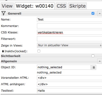

              es geht so:
              Diesen Code ins den CSS-Tab kopieren:
              .vertikalzentrieren div {
                  display: flex;
                  align-items: center; /* vertikal*/
                  justify-content: center; /* horizontal */
              Das Widget ist ein HTML Text Widget. In HTML voranstellen kommt ein HTML Befehl zum erzeugen eines DIV-Containers, der 100% in Höhe und Breite das Widget ausfüllt. Innerhalb dieses Containers wird der Text dann zentriert.
              Widget:
              [{"tpl":"tplValueString","data":{"oid":"nothing_selected","g_fixed":true,"g_visibility":false,"g_css_font_text":true,"g_css_background":true,"g_css_shadow_padding":false,"g_css_border":false,"g_gestures":false,"g_signals":false,"visibility-cond":"==","visibility-val":1,"visibility-groups-action":"hide","signals-cond-0":"==","signals-val-0":true,"signals-icon-0":"/vis/signals/lowbattery.png","signals-icon-size-0":0,"signals-blink-0":false,"signals-horz-0":0,"signals-vert-0":0,"signals-hide-edit-0":false,"signals-cond-1":"==","signals-val-1":true,"signals-icon-1":"/vis/signals/lowbattery.png","signals-icon-size-1":0,"signals-blink-1":false,"signals-horz-1":0,"signals-vert-1":0,"signals-hide-edit-1":false,"signals-cond-2":"==","signals-val-2":true,"signals-icon-2":"/vis/signals/lowbattery.png","signals-icon-size-2":0,"signals-blink-2":false,"signals-horz-2":0,"signals-vert-2":0,"signals-hide-edit-2":false,"class":"vertikalzentrieren","name":"Test","test_html":"Hallo","html_prepend":"","html_append":""},"style":{"left":"102px","top":"598px","z-index":"20","background":"green","width":"283px","height":"119px","color":"white"},"widgetSet":"basic"}]

                  hmanfred last edited by
                  @pix:
                  es geht so:
                  Funktioniert prima. 😄
                  Danke!
