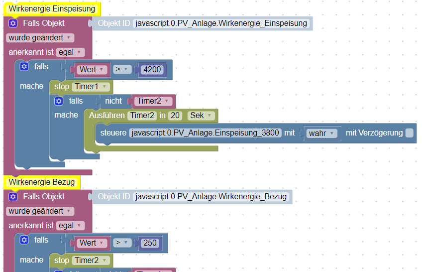

            paul53 @wendy2702 last edited by
            @wendy2702 sagte: wo der Fehler liegt.
            Kann keinen Fehler finden, würde es aber vereinfachen.
                @wendy2702 sagte: erweitern um diese Bedingung zu erfüllen:
                 <variables>
                   <variable type="timeout" id="Timer2">Timer2</variable>
                   <variable type="timeout" id="Timer1">Timer1</variable>
                 </variables>
                 <block type="control" id="4P7IuvJx_AE![7.*gF3O" x="-537" y="-237">
                   <field name="OID">javascript.0.PV_Anlage.Einspeisung_3800</field>
                     <block type="logic_boolean" id="RCK/E@,1N/|NY+h?xe`u">
                 <block type="comment" id="Pdn|@PrS^+9*o=ZdQj{*" x="-487" y="-137">
                   <field name="COMMENT">Wirkenergie Einspeisung</field>
                     <block type="on_ext" id="+CU7DBqPN-:BXdUoO+nm">
                       <value name="OID0">
                         <shadow type="field_oid" id="-dyEvB_T{Oif?o=FpqC8">
                           <field name="oid">javascript.0.PV_Anlage.Wirkenergie_Einspeisung</field>
                         <block type="controls_if" id="SX;8~,KESeTeG1|YOp2Y">
                             <block type="logic_compare" id="X1GBVZJUSiQ1+kwYIL7|">
                               <field name="OP">GT</field>
                                 <block type="on_source" id="If!1e6E=ch1+C#8^O`!L">
                                 <block type="math_number" id="]zzMuR/u,LkTKt33op,6">
                                   <field name="NUM">4200</field>
                             <block type="timeouts_cleartimeout" id="gzZU{b{~*j9fuOb@czE/">
                               <field name="NAME">Timer1</field>
                                 <block type="controls_if" id="-.DP*p_~I}(9f`~j!^OP">
                                     <block type="logic_negate" id="TvIsPZ721.R|KxN)WU(e">
                                       <value name="BOOL">
                                         <block type="variables_get" id="{RiZEnA7rethGzo*JxqV">
                                           <field name="VAR" id="Timer2" variabletype="timeout">Timer2</field>
                                     <block type="timeouts_settimeout" id="3GSE4.-/R6aMZ$GT(q.?">
                                       <field name="NAME">Timer2</field>
                                       <field name="DELAY">20</field>
                                         <block type="control" id="Y(U!+BPt*#)`3#%QjKJq">
                                             <block type="logic_boolean" id="u@Go9Jx~f.Tv6wP`8VNT">
                         <block type="comment" id="#IB)qsCs,BCFcQ@uKK=-">
                           <field name="COMMENT">Wirkenergie Bezug</field>
                             <block type="on_ext" id="l/sO`Mmg#3?E_,:aD_#5">
                               <value name="OID0">
                                 <shadow type="field_oid" id="e5eyn}olm?FlJe@hIU~V">
                                   <field name="oid">javascript.0.PV_Anlage.Wirkenergie_Bezug</field>
                                 <block type="controls_if" id="si_XTC747[al^gX0YC!R">
                                     <block type="logic_compare" id="n2q67+OVsF.C14ve9go)">
                                         <block type="on_source" id="`g)(!XgM[q~,|B1Uu_4B">
                                         <block type="math_number" id="F~ubKW`y}A(i*h}er@QP">

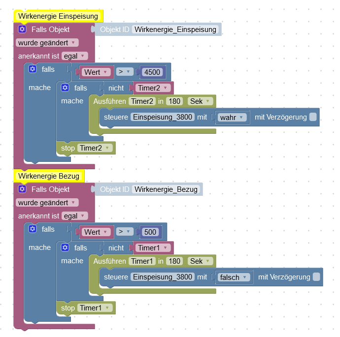

                • wendy2702
                  wendy2702 @paul53 last edited by
                  Hallo Paul,
                  Danke für deine Hilfe.
                  Ich werde morgen bei Sonnenschein testen ob es funktioniert, wovon ich aber eh ausgehe.
                  Schönen Abend
                  Mirko
                  • wendy2702
                    hat ein wenig gedauert mit meiner Antwort aber ich war auf Dienstreise und konnte nicht immer auf das System achten.
                    @paul53 : kann es sein das mit dem aktuellen Script Grundsätzlich nach der eingestellten Zeit gesteuert wird wenn der Trigger einmal erfüllt wurde auch wenn die Bedingung sich innerhalb der Zeit wieder zurück ändert?
                    Also Beispiel:
                    Einspeisung erreicht 4200 aber nach zum Beispiel 30 sekunden fällt der Wert wieder unter 4200 dann soll nicht nach der eingestellten Zeit geschaltet werden.
                    Irgendwie habe ich aber den Eindruck das aktuell immer nach Ablauf der Eingestellten Zeit geschaltet wird, unabhängig davon ob die Bedingung innerhalb der Zeit nicht mehr erfüllt ist.
                    Hoffe du/ihr könnt mir folgen.
                      paul53 @wendy2702 last edited by paul53
                      @wendy2702 sagte: Einspeisung erreicht 4200 aber nach zum Beispiel 30 sekunden fällt der Wert wieder unter 4200 dann soll nicht nach der eingestellten Zeit geschaltet werden.
                      Die Verzögerung wirkt nur bei "Bezug > 250". Bei "Einspeisung > 4200" hattest Du keine Verzögerung vorgesehen.
                      • wendy2702
                        @wendy2702 sagte in Problem mit Blockly:
                        Ideal wäre es wenn Einspeisung_3800 auf true gesetzt wenn Wirkenergie >4200 länger als Zeit X
                        @paul53 : Oh, sorry. Dachte das mit dem Satz oben zum Ausdruck gebracht zu haben.
                          @wendy2702 sagte: Dachte das mit dem Satz oben zum Ausdruck gebracht zu haben.
                          Ja, das sollte auch in dem Export enthalten sein. Wie sieht das Blockly jetzt aus (Bild).
                            Wird auch nicht, denn die Variable Timer2 sperrt solange sie nicht bei "Bezug > 250" gestoppt wird.
                            Wenn der Wert einmalig 4200 überschreitet, wird nach Verzögerung geschaltet.
                            Soll das nicht passieren, wenn innerhalb der Verzögerungszeit der Wert wieder unterschritten wird? Dann muss das "stop Timer" in den sonst-Zweig:
                            wendy2702 3 Replies Last reply Reply Quote 0

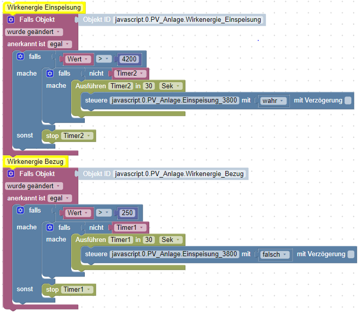

                            • wendy2702
                              @paul53 Hallo,
                              aktuell sieht es so aus wie das was du mir oben gebaut hast:
                              Idee war, damit meine WP keinen PING PONG macht, ja folgende:
                              4200 wird überschritten und bleibt für mindestens Zeit x über diesem Wert. Dann setze "Einspeisung_3800" auf true. Fällt er innerhalb der Zeit X wieder unter 4200 bleibt "Einspeisung_3800" auf false und der Prozess startet von vorne. Quasi solange bis eine Stabile Einspeisung von >4200 erreicht ist.
                              Gleiches für den Bezug.
                              500 wird überschritten und bleibt für Zeit y über diesem Wert. Dann setze "Einspeisung_3800" auf false. Fällt der Bezug innerhalb der Zeit Y wieder unter 500 bleibt "Einspeisung_3800" auf true. Also erst schalten wenn der Bezug über einen Zeitraum y über 500 liegt.
                              Hoffe ich habe das jetzt verständlich erklärt 😊
                              Also nur wenn die Bedingungen jeweils über einen Zeitraum X und Y erfüllt werden wirklich den Datenpunkt ändern.
                              • wendy2702
                                @paul53 OK. Du warst schneller.
                                Werde ich so ändern und testen.
                                Danke!

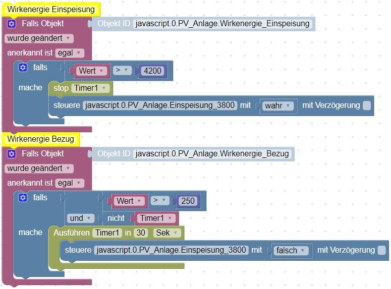

                                • wendy2702
                                  @paul53 sagte in Problem mit Blockly:
                                  Hallo Paul,
                                  habe das nachgebaut aber scheinbar schaltet es jetzt überhaupt nicht mehr.
                                  Wir haben aktuell schin seit ca. 15 Minuten eine Einspeisung von knapp 10000 aber es passiert nichts.
                                  Habe ich noch irgendwo einen Fehler eingebaut?

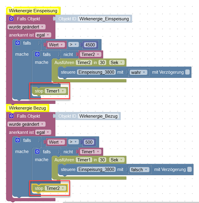

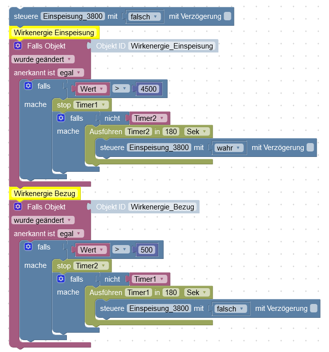

                                  • wendy2702
                                    Habe die beiden Timer mal umgestellt. Jetzt wurde geschaltet.
                                    Ist das so richtig ?
                                      @wendy2702 sagte: Habe ich noch irgendwo einen Fehler eingebaut?
                                      Du musst jeweils einen sonst-Zweig hinzufügen, in dem der Timer gestoppt wird (siehe Bild).
                                      • wendy2702
                                        @paul53 OK.
                                        Wenn man scheinbar blind ist.
